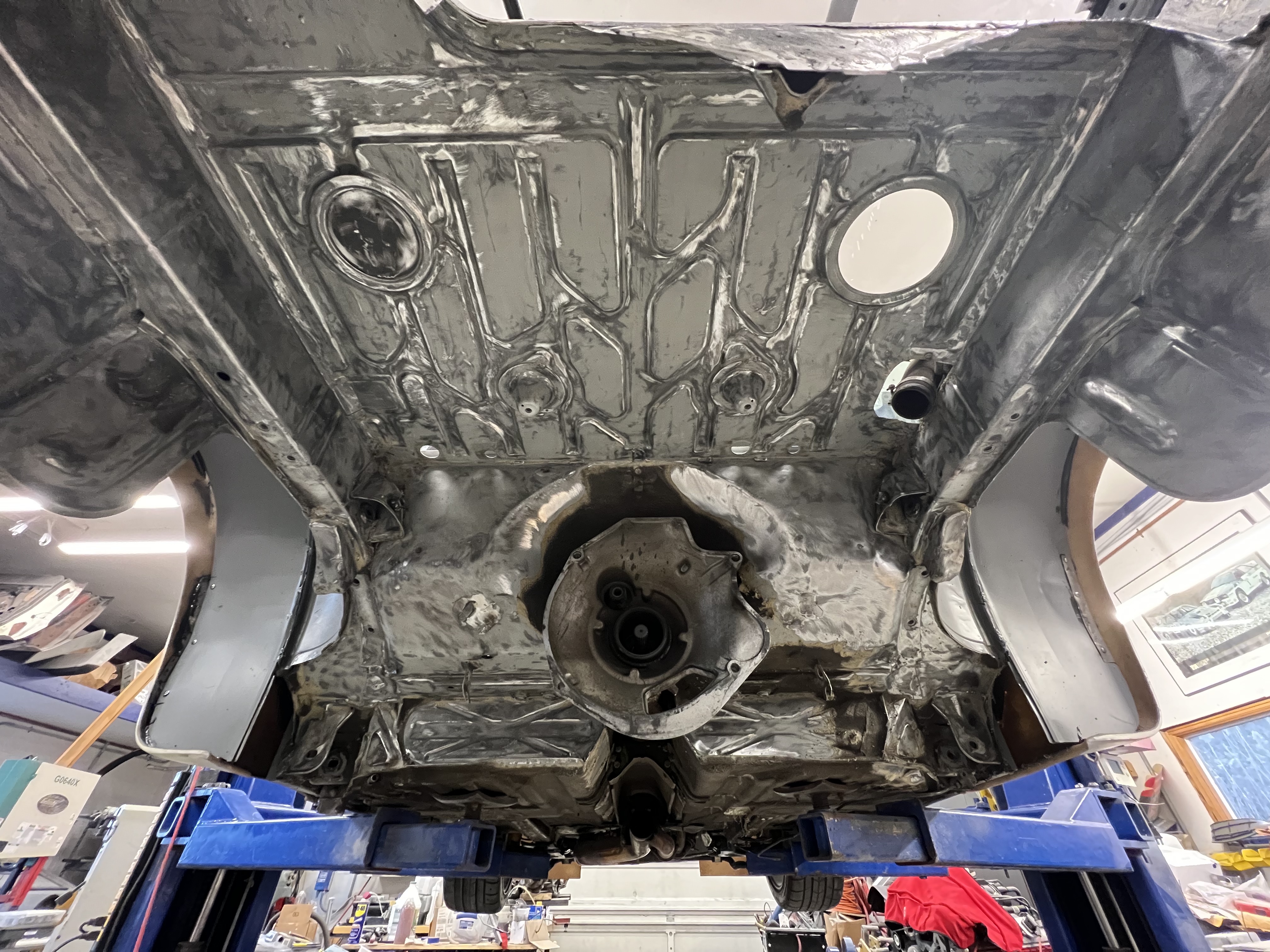

A friend of mine who built a few 944t race cars back in the 90s called it the gas wash. Yep gasoline. I laughed when he told me how he did it. But it works. The hazmat must be insane.

Wire wheel….and a lot of time! Blasting dosent do squat to that stuff or the undercoating. I just came in from the shop working on this!
