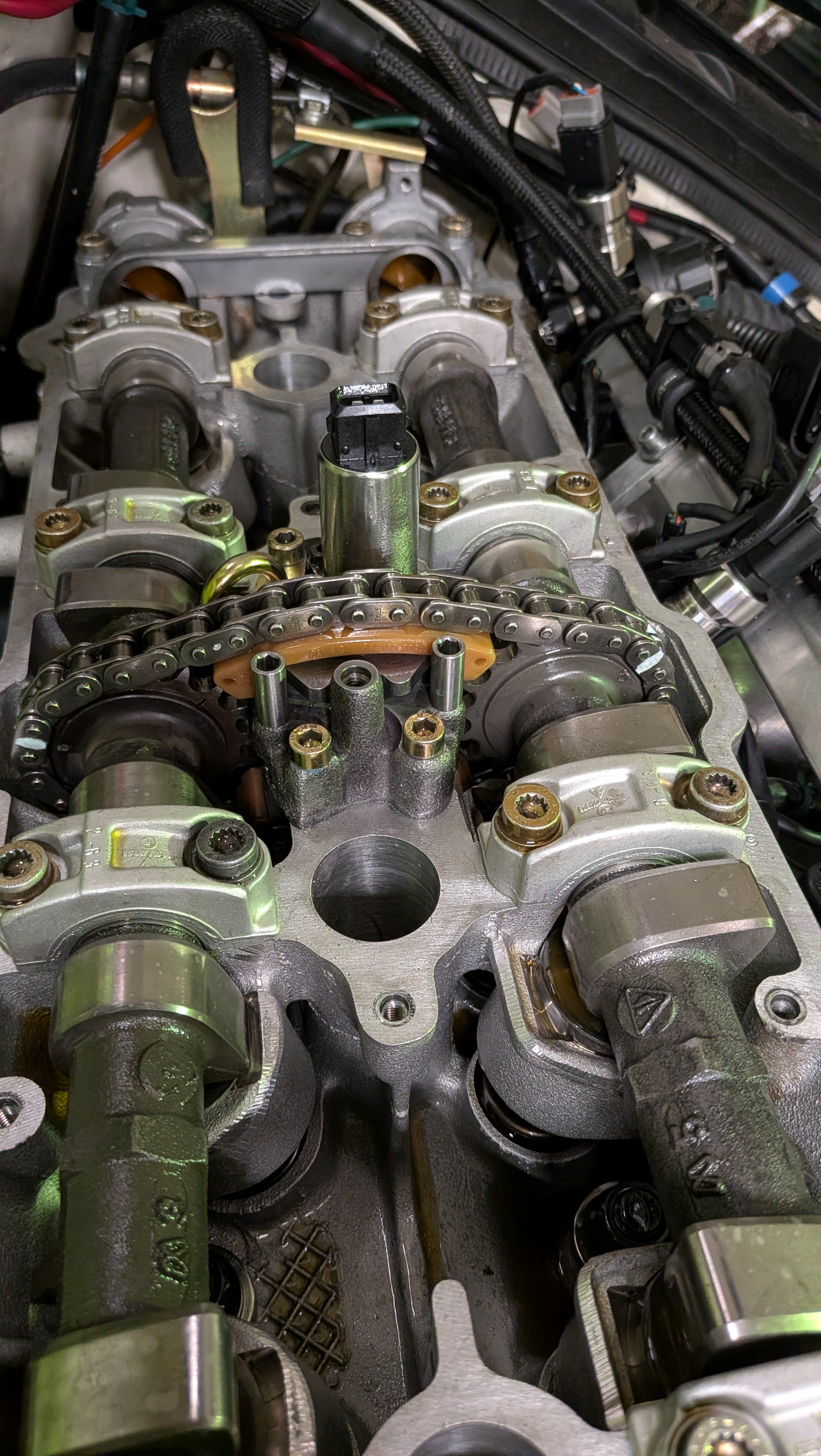

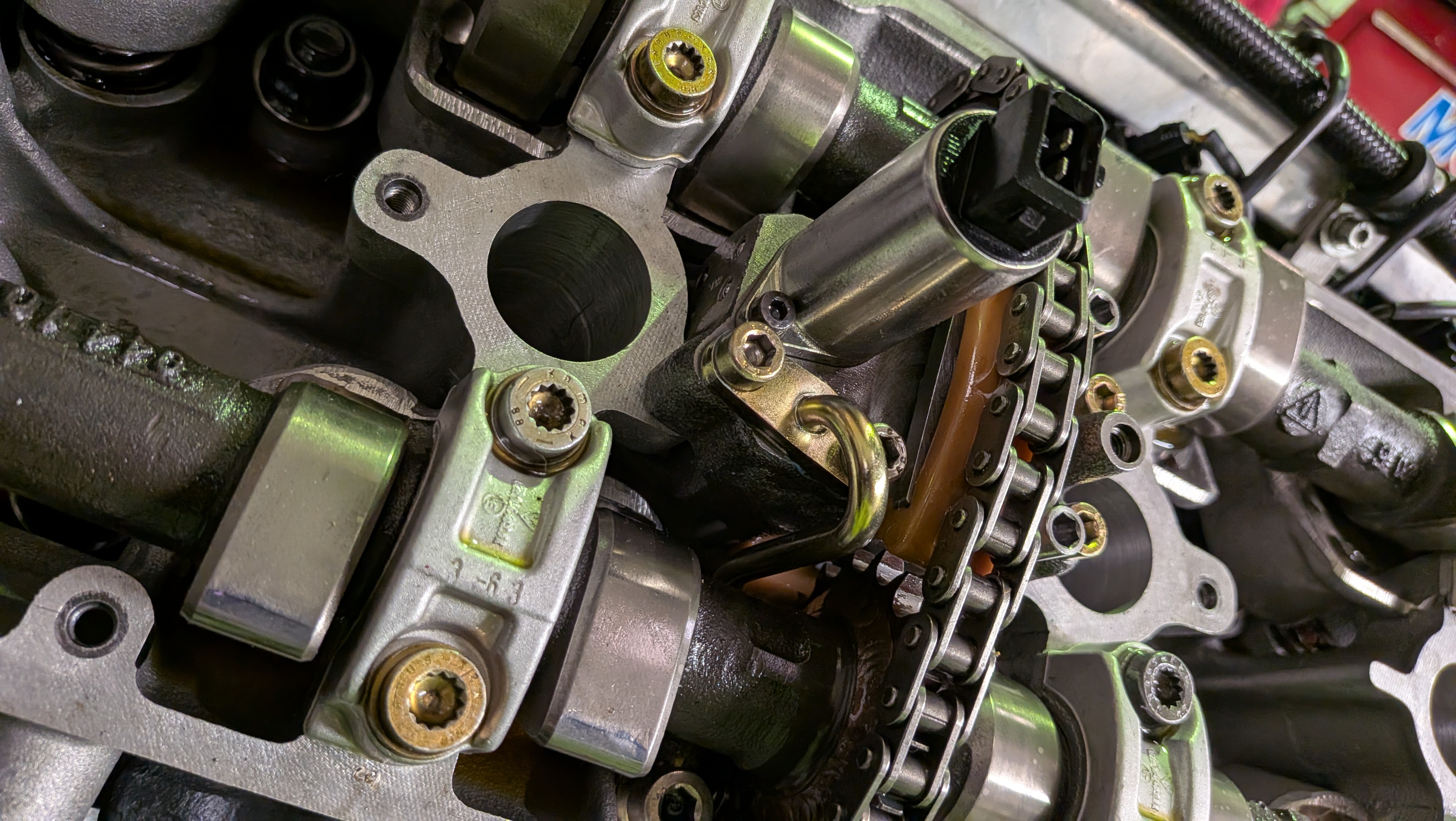

Weve changed the tensioner for a refurbished one and replaced the feed tube/check valve for a new one, didnt fix the issue unfortunatly. At a loss what it could be now. Only happens at idle when its hot so its not lifters, sound disappears with revs.
Oil pressure is on the low side when its hot (1.5bar), I put a new pickup in when we built it and we checked the balance shaft timing was still good so I doubt its cracked.

1.5 bar at idle seems very low. I do not get less than 3 bar in the warmest weather (Motul 300V 15W50 currently). What oil grade do you use and how hot does oil get when you see 1.5 bar?

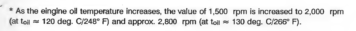

A factory documentation explains that the tensioner is not energised when oil in the head exceeds a certain temperature (as measured with the sensor specific to the 968 head). I can't remember the triggering temperature though but IIRC it's quite high, perhaps 120°C?
Anyway, does the rattle change depending on the tensioner position?

Im running Mobil 1 15w-50, from memory oil temp was around 95degC. TBH 3Bar seems high? I remember my car dropping under 2 at idle with the old engine, there is no issue with pressure at 80degC/5000rpm, its well over 5bar.
Its never deactivated, the trigger point just gets raised It seems to disappear when the varicam is activated @1500rpm, Ill have to see if changes with it deactivated. The car wont idle with it activated at idle so its hard to tell if that makes a difference.

Sorry, yes, this is the doc.

Is that only measured on the dash gauge? It fails high so I dont trust it completely, all my measurements are a from sensor feeding straight back to the ECU.
I had a look through the manual again and the spec for idle is 2.5bar @80deg C, looking through my logs Ive had values between 2.2 and 2.8 depending on the rpm, highest temp Ive seen is around 100 where it drops to 1.5, definately a case for better cooling.
The check valve effectively traps the pressure the variocam was deactivated inside the unit at as rpm drops, perhaps a good test will be to raise the trigger RPM when the noise is occuring and see if deactivating at a higher oil pressure resolves the issue.
