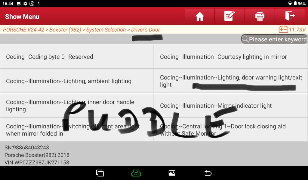

I’ve ordered a pair of door puddle lights to fit shortly and though I’ve ‘searched’ but haven’t come across a mention of coding the activation of door puddle lights with X431,
or I’m wondering if they can only be ‘activated’ with PIWIS if anyone knows please?
Note:
Found out the answer and it is yes, though I’ve yet to install and do the coding but the coding is as in this pic:
This is drivers door, then also do passenger door, I’ll add pics once iveb8nstalled and working
718 Coding using Launch X431 tool
