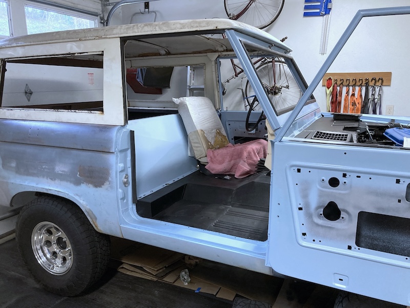

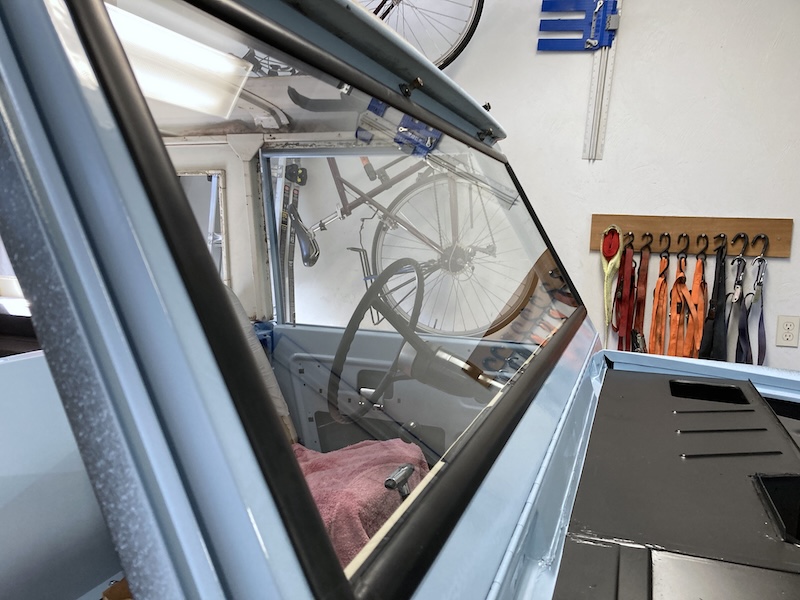

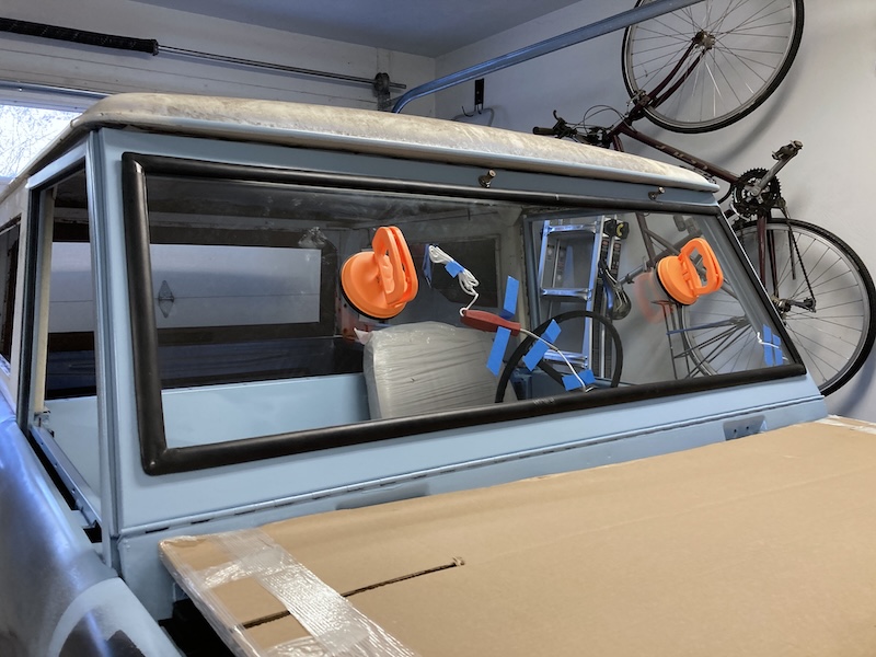

Since the last episode...
All the odds and ends have been painted, and I think I have finally got the carb dialed in. Yesterday I installed the windshield, cabin bulkhead (freshly painted) and a driver's seat belt. Will start trying to make the hood reasonably straight and presentable next.

Re: Arne's non-Porsche projects - Now a 1969 Bronco
Posted: Sat Mar 28, 2026 10:24 am
Arne2 wrote: Sat Mar 28, 2026 9:54 am Since the last episode...
I saw one of these on the road yesterday and thought of you. They were cool SUVs before SUVs were cool. :) Love the flat windshield -- Lowes cuts glass to size, just say'n... :lol:
Posted: Sat Mar 28, 2026 11:03 am
by Arne2
Tom wrote: Sat Mar 28, 2026 10:24 am Lowes cuts glass to size, just say'n... :lol:
Yeah, but it's not laminated. This new one is.

Hood was straightened, reinforced, cracks in edges welded, then installed with hinge shims to adjust the fit. All rear spring bushings replaced. Top removed to ease access to plugging up the hole in the roof from a cheesy, leaking, and broken old sunroof. Final fitting and welding yet to come.
