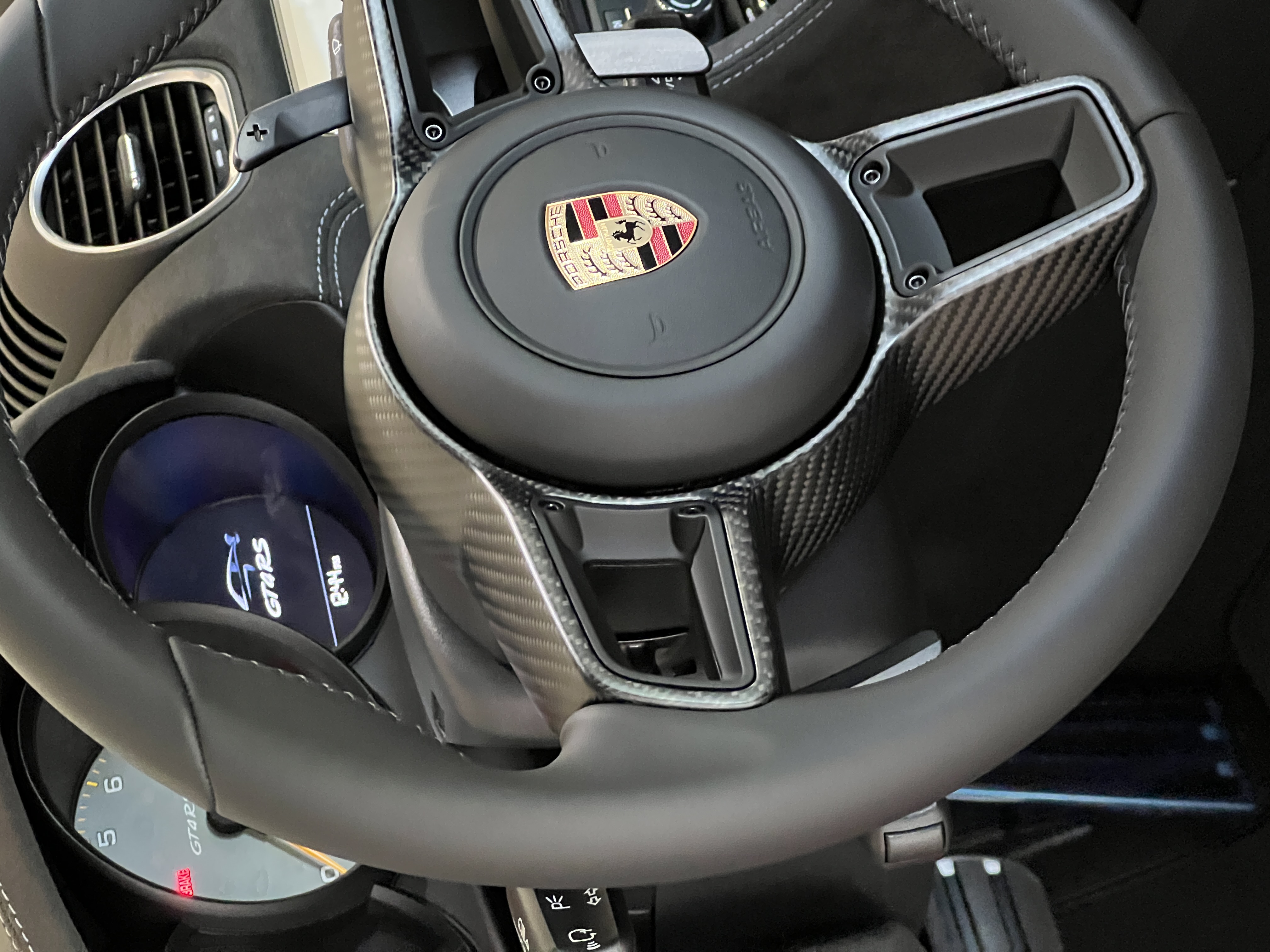

Helped a friend install some JCR aluminum paddles in his RS.
