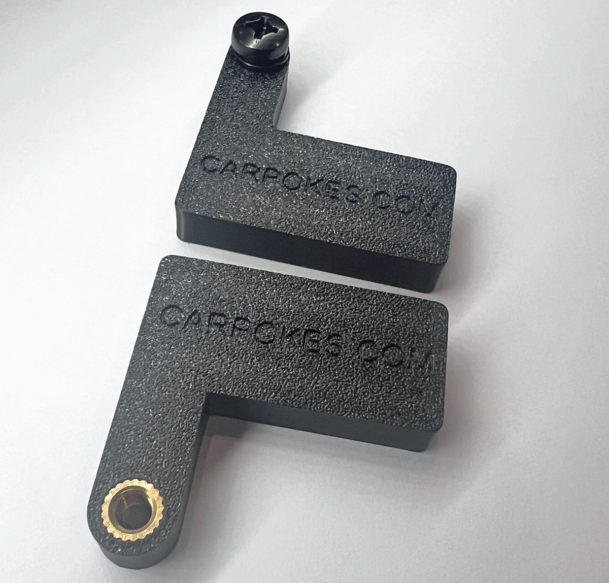

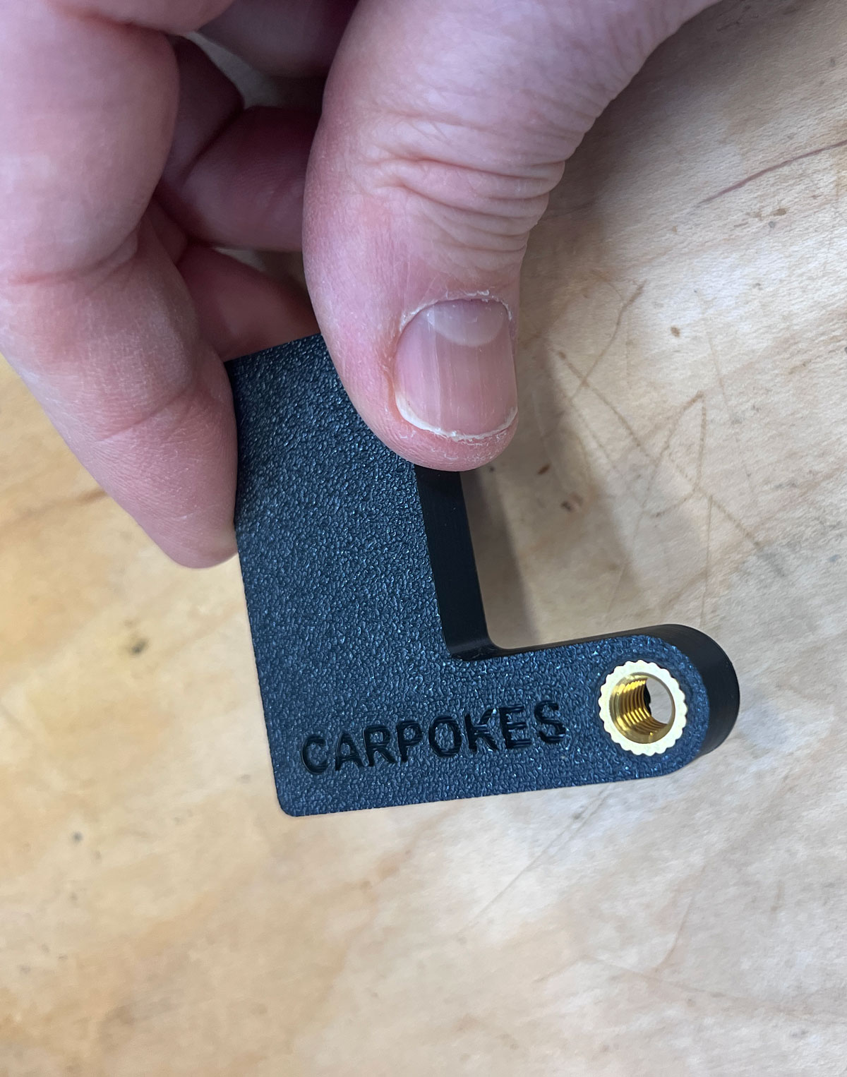

I originally 3D printed all my license plate mounts, and they worked great, but they looked like home-made 3D printed parts, had a high failure rate when printing, and took hours to print. I turned to CNC machining to get a professional look and, importantly, to speed up production. The downside of CNC was cost, which started out high, but manageable. That price has unfortunately more than doubled since the first batch and I didn't want to just keep raising the price to the point where no one wants them (and I wanted to keep production here in the US).
So.... I've been exploring options and think I've come full circle back. FDM printers (the most common) have made some quantum leaps in technology lately, and I'm honing in on a process that can match or exceed the appearance and speed of the CNC process, at a fraction of the cost. See the prototype below. This is done in ASA plastic, which is a close cousin to ABS, but holds up better to both UV exposure and heat. Most of the magic is in the new Bambu Lab X1C printer. Not sure these pictures do it justice, but it looks like a factory-made part that most people would never guess came off a printer. I'll keep honing the process, but I'm fairly sure I'll be moving to mounts like these in the near future.

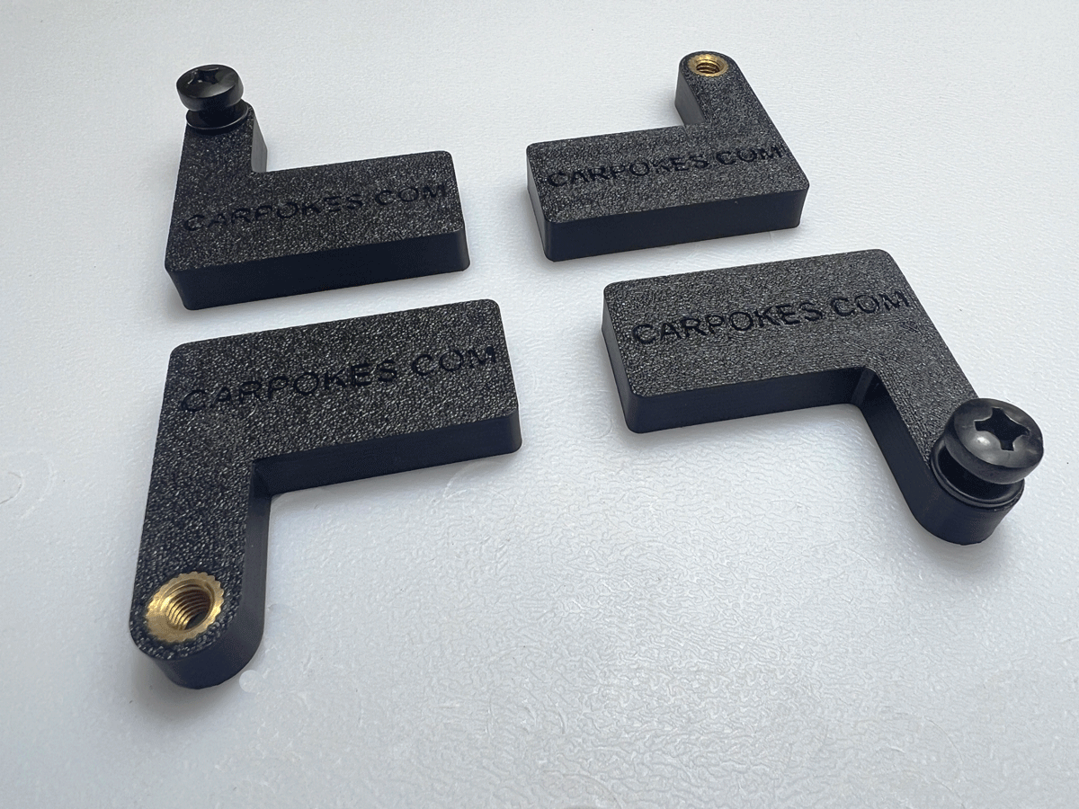

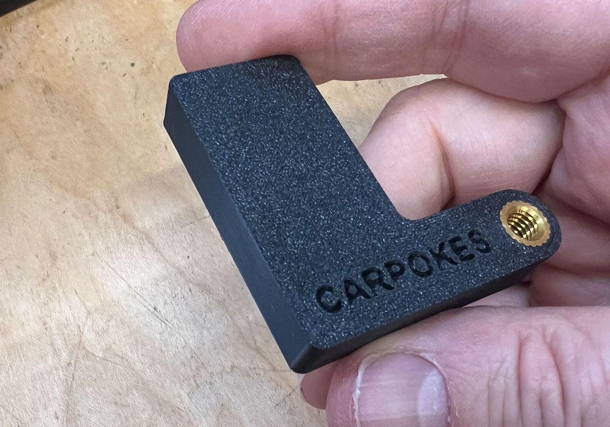

Just FYI, I've updated the mounts again -- in my never-ending effort to keep quality up and costs down.
When I first started making these, they were 3D printed in ABS plastic, but 3D printing at the time proved to be too slow and unreliable to keep up with demand, so we've been having the mounts CNC'd for the last few years. But since that was getting so expensive, we recently invested in some of the newer 3D printing technology and are happy to report we'll now be making the mounts 'in-house' again. No changes in the design, they still work exactly the same -- this is motivated purely to keep quality up and costs down. That said, I'm very please with the way these look and work!
Best part is I can avoid a price hike this way!
