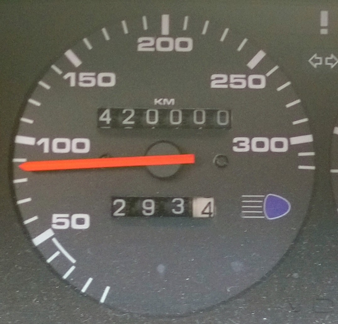

Had to use the car yesterday for a 600 mile drive and can confirm again the improved smoothness and torque response down low with the larger turbine housing. Again it is a subtle improvement but there is less downshifting needed from 6th to 5th when going slightly uphill on the highway. Fuel consumption is at an all time low with 30 mpg. On a very short section of destricted Autobahn in Germany I couldn't resist applying a little load in 5th, perhaps opening the throttle 30% only and found myself at 150 mph in no time. I can't remember if I mentioned vibrations in the rear axle I experienced last summer during high speed cruising in Germany but the guy during the technical inspection 2 weeks ago noticed the bottom bolts for the shocks had loosened and the lhs one was a few threads away from coming out! No idea how this could have happened and I plead guilty to spending way more time checking out anything in the engine bay than the rear suspension, but it seems that retightening them has fixed the vibrations and the car now feels like it's on rails back again at high speeds. Too bad I had to drive back home and I'm looking forward to more high speed cruising to experience more of it. This will be even more of a monster cruiser considering how effortless the engine feels even at low to medium loads - with the increased flow of the 1.03 turbine housing the engine can properly "talk".
Crossed the 420,000 km mark too. Such milestones are always worth a picture. With 30,000 km in 5.5 years the 16V is engine is probably broken-in now.
