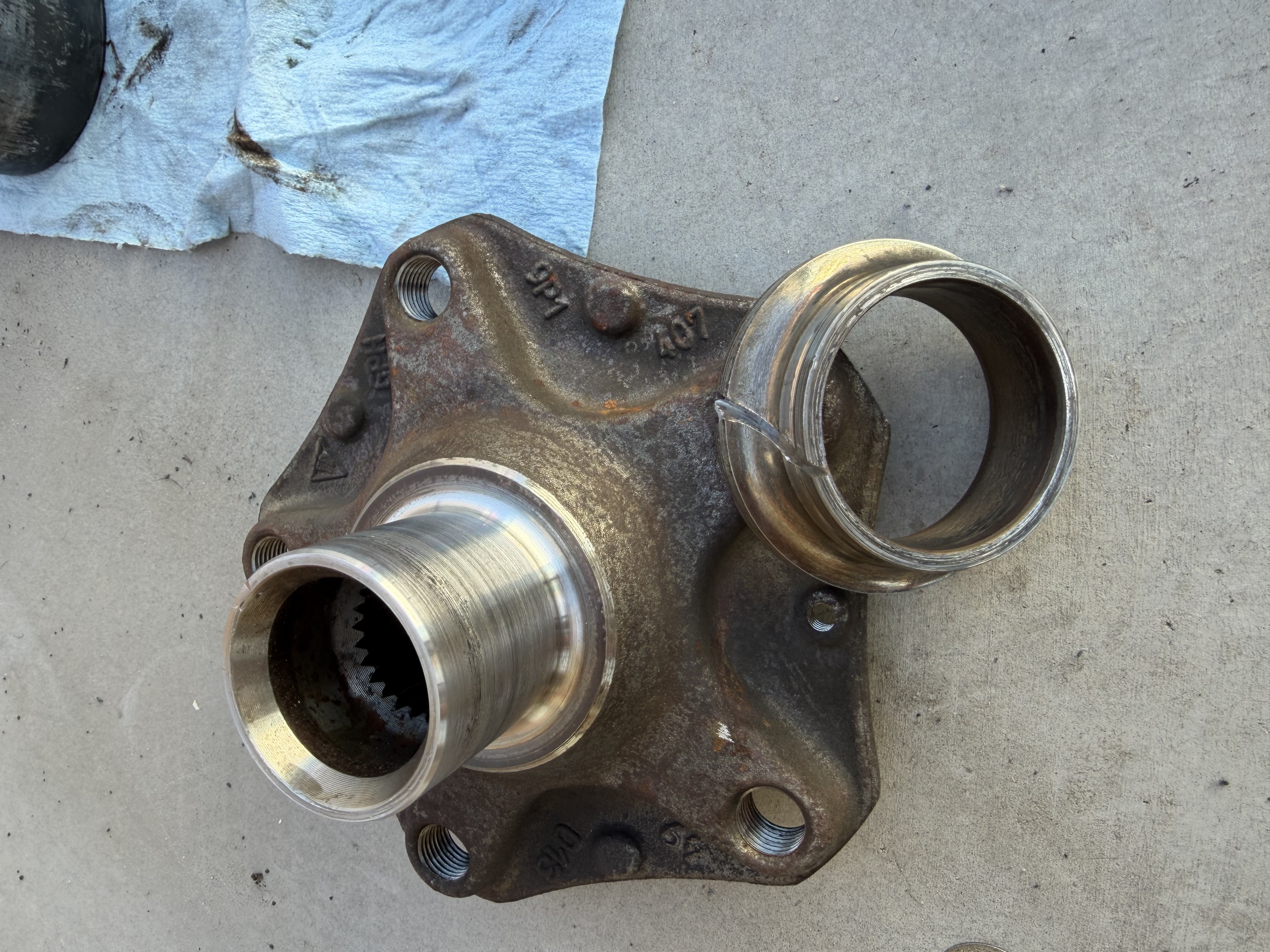

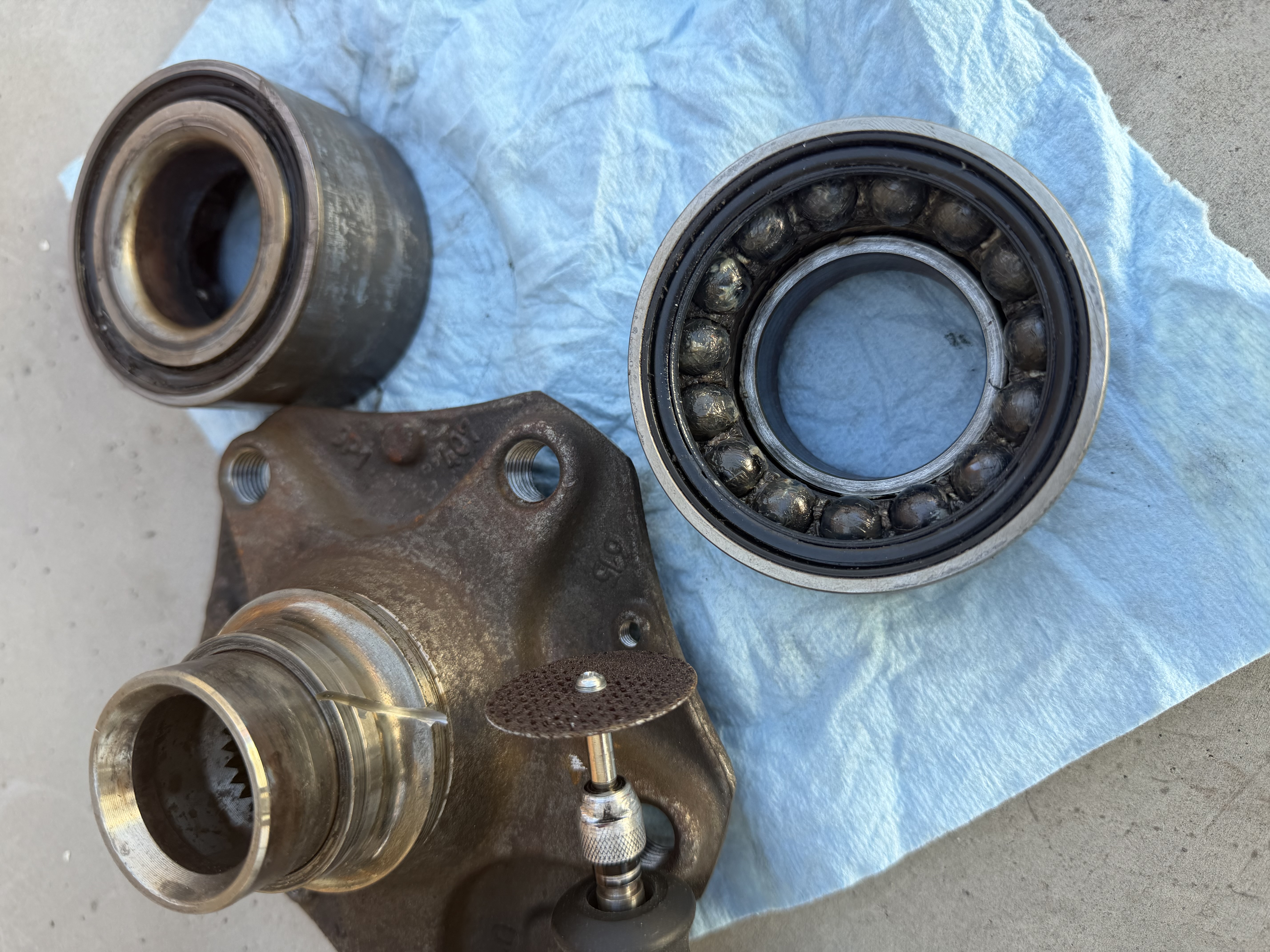

Each wheel uses one large dual roller style of bearing. The fronts are very similar and the same process applies.
Shown below one sides flange and both of my wheel bearings, one pointing up and one down to show how the race from the flange will go into the bearing.
After you have used the slide hammer to remove the flange from the hub bearing you will be left with this inner race stuck to the snout of the hub.
I used a dremel tool with a cut off style abrasive wheel to cut a nice slit in the race. I then smacked the slit with a chissel to crack the race and then pried the slit open with a screw driver to remove it.
