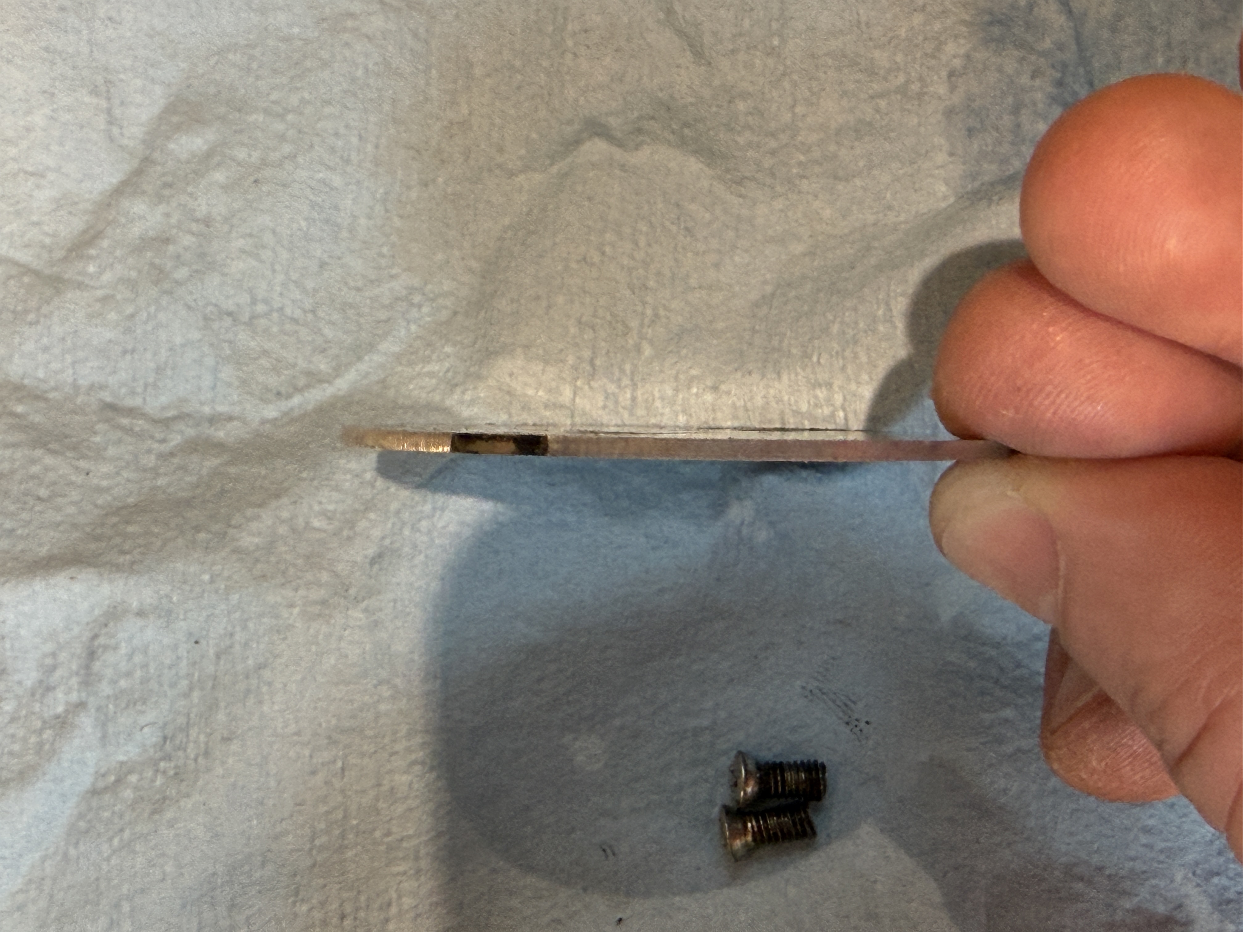

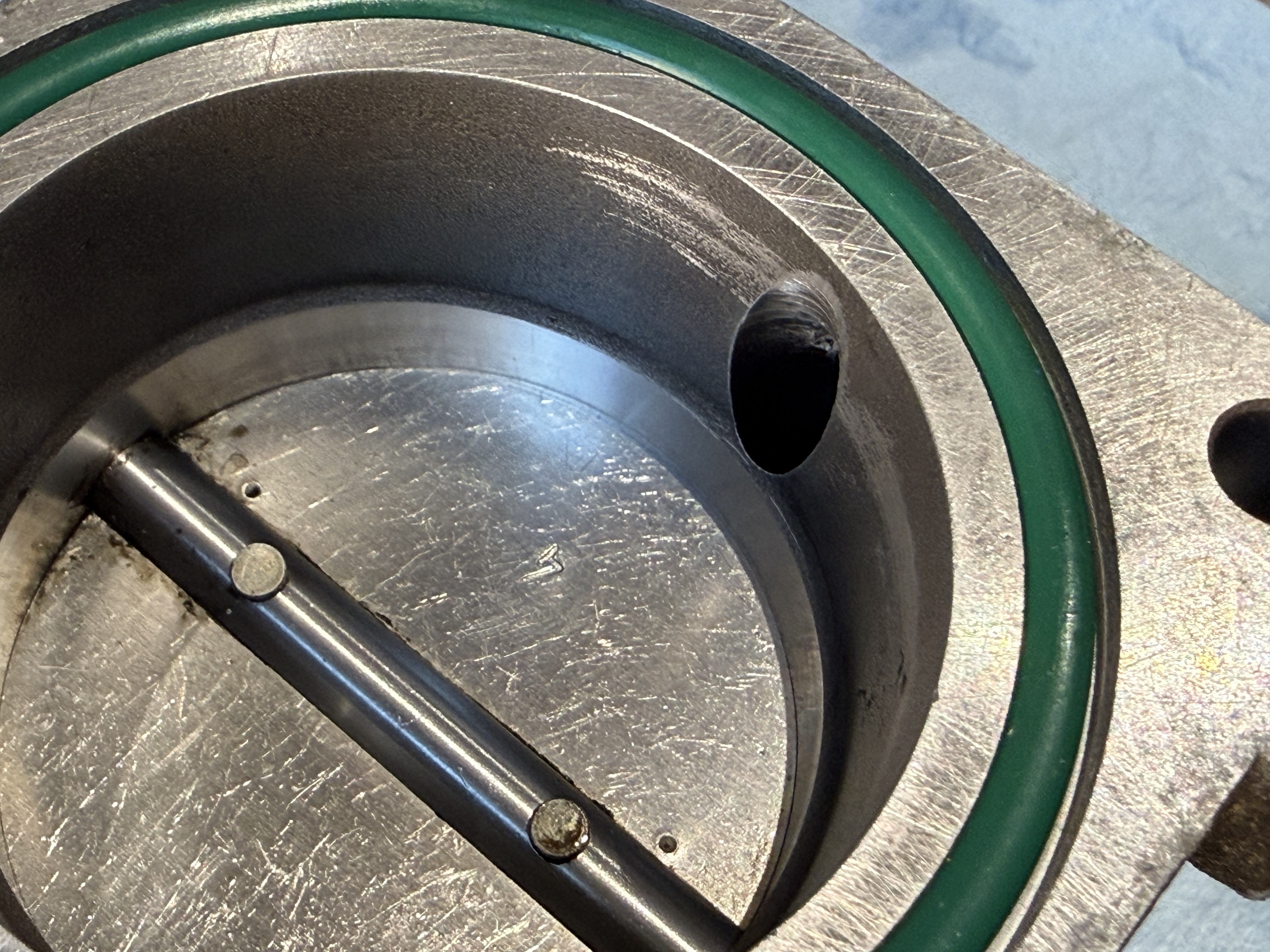

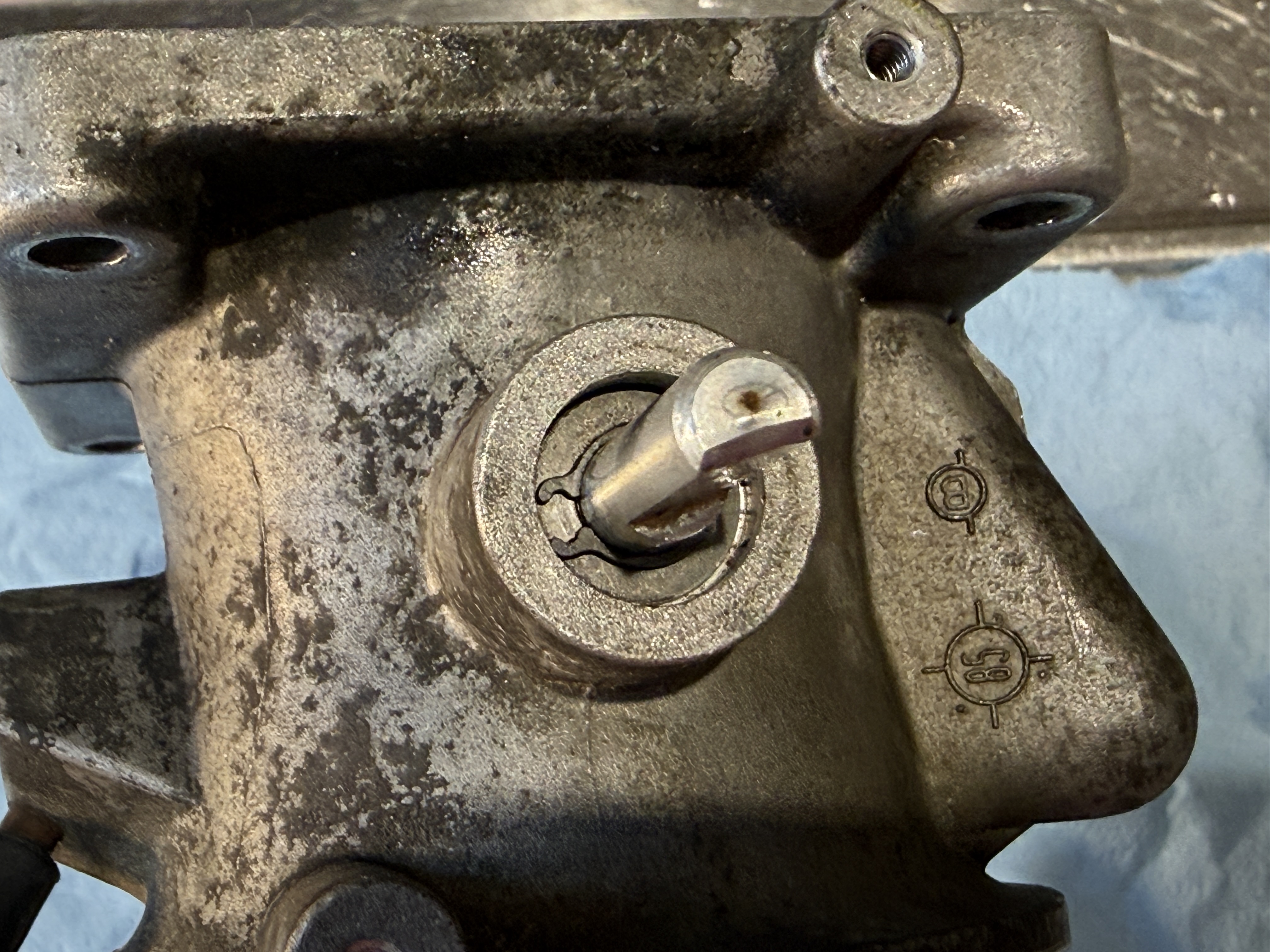

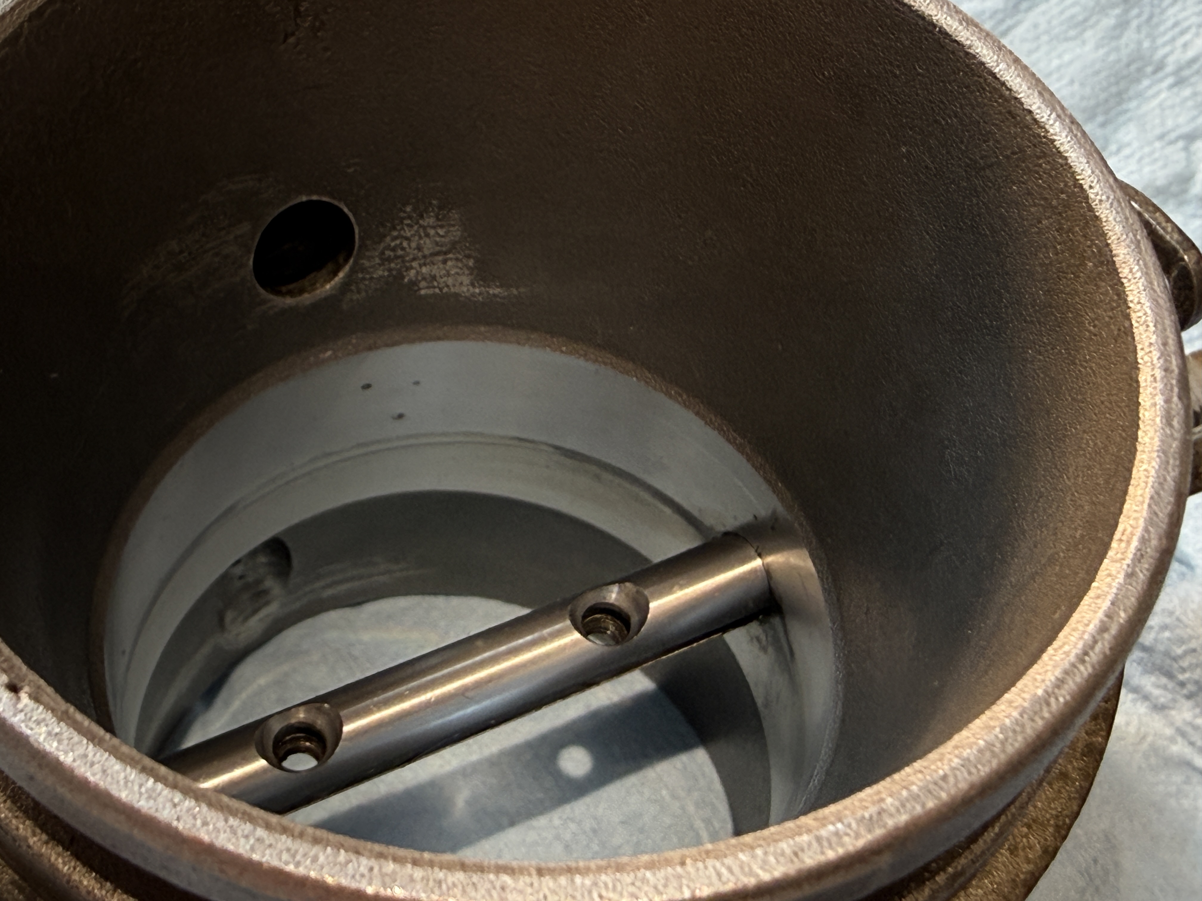

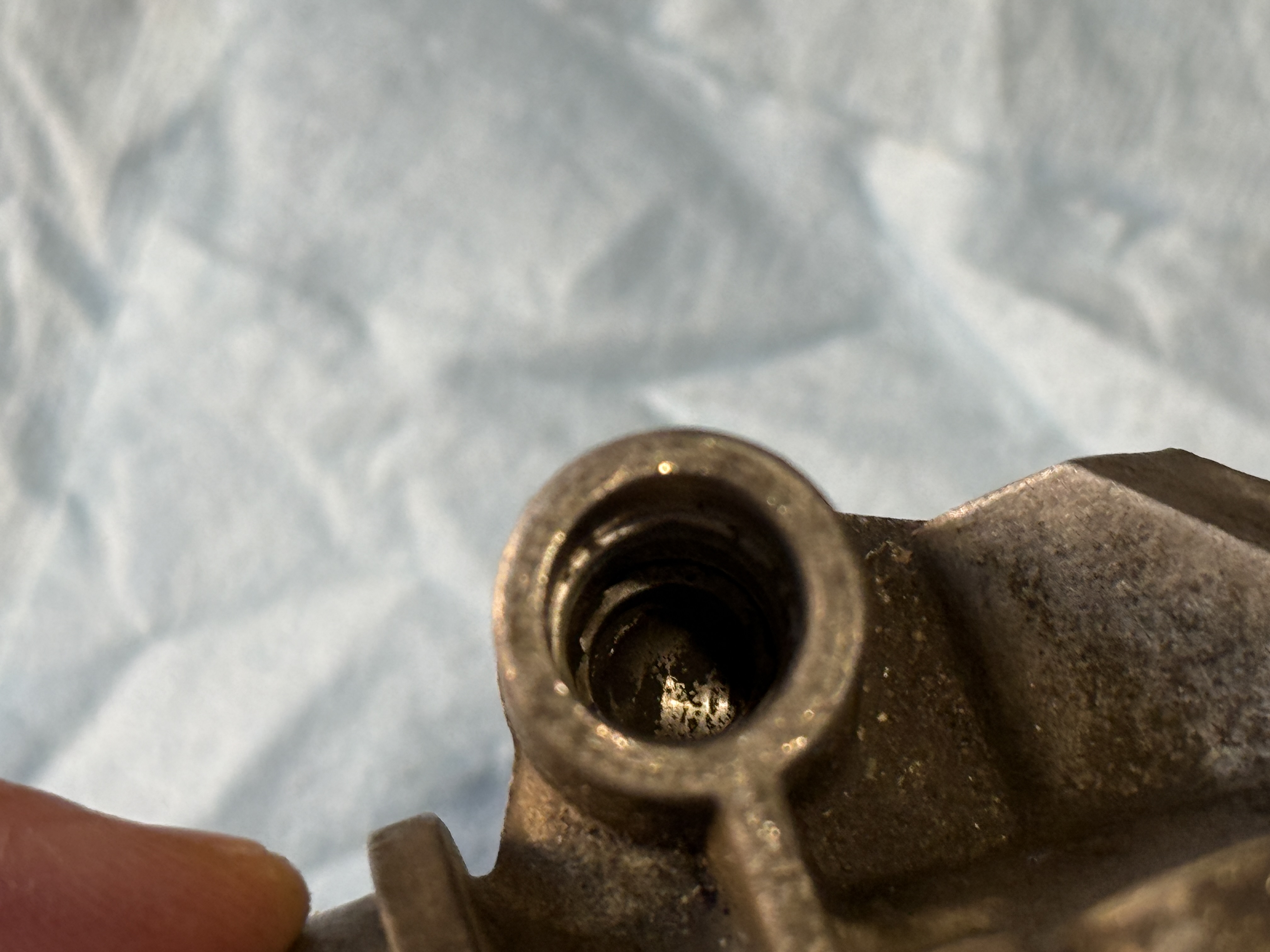

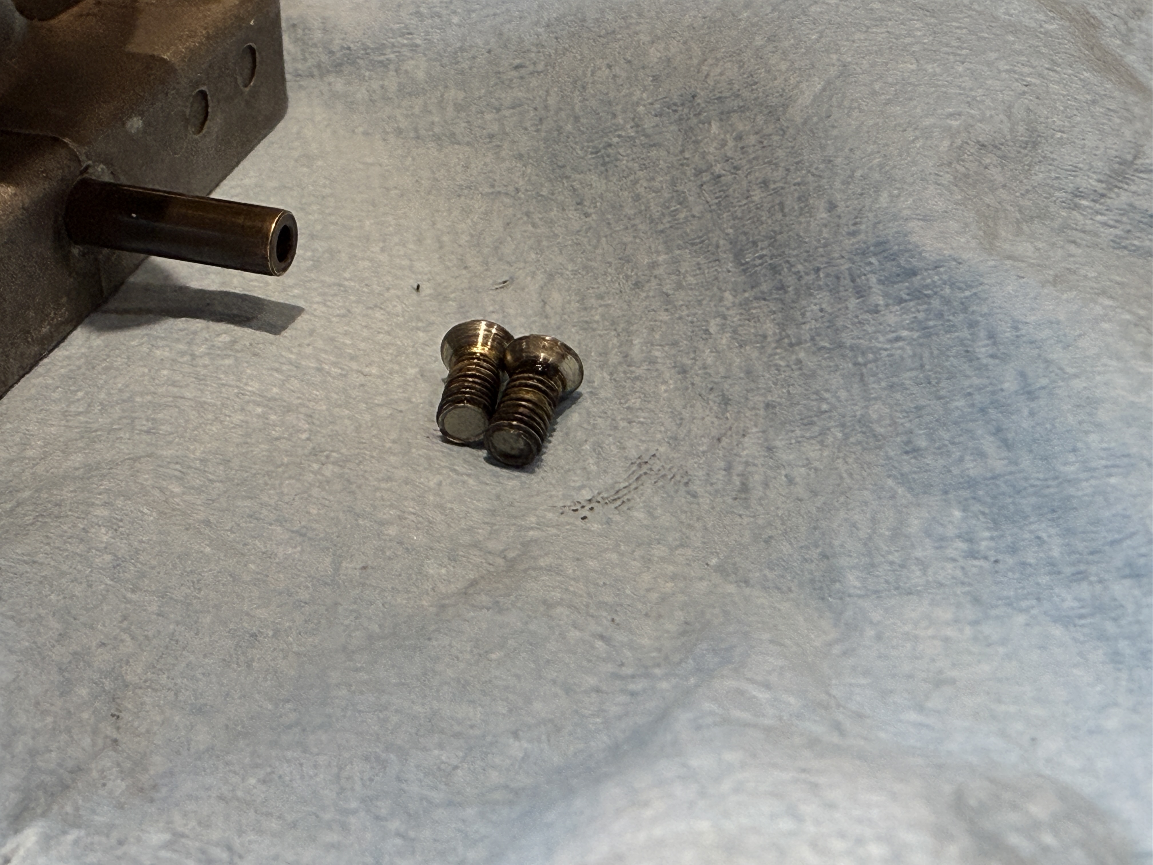

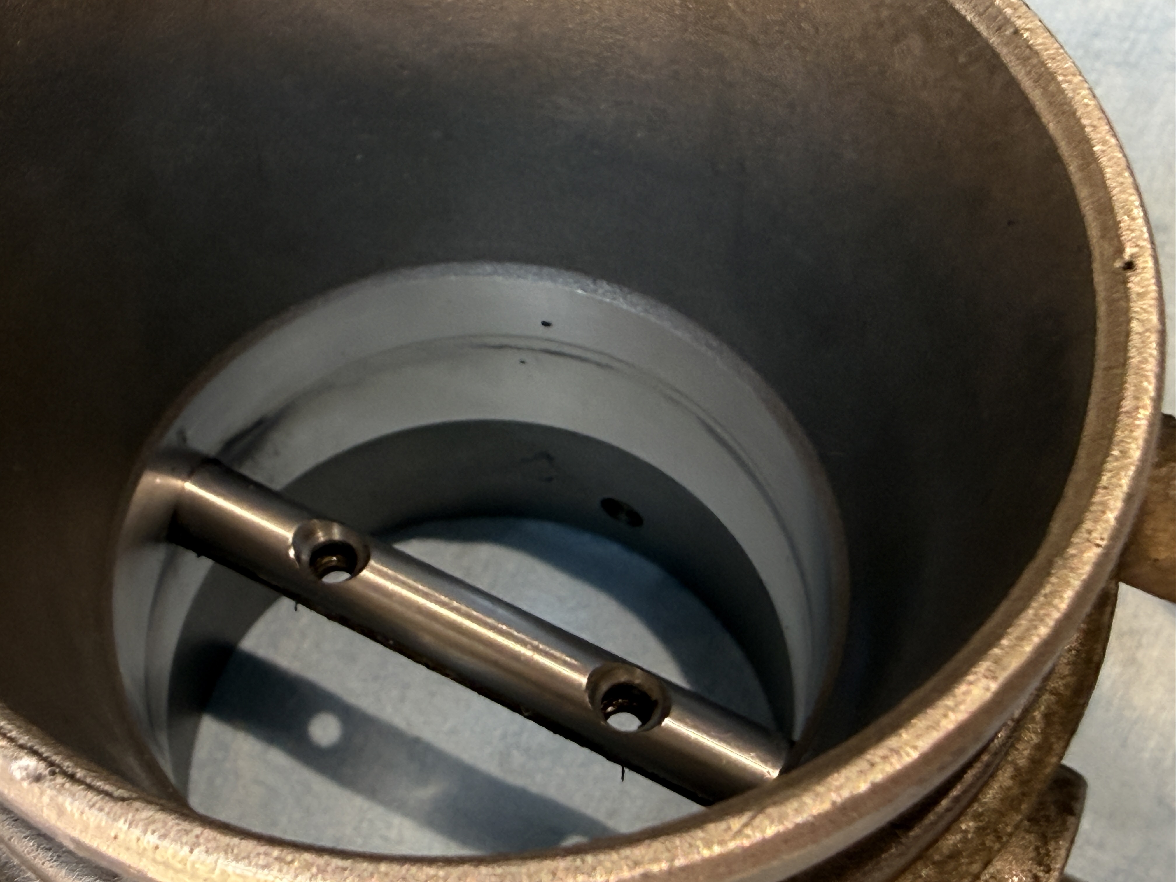

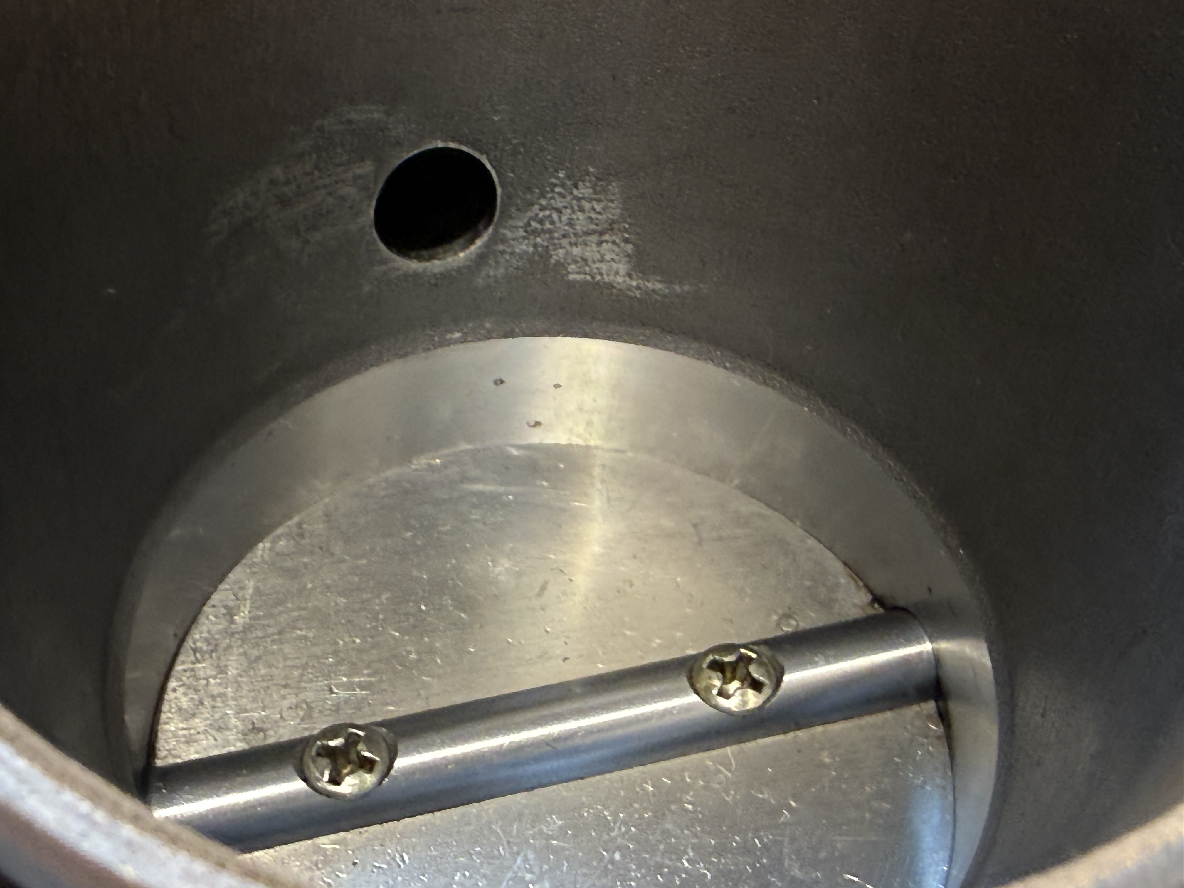

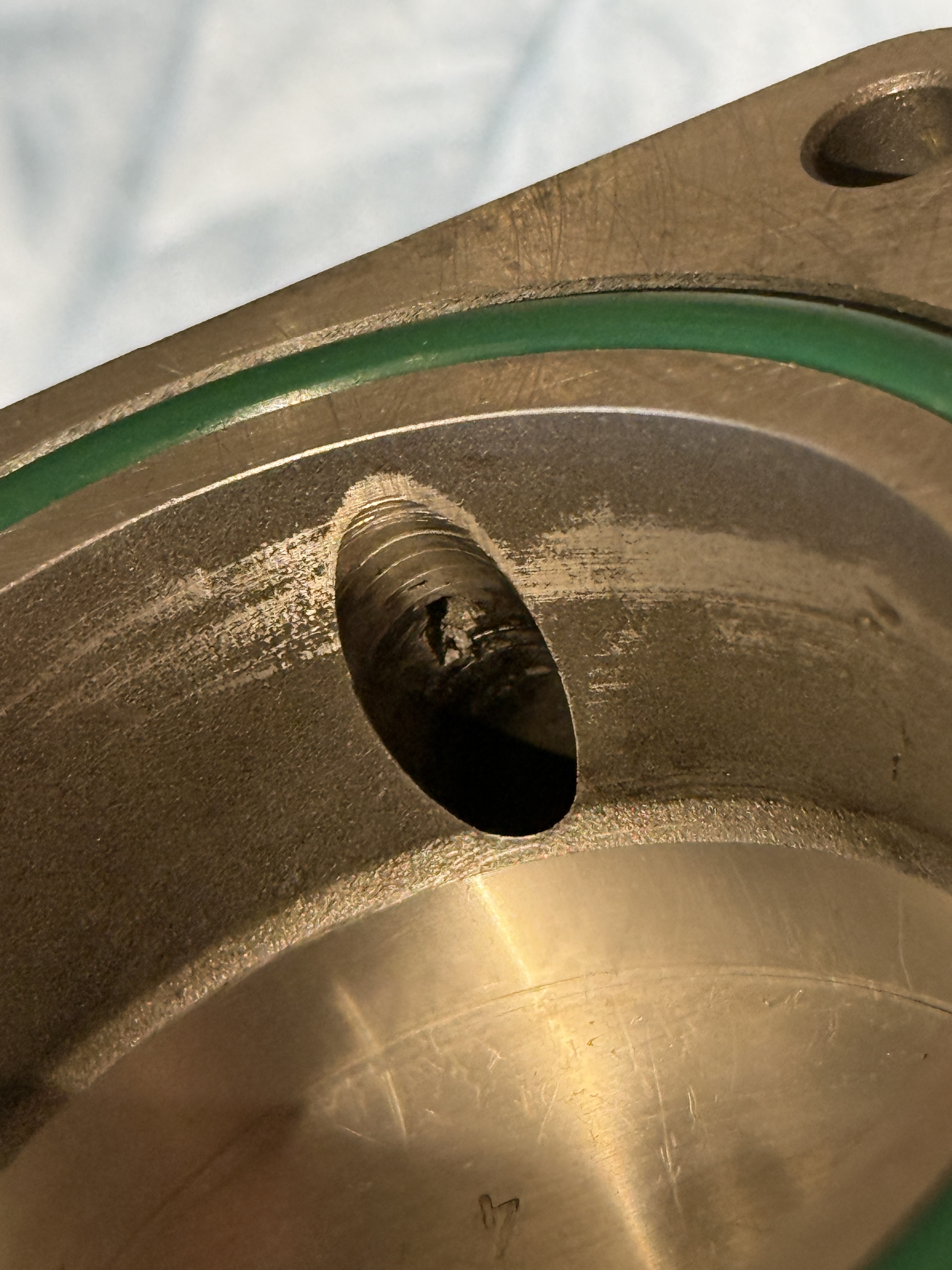

Took a look at my original throttle body. Aside from the plate, the only other interesting damage is inside the throttle bypass bore, which looks like metal fatigue, wonder if this engine ate those bits at some point...
I was able to unscrew the plate screws without any effort, they were not peened...
The plate is aluminum. I flipped the orientation so that the 4 is facing outward and reinstalled the screws. It operates fine. Very little gap. However, my replacement is overall nicer.

Regarding TB plate material, I've come across primarily brass (with the #4 front facing), but also have a few turbo TBs that have flat aluminum, as well as dimpled aluminum plates - interesting.
Also, I have two NOS NA throttle bodies still in the box... I will get them from storage, but I've not seen internal damage as you listed in the previous posts.

Interesting. I wonder why some have dimpled aluminum plates. Do the ones you have with alu show the "4" facing in(manifold) or out?rheidtman wrote: Thu Nov 27, 2025 7:20 pm Regarding TB plate material, I've come across primarily brass (with the #4 front facing), but also have a few turbo TBs that have flat aluminum, as well as dimpled aluminum plates - interesting.
