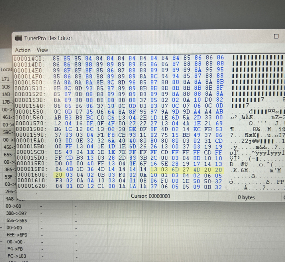

You guys are awesome! Thanks for that info. For whatever reason, I just tried that on my car and the idle didn't budge. I scanned the BIN and that was the only location I could find (0x5F9 to 0x600) with that exact string of numbers. I bumped all three up to 18, then 20, and got no change to the idle at all. (I 'commit change' in the hex editor, then 'upload bin to hardware' to get it in the Ostrich, which seems to work for other edits.) Wondering if APE did something else in their file that overrides some other constraint. There is also apparently a Euro BIN with and without O2 closed loop, and logic paths that change within both the Euro and North American BINs based on the country code, so quite a few variables I guess. If you can control idle with map edits on a 24-pin chip, however, that would seem to say the idle RPM is not hard-coded into the ROM (or lower half of the 8k chips). Do you know if you have the country code plug shorted in your car @Dave W. ?

The work will be tedious and time consuming, but the way I did it was by searching for every instance of '13' in the code, then looking at the number following the '13'. If the next number was 02, 03, 04, 05, or 06 then it was most likely a coolant temp based table. I found 20 tables with this method. There are several instances where 13 was followed by a high number, which is some other code that I wasn't interested in.
FYI the other tables I found that use coolant temp are startup enrichment, startup ignition timing adjustment, ECT running enrichment, ECT timing adjustment, Accell enrichment, ISV base values and more.

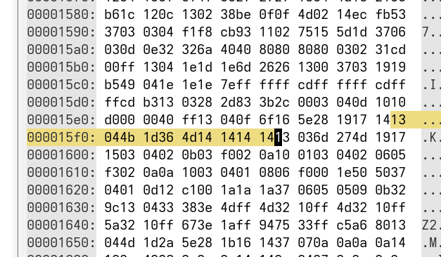

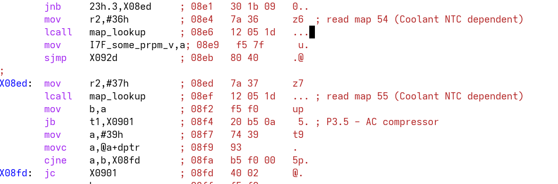

There is another NTC-dependent map of rpm values that's used as an alternative to the one Dave W. used, but I don't know what controls it:
The values are all set to 14 (800rpm)
There's a flag 23h.3 that determines which of these 2 maps get used, but I don't know what that flag represents:
Tom maybe your car is using this one and the extra 40 you're seeing is being added by some other process.
EDIT...I think the mystery flag 23h.3 is altitude related but I'm not sure.

I took a 24-pin APE BIN and copied it into the upper 8k of a stock 28-pin BIN just now. Car fired right up, but changing that idle map still didn't do anything. I'll try the map before it with the 14's next...

Success!! You guys are awesome. Thank you, thank you! The string of four 14's starting at 0x5F5 did the trick! I was able to take the idle up to whatever I wanted by increasing those 14's. I'll try changing it with temps too once the engine cools down, and suspect that'll work too. I'm doing my own XDF and will post it here on CP when done, so this will be a great addition! Seriously appreciate the assist, and for what it's worth, you guys are way smarter than ChatGPT. ;)

I can't think why Dave's idle moved based on that 3-cell map, and mine didn't. If APR somehow pointed idle to that map, why didn't it work when I put the APE map in the upper half of an 8k chip? Different APE 24-pin image? Different programming code in the internal 8051 ROM vs the 8k chip?

13 05 * 6C 19 1F 1D 31 followed by 5 rpm values. The RPM conversion is still the same, just multiply by 40. The coolant temps convert to: -23 106 136 174 208
