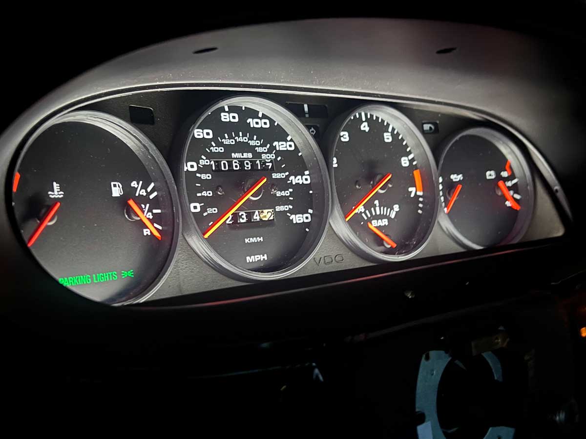

Very much still working on this -- mostly the lighting. I'll share details this week, but it's based on a different approach and has some cool features.... 8-)

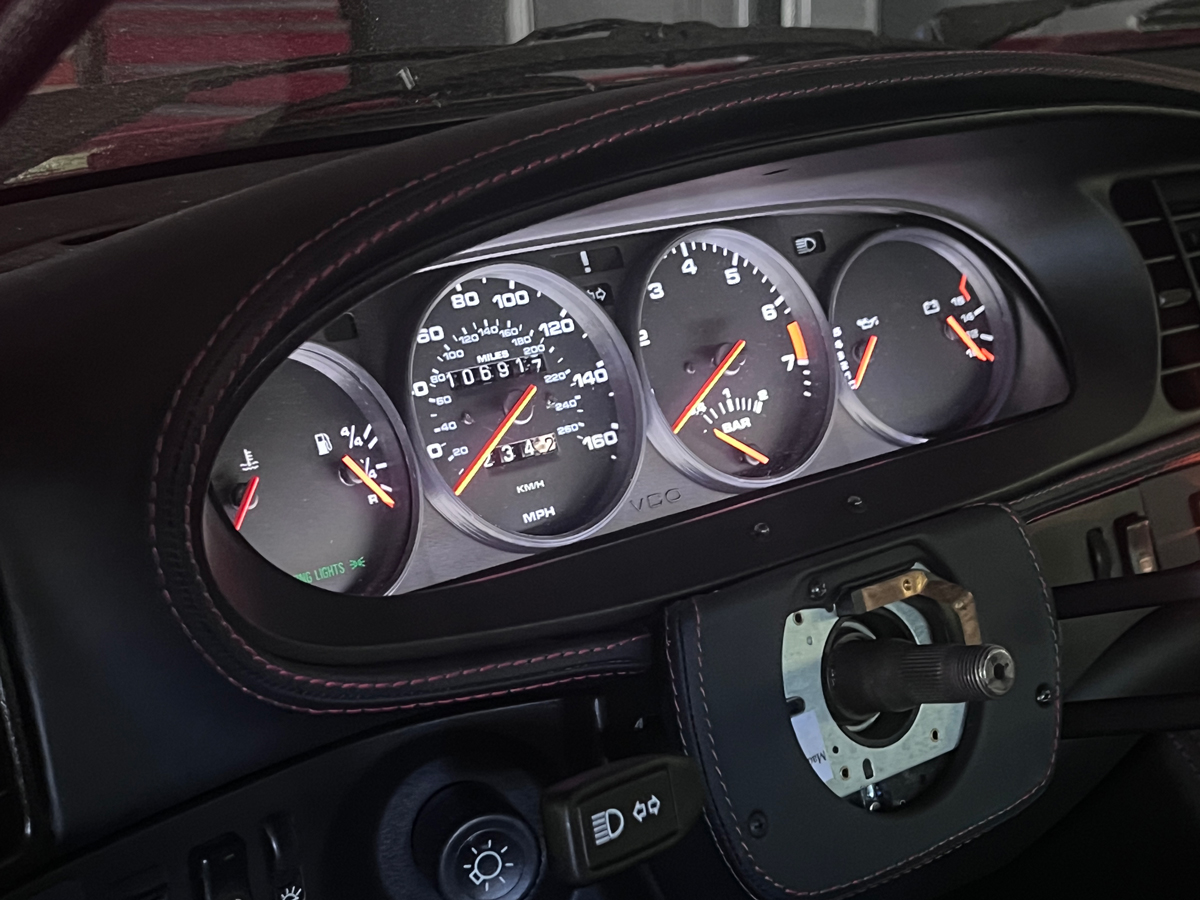

Pictures look the same, but I've addressed some issues with the LED kit and am getting very close to releasing these. Should be this week. Will take me a while to make each set, and pricing still TBD, but I'm planning to release the Gauge kit with the anti-reflective lens and LED kit as a package. If there is sufficient interest, I mayl post the STLs for the gauges for those who want to print their own and use normal acrylic lenses without the LED kit, etc.

cp99 wrote: Sat Oct 28, 2023 6:50 pm Love it. Any way to make the rings in metal? And is there a “softer” light temperature LED, such as a 2700-ish kelvin, that can be used?
The gauge rings are 3D-printed in a low-sheen ASA plastic. Once I finish this kit, I still plan to work on a more Singer-like gauge set, which would need metal to look the part. Machining them is a possibility, but I fear the price would get out of hand fast. Looking at the possibility of metal plating the plastic. As for the lights, the LED's in the pictures are 6000k, so very white, and set to max brightness. I have to say in person it looks great to my eyes. I can also use 3000k LED's for a more vintage feel -- will try to get some pictures of that too. Although the factory dimmer 'works' with the LEDs, it does not offer a very big range of adjustment, so I added a hidden trim pot that allows you set the base level of brightness wherever you want, which can then be turned up or down with the factory dimmer. :thumbup:
