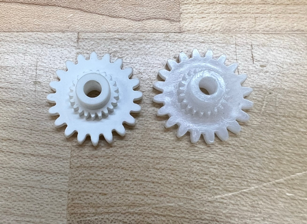

Yeah, let me know. More than happy to make a 968 version while I'm at it. In the meantime, I made tiny little adjustments to the model (shortened it by 1/10mm so it didn't press on the c-clip) and printed it in the fancy "Rigid 10k" resin at 50 microns. I'm blown away by how nice this resin prints. To the bare eye, these look like they came out of a plastic mold -- the detail is awesome. See pics below. The nylon one on the right is from eBay (E30 products) and the one on the left is 3D printed. Fits and works like a charm, so I have it running on my bench cluster now -- I'll let it run a few thousand miles this time before I call it good, but pretty sure this will bring the price of 944 odometer gears down to a dollar or two. :)

Holy cow that looks good, @Tom !

That looks great!
