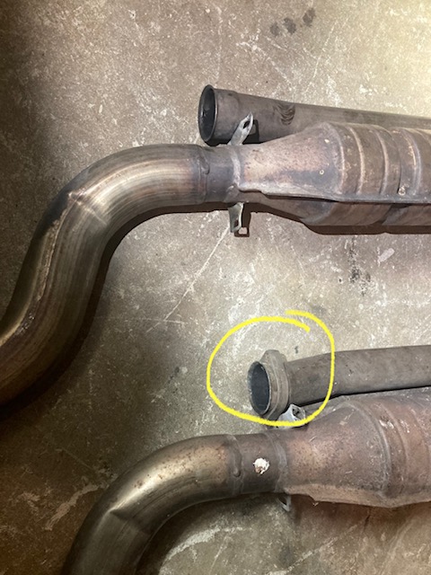

Speaking of catalytic converter design, I have two stock cats here and one does not have the 2-bolt flange that connects to the wastegate pipe (circled). Did Porsche make two versions of these with different flanges?

Doyle623
Posts: 50
Joined: Sat May 21, 2022 5:24 am
Location: Fairmont, WV
Has thanked: 13 times
Been thanked: 7 times
Update, I was able to confirm that the previous owner cut off the flange...so they should all have this two bolt flange attached.

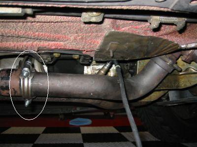

Sorry, I missed this question early. There were in fact two different types of flanges. On early cars, like my '86, it came from the factory with a small v-type clamp as shown in the first picture below. Both sides of the joint had a bell mouth that butted together around the donut gasket. Most test pipes were set up for the football-shaped flange, however, so a lot of people ended up cutting the bell-mouth off the wastegate dump tube so they could use it with the newer style cat/test pipes....

Doyle623
Posts: 50
Wow, thanks Tom, I did not know these existed. I checked various dealer sites and are NLA, but Ian at 944Online has them for $103. Hopefully I can find one second hand, since I want to pop this cat pipe on and try it out (the one with the flange has been gutted).
