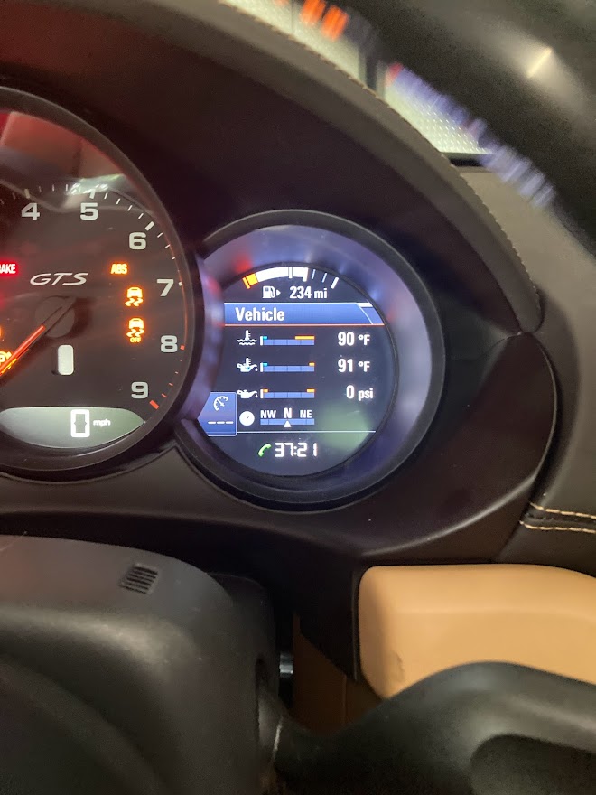

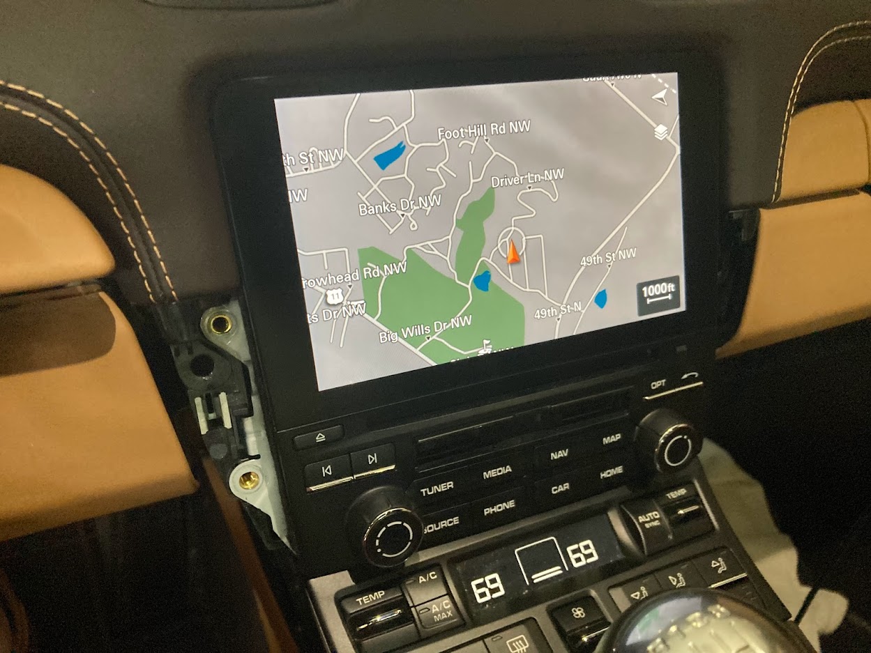

Success! We got back together today and downloaded new files on my SD cards, remotely connected my car to his PIWIS so the cluster was enabled, and I downloaded the Nav and Map functions and the map files on my PCM and everything is up and running just like factory. I'm like a kid at Christmas after so many hours trying without success. If you have any tech sense at all this thing is a breeze to install on your PCM.

Hi Bill, this is Phil. I am glad it is working for you. If anyone has any questions, please post.Bill in Bama wrote: Thu Jul 21, 2022 4:06 pm Success! We got back together today and downloaded new files on my SD cards, remotely connected my car to his PIWIS so the cluster was enabled, and I downloaded the Nav and Map functions and the map files on my PCM and everything is up and running just like factory. I'm like a kid at Christmas after so many hours trying without success. If you have any tech sense at all this thing is a breeze to install on your PCM. Cluster.jpgHome screen.jpgPCM map.jpg
