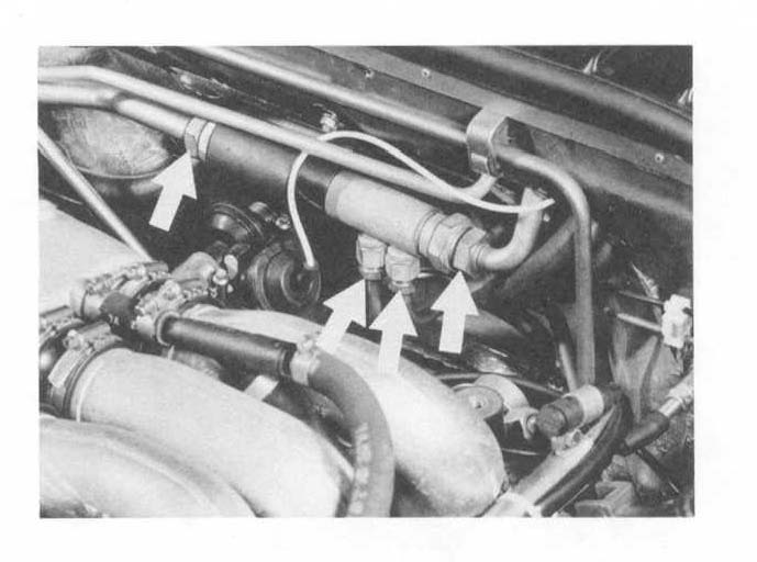

A picture or three would be great. I looked on Summit, and see that there are any number of radiator style fuel coolers, mostly for diesel, but any port in a storm...? I may also just try re-routing the lines under the hood so they are not being baked by the headers (Porsche's idea, not mine, and super fun when they leak).

Here's an image from the WSM pages, handy because the air cleaner blocks an actual camera view on the car. I'll get some better pics from mine when it's in the workbay. This one should give at least a concept to consider.
Rather than trying to add AC fittings and build leaky connections for same, I'd be more tempted to find some larger aluminum tubing, section it lengthwise, roll the ends so they fit closer to the original aluminum line OD, and then TIG the pieces in place around the existing line from evaporator/expansion valve to compressor suction. In the picture there are fuel return line connections shown together at one end of the outer shell. I have no indication of what might be used for baffles in that outer shell, so might look harder at having fittings closer to the outer ends of the shell. With everything in aluminum, the outer shell will transfer heat from the fuel and conduct it to the AC tubing from the ends, in addition to the heat that transfers directly from fuel to the AC tubing inside the shell.
For sure you'll want to insulate the fuel lines and the cooler shell, and probably do any other exposed sections of compressor suction piping from the expansion valve/evaporator anyway.
On the 928 anyway, the fuel injector rails over the heads were originally fitted with a foam layer and a cover to help diminish injector noises transferred to the rails. At my last injector cleaning session, I fitted some more insulation so it wraps around to protect the bottom of those rails from radiated heat from the cylinder head. It's adhesive-faced closed-cell foam in my case, with holes punched for the injectors and retainer clips to poke through. Tiny cable ties secure it. It's hidden pretty well, and might be noticed only if you look hard from a low angle. All with the idea o reducing transferred heat into the rails. The rest of the under-hood metal fuel plumbing is still factory-exposed, so I'm not sure there's a lot of benefit. But I felt I was doing something even if I can't prove a benefit.
Again, I'm not familiar enough with the 951 fuel plumbing to know if this is a practical option for you.
