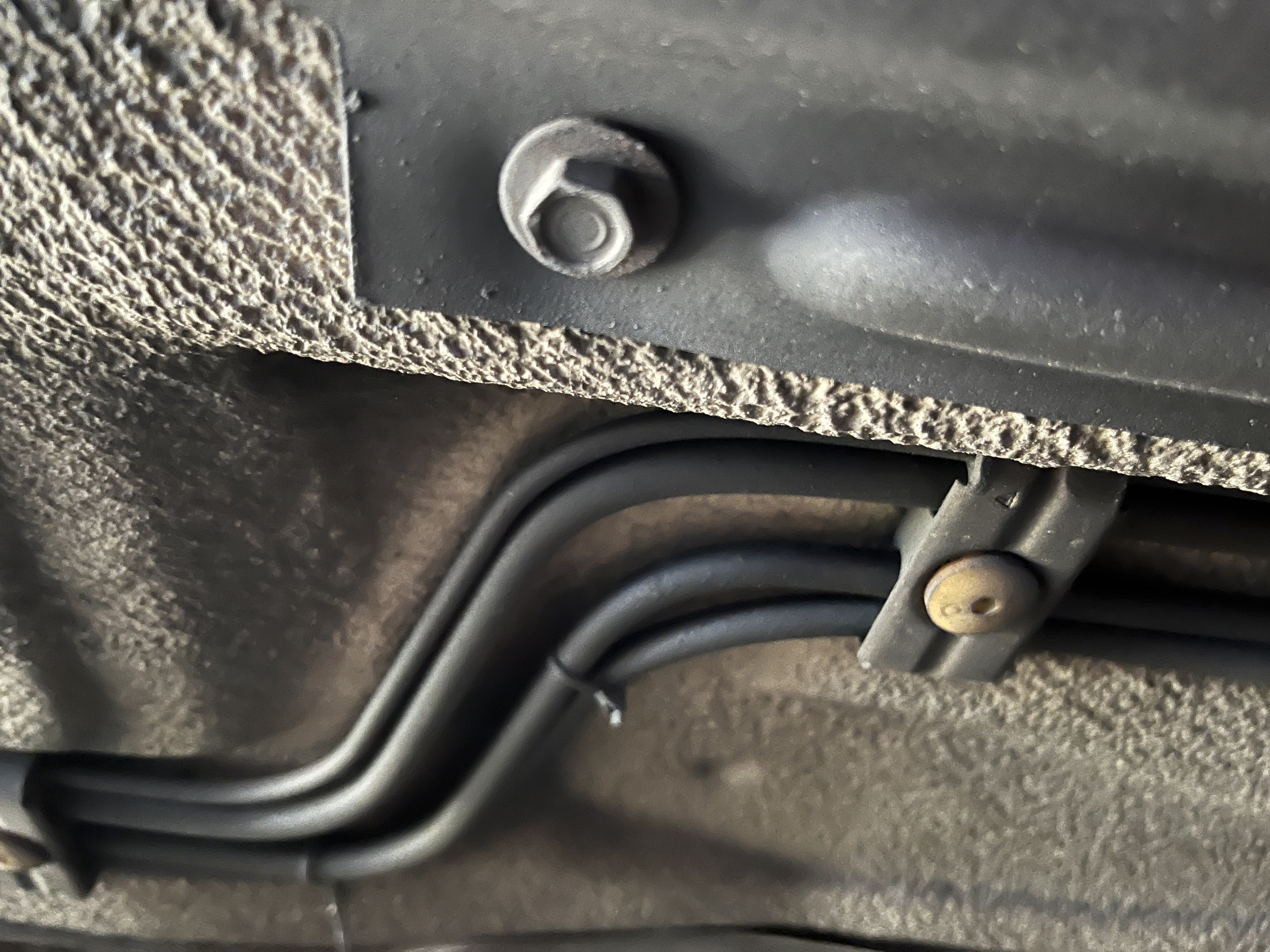

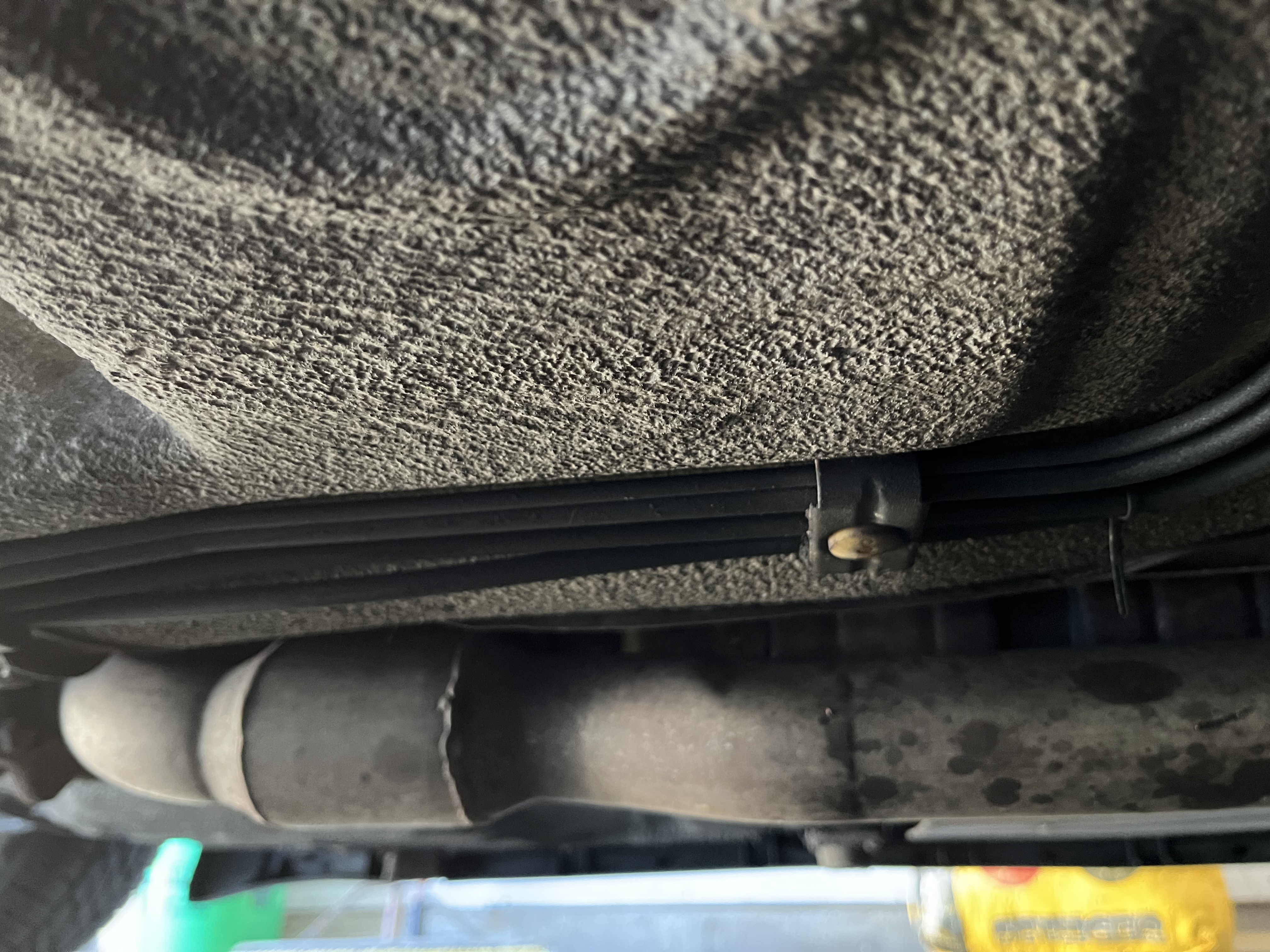

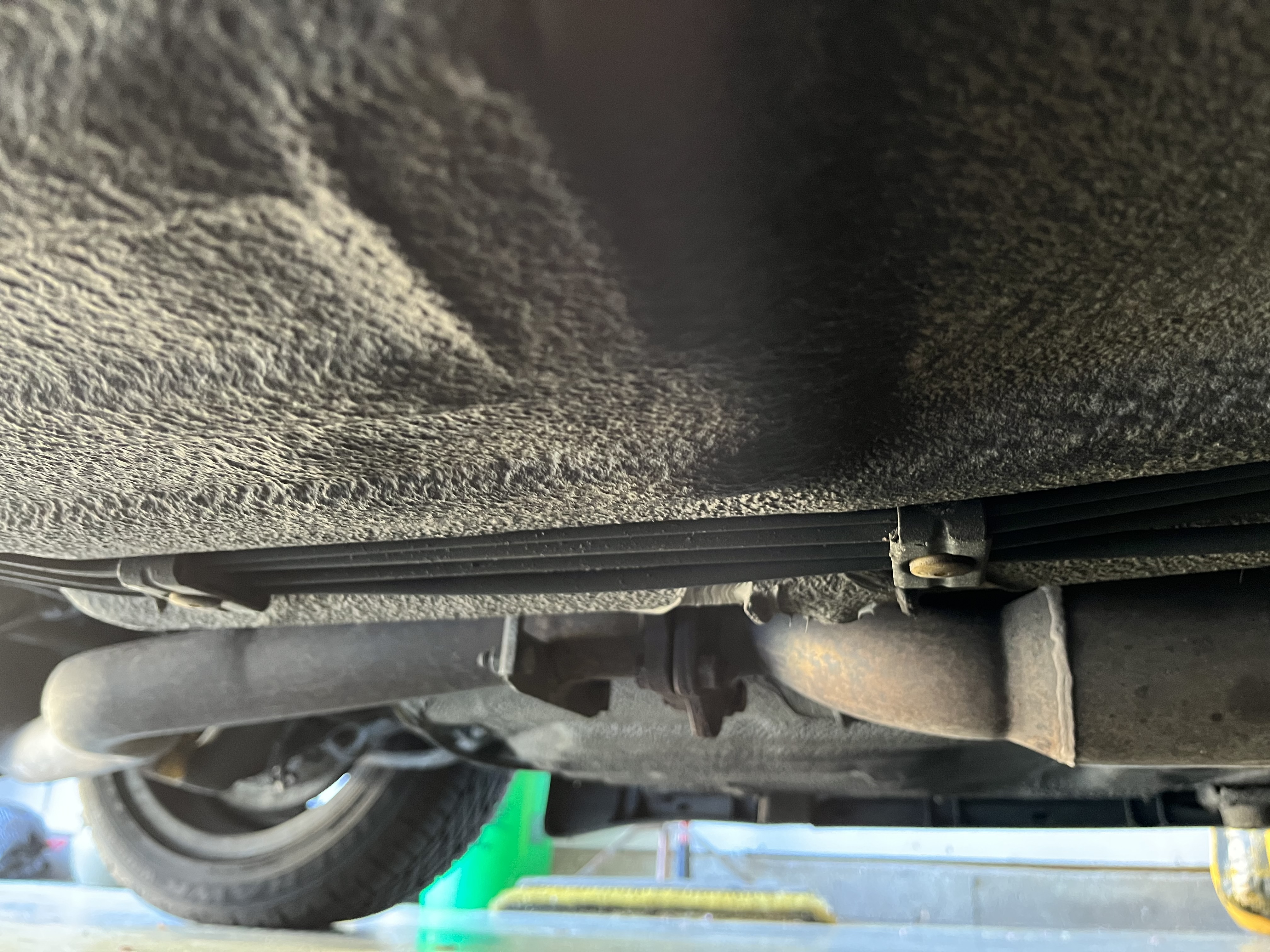

Late to the party on this one. I have two '86 turbos. Tom did you need any more pics or did you find what you needed?

Actually, I'd love more pictures of 1986 fuel lines under the car, with a focus on whether the two lines (feed and return) are one continuous tube all the way to the back fuel filter area, or if one or both of them are two-piece units with a coupler about half way back. The feed line on my car has the coupler shown in PET, but the smaller return line is one piece all the way to the back, and neither PET nor the dealer seem to have any reference to my one-piece line. I assume my car did come this way from the factory, but am looking for other '86's that are like mine to confirm....

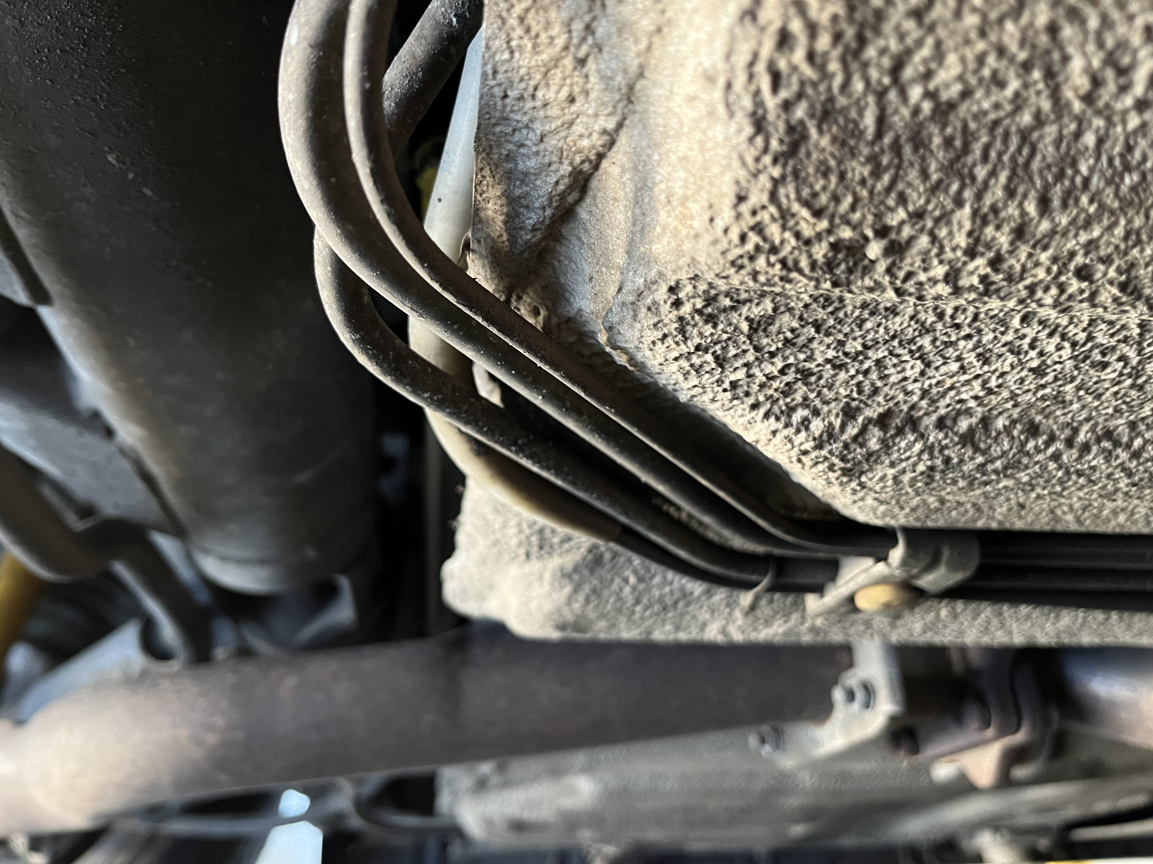

Here are some pictures of my white car. It has less miles on it and is more likely to be original. I don’t see a coupler.

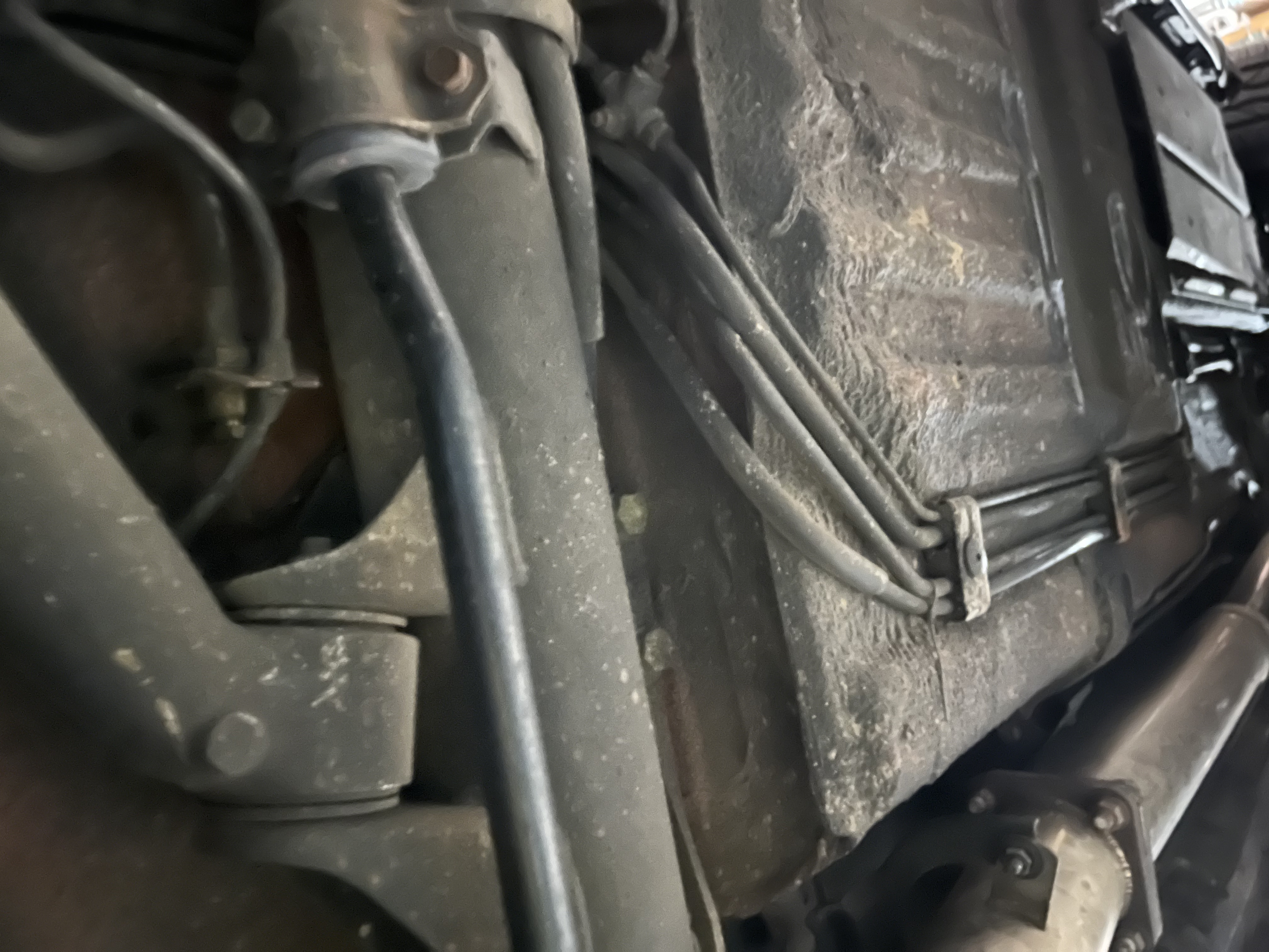

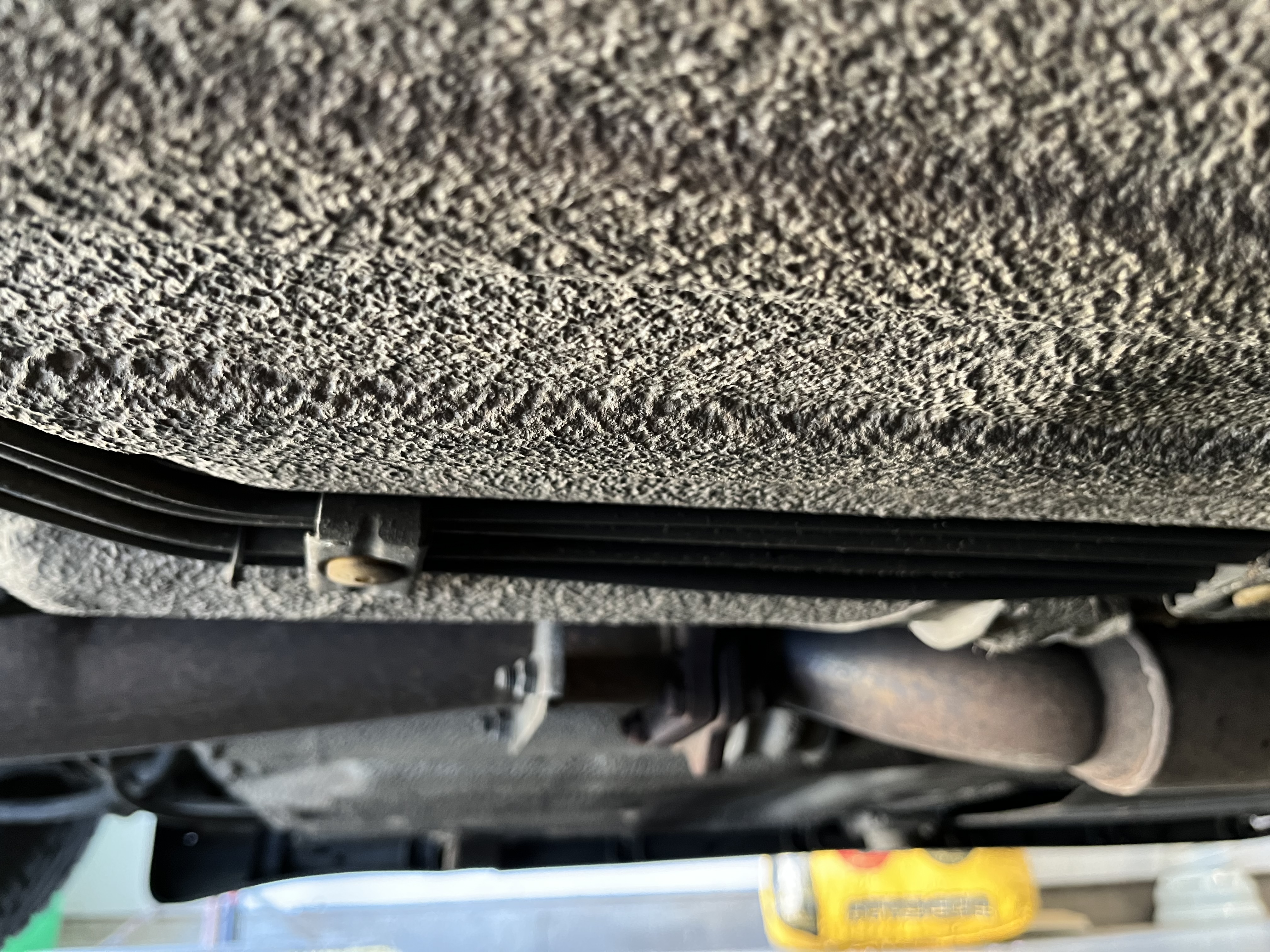

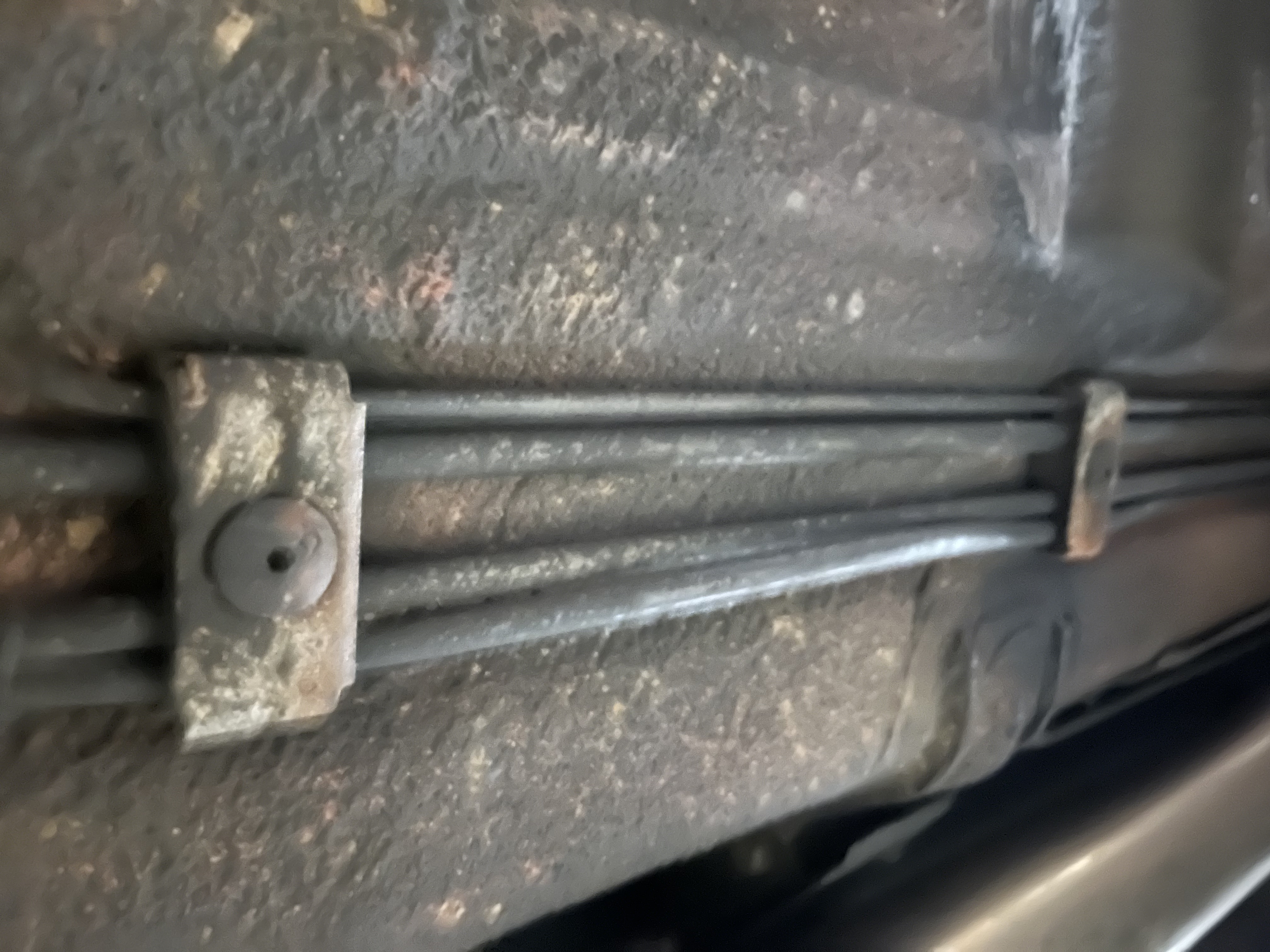

Thank you for those pictures! So far, my car is the only car I've seen with a two-piece feed line and a one-piece return line. I wonder if the dealer changed one early on, but not the other. There are some receipts referencing fuel leaks with unspecified 'campaign' repairs. I'll keep digging though. If Porsche updated the parts, then 'somewhere' there must be a TSB or something....

my red 86
