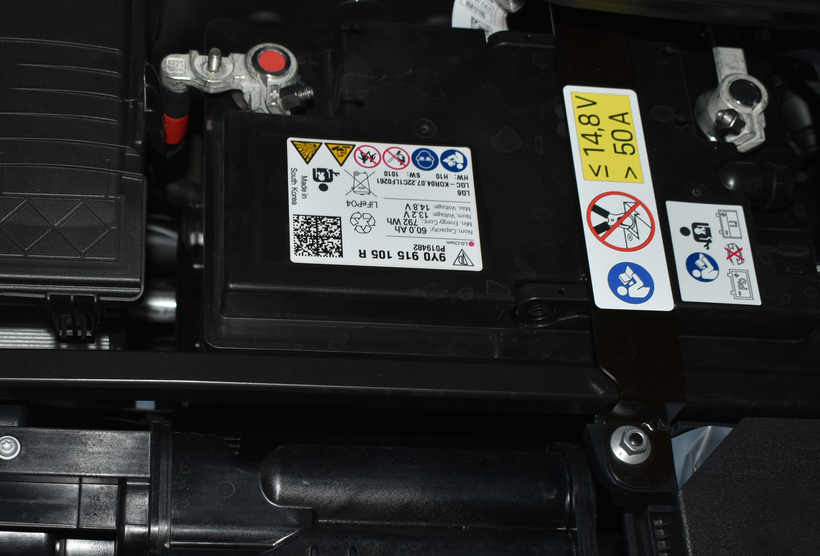

Thanks for the reminder. The battery is made in South Korea.

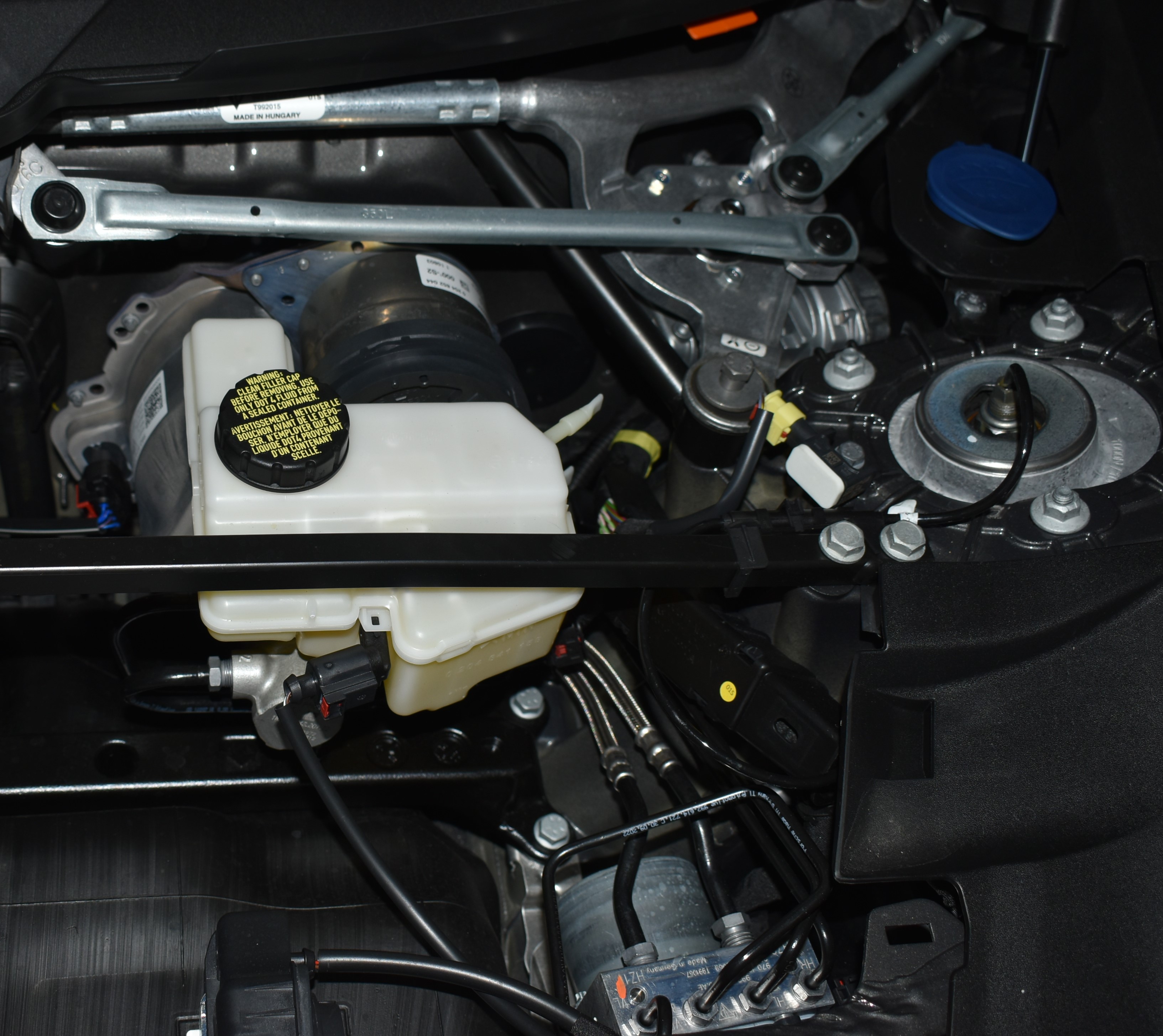

Here is the other (driver's) side. I noticed wiring going into the top of the front struts. I guess this for the suspension? It sends a signal to stiffen the fronts?
This is a change from the 2020 Carrera. I remember going away for a month and attaching an old-style trickle charger to the battery. It worked well.
[Opps, double picture post].

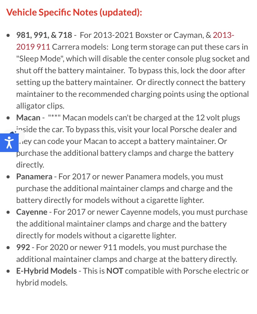

https://www.suncoastparts.com/product/CHARGER2.html
992 - For 2020 or newer 911 models, you must purchase the additional maintainer clamps and charge at the battery directly.

@P_Coastal
I think Suncoast Parts might have it wrong for 992's and maybe other models too. Mine works just fine (and has been for a year now) using the footwell access plug. It also has performed the same for others I know who use that method. Porsche svc dept here has verified and recommended same setup as I use to several 992 customers who have asked about Lithium battery maintenance.
The inside power port also works fine for battery maint on our 2019 Cayenne Turbo too which has a Lithium battery. The ports remain hot per the Owner's Manual for both the 992 and the Cayenne.
The only downside I see is that if you store the vehicle outside and/or in a less than safe area, it might not be wise to have the window down that 1/4" or so to allow the cord to pass through. I would never raise the window all the way up on any kind of cord, power or otherwise.

@blueline, I am not disputing your experience, or anyone else’s. The notes from Suncoast seem to align with Tom’s experience so it is just a data point, not definitive.
