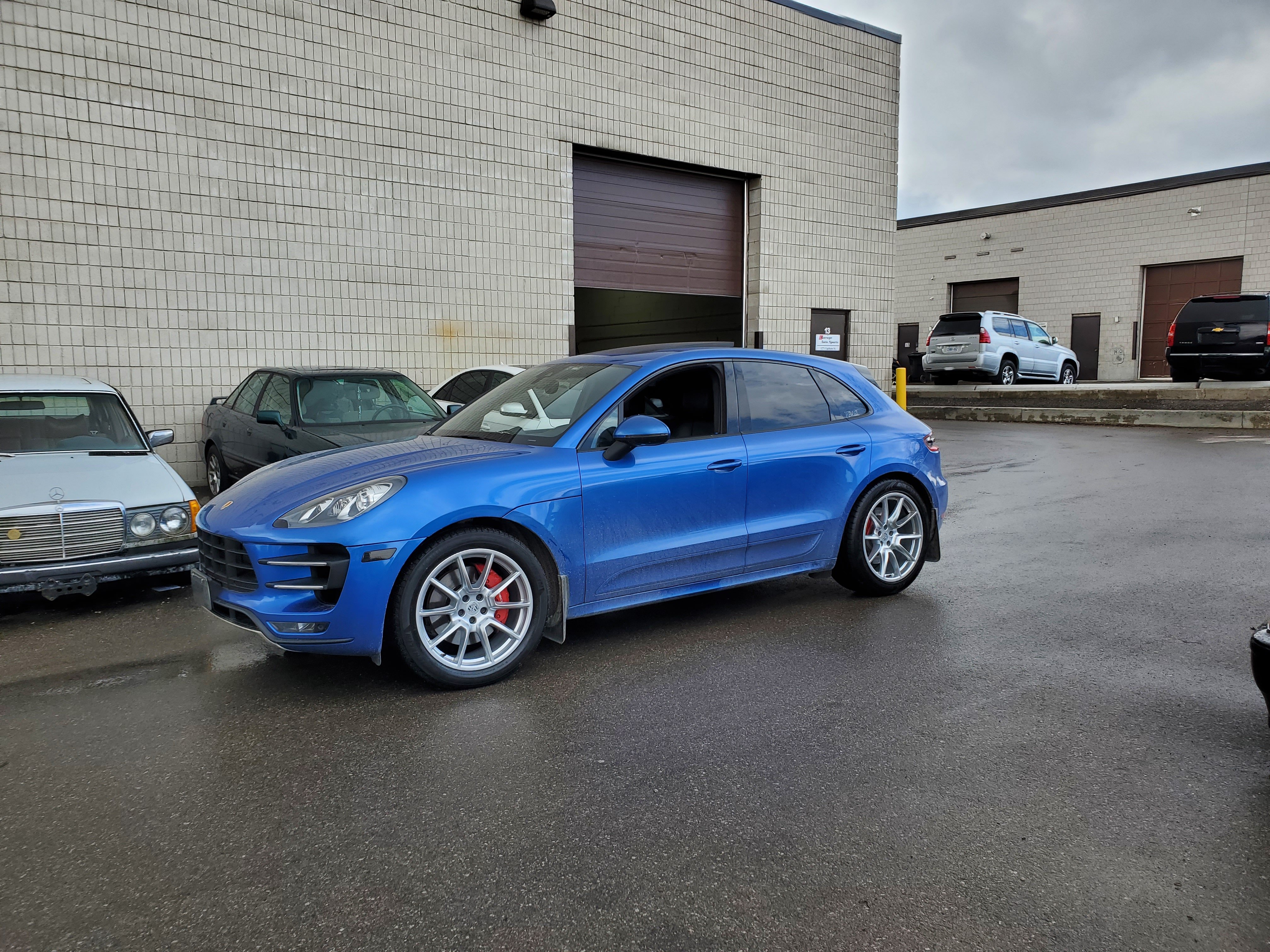

Took the car to Bill @ Garage Autosports caused I wanted louder burbles. Lol

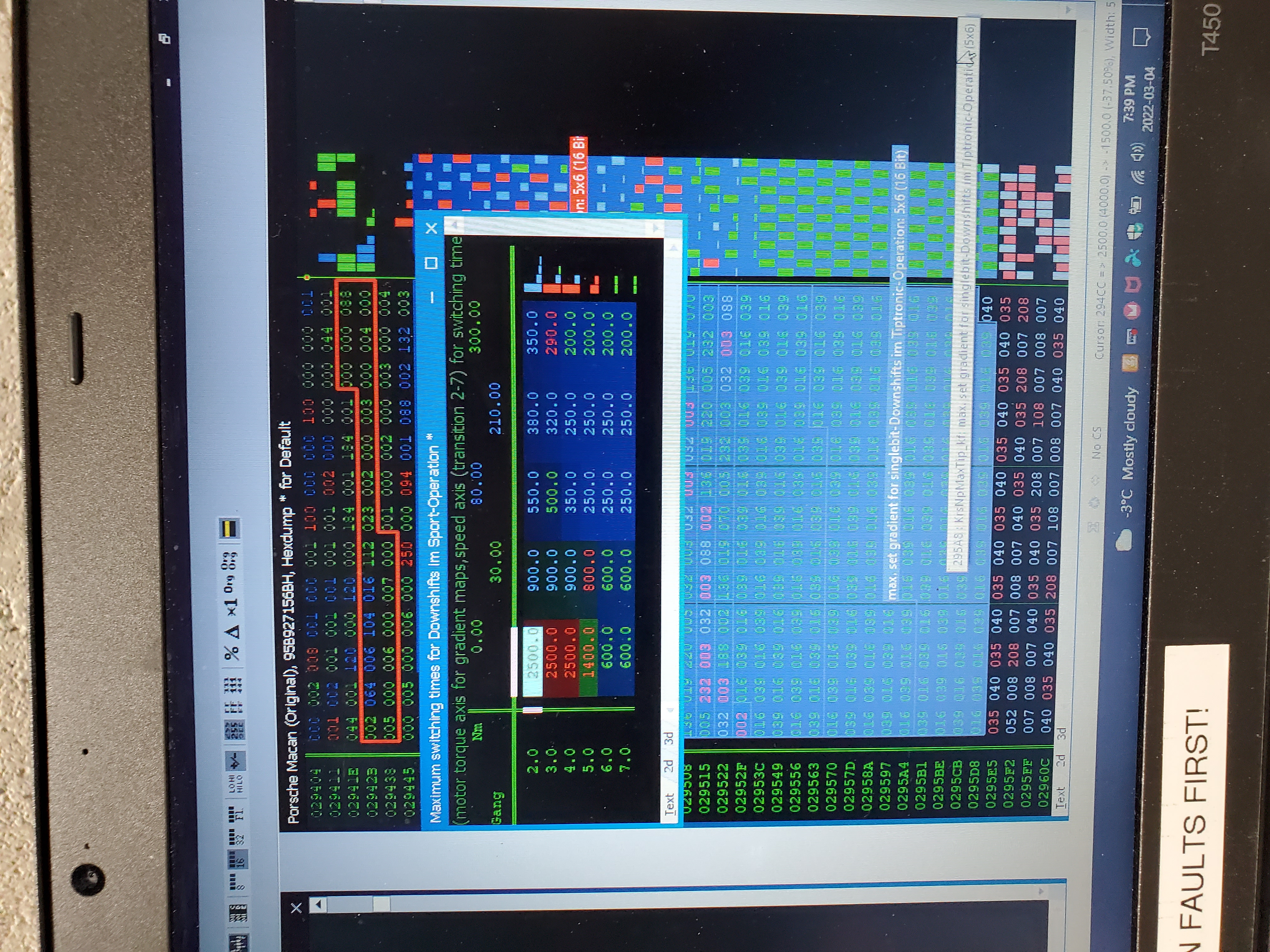

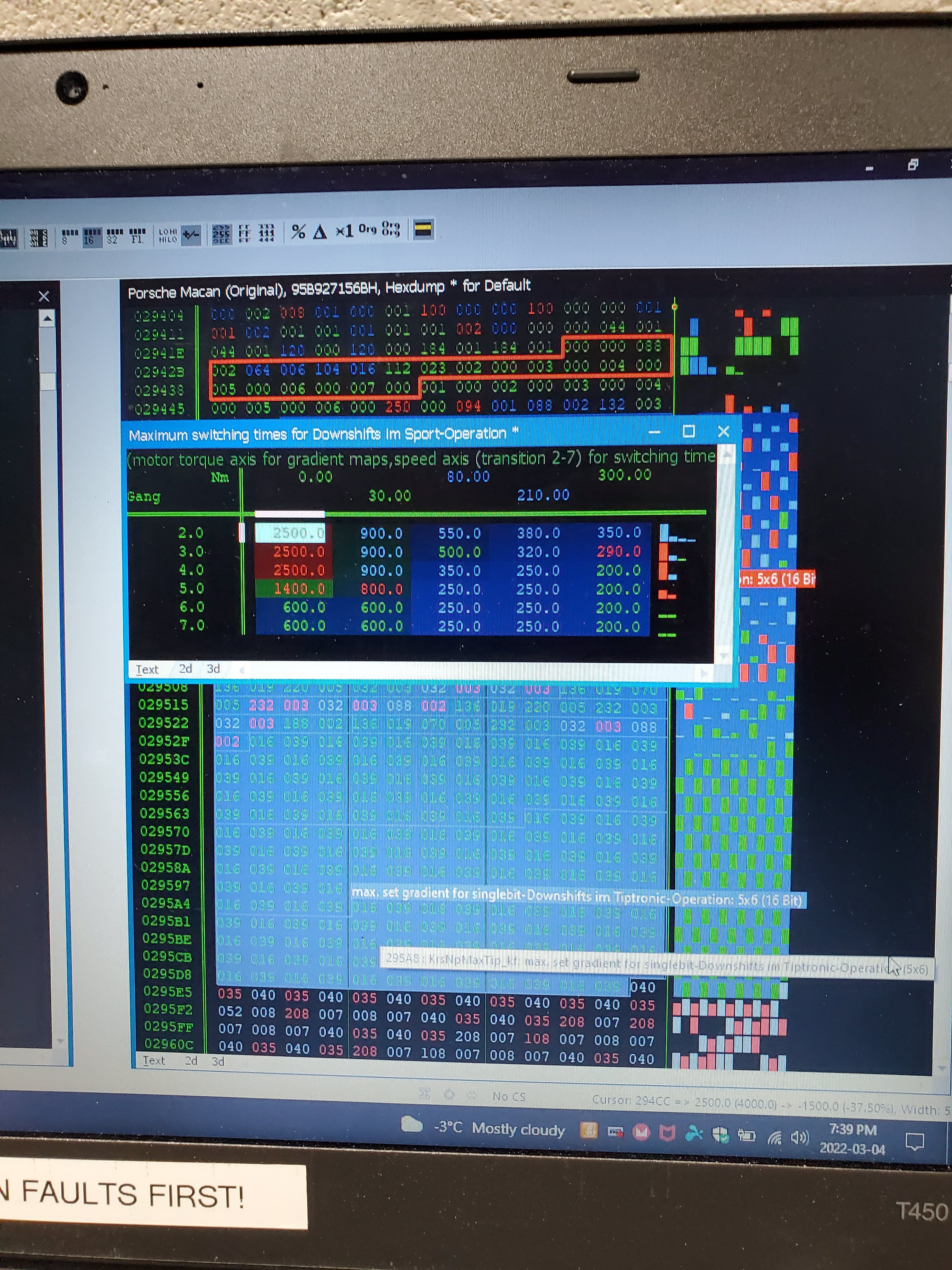

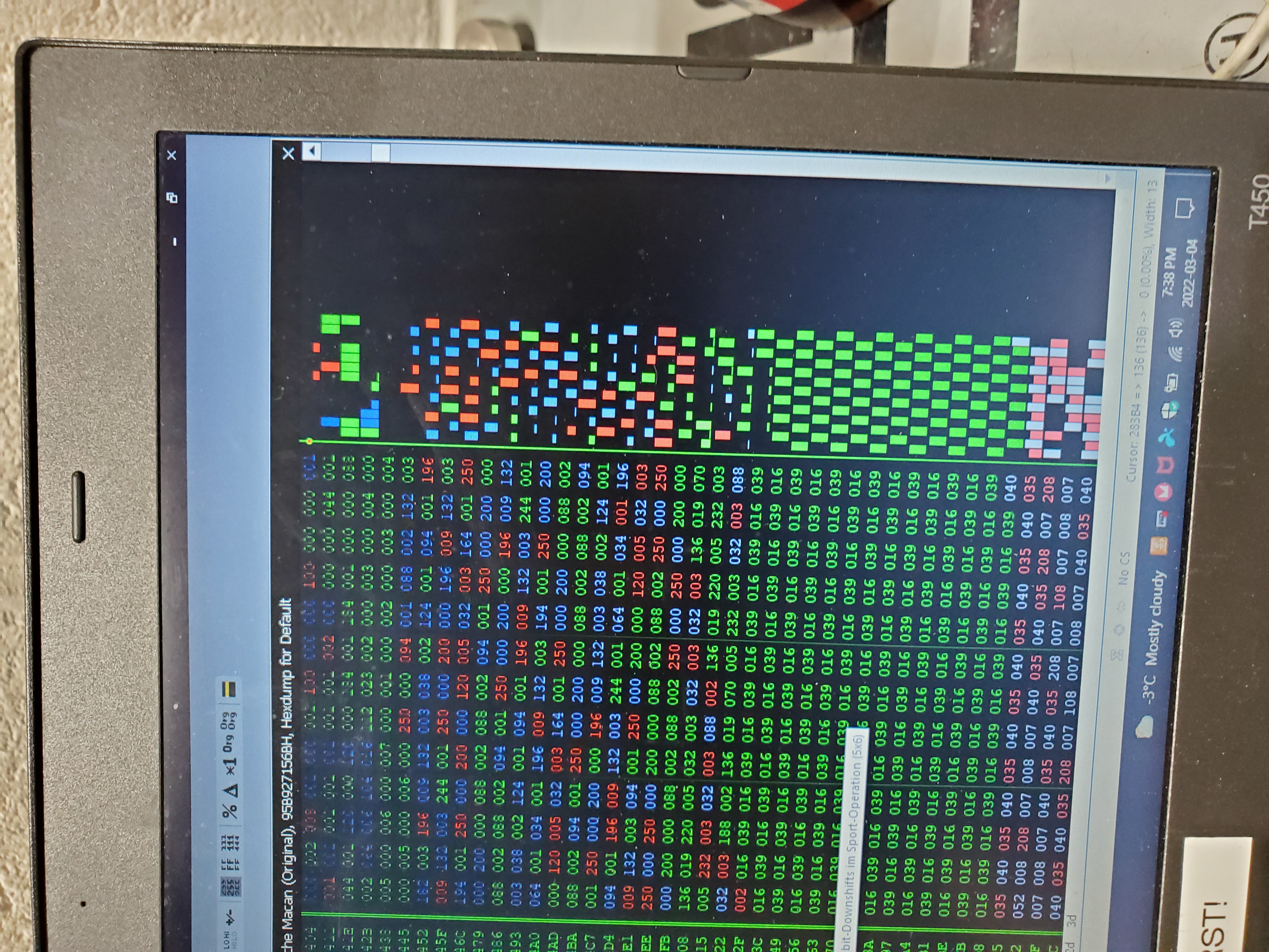

Biggest update STAGE 1 PDK Tune is done!! (Picture of hexdump while Bill was doing his thing)
First impression on PDK:
Shifts feel alot smother and faster
Normal mode no longer takes its sweetime to down shift.
Sport+ feels fantastic.

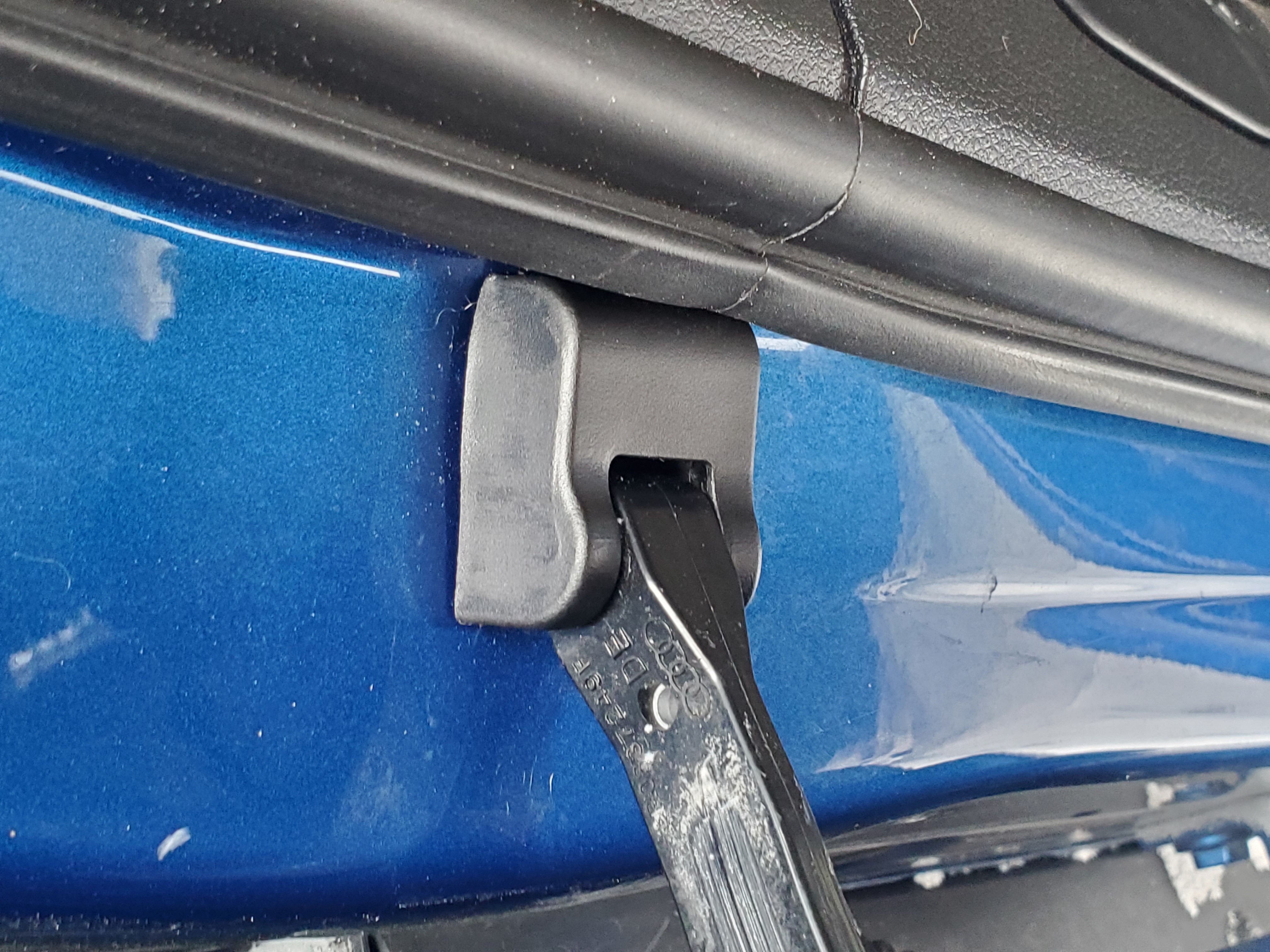

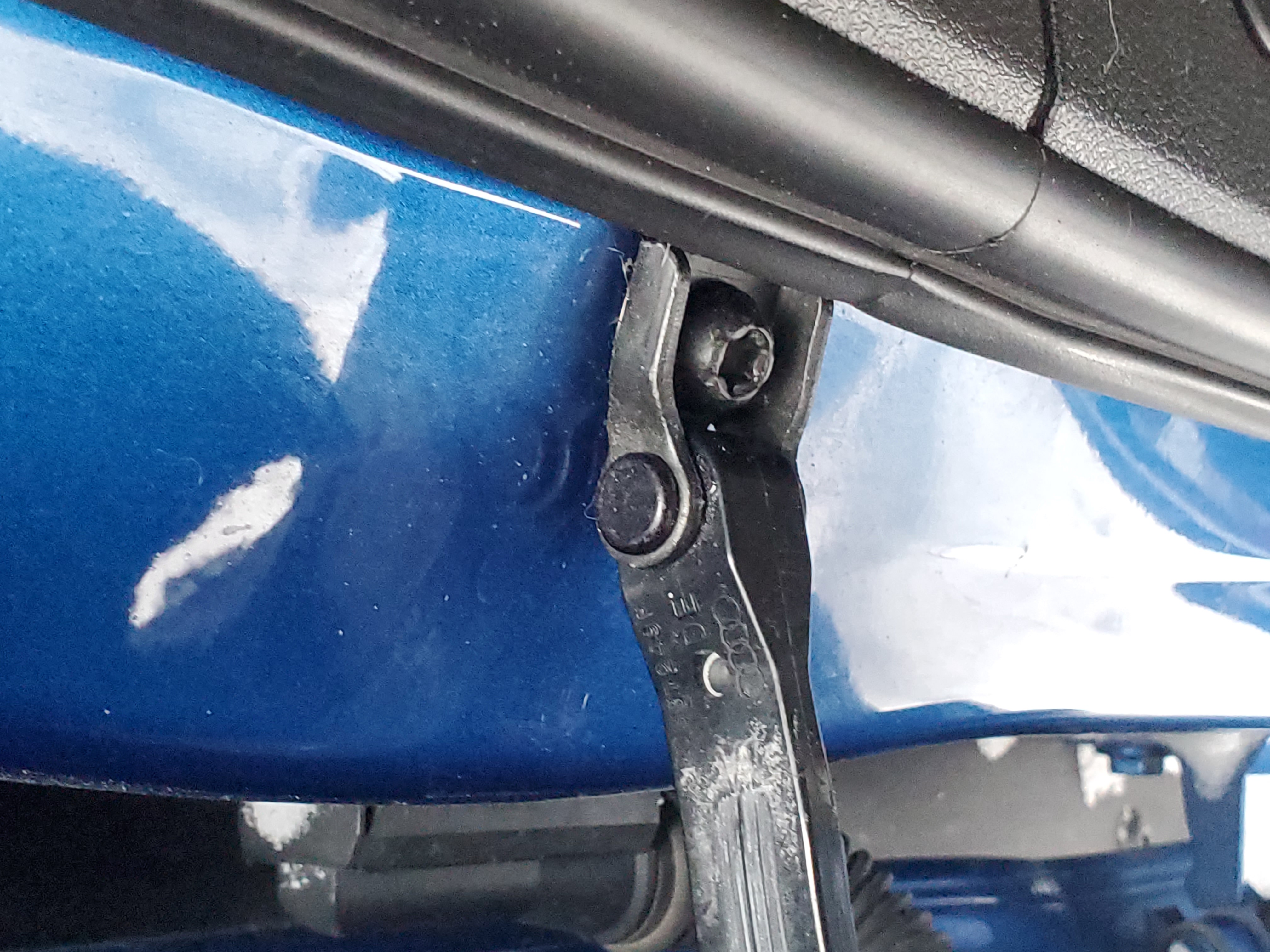

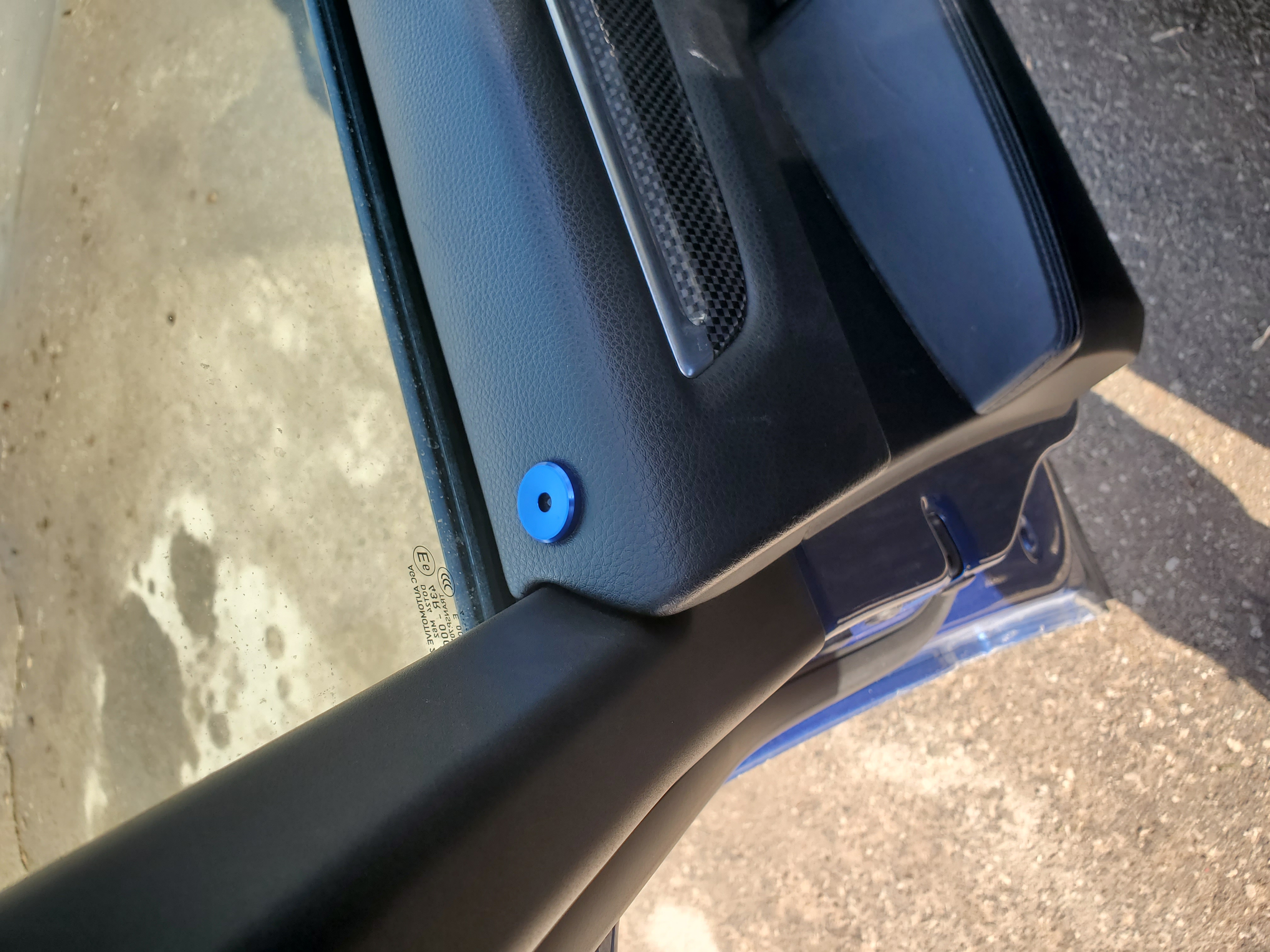

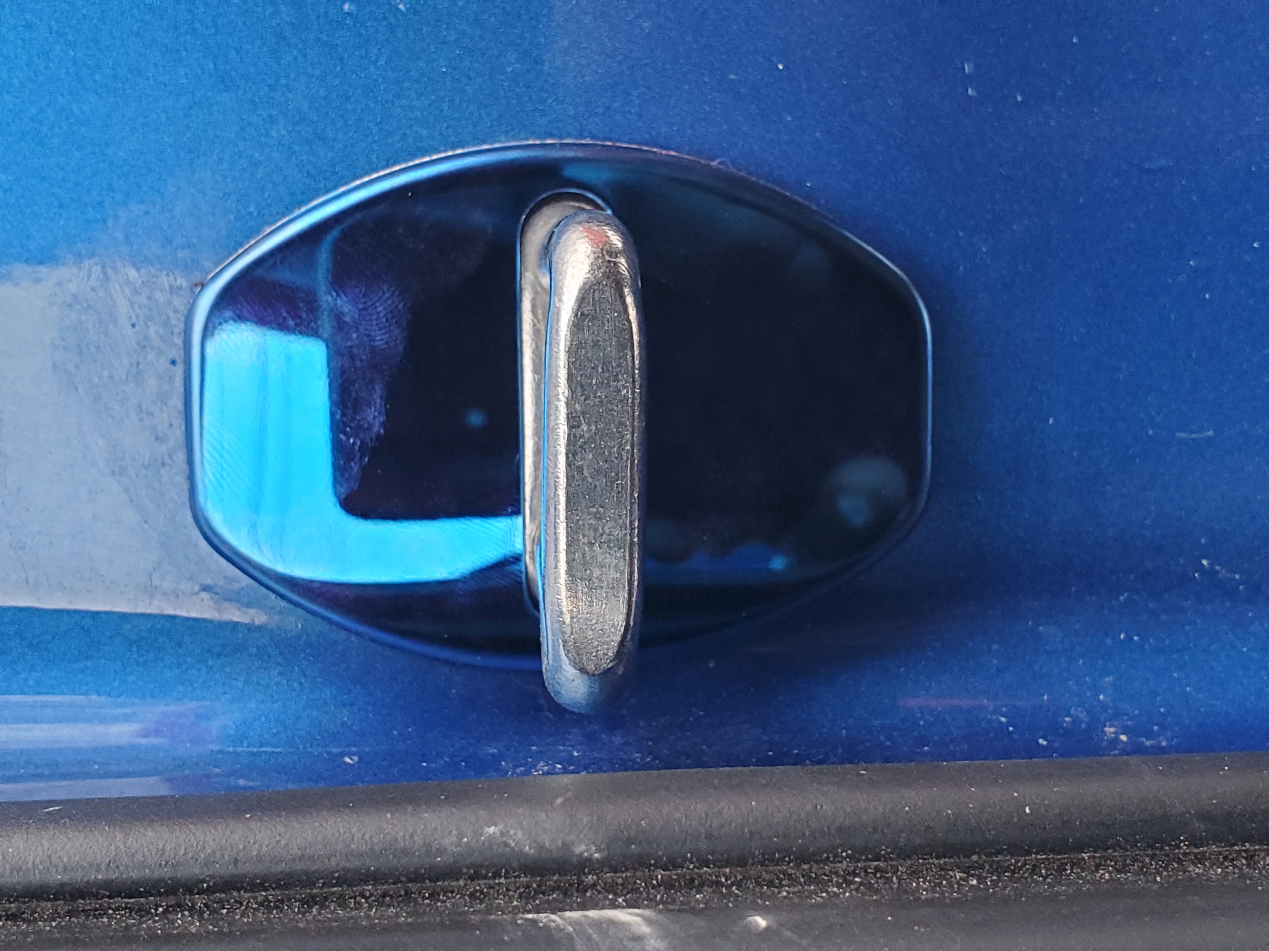

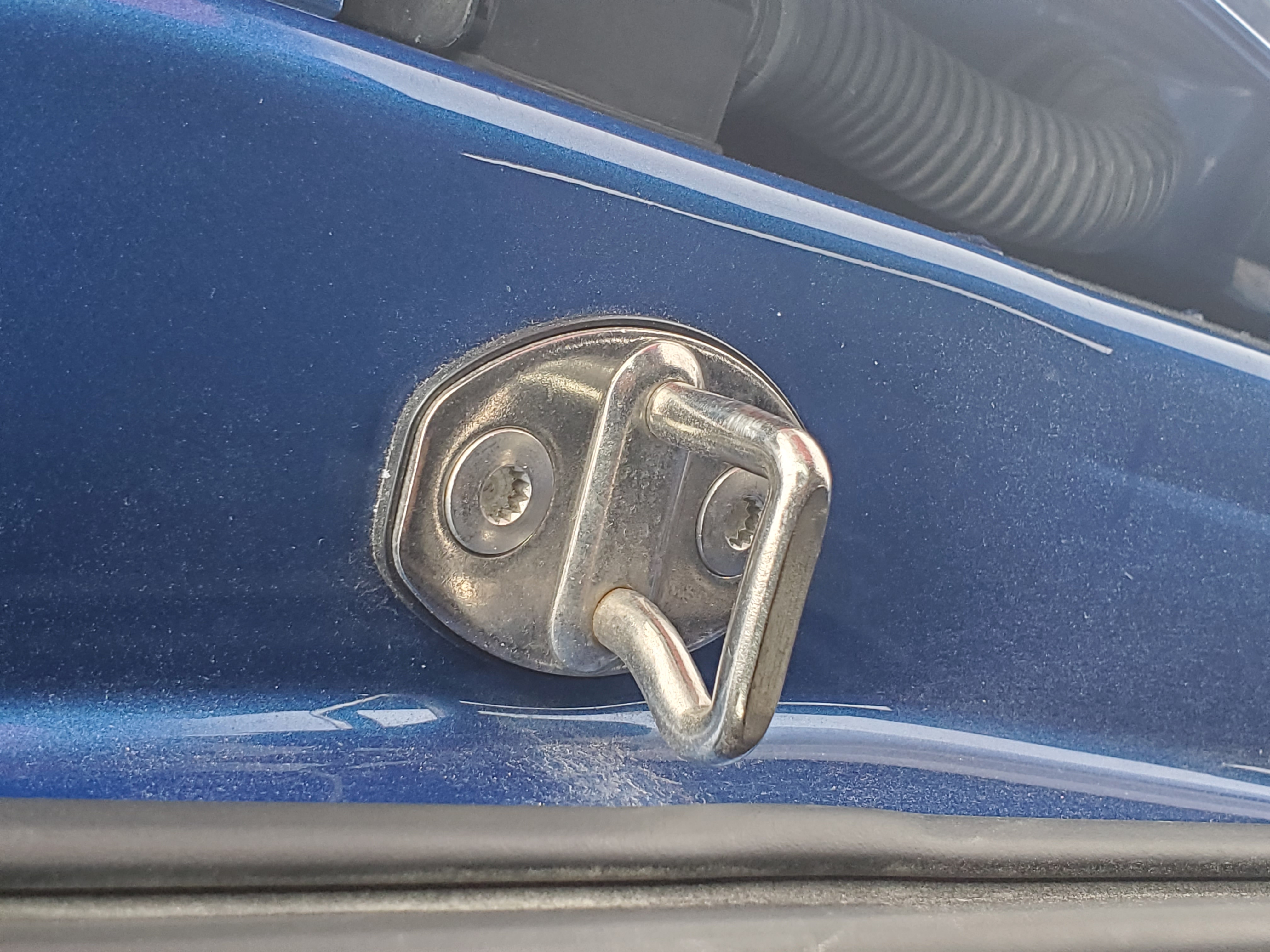

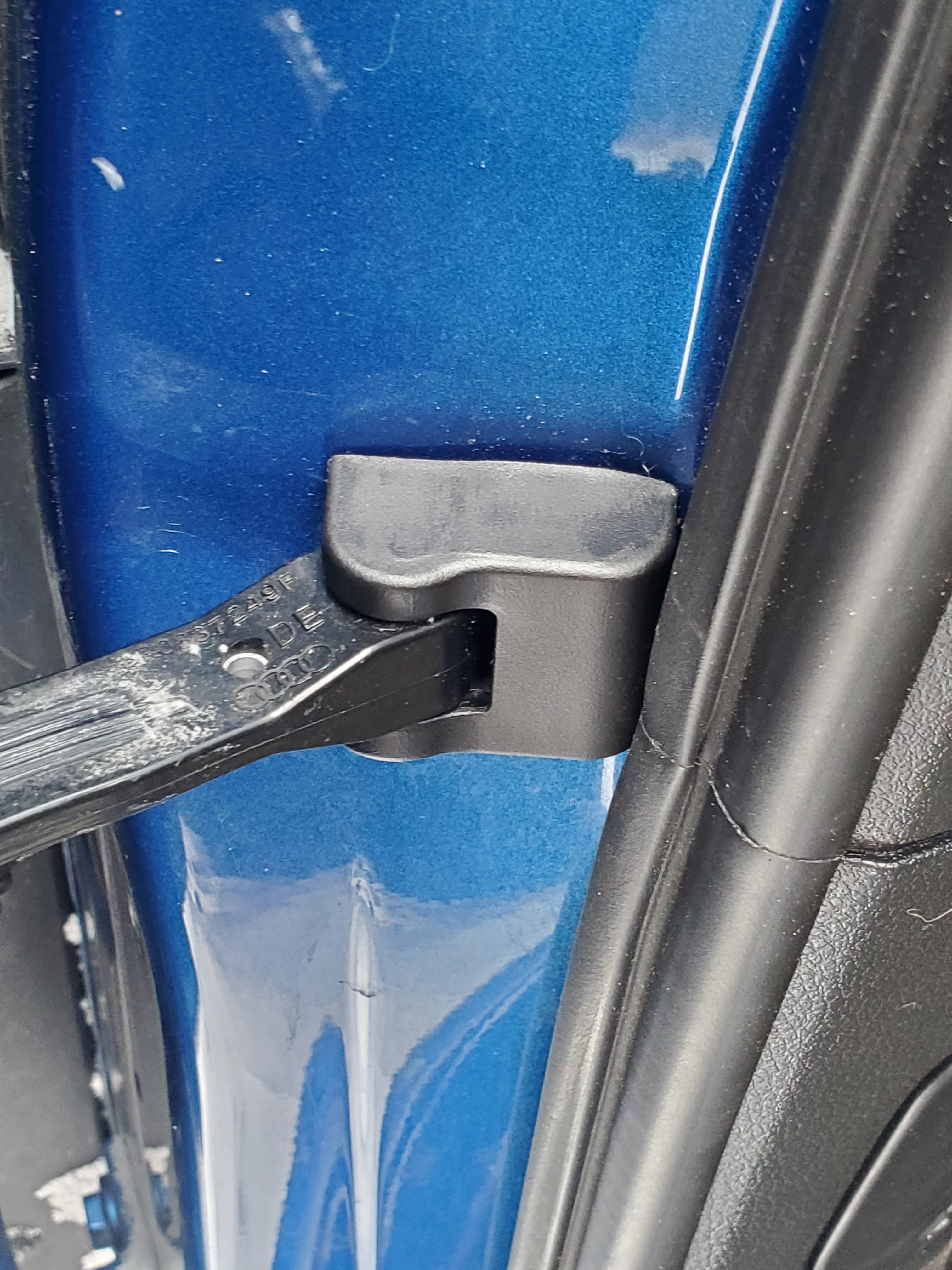

Installwd the followong items:
Gauge rings, smoked sidemarkers 3stripe LED, Door hinge, latch and alarm covers , stick on paddle extensions
Before
After
Before
After
Side markers

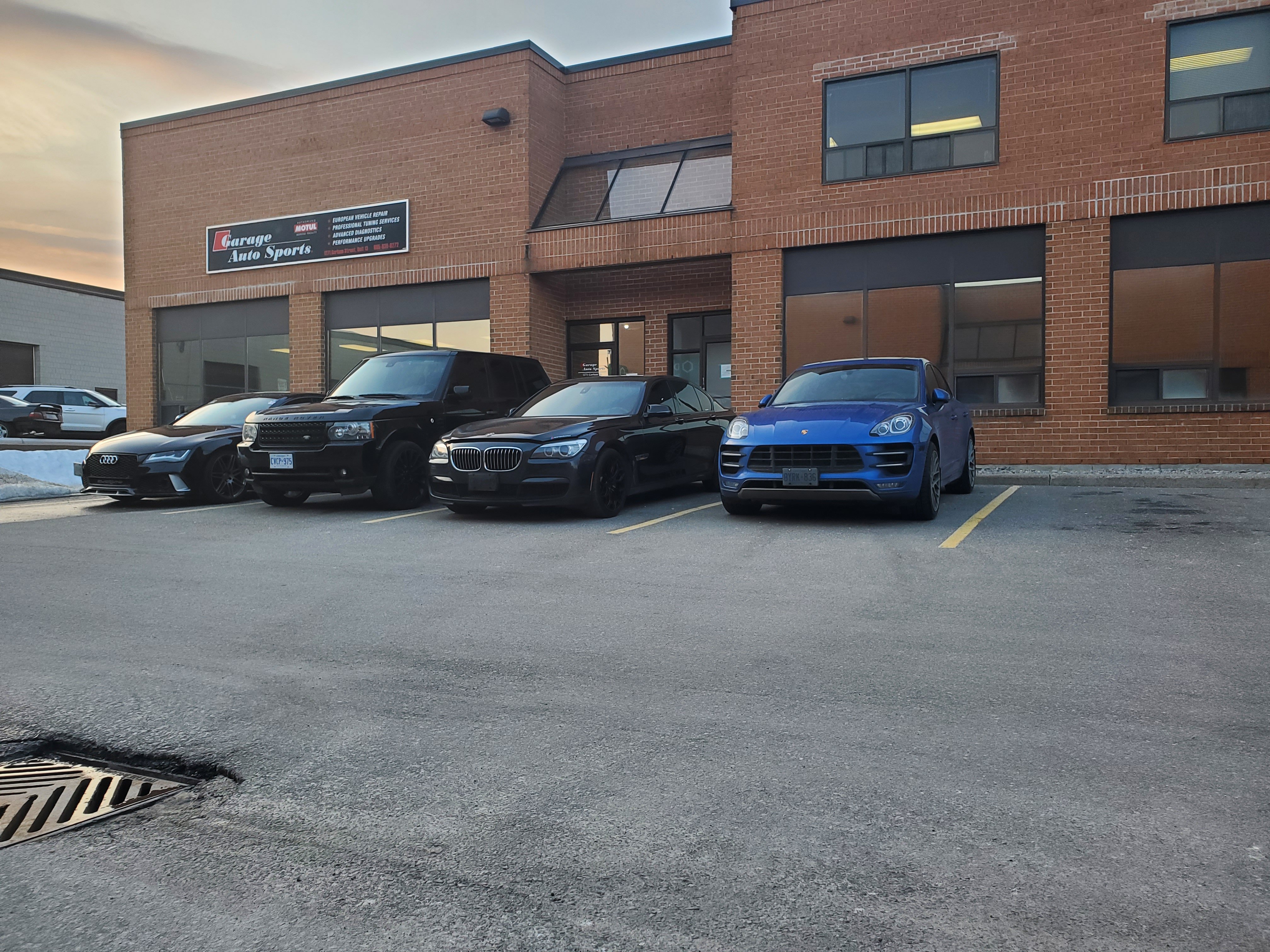

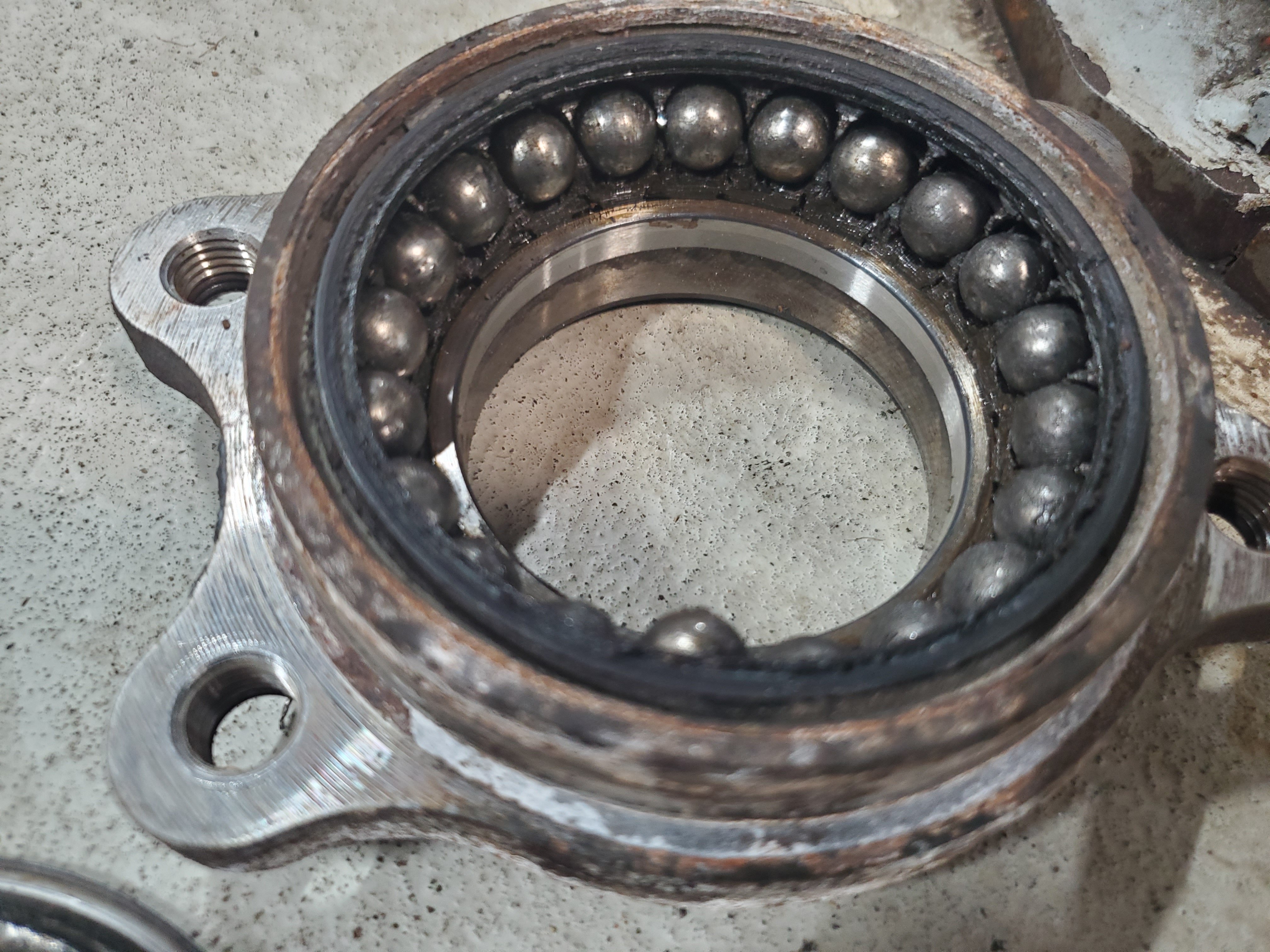

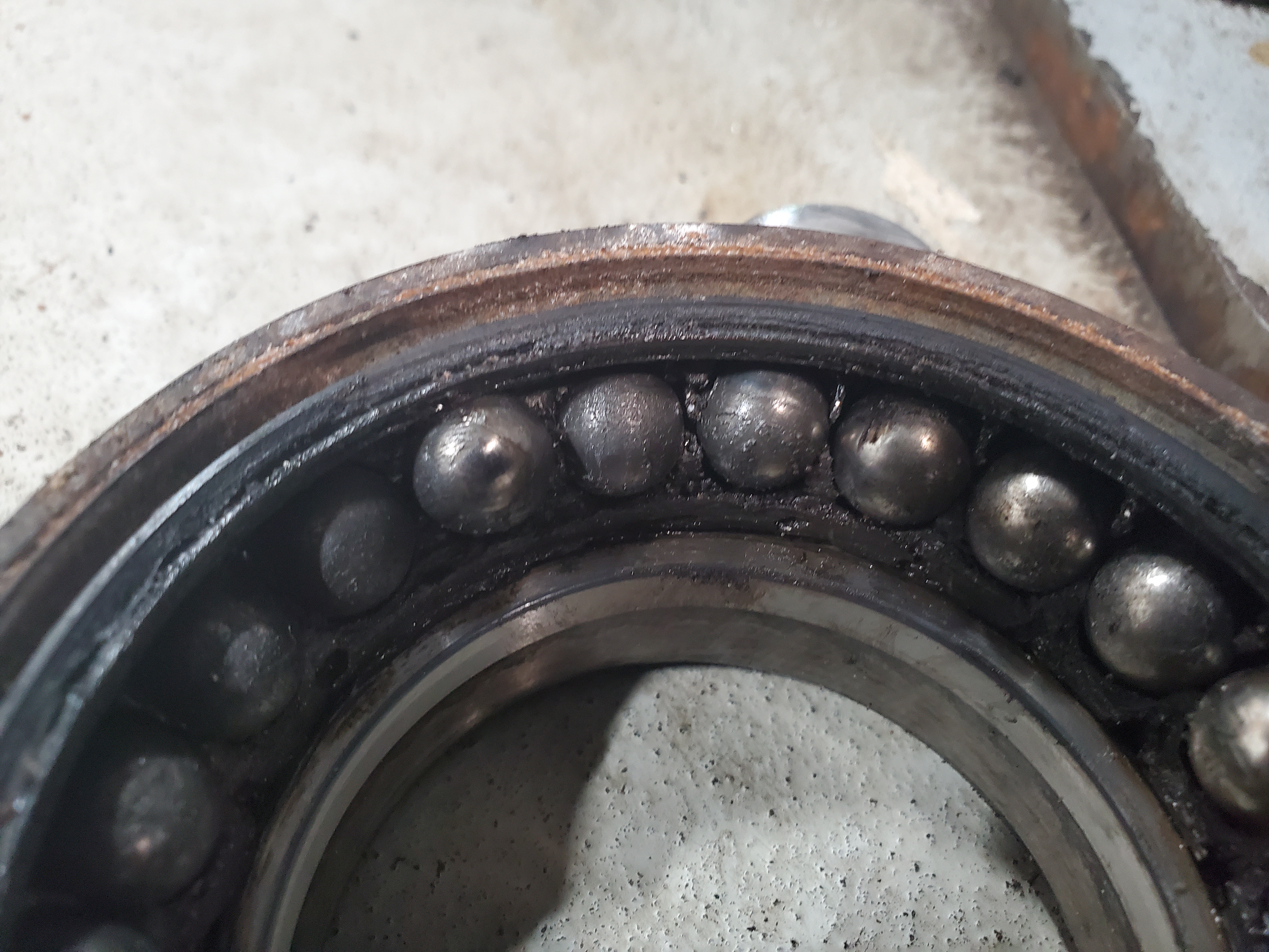

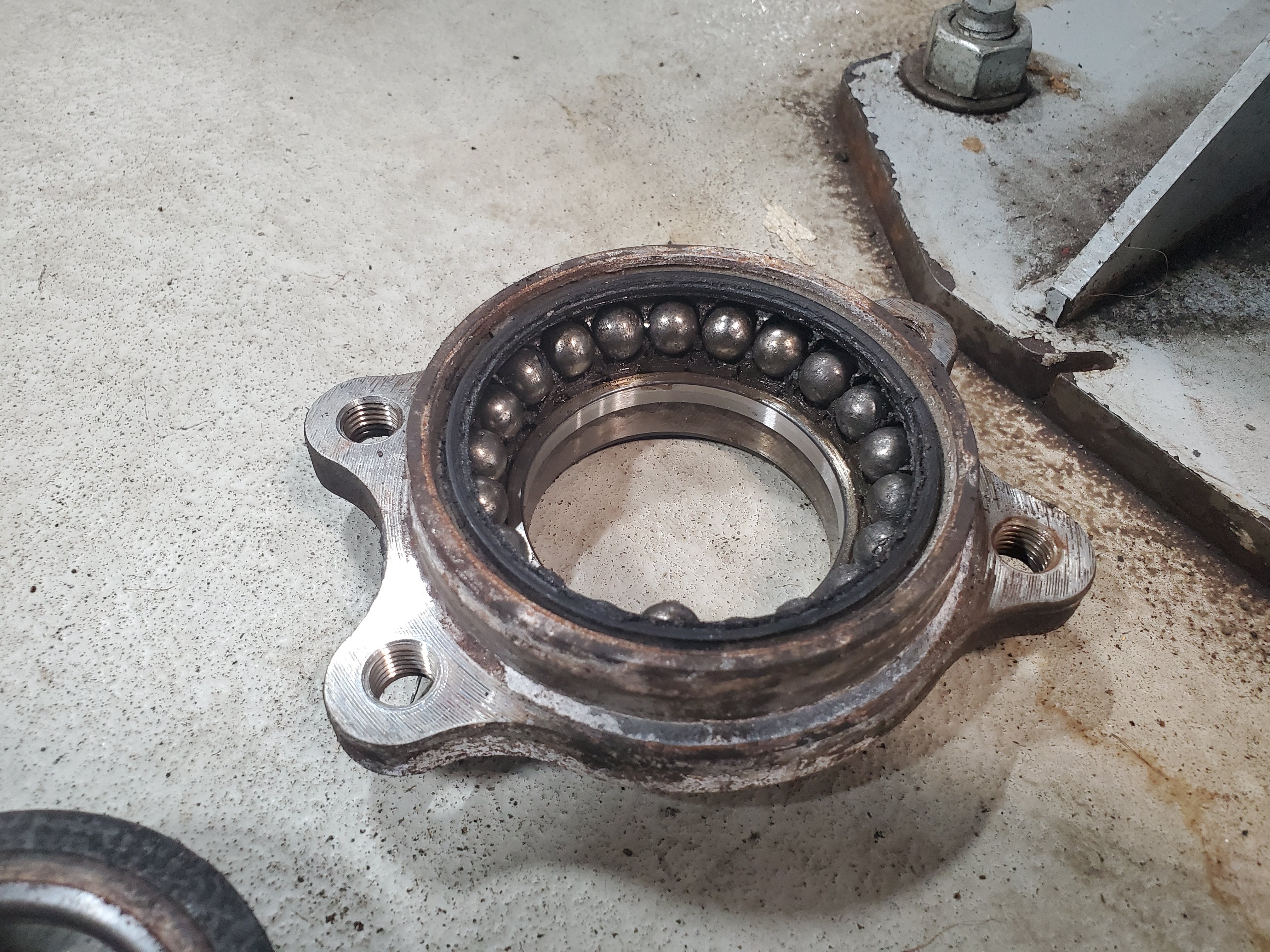

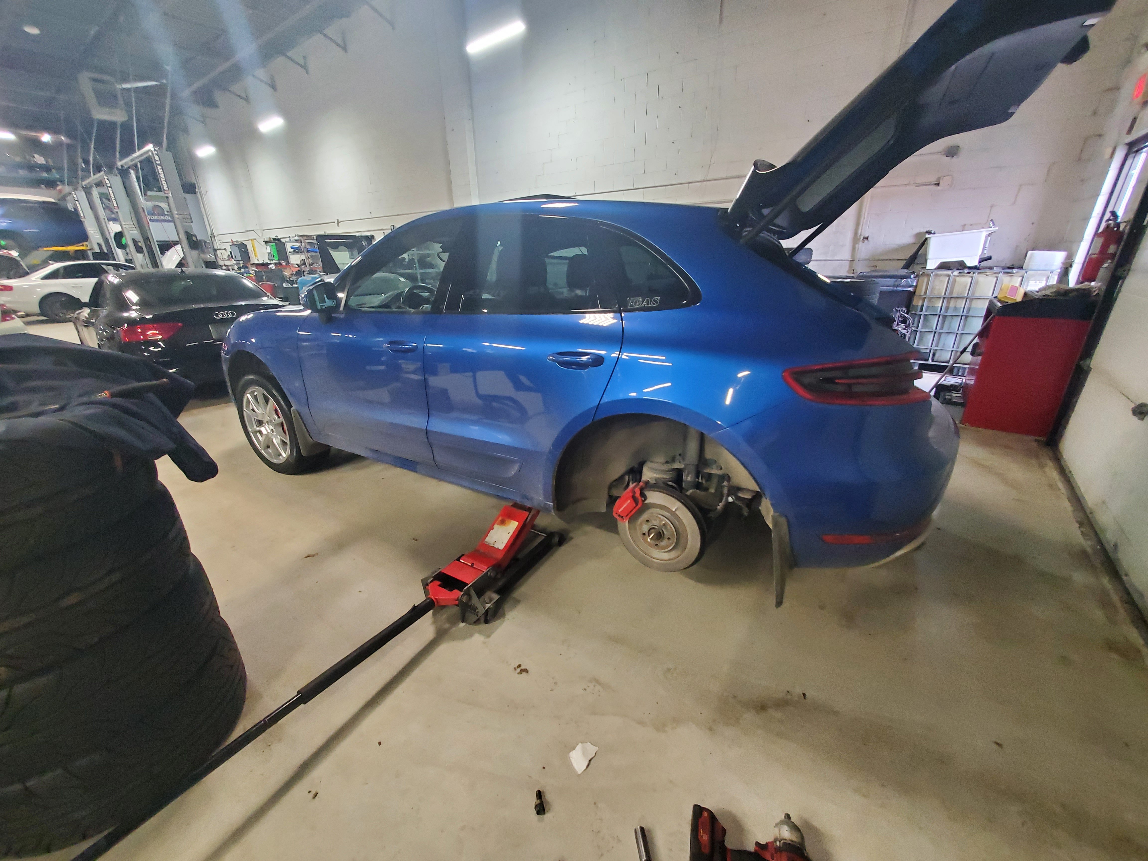

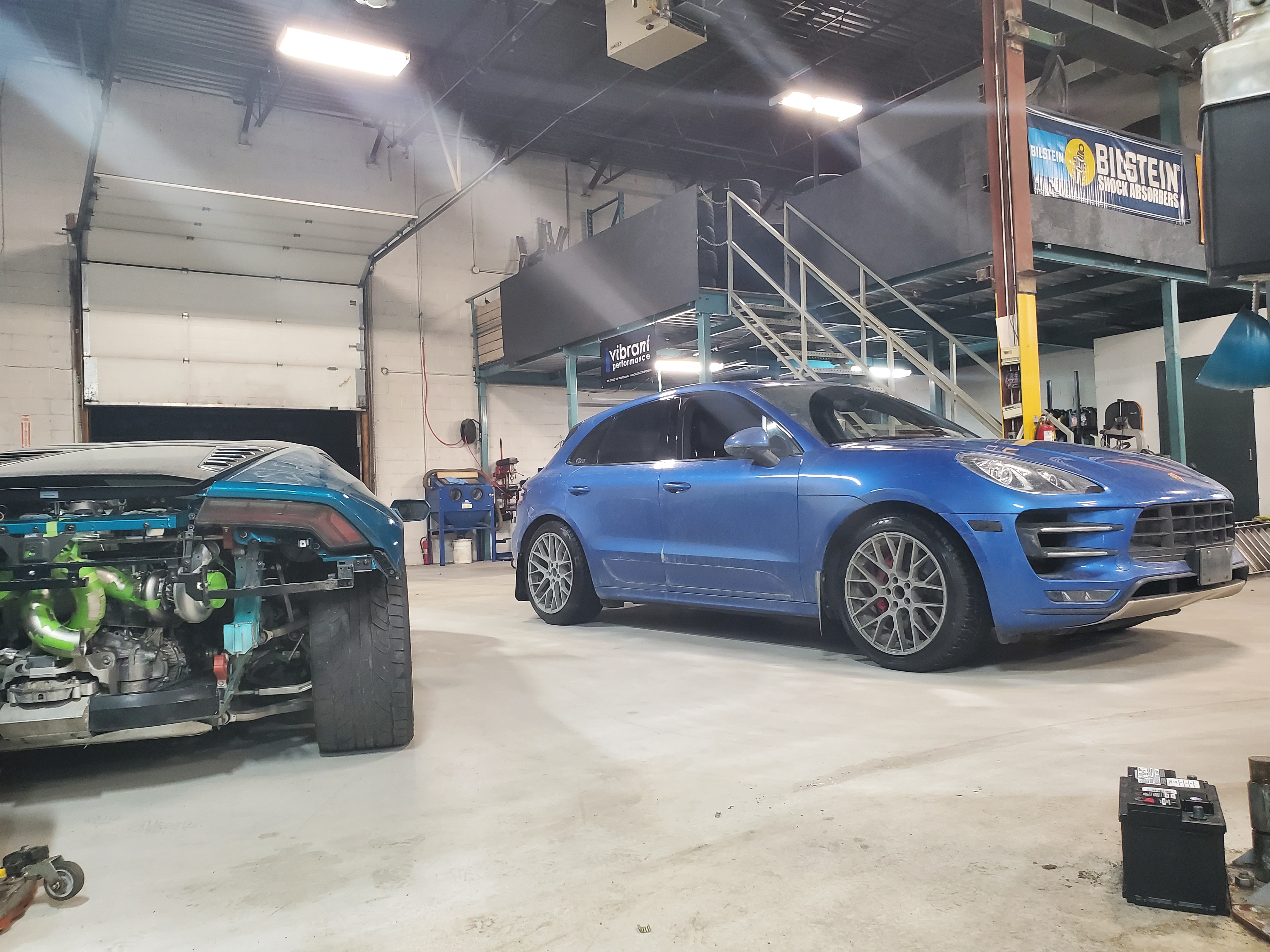

Bill diagnosed that i had a bad rear wheel bearing noise when we went out for lunch, so dropped the car off and had both rear wheel bearings & tcase fluid replaced by Garage autosports.

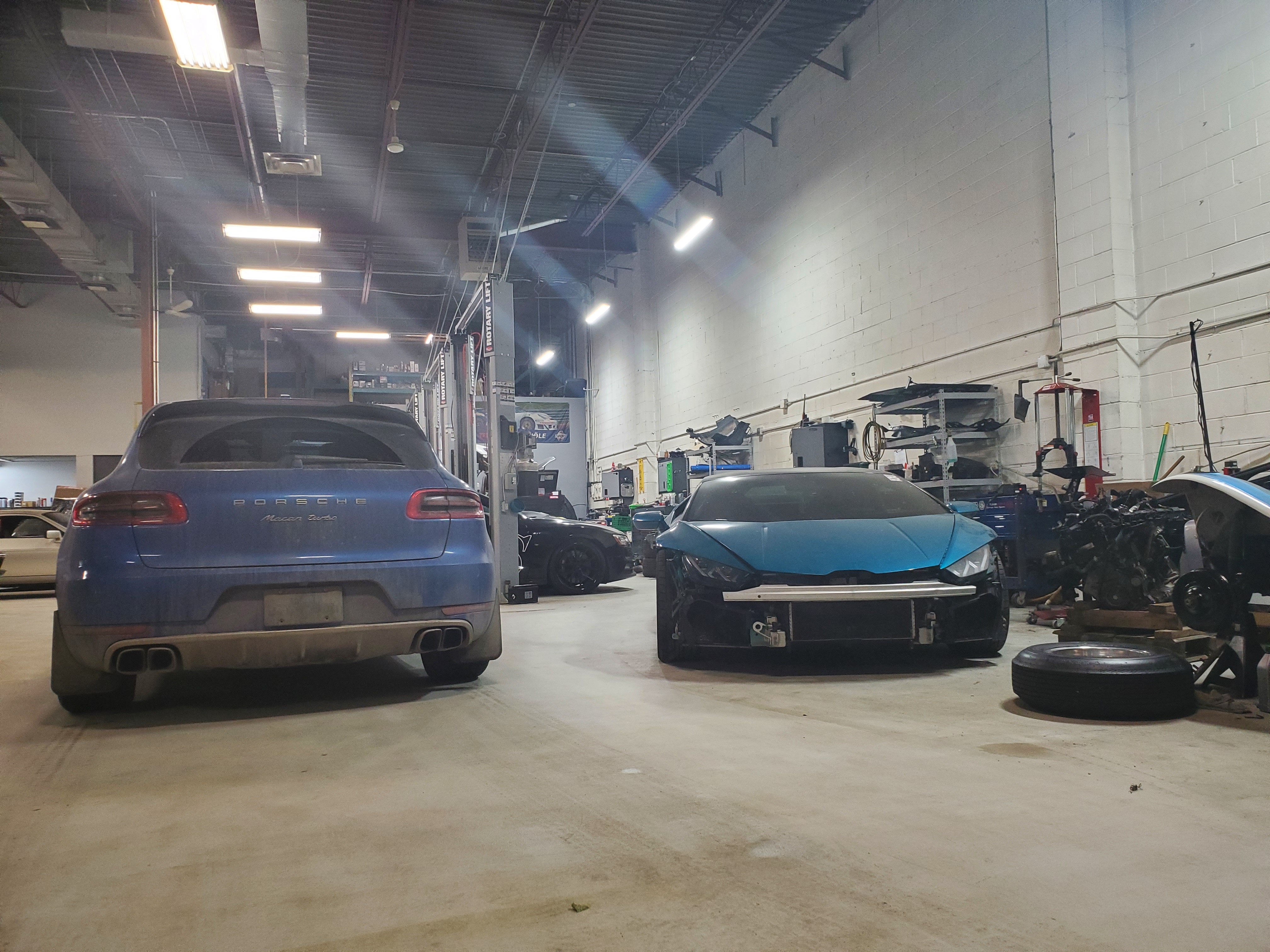

Dropping off and TT Huracan project the shop is working on
Picture of the old worn bearing.

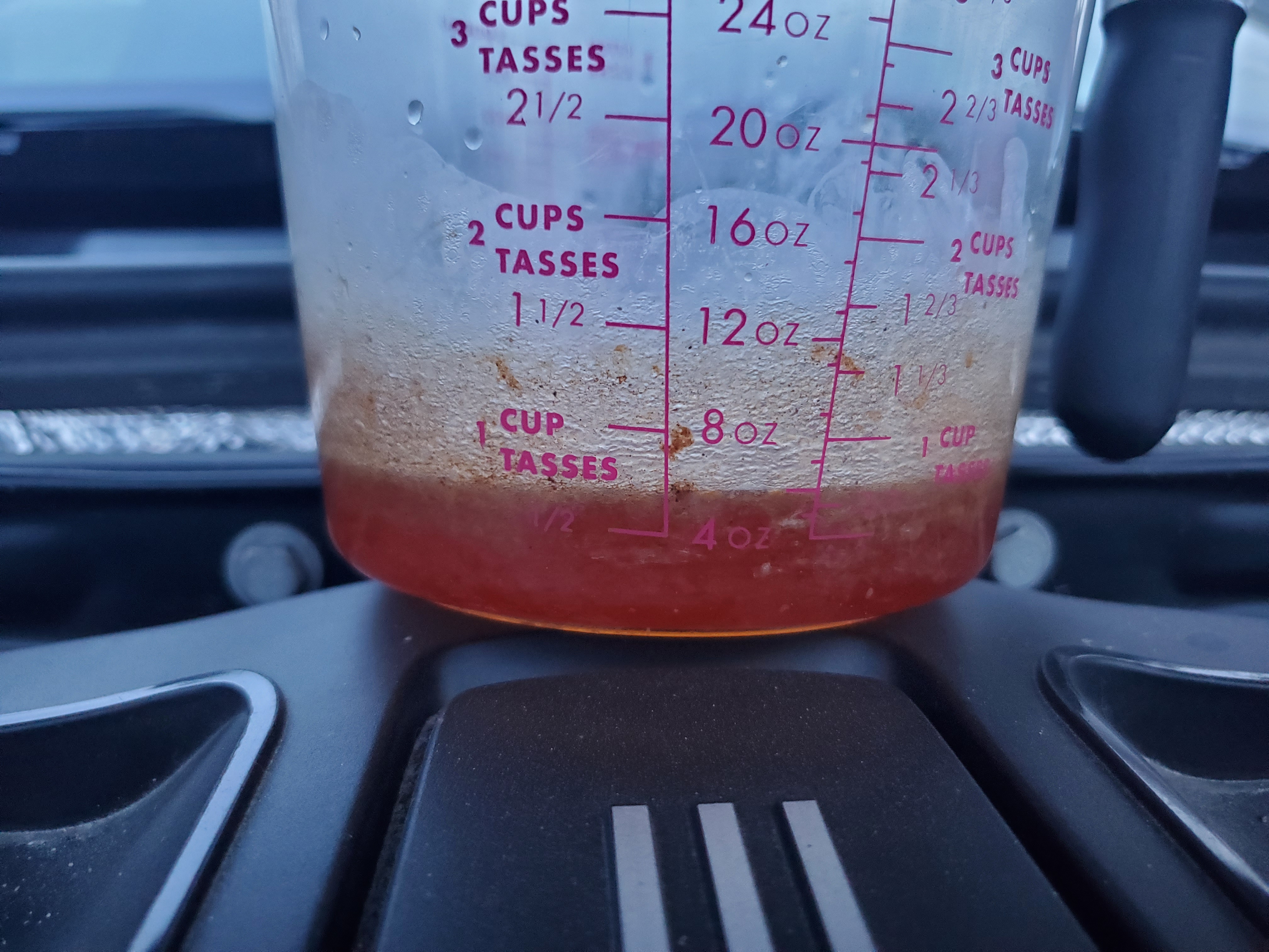

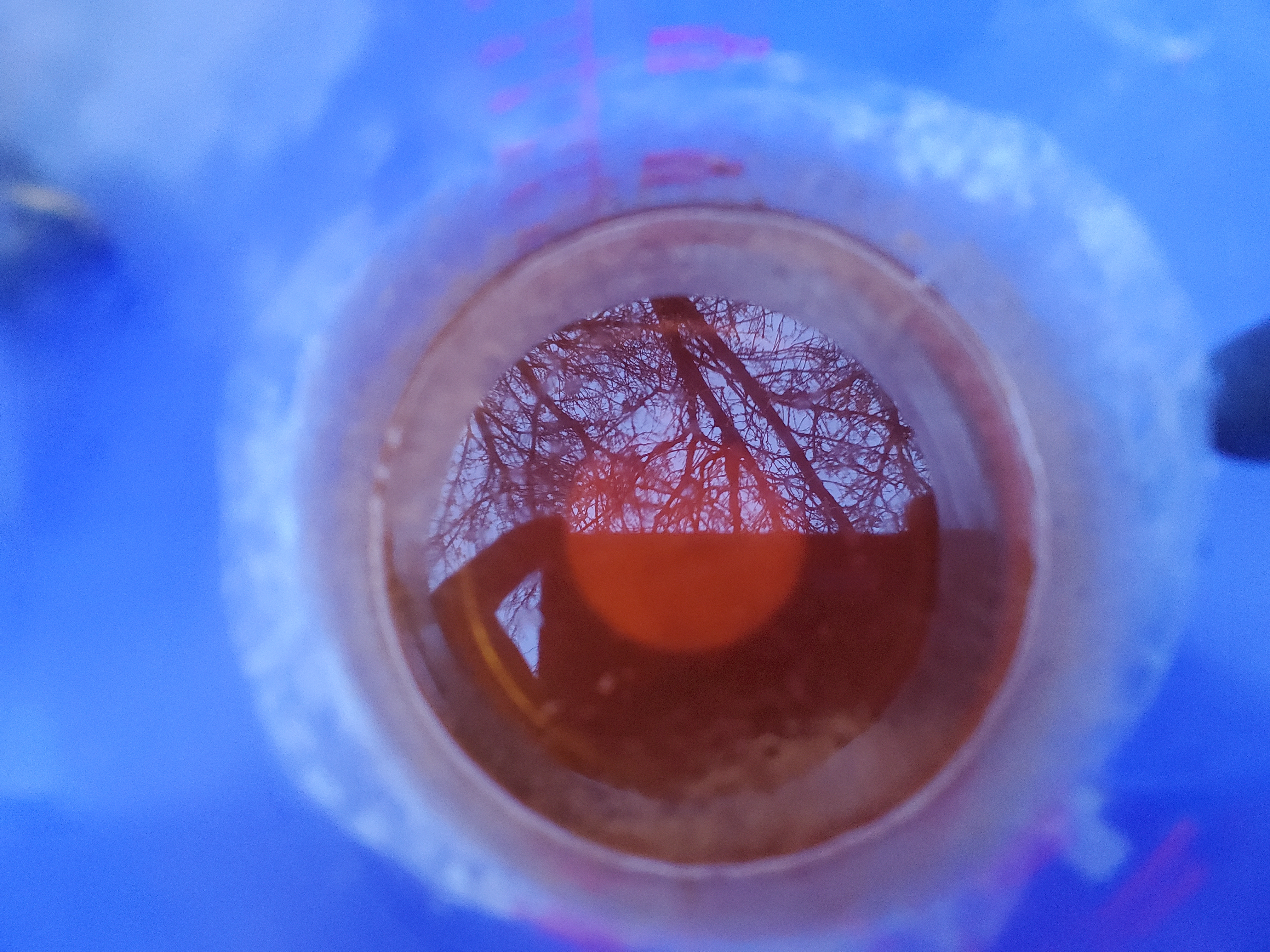

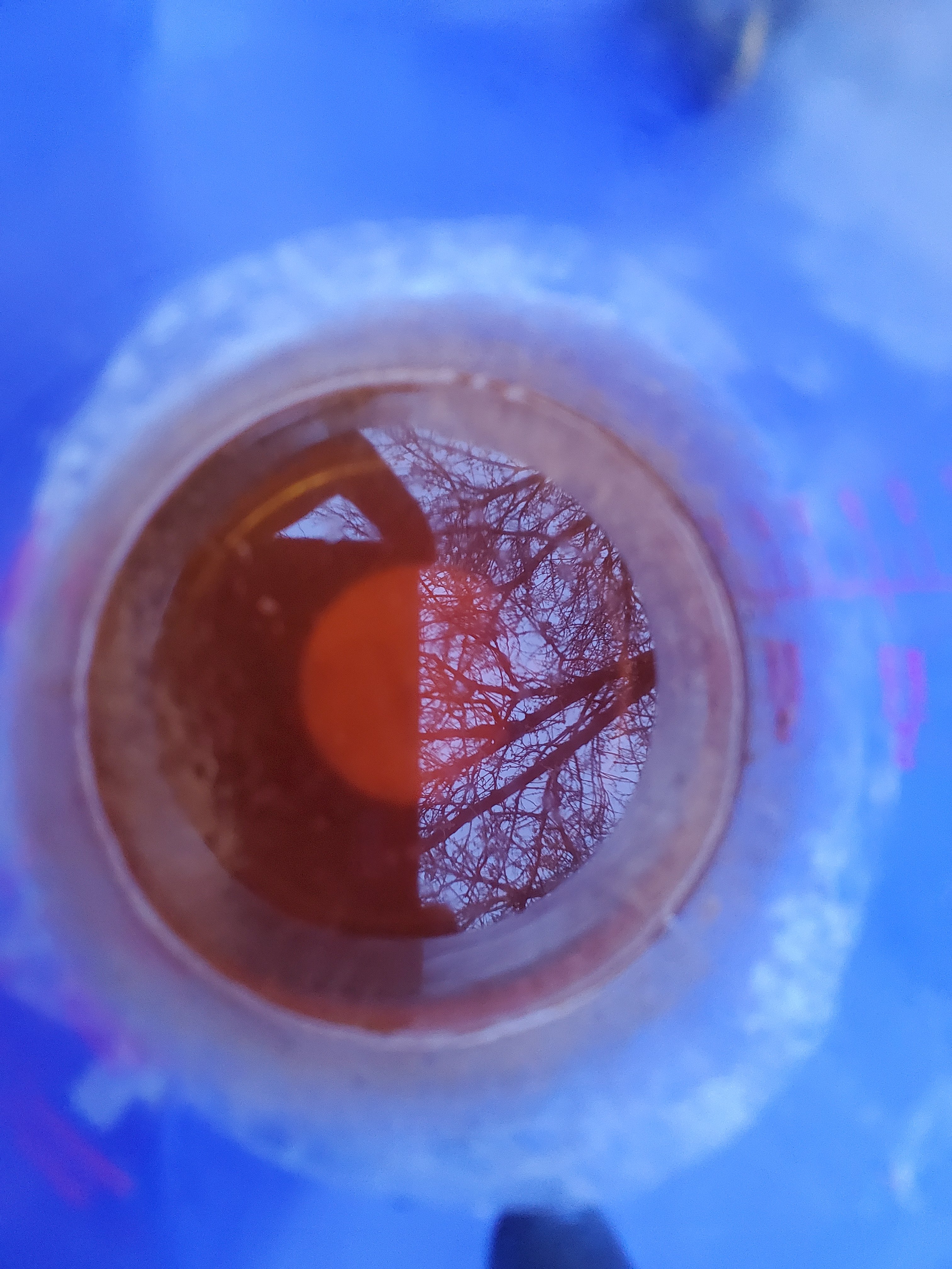

Drained the catch can @ 2056kms. 4 ounces of fluid came out, going to wait till 4k for the next drain but so far the can may only have to be drained every oil change or 8000kms.

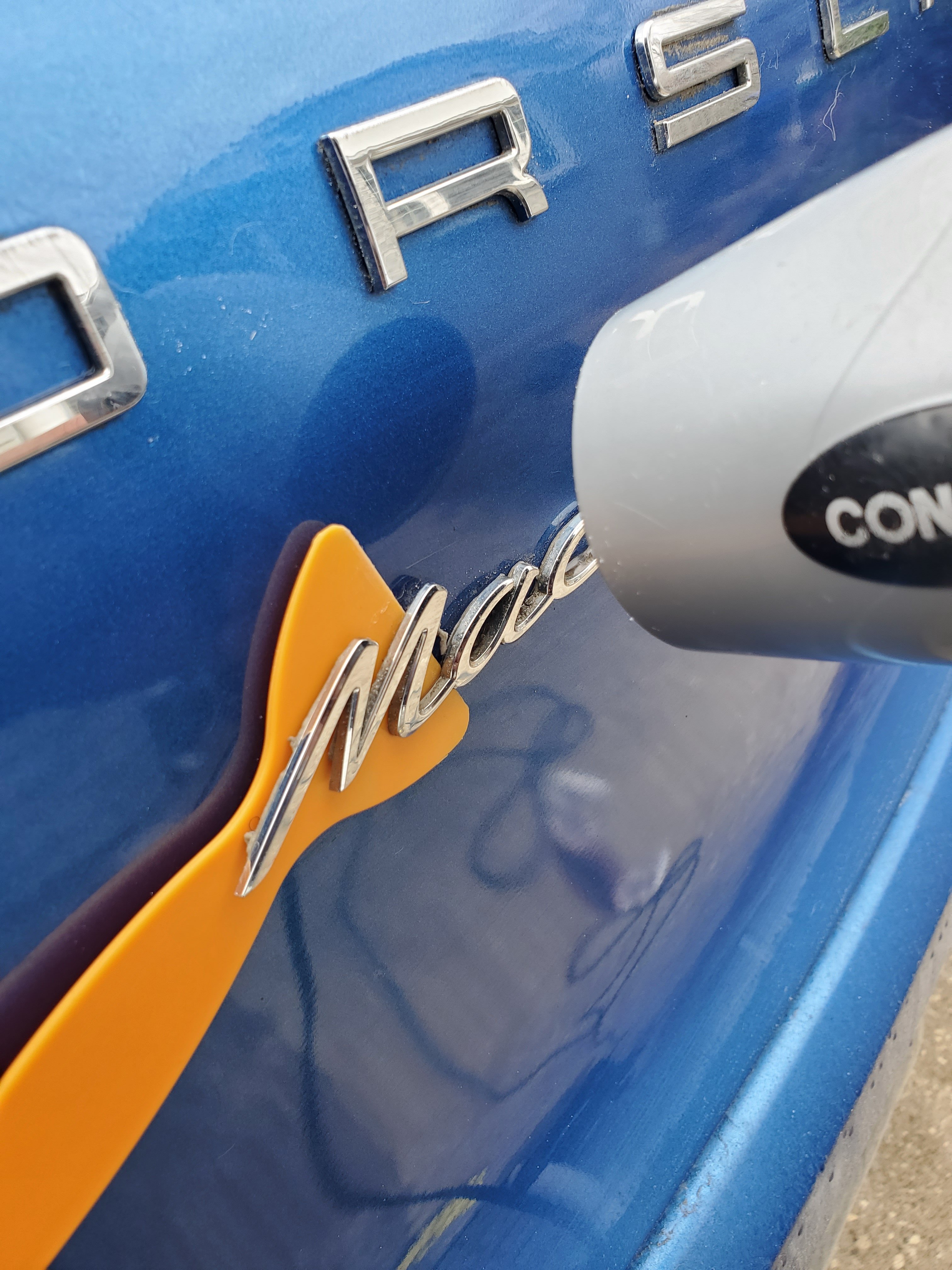

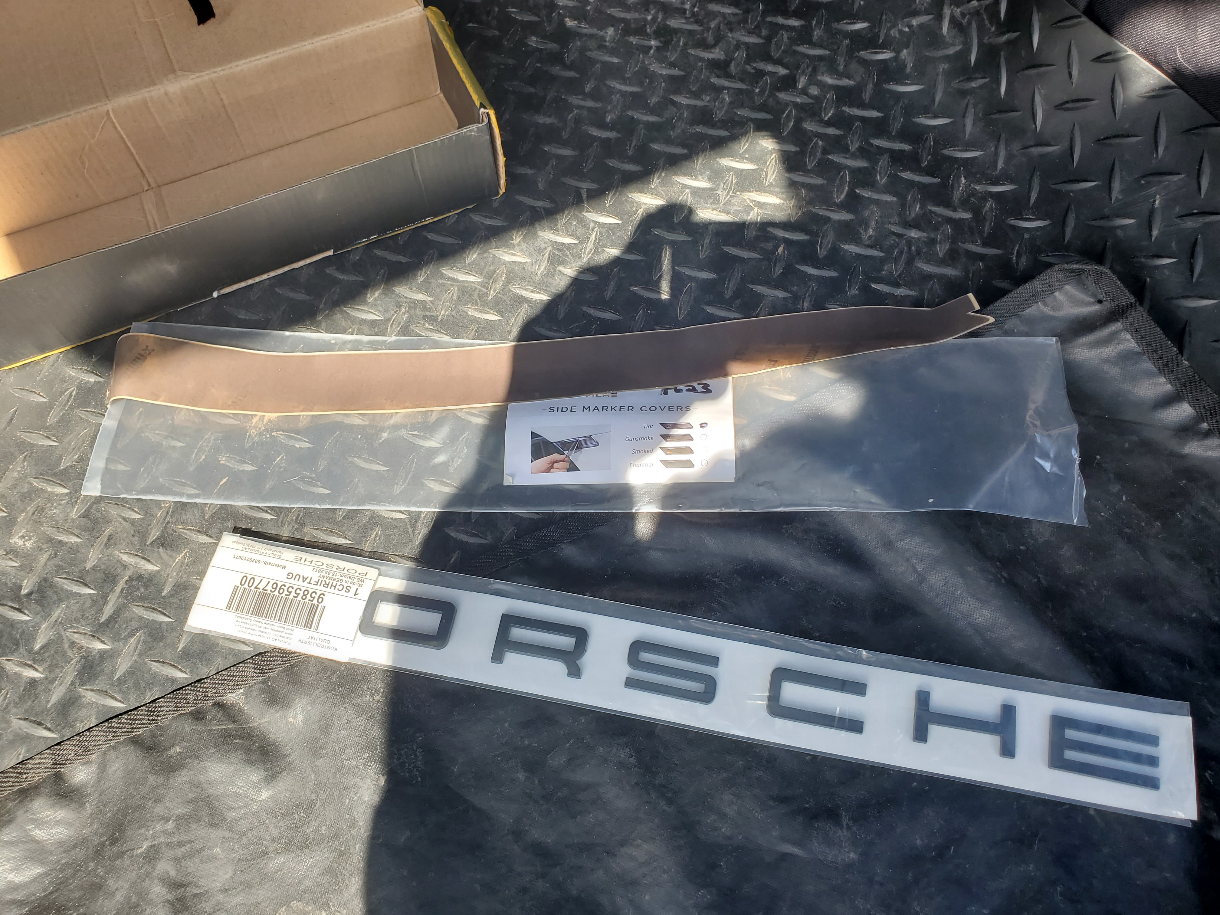

Did the model designation delete & installed smoked Laminex rearside marker film @Teddis had laying around & he also gave me black Porsche badge.

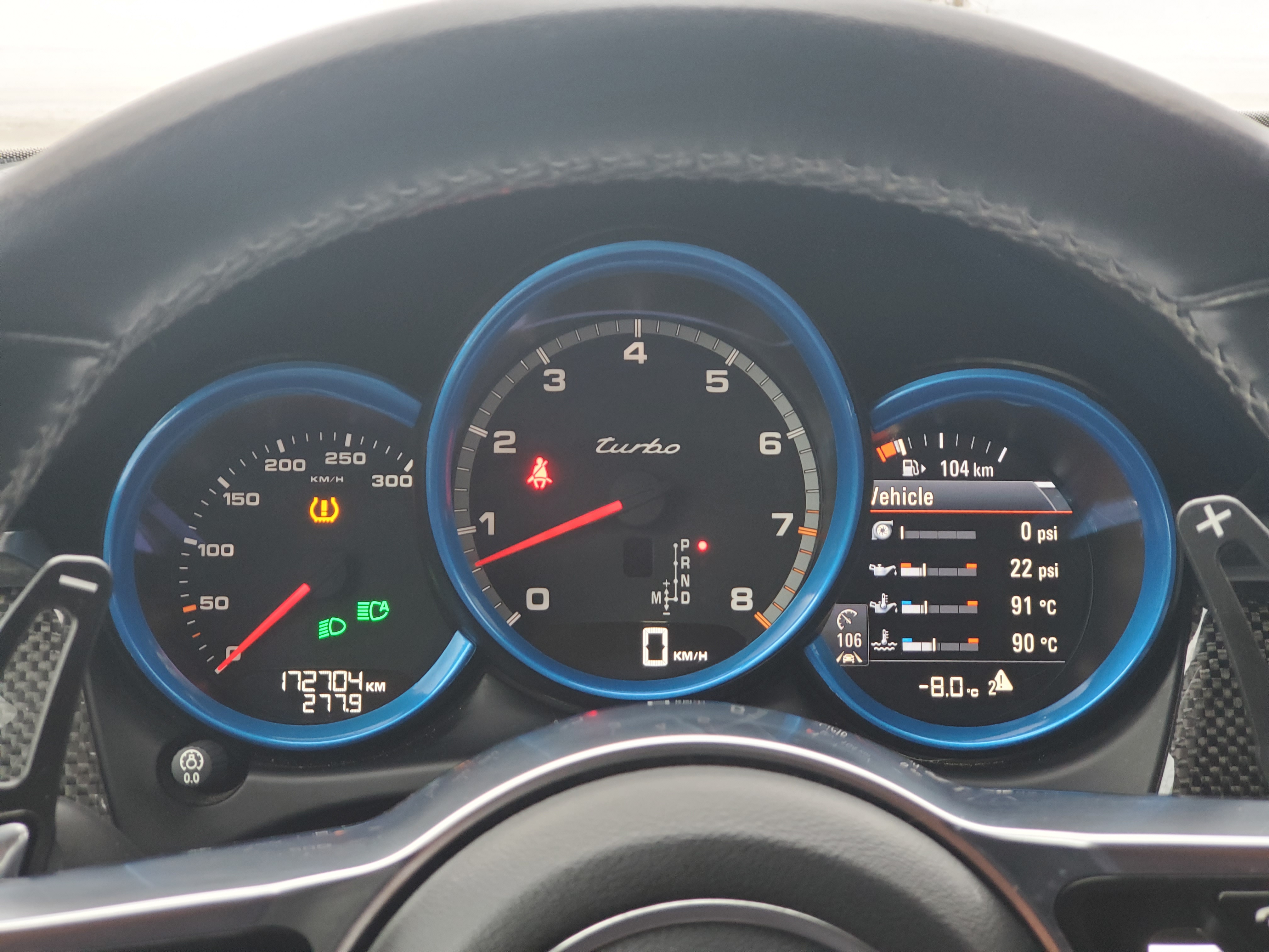

Also coded the following
Boost gauge display increased to 3bar in normal and sport
Coolant gauge fixed to show real coolant Temps. Details from this link: https://rennlist.com/forums/991/1283139 ... e-fix.html
To correct this I copied the X2 - X8 values over to the corresponding Y2 - Y8 fields
Adaptive brake lights. Brakes lights flash if the car senses a deceleration rate of -81.gs to .71 gs deceleration.
*Brakes Lights are currently set to flash for 2 seconds but that will be reduced to 1 sec.
