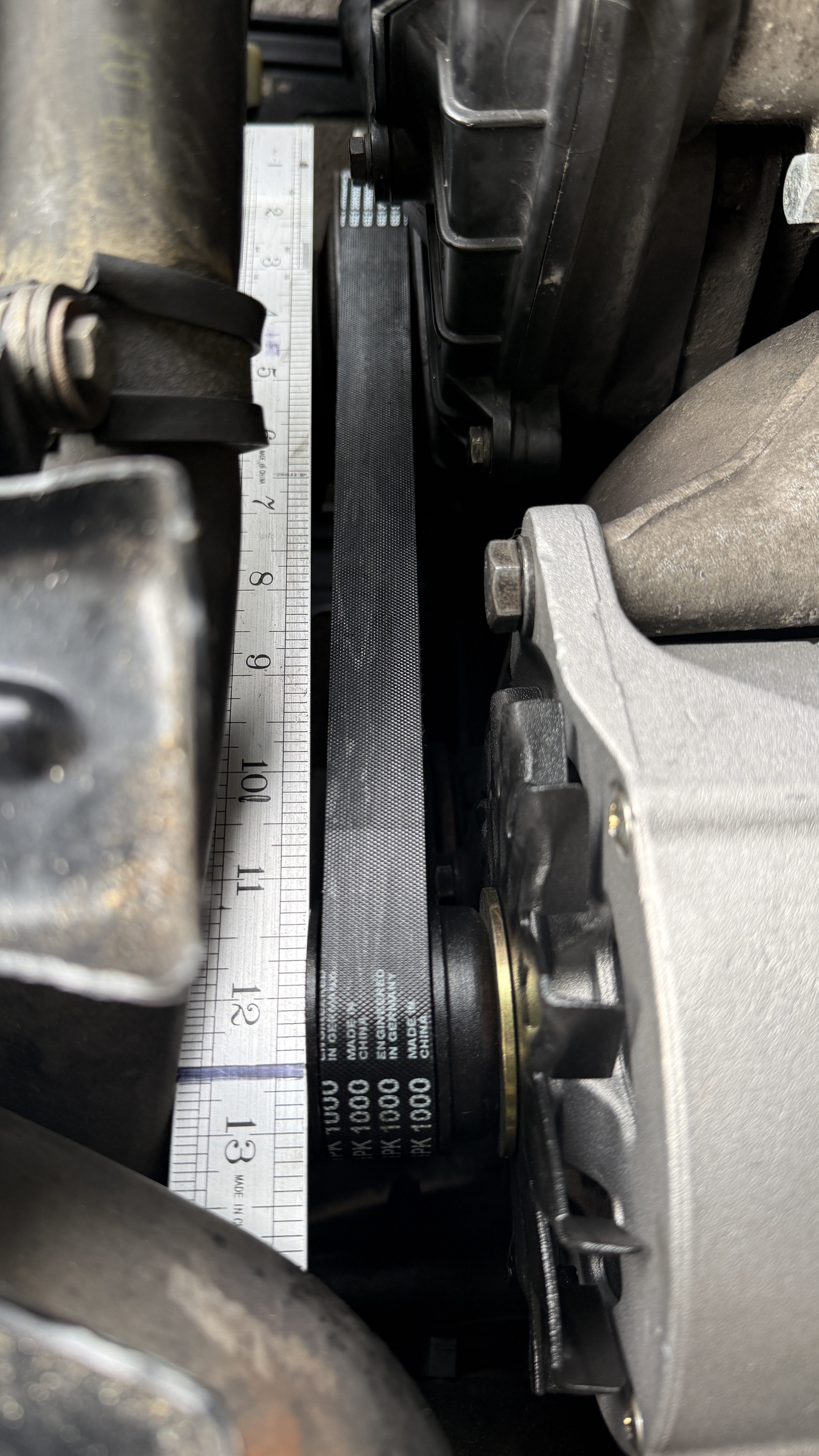

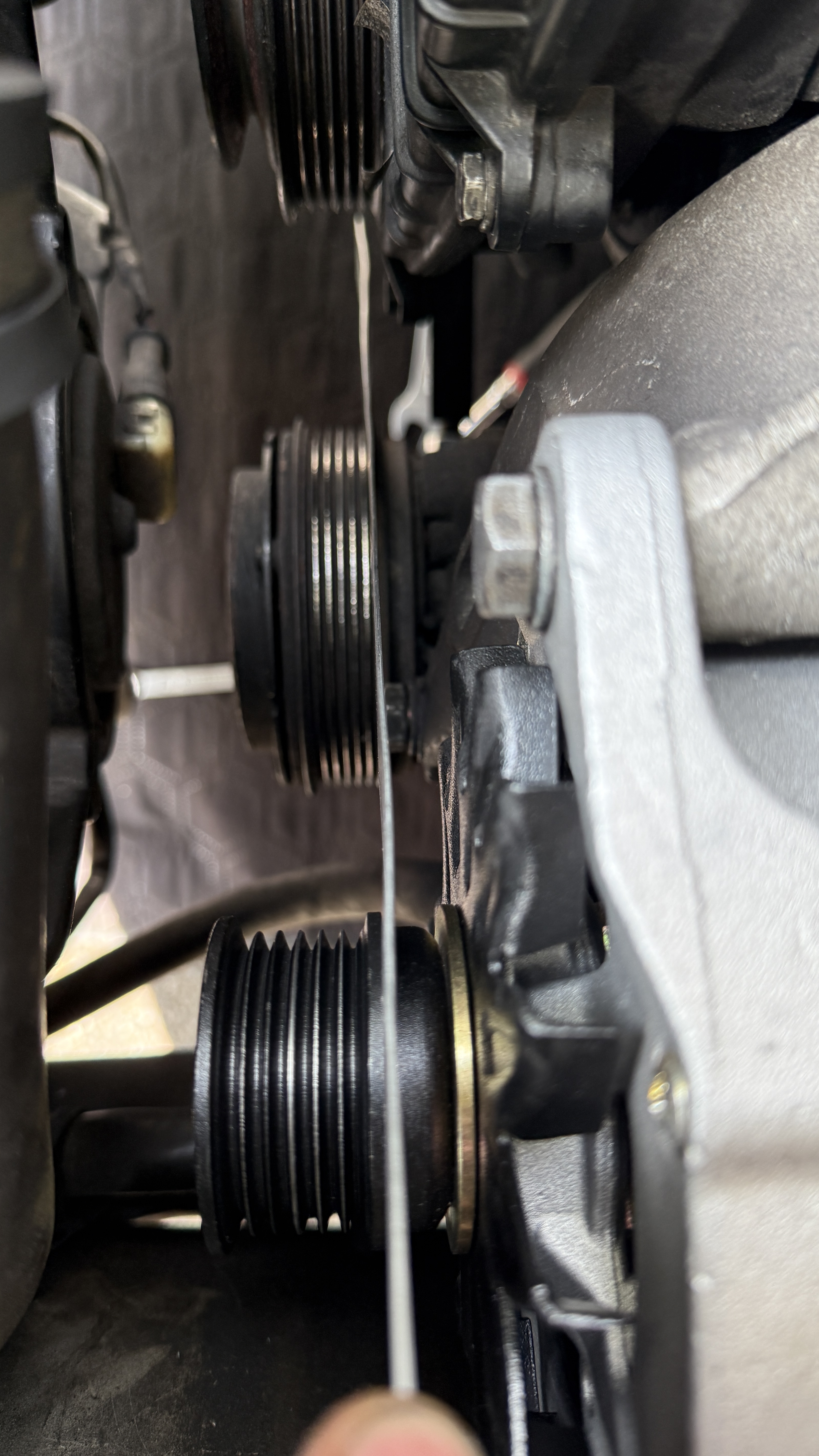

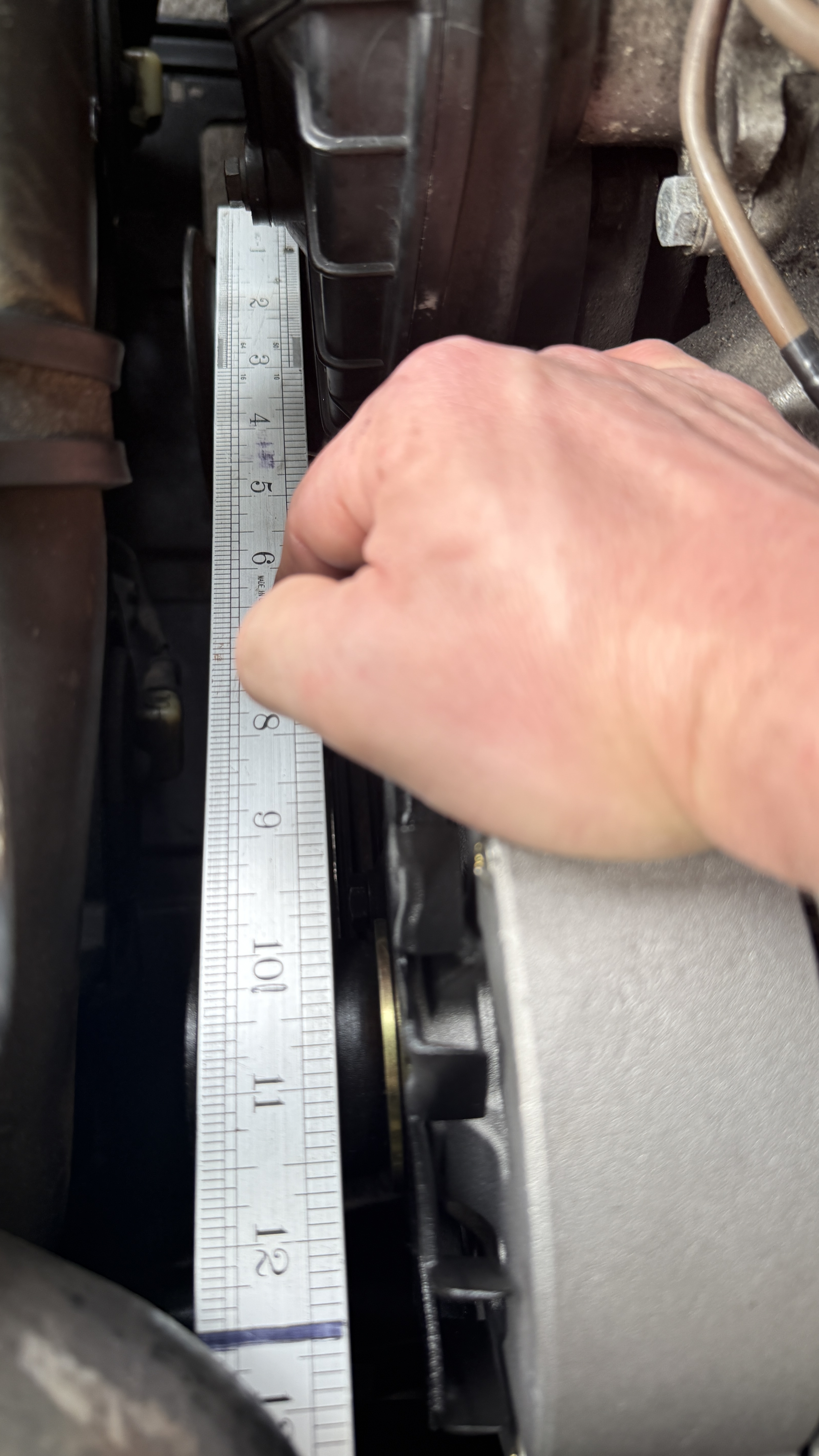

I think this is sorted now. My rebuilt alternator had a spacer in place that had the belt misaligned by a single groove... Had to pull it all back out to remove that. Took the time to clean all the pulleys, test their bearings by spinning them, and installed another new belt. Went slightly tighter than before, no squeal.
Some photos for future reference.
