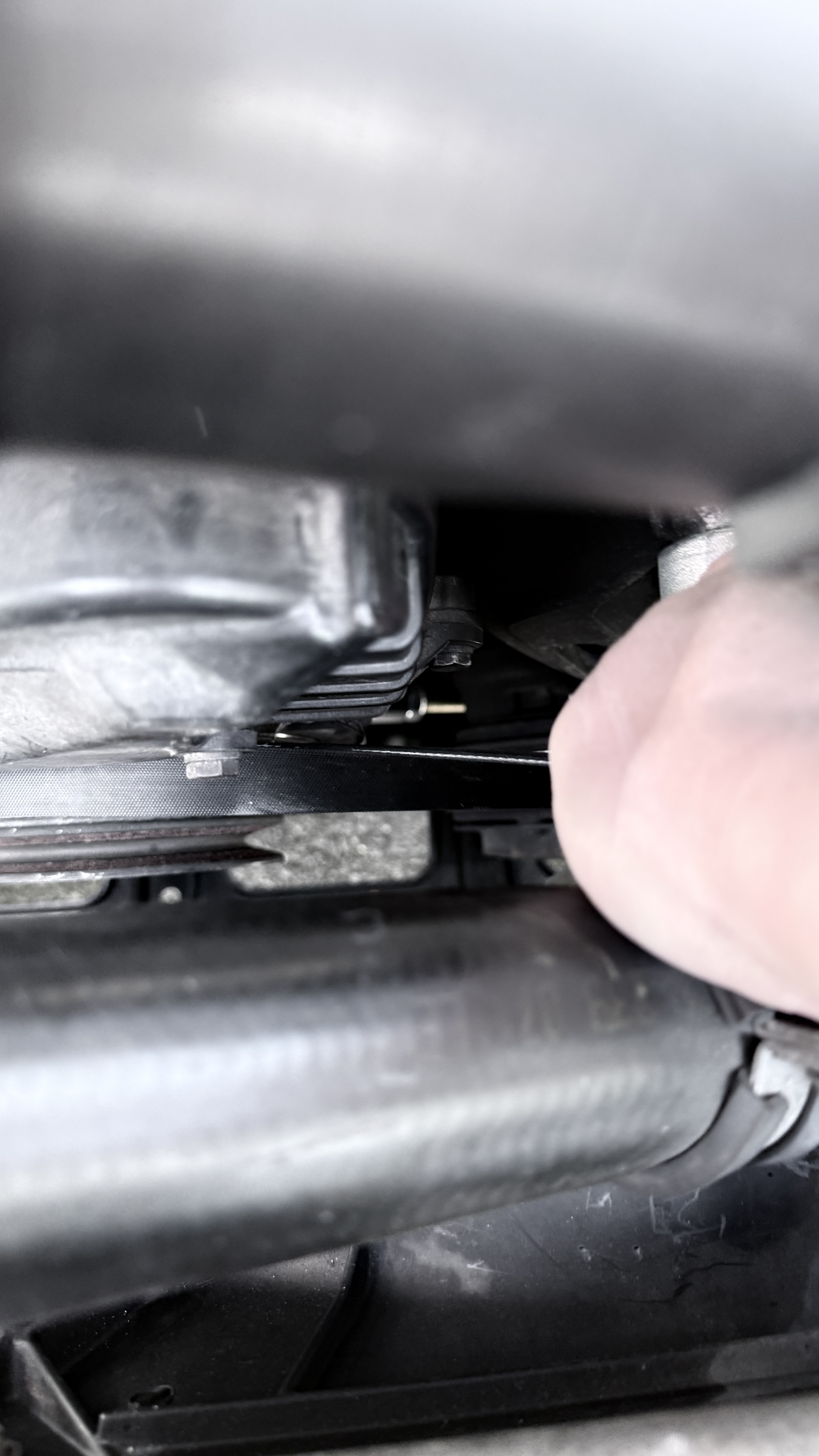

This question has been asked to death Im sure. I googled it and got a wide range of responses...
  • Use the special tool...
  • ~5mm of deflection (Old forums)
  • 2mm deflection (NC944er youtube)
  • 1/8 to 1/4 twist (Old forums)
  • "Wicked" tight...
Looking for the Carpokes opinion here. I just changed my alternator and put on a new belt and tensioner rod, Im somewhere between 2-5mm (hard to tell, seems like 5mm) or 1/4 twist... Dont want to stress any bearings, but its definitely wicked tight...
Crap photo of the twist method.

The factory tension level is crazy tight. I've tried it with the official tension tool and It just seems excessively tight to me. Here's mine right now. This is probably 3 or 4 turns of the turnbuckle below the factory spec -- maybe an 8 or 9 on the tool. Been doing it this way for decades with no squeal or other apparent problems.

Tom wrote: Mon Apr 27, 2026 10:46 am The factory tension level is crazy tight. I've tried it with the official tension tool and It just seems excessively tight to me. Here's mine right now. This is probably 3 or 4 turns of the turnbuckle below the factory spec -- maybe an 8 or 9 on the tool. Been doing it this way for decades with no squeal or other apparent problems.
@Tom How did I know it would be you, and damn, a youtube video that didnt come up when I searched Google. You are on top of it!
Your twist looks similar to mine... maybe even less twist then I have going on... so I guess I'll just leave it as I have it for now.
