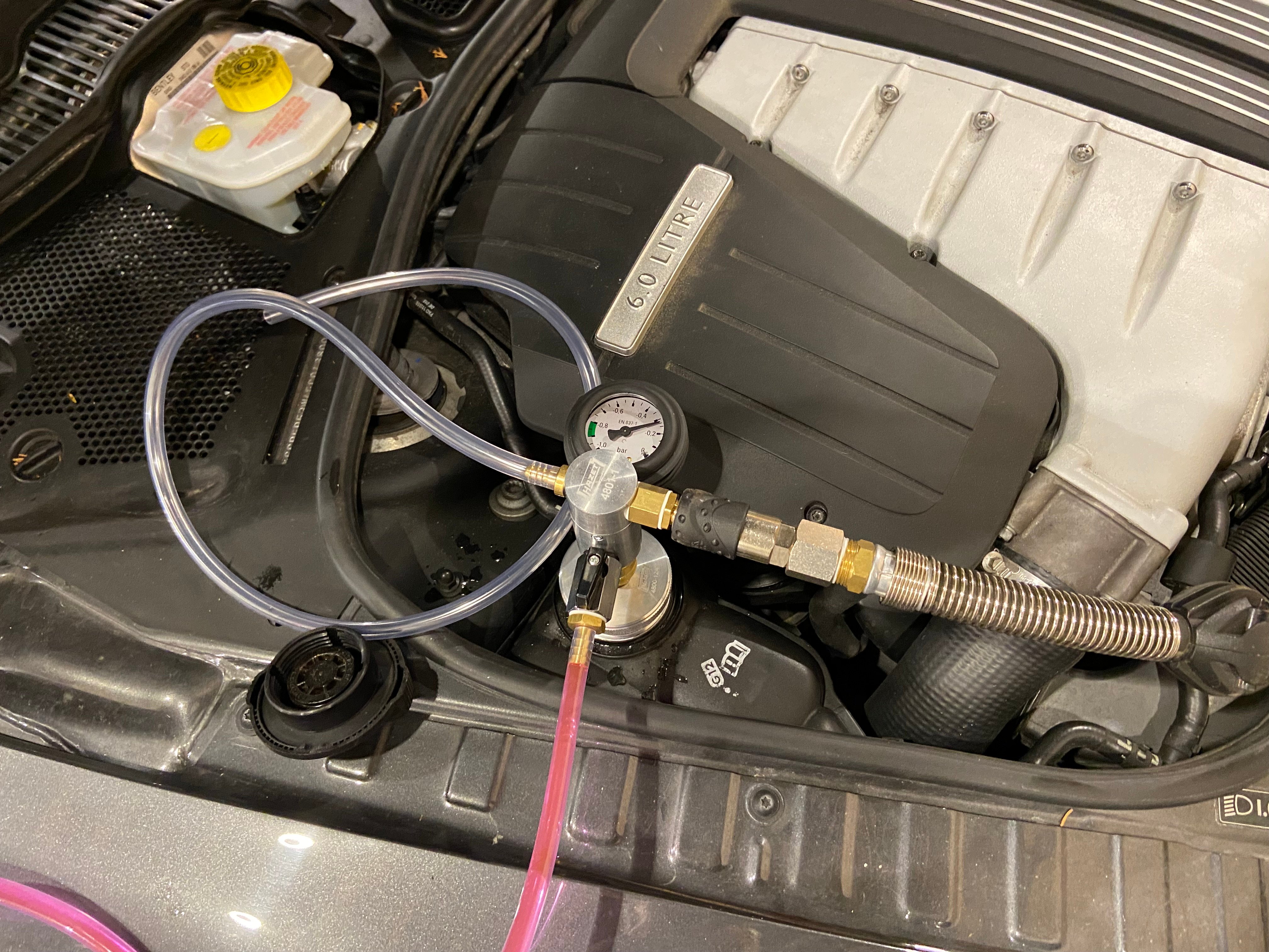

I've had decent luck bleeding my 944 a couple of times.
But I had to get a vacuum filler for the Flying Spur W12, so I'm looking forward to trying it out on the 944 next time around....

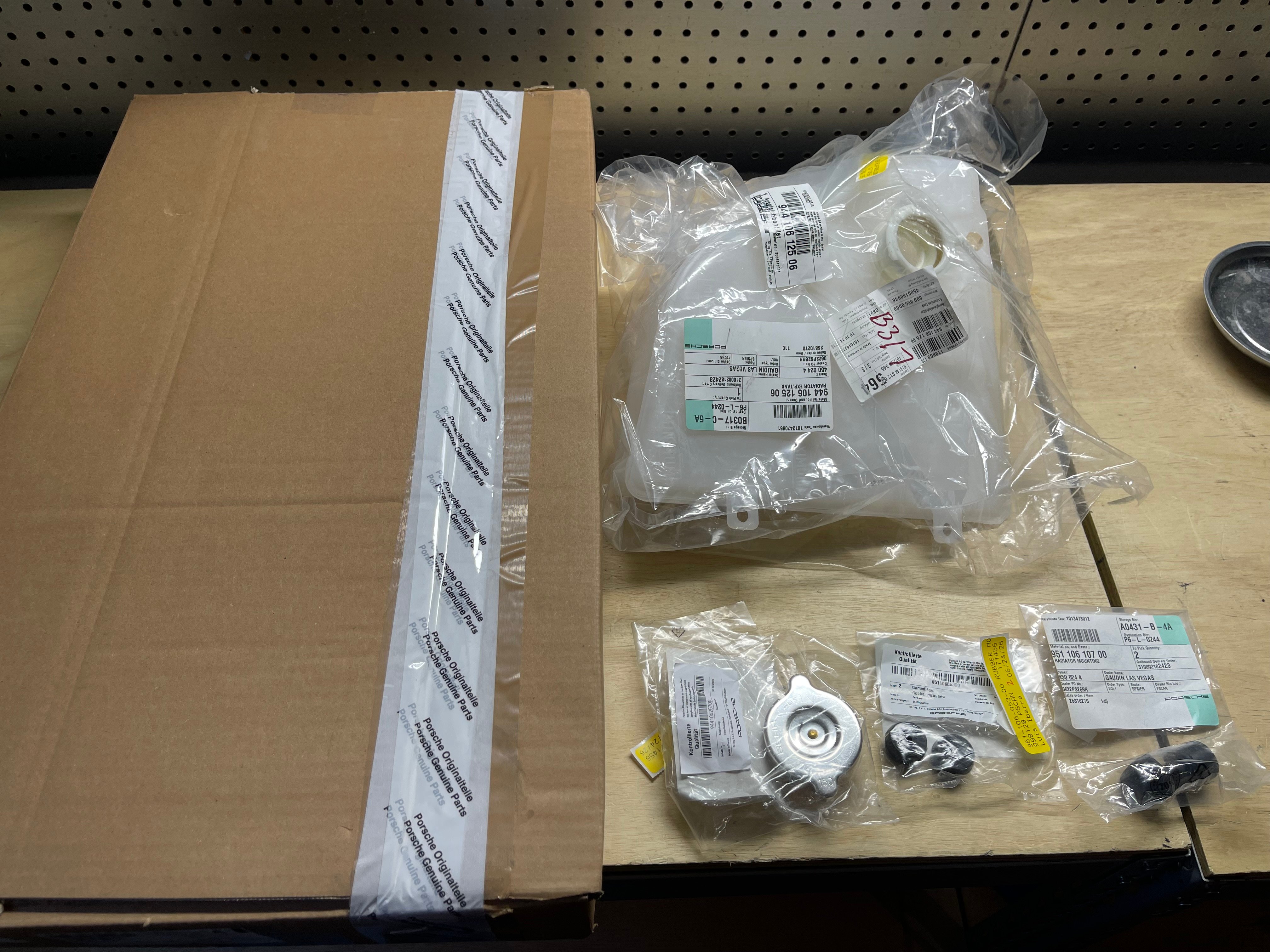

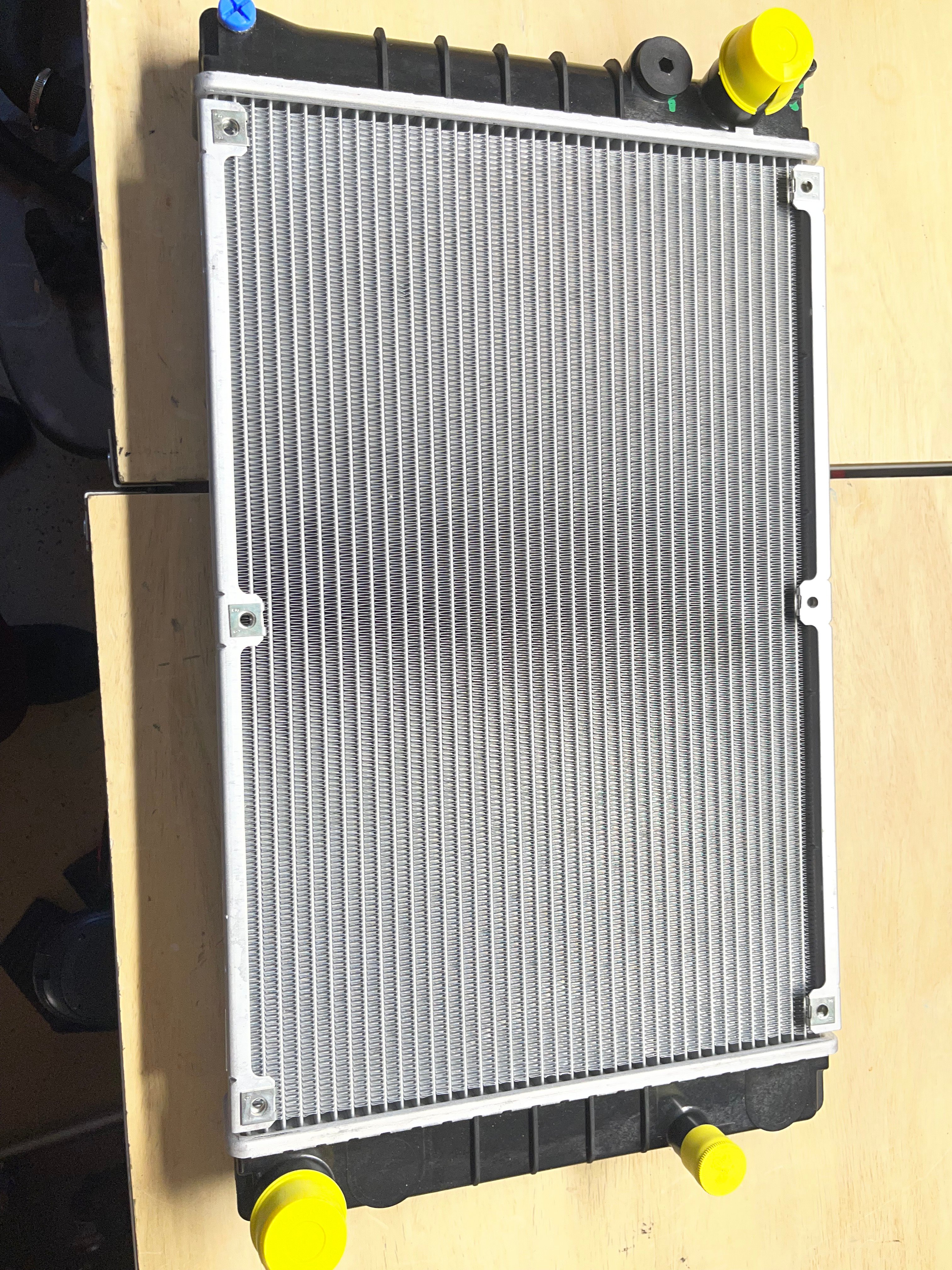

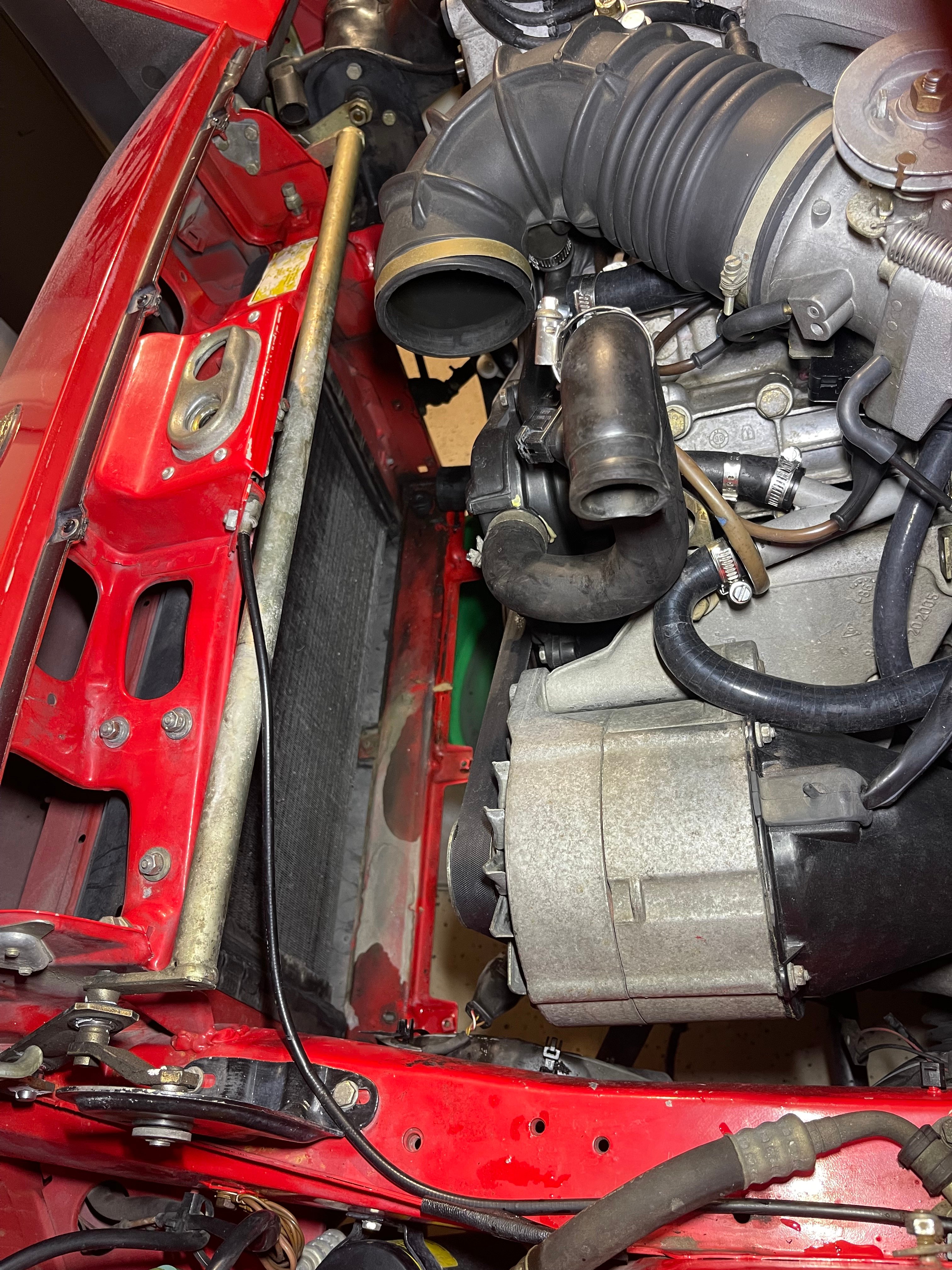

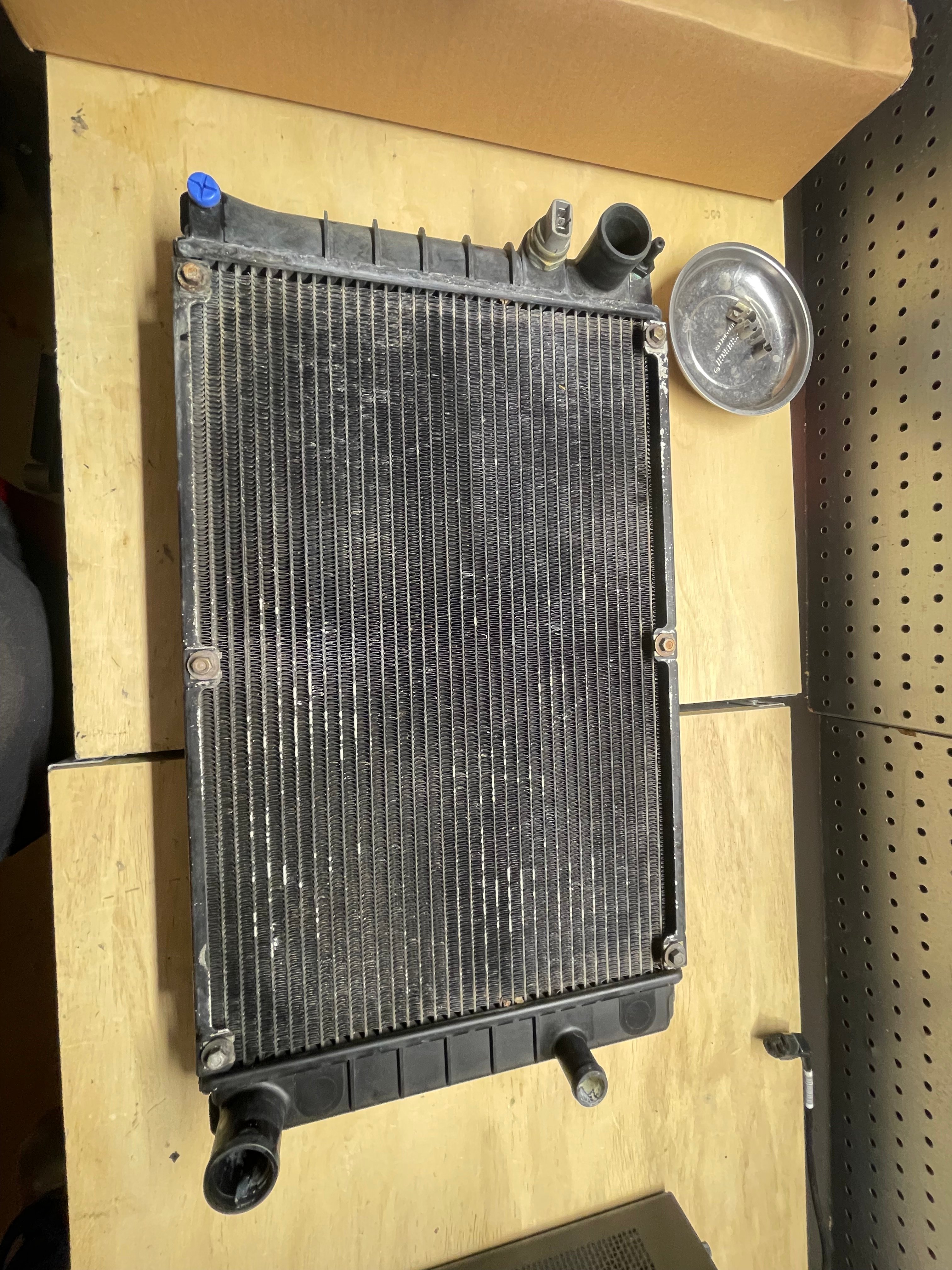

Your superpower is definitely strong, Tom :lol: Just got a new radiator along with the rest of the parts to finally wrap up the cooling system restoration.
Taking out the radiator was actually pretty easy. I’ve been in that area so many times that getting to it felt second nature. All I had to do was loosen the bolts on the left and right at the top, no need to remove them completely. Then I tilted the radiator forward, lifted it up off the grommets, and slid it down and out from the bottom.
The old radiator doesn’t look too bad. I might take it to the radiator shop, see if it can be repaired, and keep it around as a spare.

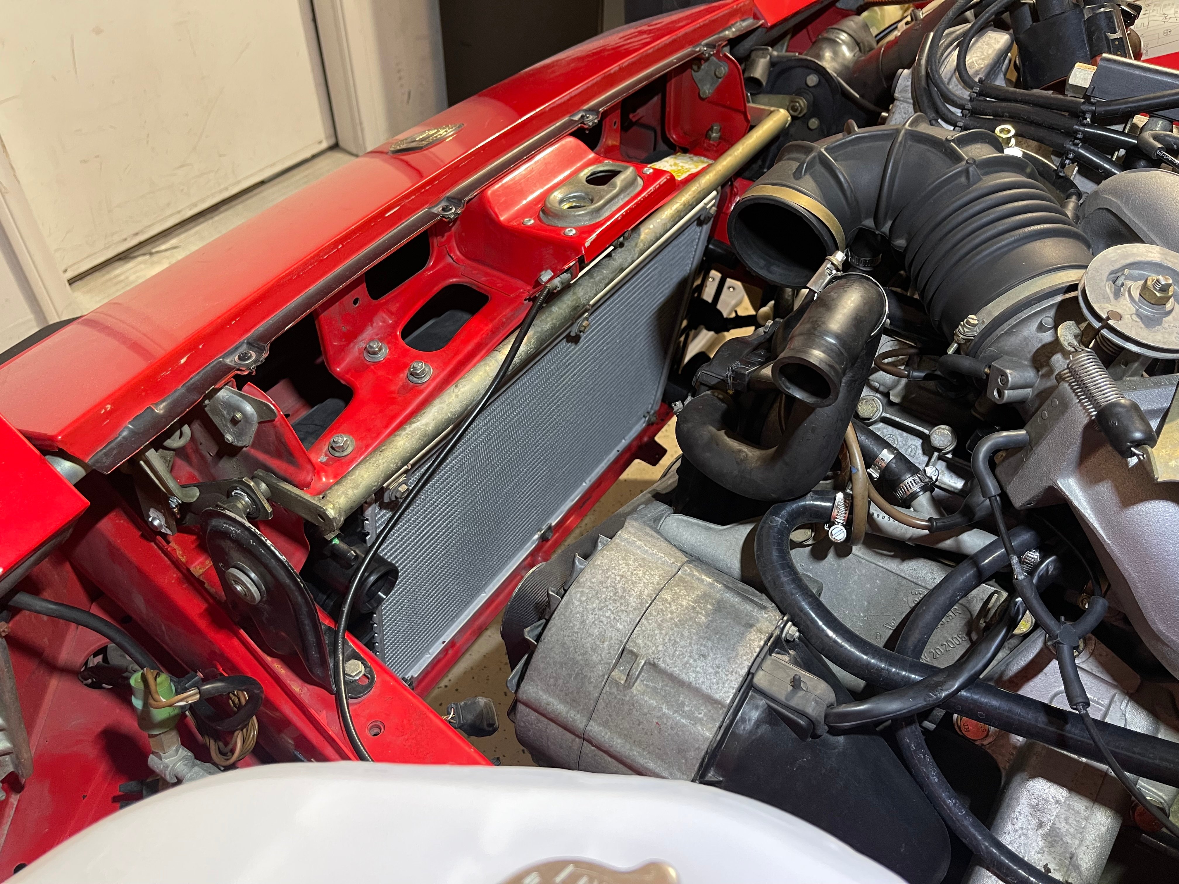

libarra82
Posts: 58
Joined: Fri Dec 19, 2025 2:17 pm
Been thanked: 12 times
New radiator is installed. Forgot to get a new crush washer for the fan switch. Will have to wait a few days for it to arrive to finish the project.

jeyjey
Posts: 94
Joined: Sat Apr 25, 2026 7:28 pm
Has thanked: 36 times
Been thanked: 36 times
If the old crush washer sealed, then it's good-to-go till the next time you have to remove it. (Crush washers don't have much of a habit of failing in service, with the possible exception of banjo bolt unions.)
