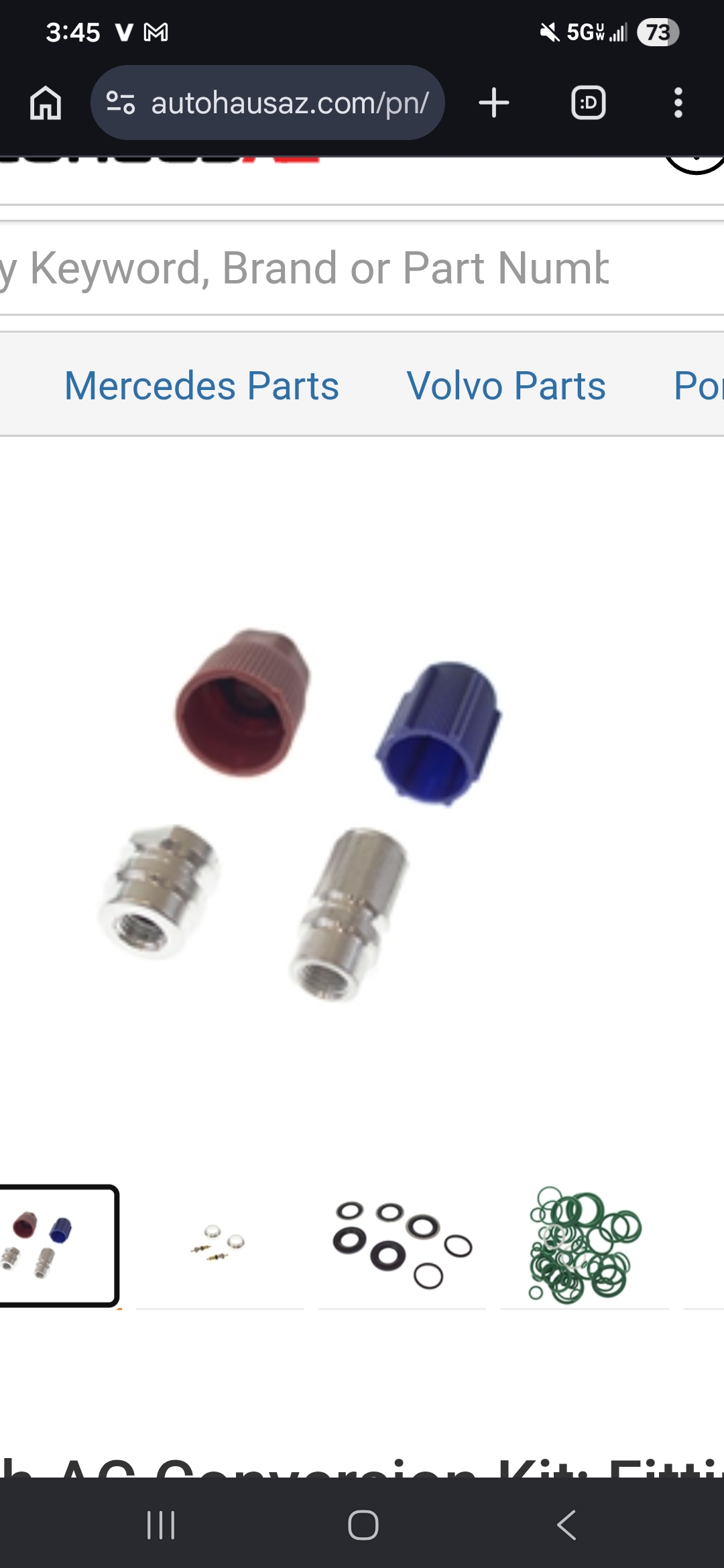

Is there an R134a conversion sticker under the hood anywhere?
As @dr bob and @Tom have mentioned, it's a pretty good bet your system has been "converted".
I use quotations because of the sealant putty on your Drier.
What that kind of tells me is that there may be a good chance the o-rings weren't changed out for the proper green ones.
If you unscrew the blue cap, the fitting should look like this.
The red cap should be on the compressor.
Cheers

On the 928S4, the high-side service port is on a bit of tubing just upstream of the receiver/dryer, in front of the condenser on the passenger side. That's the red cap on converted cars. As the OP's pictures show, the low-side service port is on the compressor suction side plumbing from the expansion valve at the evaporator. With everything in place, access is inconvenienced by the upper radiator hose, the air intake hose to the air filter housing at the rear of the engine bay, and a couple cooling system vent hoses that pass to the passenger side fender wall. I used a 90º "conversion" fitting on the low side, and it makes connecting the service hoses a LOT easier.
The little hose manifold plate on the compressor itself has service ports on it, but with the compressor installed there's zero chance of actually using them. Regardless, the Schrader valves in those ports, the o-rings inside the service caps, and the o-rings between the manifold plate and the compressor housing all need to be swapped as part of the conversion. The two between the manifold plate and the compressor escaped replacement (same as: I didn't even know they were there) until the new oil caused them to swell and fail within a day. So dumped the refrigerant charge and some of the oil charge in a matter of seconds. Back to the garage, removed the compressor, new o-rings again including the hoses and the ones that failed, another 24 hours with vacuum on it, then new oil and refrigerant. Fine ever since, about 28 years ago now give or take a couple days.
I knew that.
Not sure why I wrote what I did.
My apologies if I confused anyone.
