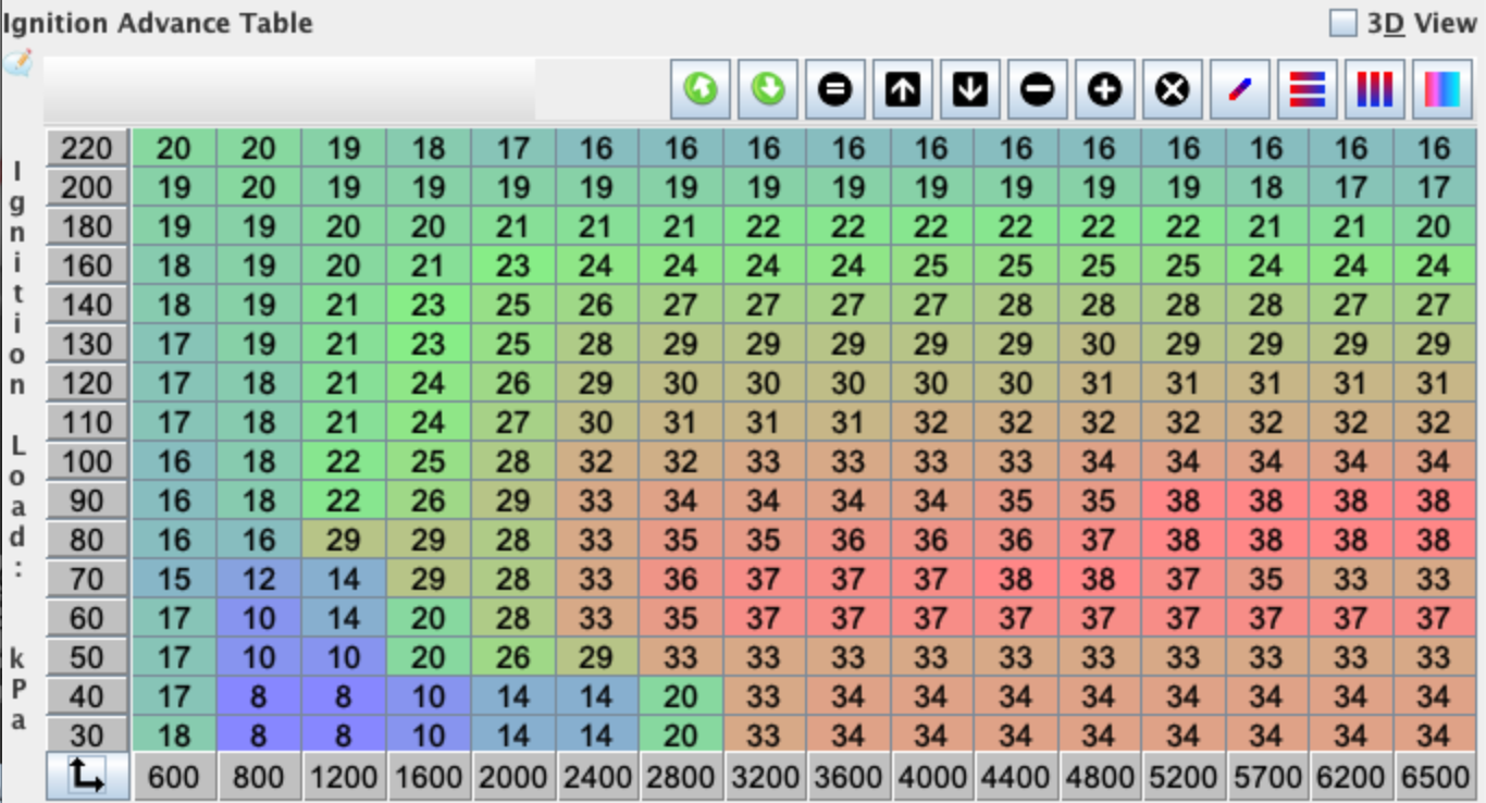

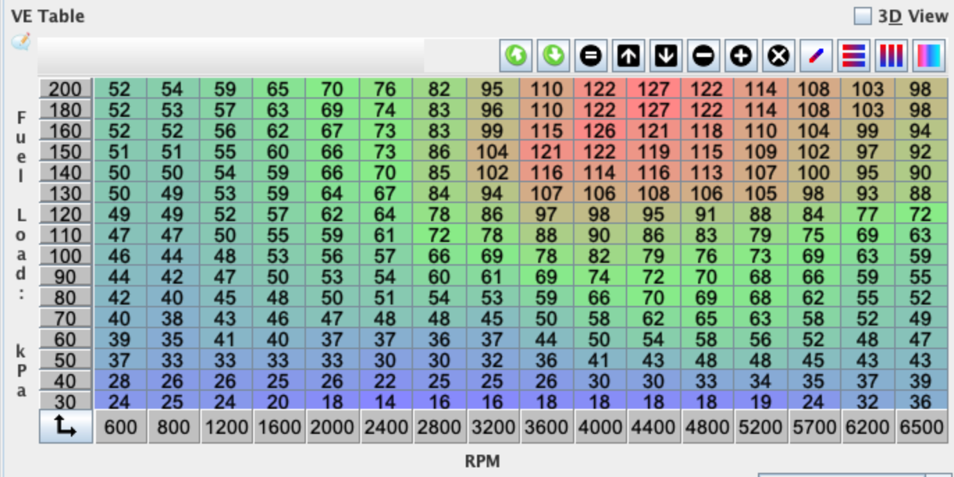

Not sure if it's helpful, but here's my latest VE table. Still refining, and with my current setup and tired wastegate I can't boost above 160kPa, but the rest is a decent reference for a stock 951 - 2.5bar FPR, OE injectors, AFM still mechanically in place (though fuelling is based on MAP).
Screenshot 2026-04-26 at 7.06.41 PM.png (545.31 KiB) Viewed 269 times
Screenshot 2026-04-23 at 4.20.35 PM.png (442.15 KiB) Viewed 321 times
edit: may as well include ignition table
Screenshot 2026-04-24 at 2.05.24 PM.png (367.1 KiB) Viewed 293 times
I've got a few more VE tuning cycles to do, and then I'm on to throttle enrichment, but these are probably close. Running conservative ignition as this ECU doesn't yet have knock control functional.

Thanks for the tables. Always good to see other reference points.
