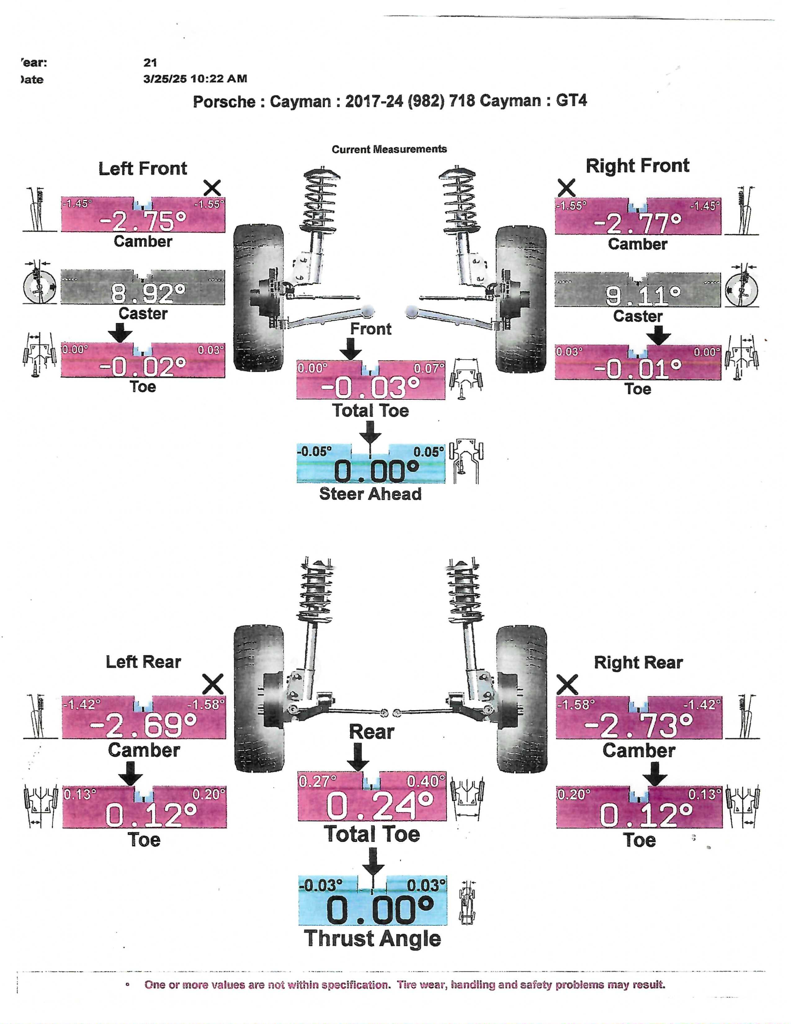

I keep mine at a max of 29 psi square approximately 10 minutes after pit-in. For on-track and the highest heat, the max pressure that I like is 32 psi or lower.
Alignment is -2.75 square for camber. Toe is minuscule toe-out (-0.02° range) and slight toe-in for the rear (+0.12° or less).
Can you read a copy of the alignment sheet if I post it here?

Yes, if you post a clear photo or screenshot of the alignment sheet I can read it and help interpret it. Best is a straight-on shot with good lighting so the numbers aren’t skewed, and include all pages if it has before/after plus ride height/corner balance notes.
Your pressure targets sound sensible. 29 psi about 10 minutes after pit-in is a good “don’t cook the tire” check, and keeping peak on-track at 32 psi or under is in the normal window for both Hoosier Track Attack Pro and PSC2 on a GT4, depending on ambient and pace.
Your alignment also looks like a solid track-biased baseline. -2.75 camber square is a common place to land on these cars with 305 rears, and the toe numbers you quoted are conservative enough to keep it stable while still letting it rotate. Once I see the sheet, I can sanity-check left/right symmetry, total toe versus per-side, and whether the thrust angle is where you want it.

The sheet is a jpeg scan of the graphical alignment print-out.

Yep, I can read it fine.
Front left camber is -2.75 and front right is -2.77, with caster 8.92 left and 9.11 right. Front toe is -0.02 left and -0.01 right for -0.03 total toe. That’s a tiny bit of toe-out overall, basically a track-friendly “alive” front end without being darty. Steer ahead is 0.00, so the wheel should be centered.
Rear left camber is -2.69 and rear right is -2.73. Rear toe is +0.12 each side for +0.24 total toe, and thrust angle is 0.00. That’s a nice stable rear setup for a GT4, and the left/right split is small enough that I wouldn’t chase it unless you’re trying to optimize for a specific track direction.
Overall this sheet matches exactly what you described and it’s a solid baseline for 305/30 rears on 11” wheels. If you ever want a bit more rotation on entry, the usual first tweak is taking a hair of rear toe-in out (still keeping it toe-in), but as-is it’s a good “fast and safe” track alignment.
