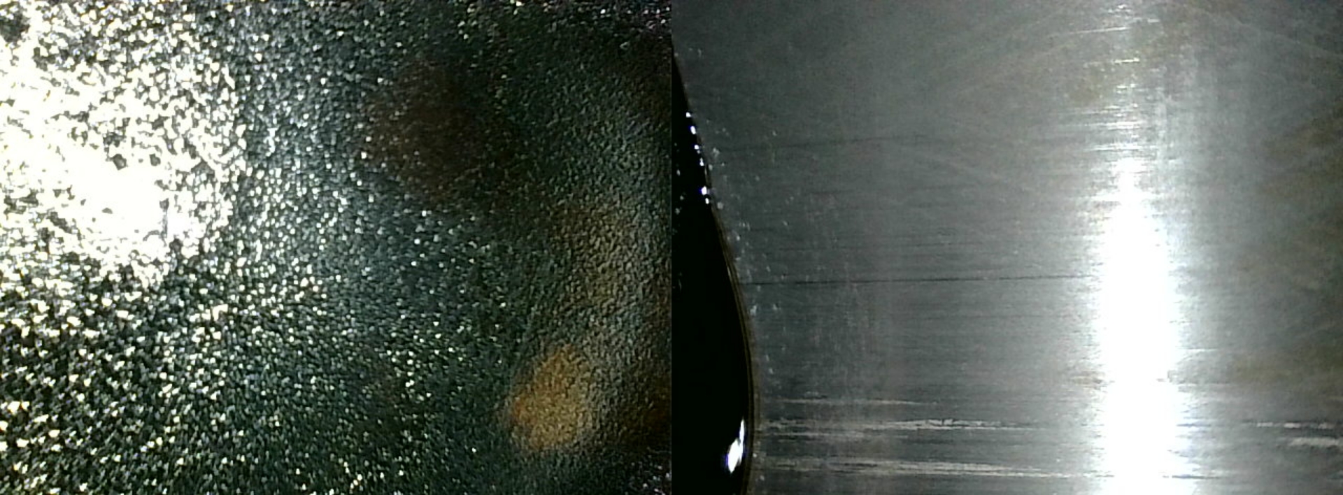

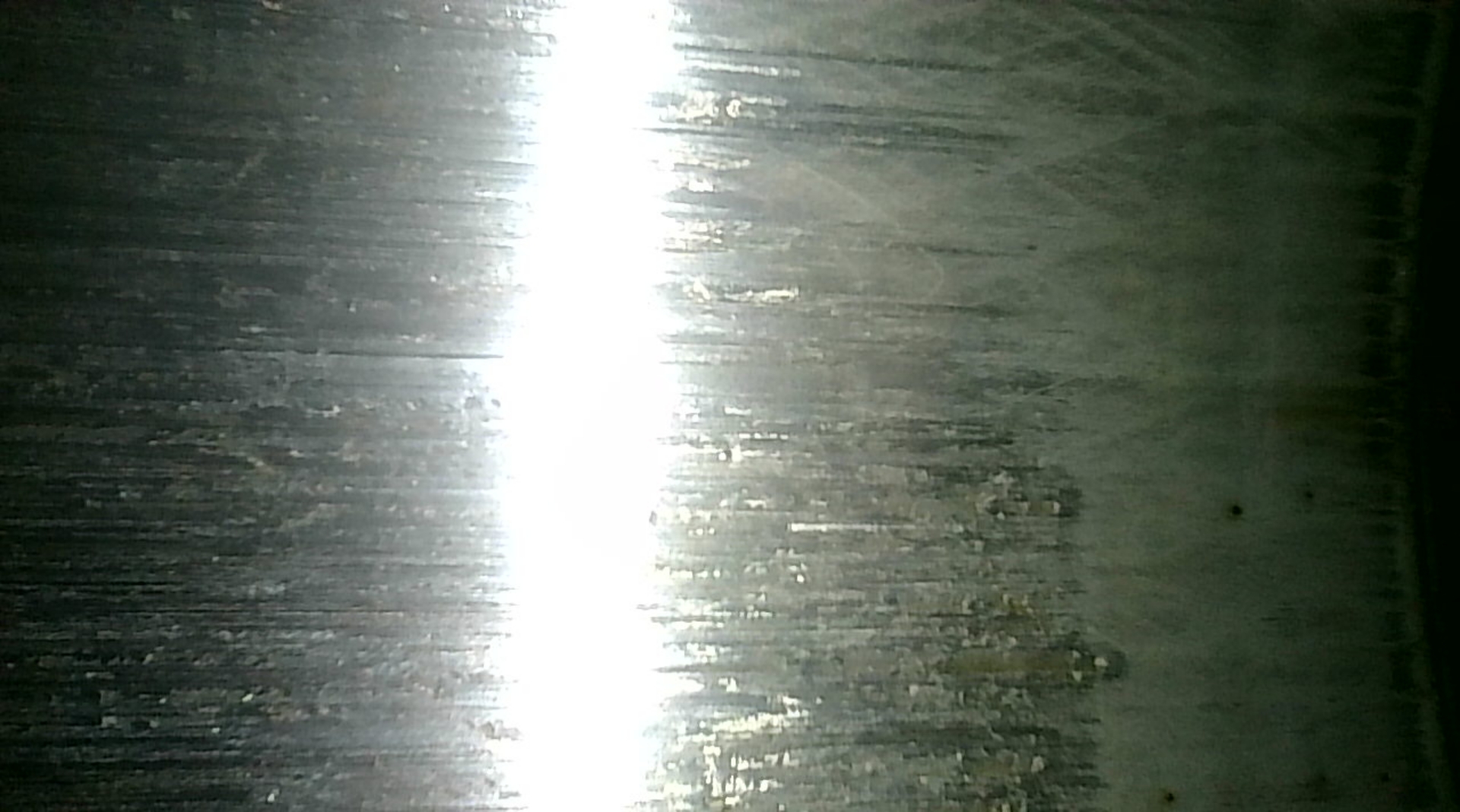

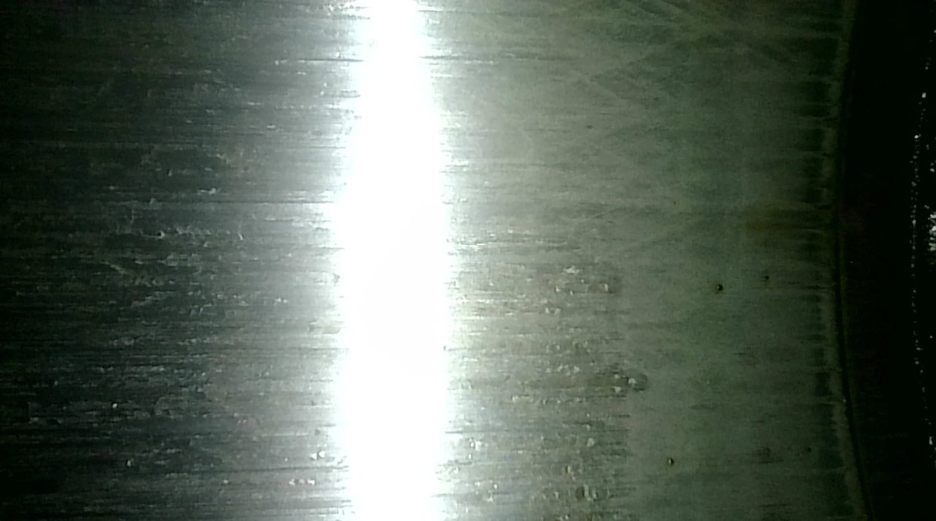

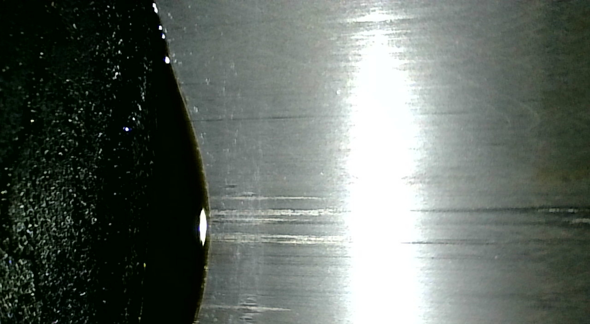

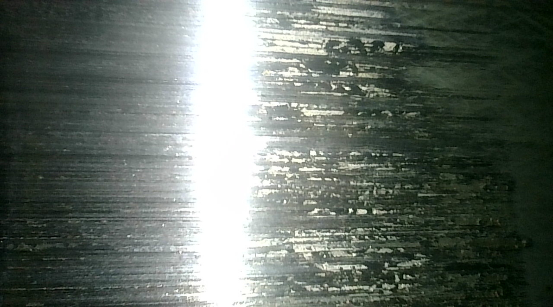

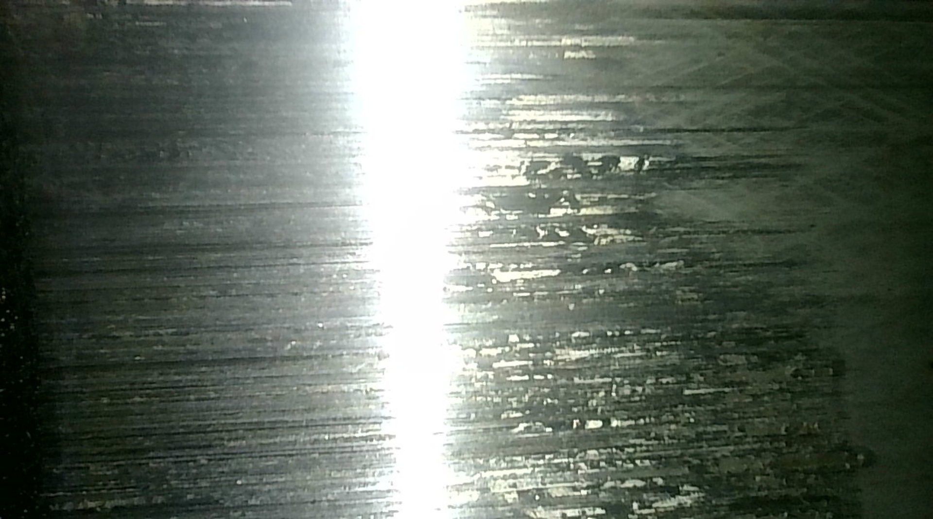

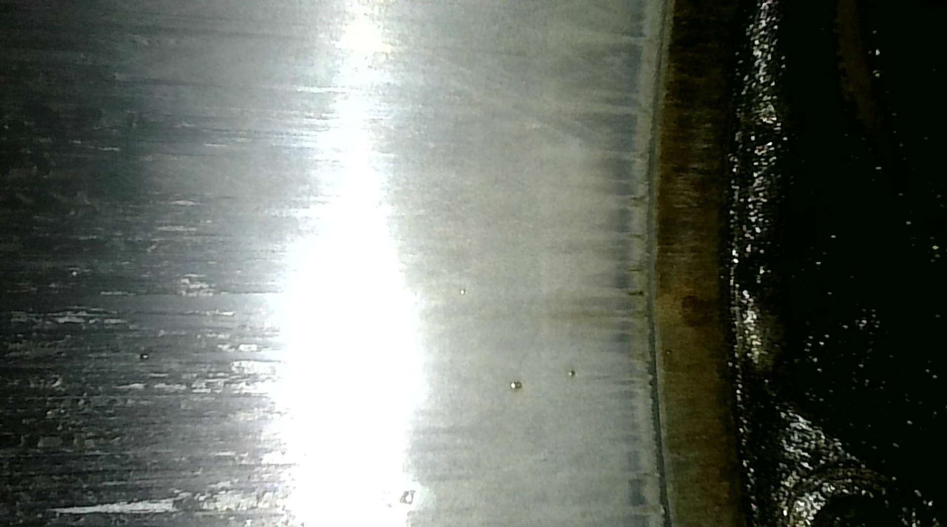

Well you win some, you lose some. This time I lose. I finally got around to scoping cylinder 6:

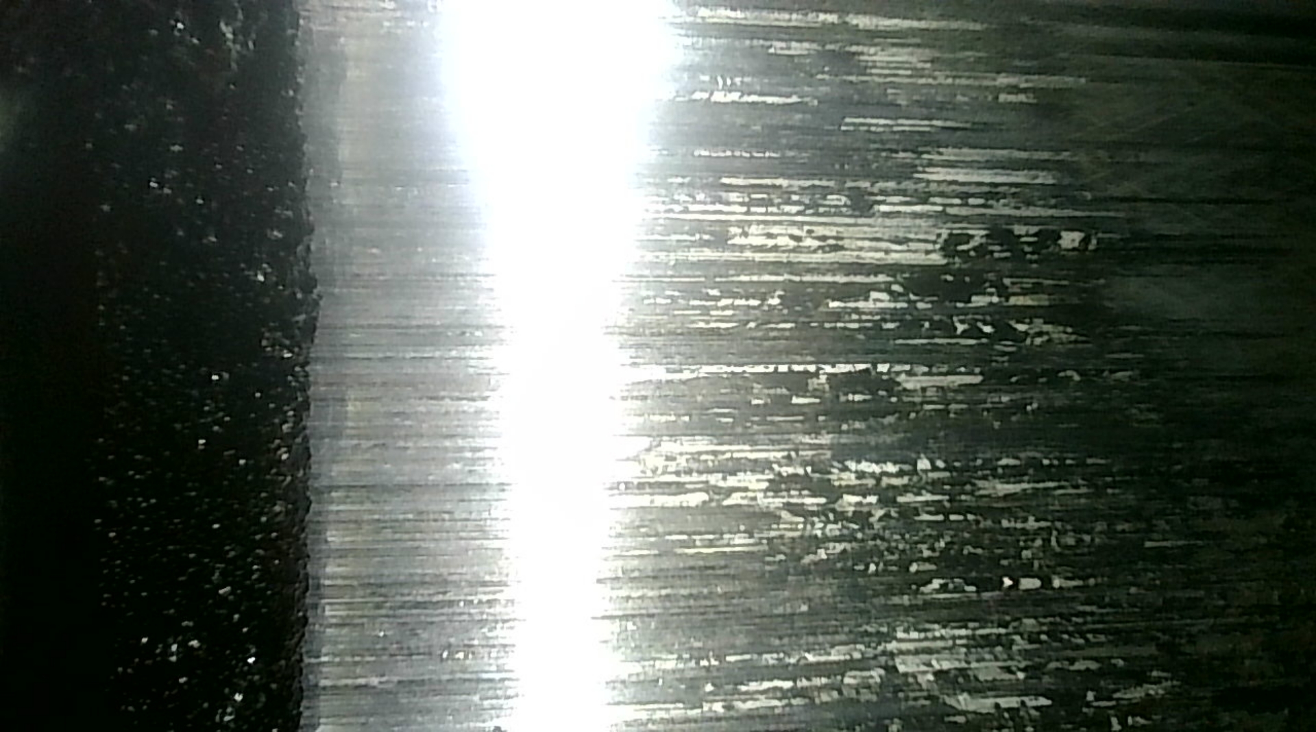

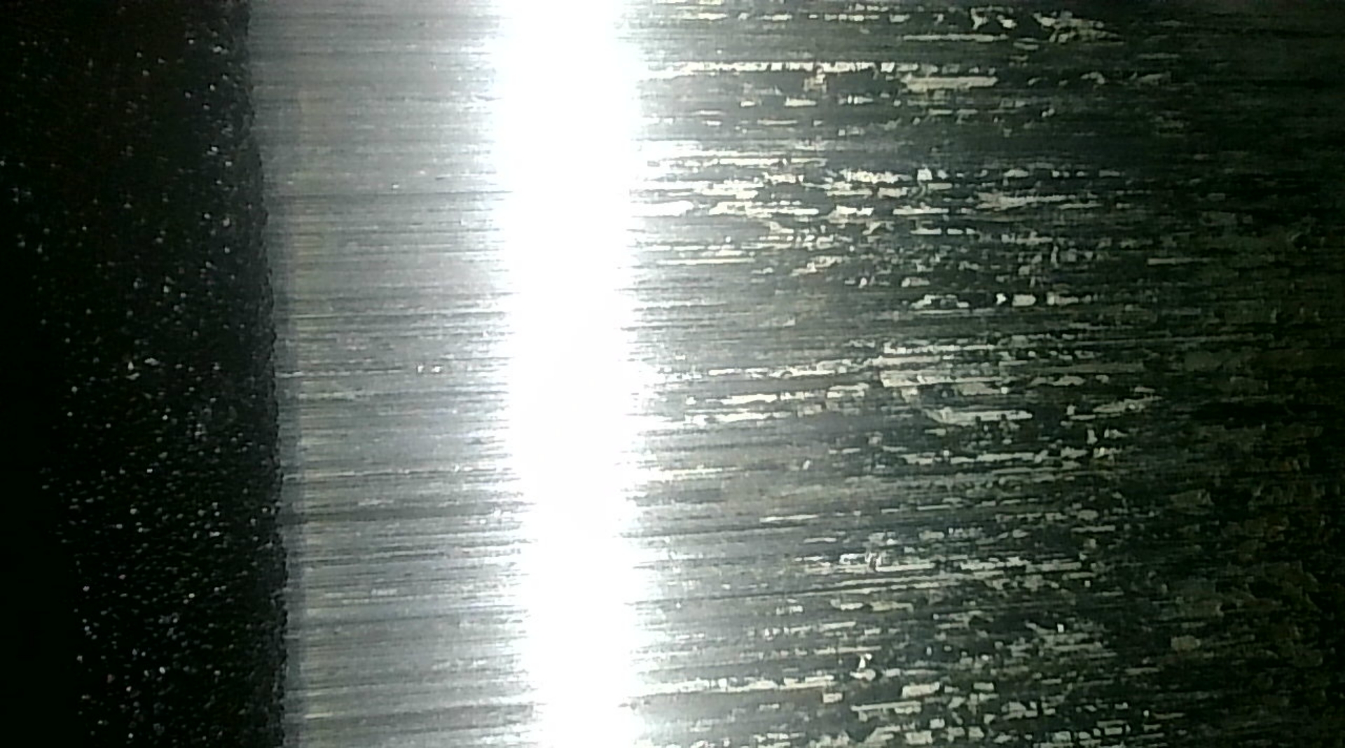

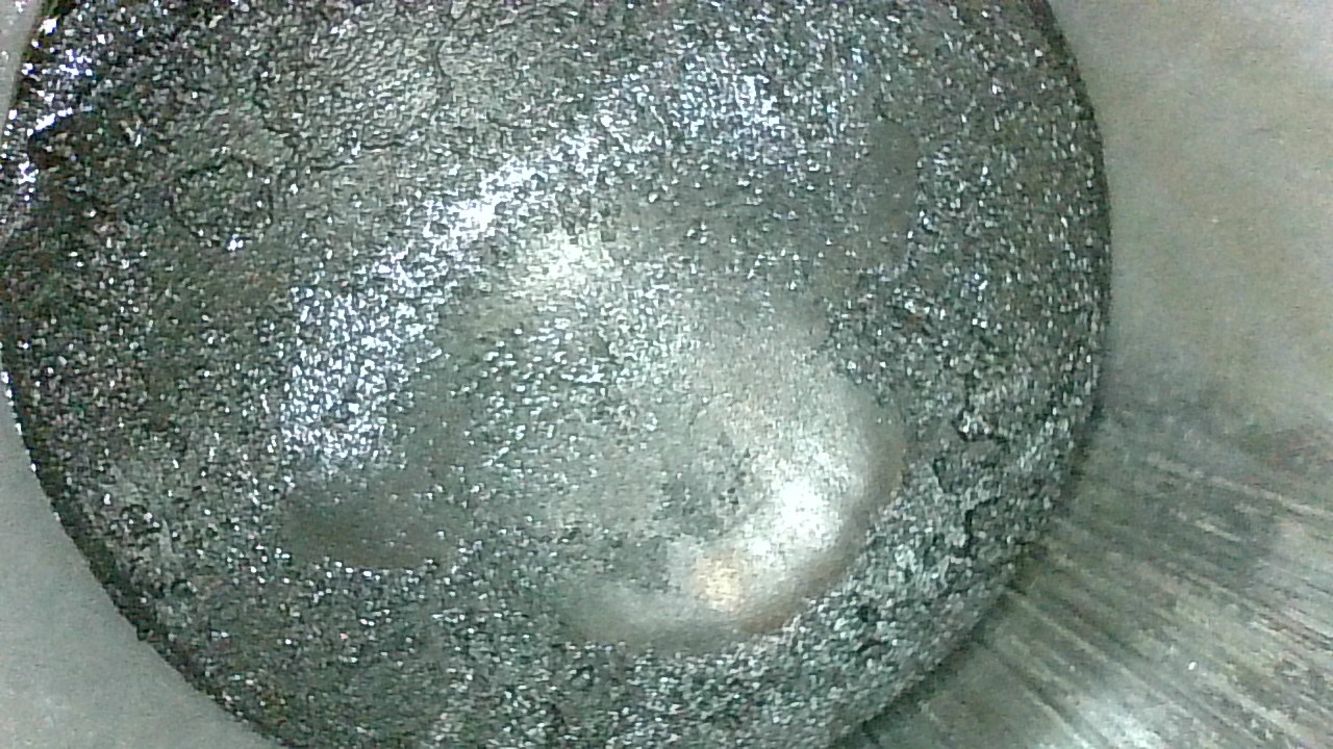

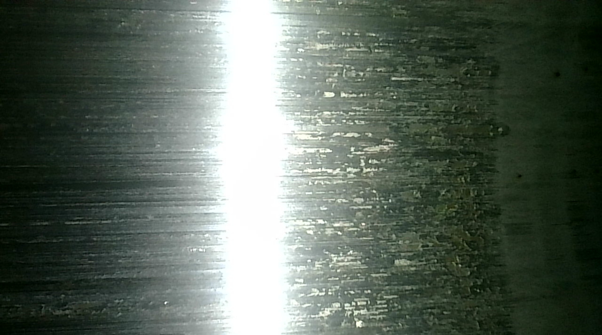

Some more pics of my scored cylinder:

I'm still preaching about warm-up management as a key to avoiding many common cylinder issues. What appears to be "bore scoring" looks a lot more like galling. The iron coatings on the piston skirts get scrubbed when the piston grows faster than the cold block. Then it's aluminum on aluminum rubbing forever, even after things all come up to temperature. Discipline with the throttle is critical until coolant and oil come to temperature. In my amateur estimation. Keep the piston small until the block grows. Counters Porsche's guidance to drive off immediately so the cats can get up to temp quickly, but might be enough to keep internal things happy a bit longer.
On your affected cylinder 6 with the particles, can you get a sample of the particles out? Long Q-tip maybe? Wash them and try a magnet to see if it's iron from the skirt, or aluminum from the galling.

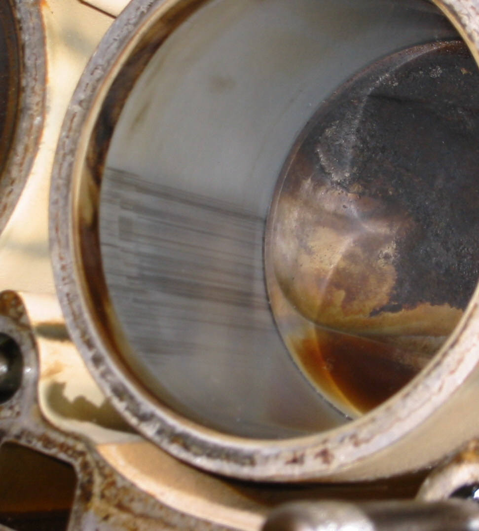

The 944 hot rod world has been dealing with this for years. Weird how the Chevy Vega got a horrible reputation from its Alusil bores, but Porsche keeps using the same iffy tech and apparently leans on the power of its brand to dance around the issue. Here's a vintage picture (from a vintage camera), circa 2005, from my original motor. Turning up the boost is a fast and easy way to make more power but without some heat management, this is the result. The pistons just get super hot and expand more/faster than the cylinders can keep up, and suddenly the piston/rings become a friction fit in the bores. The only difference is -- and I have not studied up on why this is -- but on the 944 motors, the motor keep on running without any of that death knock sound. Oil consumption goes up, compression might do down a little, but the motors still make good power and can last a long time like that. I bet a good percent of the 951s on the road today have at least some scoring.dr bob wrote: Mon Feb 02, 2026 8:28 am Curious if there are similar reports for piston/cylinder damage in the Tiguan and Q3 sibs. I just recommended a Macan to a friend, and she's shopping in the used market. She's coming from an Alfa sedan with a fuel pump issue, recalled but no replacement parts available for at least another month.

I don't know if there's anything I can remove, it's hard to reach in there. I do see some tiny aluminum flakes in the oil filter I removed last week. I think I still have the filter, I can take another look.dr bob wrote: Mon Feb 02, 2026 8:28 am Curious if there are similar reports for piston/cylinder damage in the Tiguan and Q3 sibs. I just recommended a Macan to a friend, and she's shopping in the used market. She's coming from an Alfa sedan with a fuel pump issue, recalled but no replacement parts available for at least another month.
