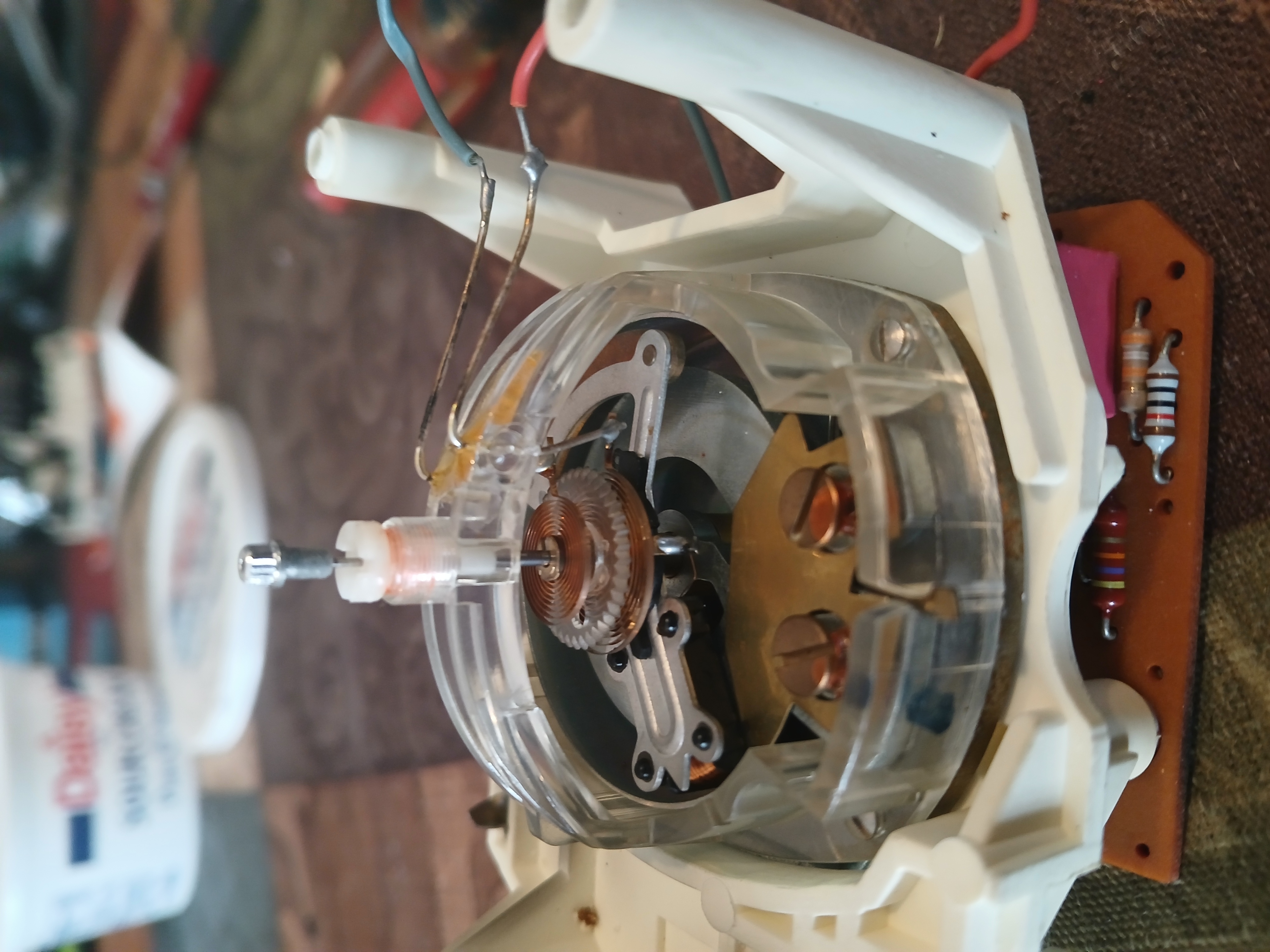

Here you can see the intact needle shaft poking up from the clear plastic unit. I had wondered if I could detach the clear plastic unit from the white bracket.
It turns out the clear plastic unit is only attached to the white bracket by two screws coming up from the bottom. The two wires run down to the circuit board.

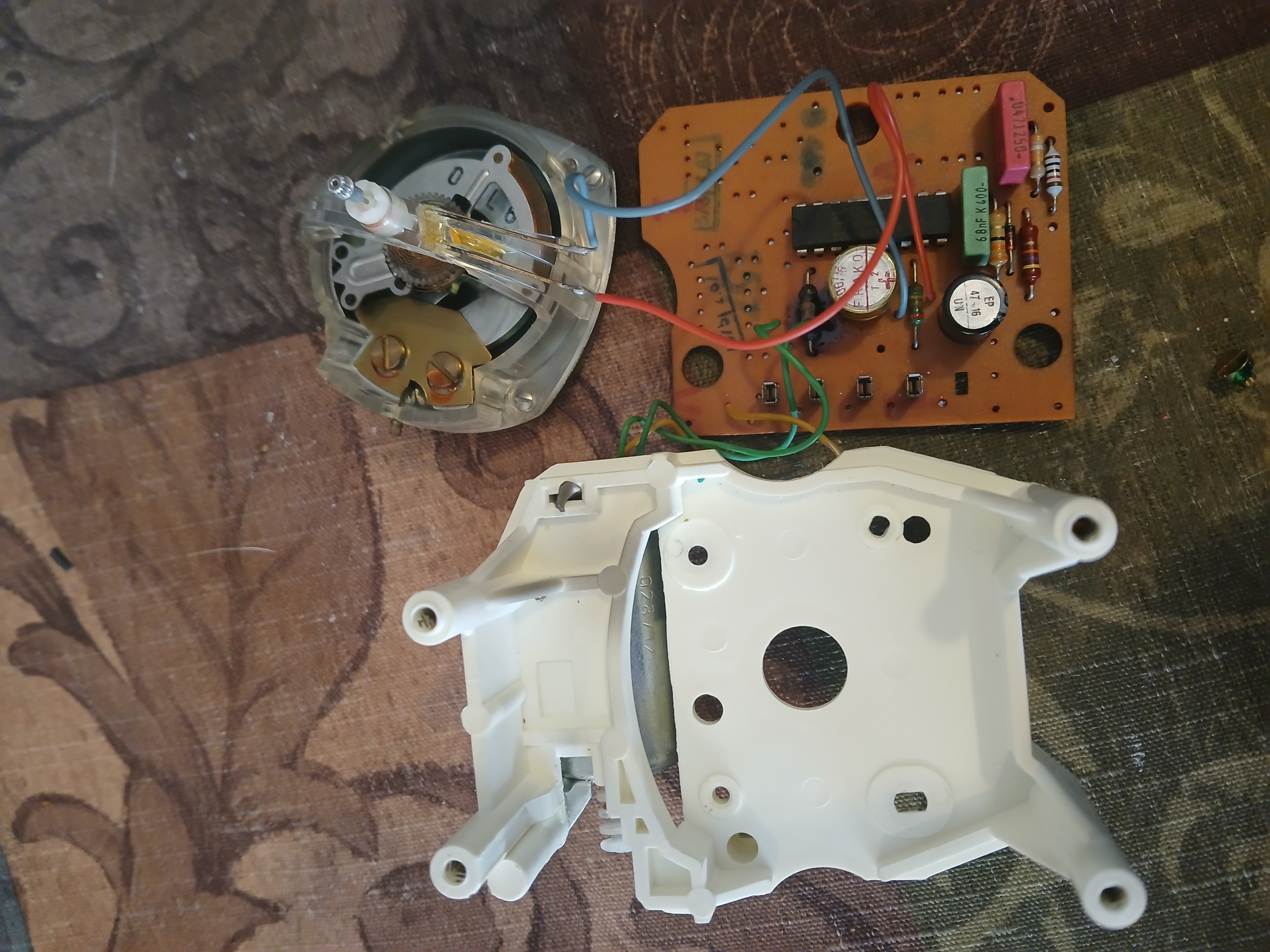

Disassembled At this point all I had to do was de-solder the wires and transfer the clear plastic unit to my original speedometer, re-solder the wires, and attach it to the bracket from my original speedometer. I did use the odometer from the replacement speedometer because it already had the new gear in it and it seemed to turn more smoothly than my original.

Nice work! I wonder what's going on with that resistor lately. That's the third speedometer board posted on Carpokes in the last few months with the exact same blown out resistor!
The culprit is the 100uF cap shorting out to ground, which takes the 33 ohm 1/2 watt resistor with it. 12v across a 33 ohm resistor gets you to 144/33 or about 4 watts. It never had a chance.
