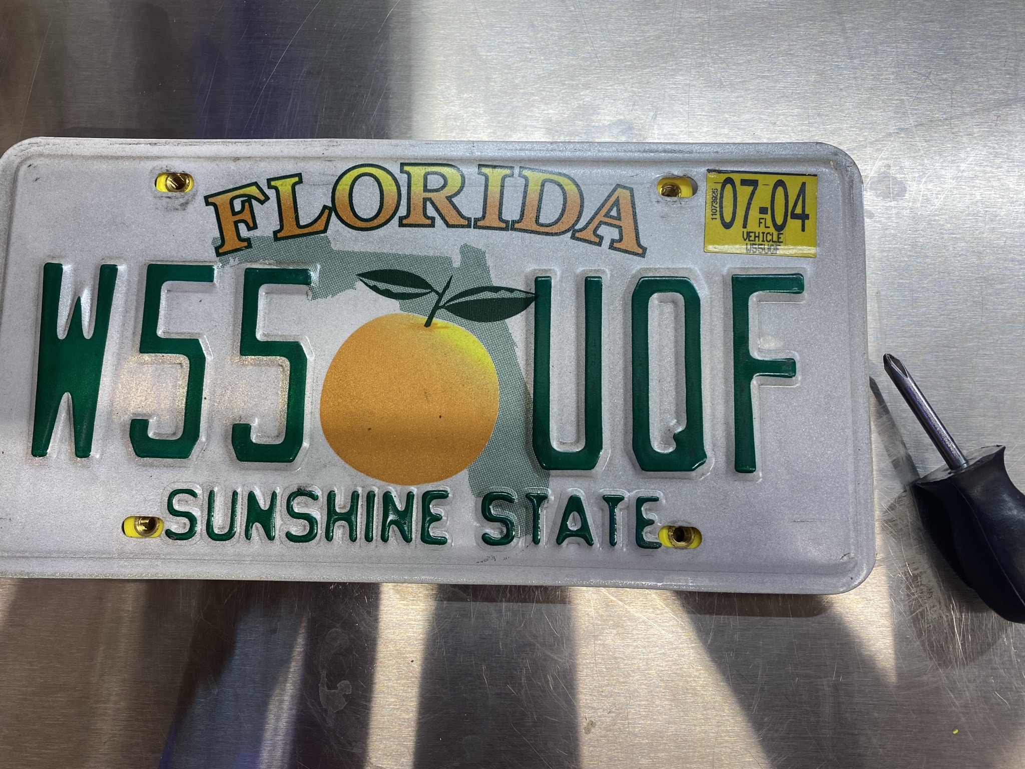

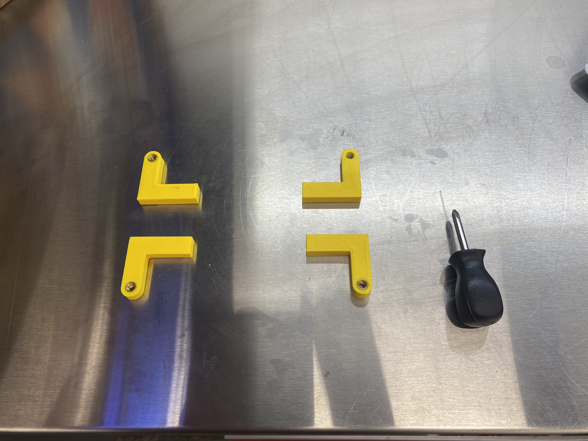

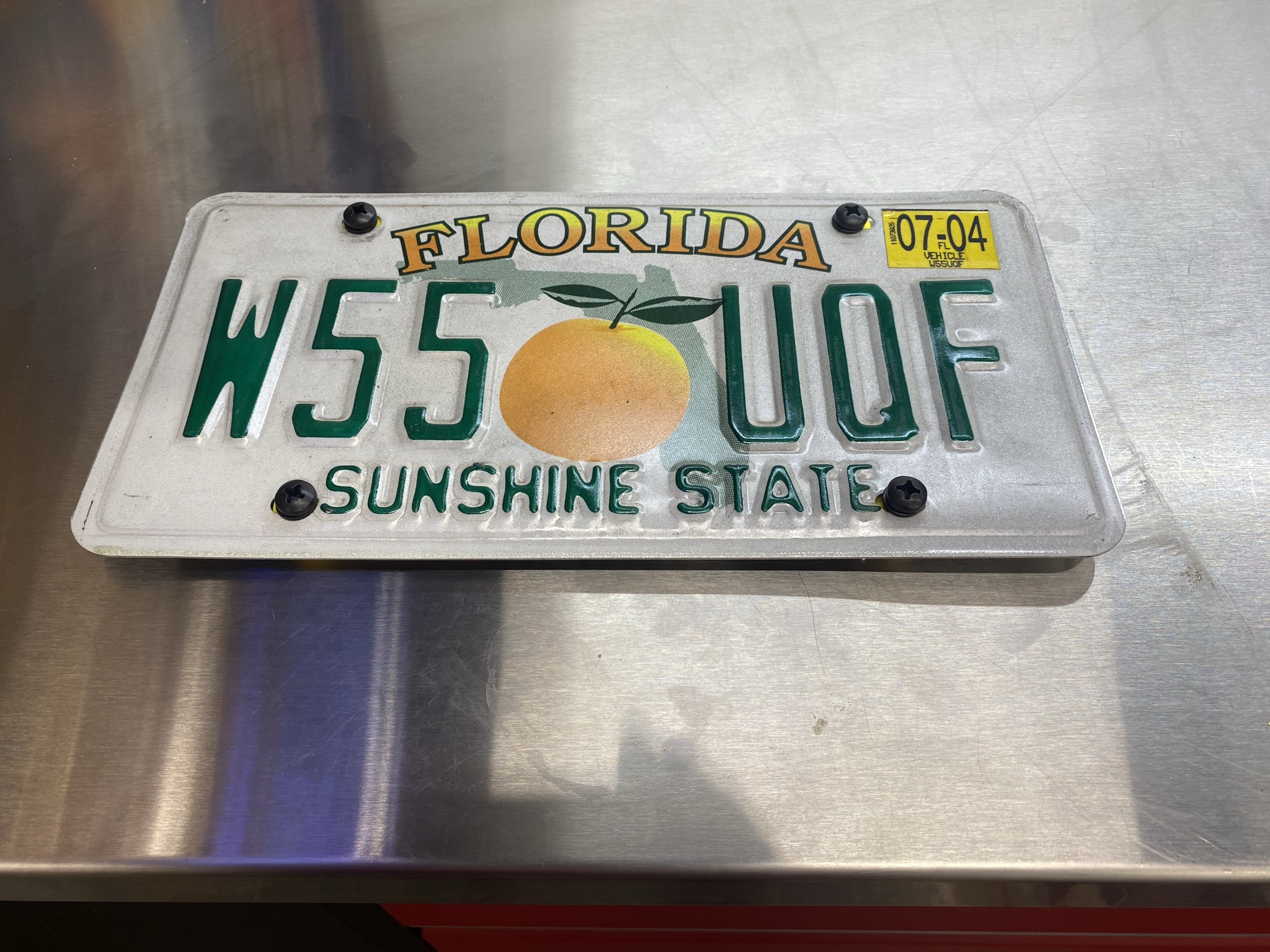

Kit, for sure! PM me and we can pick a time. In the meantime, based on Bob's super helpful pictures, I came up with these prototypes for the 718. I noodled with different rectangular designs with rounded corners, etc. but none of them worked well for the little round islands around the upper screws. These are intended to overcome that.....and still provide plenty of molding tape contact area and stability. They are also 3mm thinner than the 991 and 992 mounts because they don't need to clear any ridges on the bumper. That should help keep the plate from standing off the bumper too far in light of the raised area that's already there. What do you think? I did them in yellow and used a Florida plate in Bob's honor.... :)

Those look great, I'll ping you for a time to drop by.

Thanks Tom and what you came up with looks like it should work fine...nice job!
