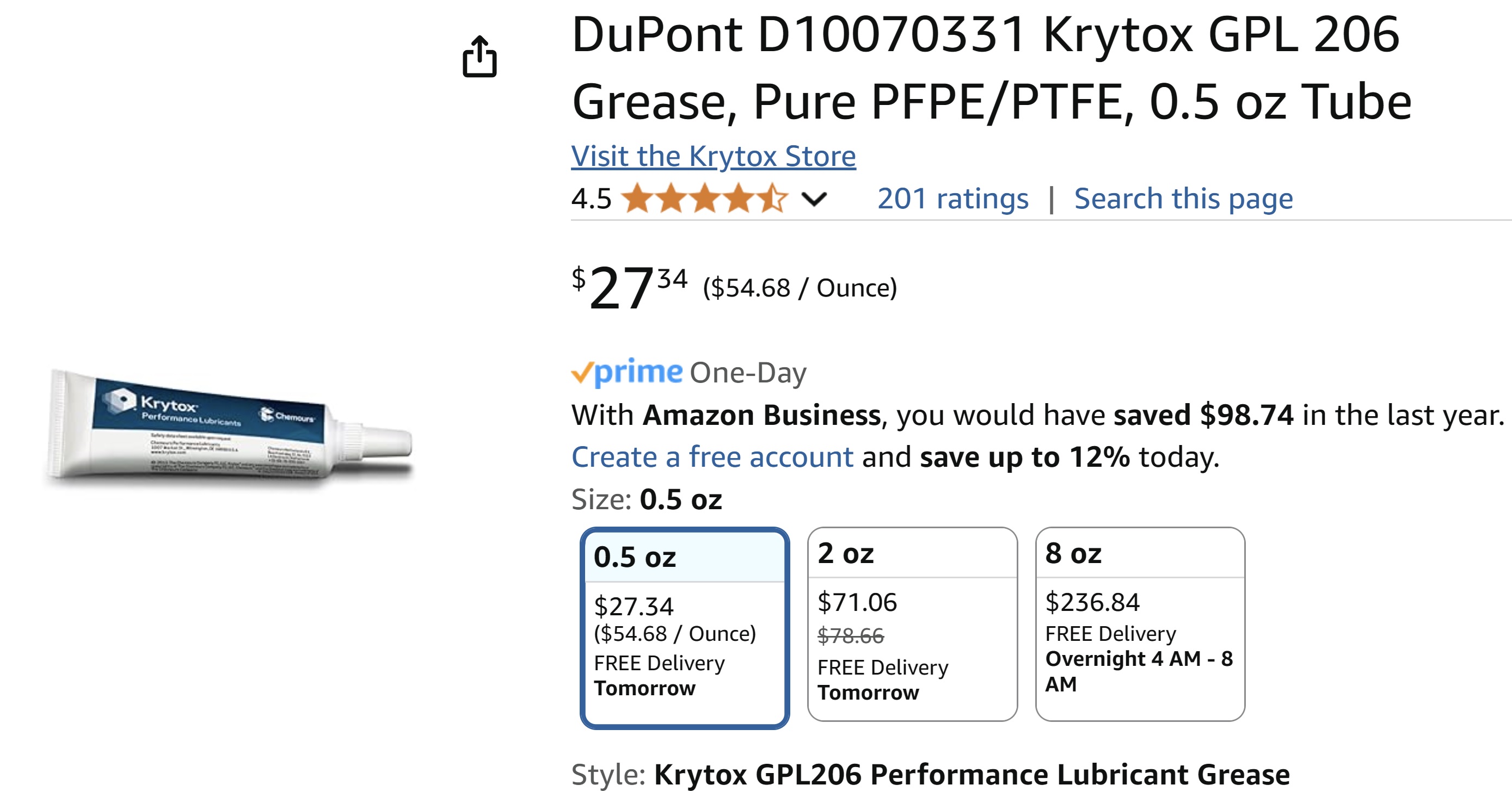

My dealer turned me on to Krytox for this sort of thing. They use it on rattles. squeaks, sticky parts, etc., and on all sorts of parts -- rubber, plastic, leather, metal, etc. It's a true lubricant -- basically liquid teflon (PFTE) in a synthetic lubricant (PFPE) base. Amazing stuff -- definitely worth a try. There's a good chance this is what the dealer would try if there are no other clear problems with the mechanism.

There are different variants of Krytox. I don't know what differentiates them. I've been lead to believe the factory uses GPL105, which is an oil. I'd wonder if that tube is 'the same' or not.

My dealer uses the 205 or 206; it's a gel that squeezes out of a tube. I believe the 206 has a slightly higher heat tolerance that 205, which is largely irrelevant in applications like this. The 105 is an oil. The factory may very well use it in some situations, I dunno, but the gel is what my dealer uses to lubricate sticky weather-stripping, plastic, leather, metal mechanisms, etc.

The Krytox is not really a weather-strip preservative, per se. I suggested it because you said that your problem may be related to the weather stripping sticking together. It's that very issue why Krytox excels -- lubricating and cushioning parts that might otherwise stick together or chatter, etc. The dealers seem to use GLP206, so that's the one I recommended above.
As for the best weather-strip preservative, I've heard good things about the Gummi Pflege Stift you used, but suspect the best product is the one you use most consistently....
