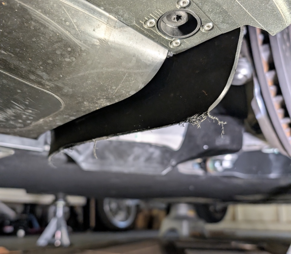

I have a set of Apex wheels with 255/35-19 and 285/35-19 tires on them. From a width perspective those sizes are perfect (don't want too much rear grip for a street car).WillyDaP wrote: Mon Mar 03, 2025 5:51 am Honestly if you are not autocrossing in a Stock Class the 9 inch wheels that Apex offers in front is a better choice imho. With those up front and 10.5s in the rear a set of 255/35/19 Bridgestones fit just fine, along with 285/35/19s in the rear. I did get a little bit of negative camber up front , but I know a couple of guys who just maxed out the factory amount with no issues. It isn't much, but honestly a 255 fits on a 9 inch better and I believe that was their thought process at Apex Wheels.
Good luck and I have a set of 18 wheels also and with a Tarett front camber plates ( -2.25 up front ) I had a set of Hoosiers A7s on them ( 255s/35/18 and 295/30/18s ).
Just think about the GT4 with a size wider up front and two sizes in the rear over a GTS, those tiny rubber donuts are just part of the Porsche plan to not let the GTS be quite close to a GT4 --- smaller rotors, smaller wheels and a slightly tuned HP . So many performance cars do the same thing to differentiate their models. Mustangs have been hilarious with their tiny tires on a GT ( or other models ) and once you move up to a Handling Package Option they slap on some larger meats with not problems.
However, continuing to think about the 1.8% difference in diameter underscores my irrationality in considering very light custom wheels merely to revert to the original tire sizes.
Note that the ride height difference does make a noticeable impact in a couple scenarios:
1) entry angle to driveways
2) scraping the wheel air deflectors when the car is loaded up cornering on undulating pavement. I heard this on a backroads run and was worried at first that it was more serious. See pic below:
