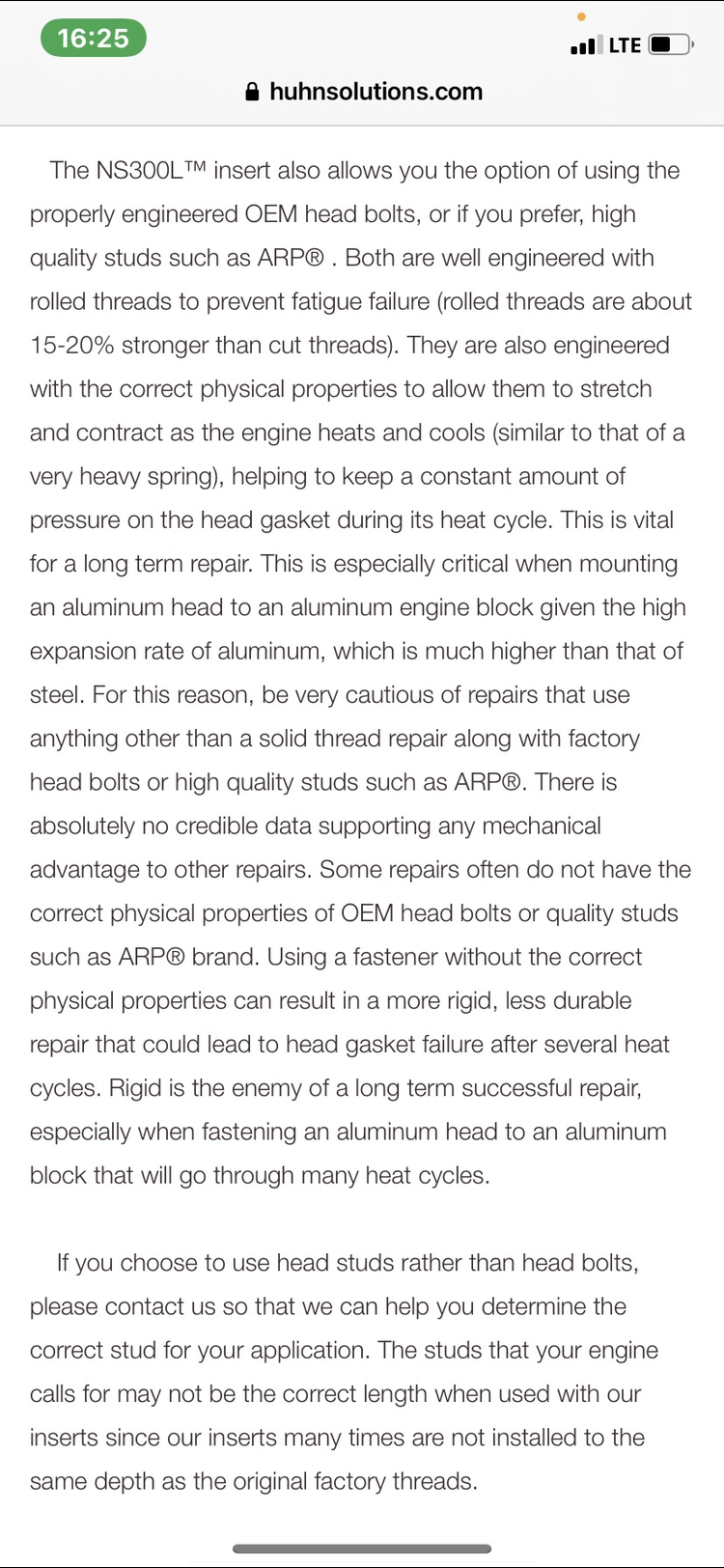

Have a read
Enjoy 😉
Supports what Chris knows

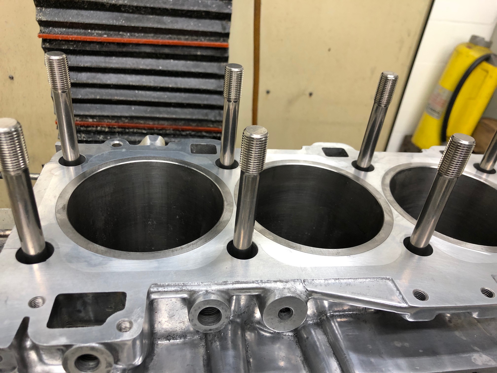

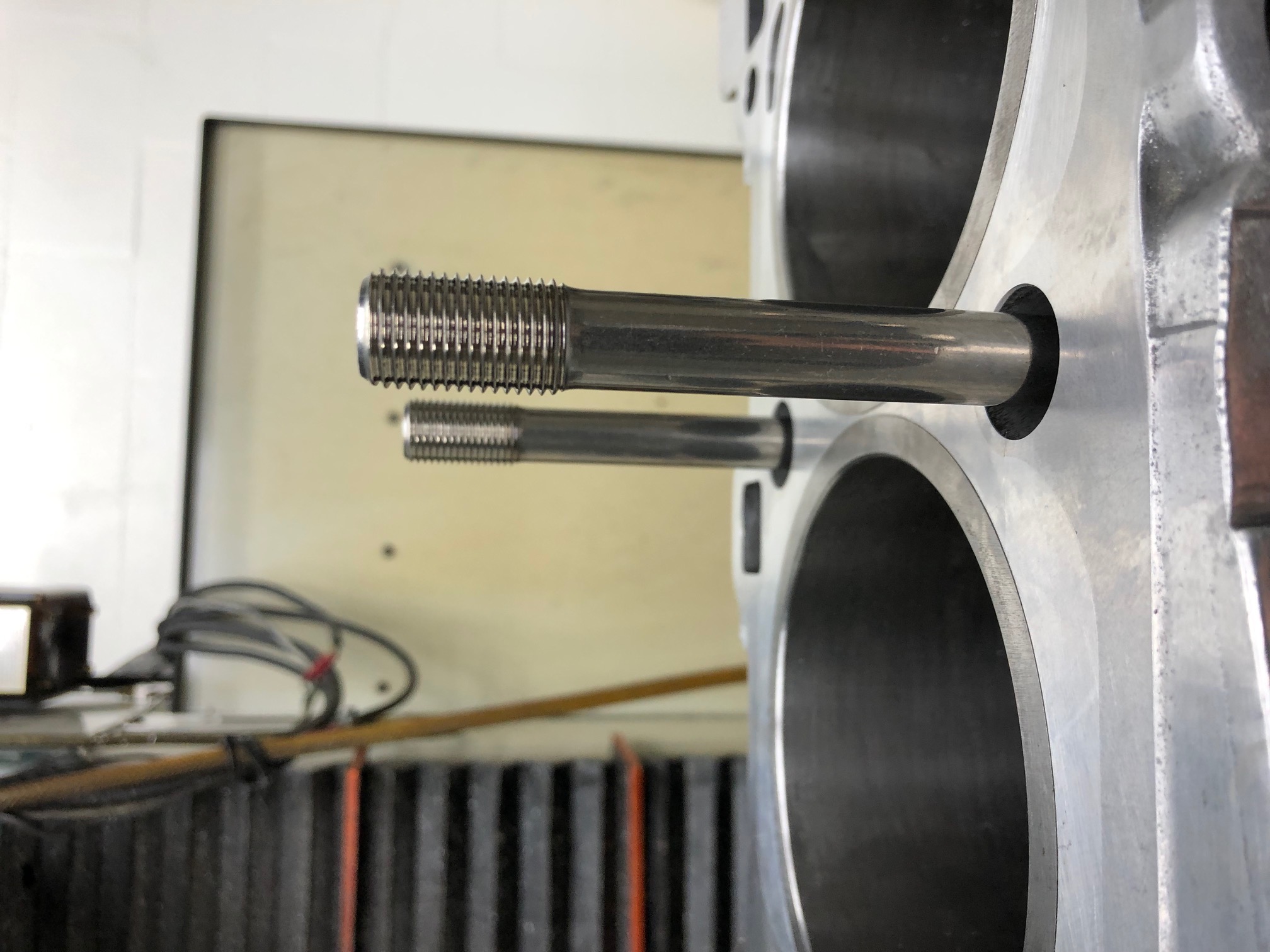

Just to say that I use 9/16 head studs that were purpose made but have to torque to a min 128 lb to get a bit of stretch ( worked out by my engineer ) . Gets a bit tense with an old block .
On the flip side Turbo Tim was well over 30psi on his engine with OE head studs with out issue .

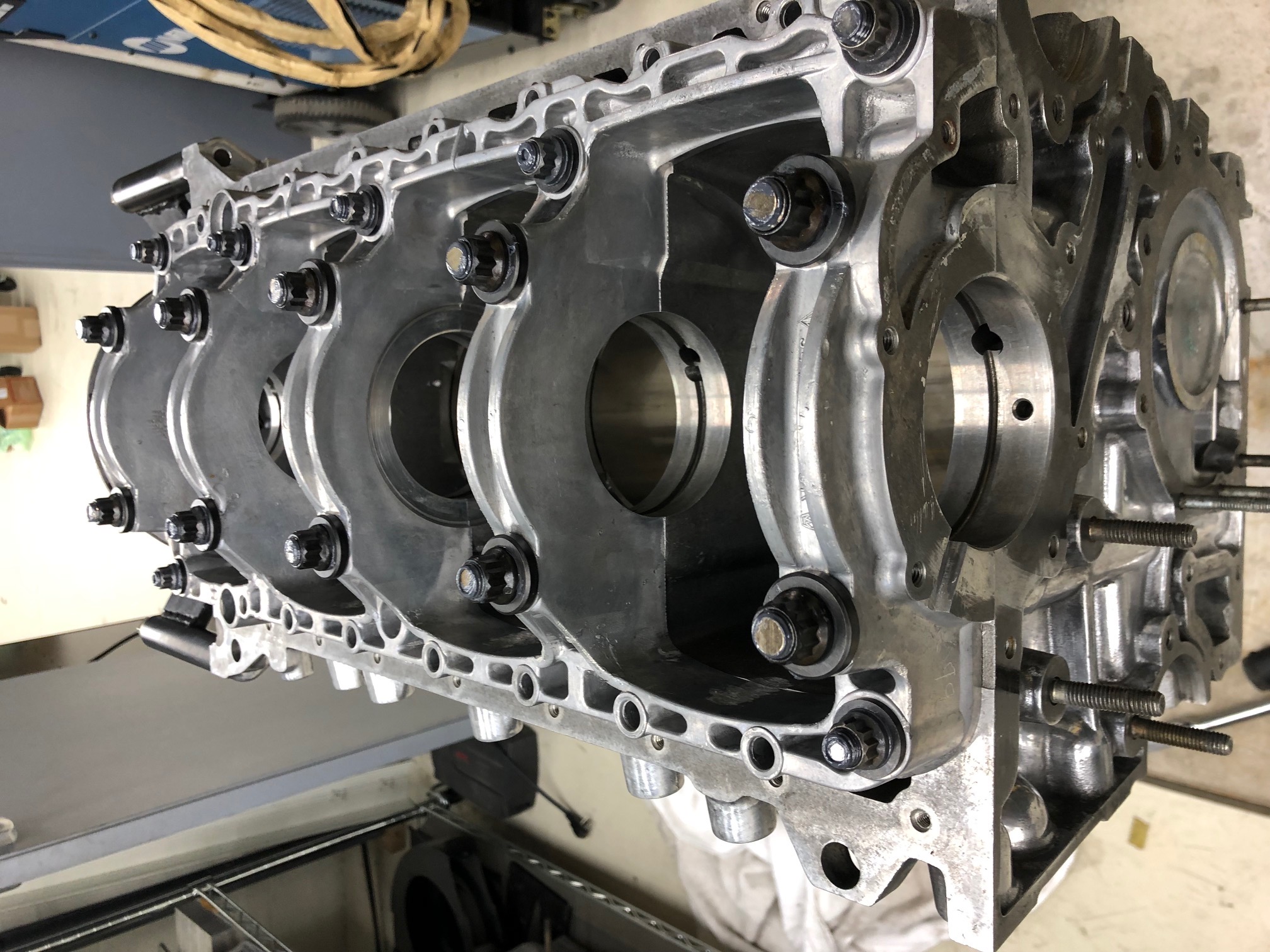

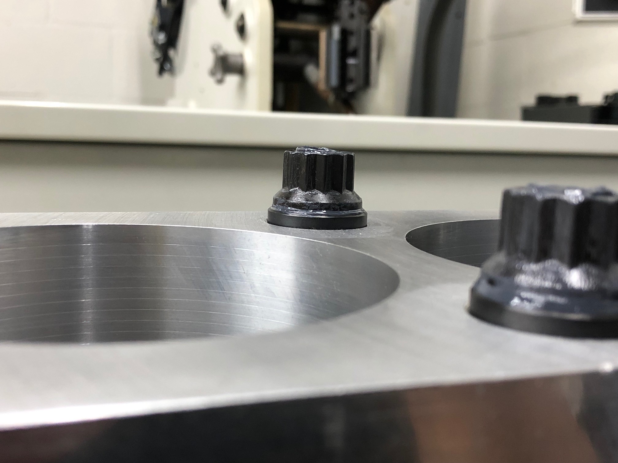

Those that consider larger head studs need to know there's a 944 head stud that's close to a main girdle stud at the bottom of their respective threaded holes. I've seen two 944 blocks with cracked main webbing due to threaded and stressed holes being so close to one another. This issue is exacerbated with larger head studs. Frankly, I don't recall which studs are at issue, but someone please look at the main studs at the 4th main bearing, and the head studs between cylinders 3 and 4.
I never saw a need for a closed deck block, but I'd certainly be interested in cylinder distortion it may cause at the top of the stroke. I'd surely want to finish the bores after a plate is installed. I'd then heat the block with hot oil or boiling water around the cylinders to see what cylinder distortion the additional "support" may cause. Again, no personal experience, but something to consider. The 2.7/3L blocks have the best support for the cylinders, and the 2.5L blocks can be filled to improve their cylinder support.
Are the Honda guys still welding or pressing in deck supports or did they determine it was causing more problems? Patrick's engine, I believe, had a closed deck and big head studs. It failed in a big way very quickly.

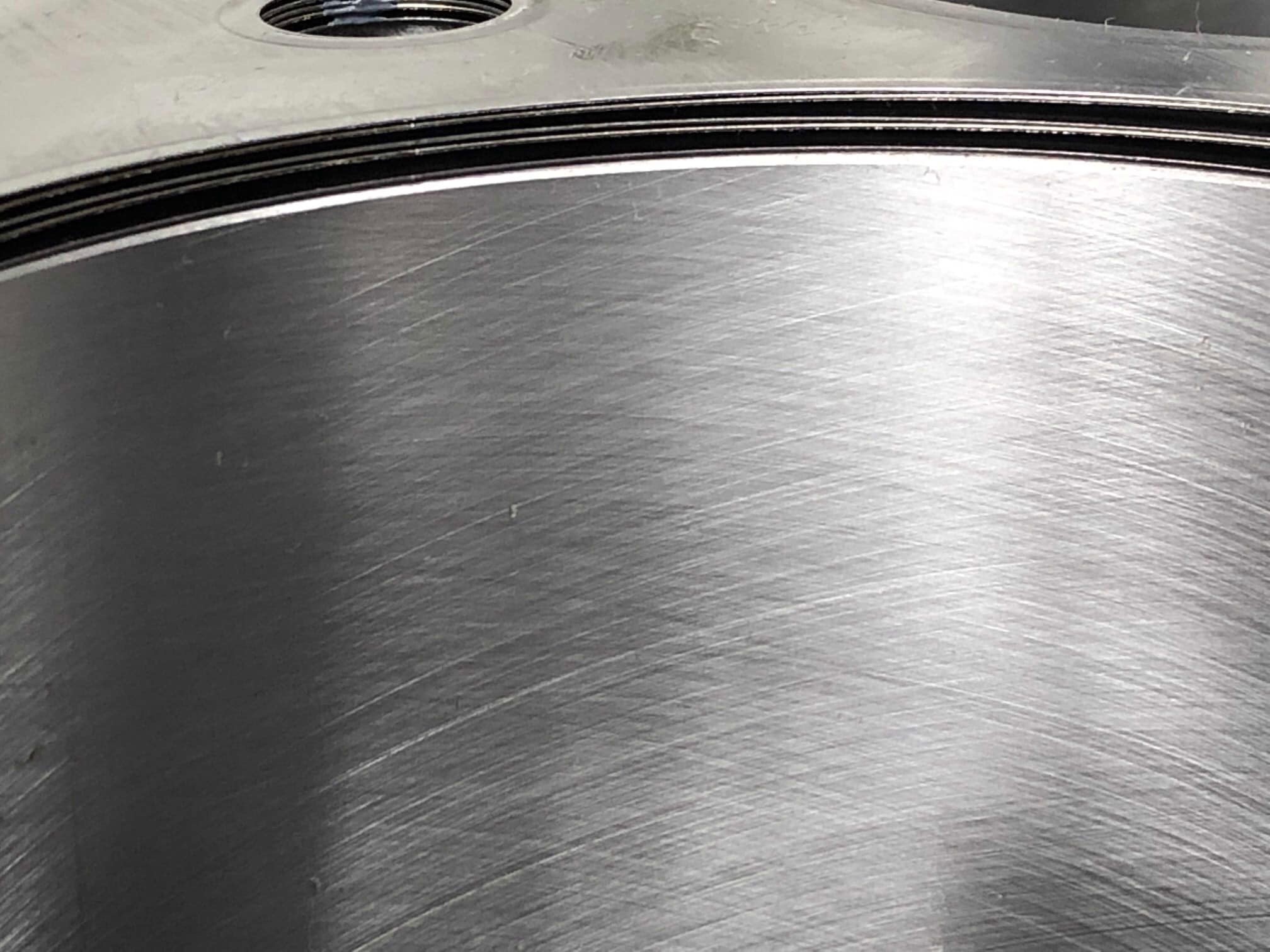

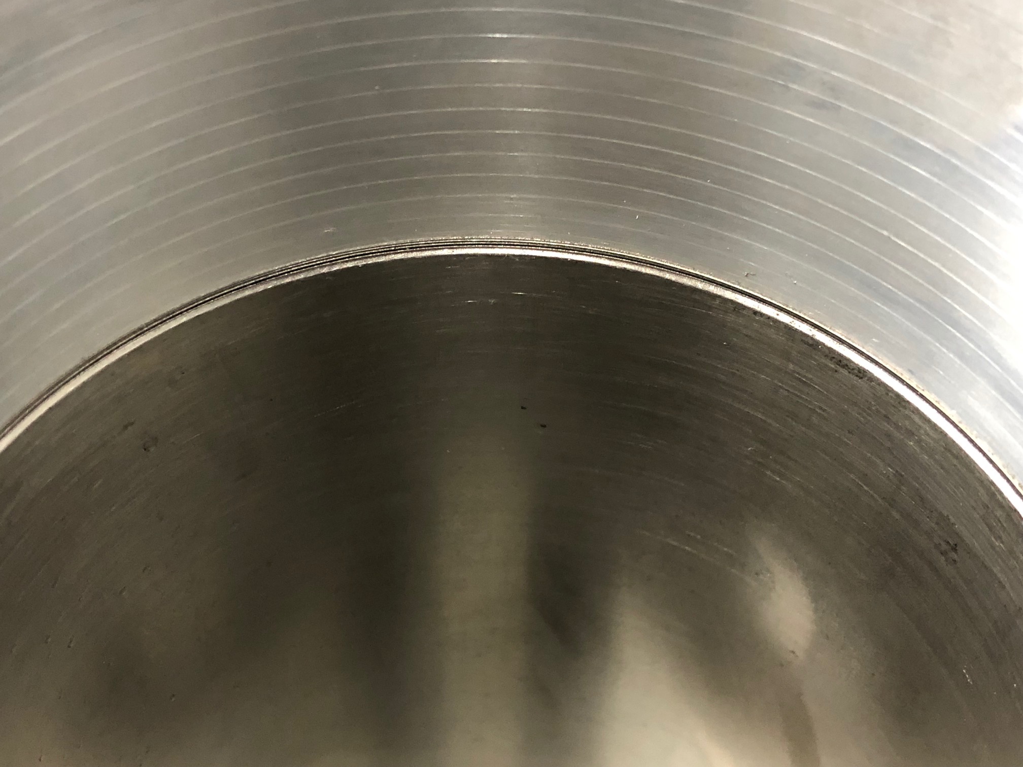

The way it should be done if you are going to do it! Michael highlighted just some of lengths taken to do things properly. On a plane, can’t go into details, but precision like this is rare and expensive. Cylinders are parallel to 0.0001”, all machining done at temp, custom one off boring plate torqued to proprietary torque during machining, everything B&B to crazy numbers that I don’t prefer to share.
