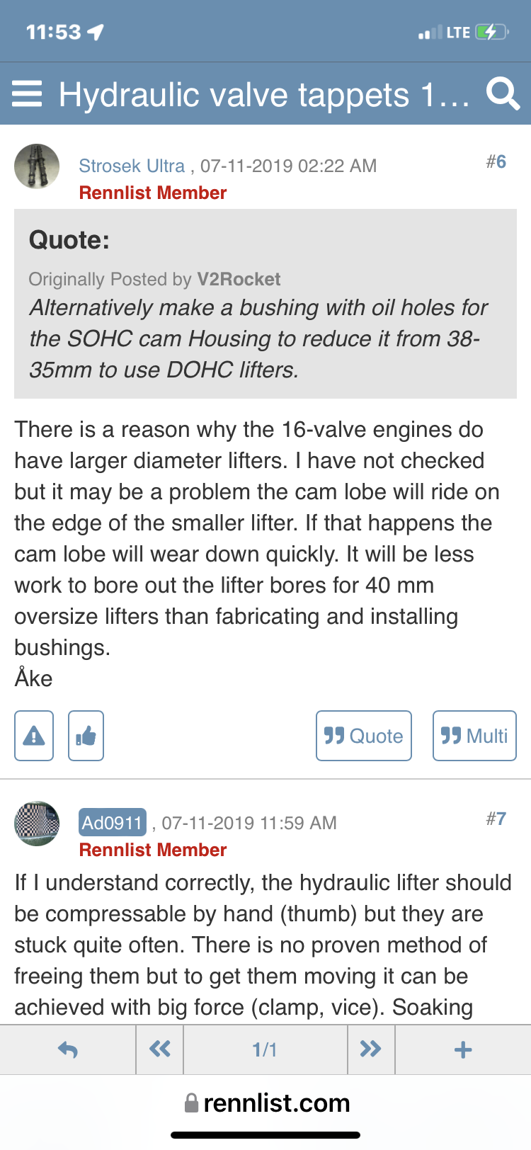

I am finding articles on over-boring lifters as far back as the early 2000’s
The big one is going to a .904 on V8’s

Not news. The idea was from a guy in sweden that discovered the benz lifter back in 2019 from whwt I heard all this drama is nonsense
This is the original post talking about the lifters
https://rennlist.com/forums/928-forum/1 ... 978-a.html
