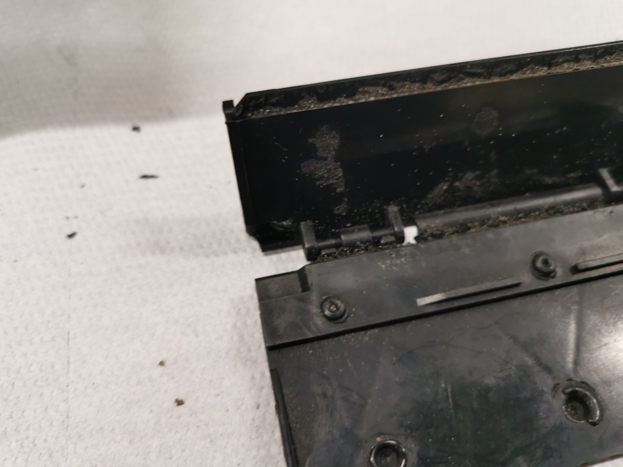

Hi guys,
Here are some photo's of the plate that is on the backside of the central ventilation opening in the dashboard. This one is damaged and cannot open or close the ventilation opening. I want to repair it with 3D-printed pieces. Can somebody share some pictures of the same plate but in good working condition? Hopefully I can find out that way how it works and what to print exactly.
Thanks in advance and greetings,
Bert

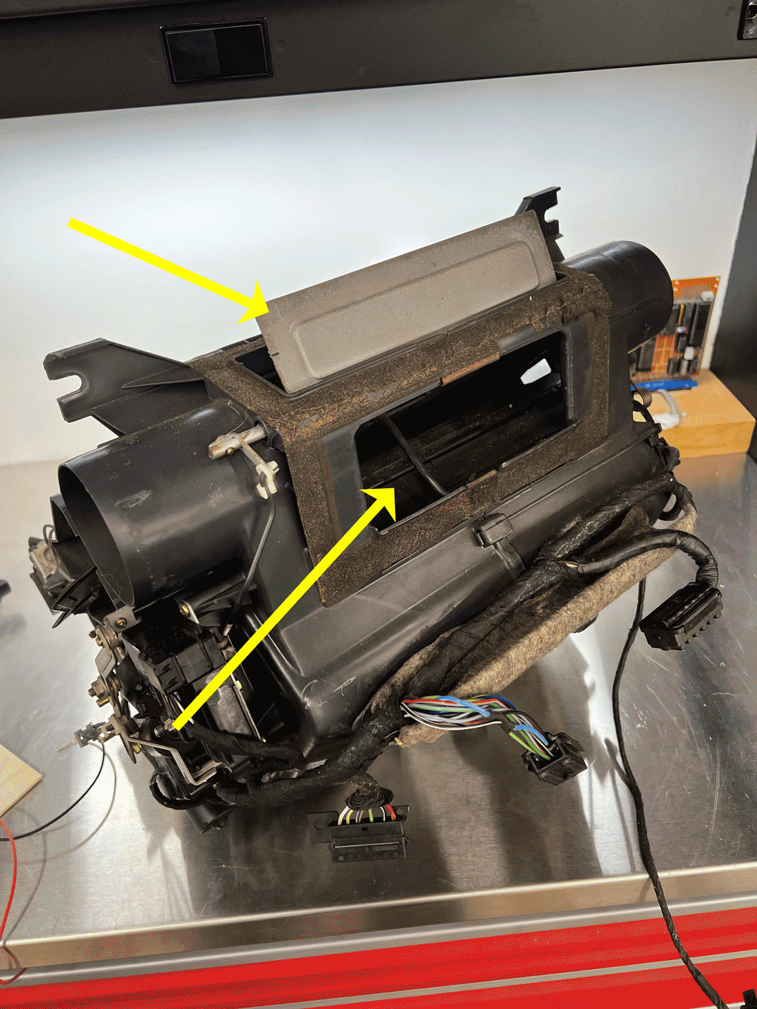

I can't tell where/what flap that is? Where is it behind the dash? I just so happen to have a spare heater-core unit on my bench (along with a dashboard) and don't see a flap that looks like that? Did you have to take the heater core plastic housing apart to find this inside? Or am I not looking in the right places. The only flaps I can see without taking it apart are shown with the arrows below and neither looks like the one in your picture? Did the 968 change parts behind the dash by any chance?

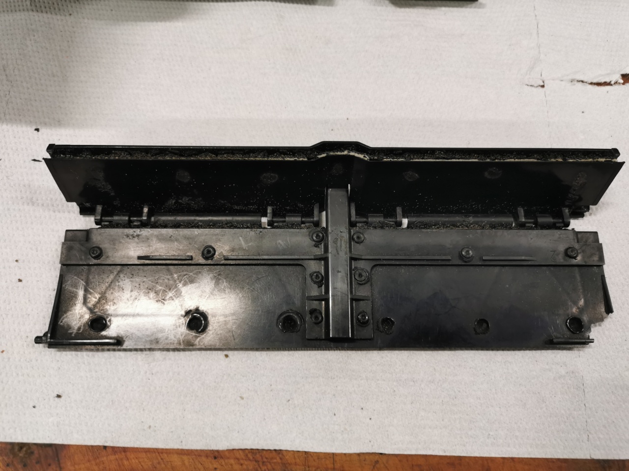

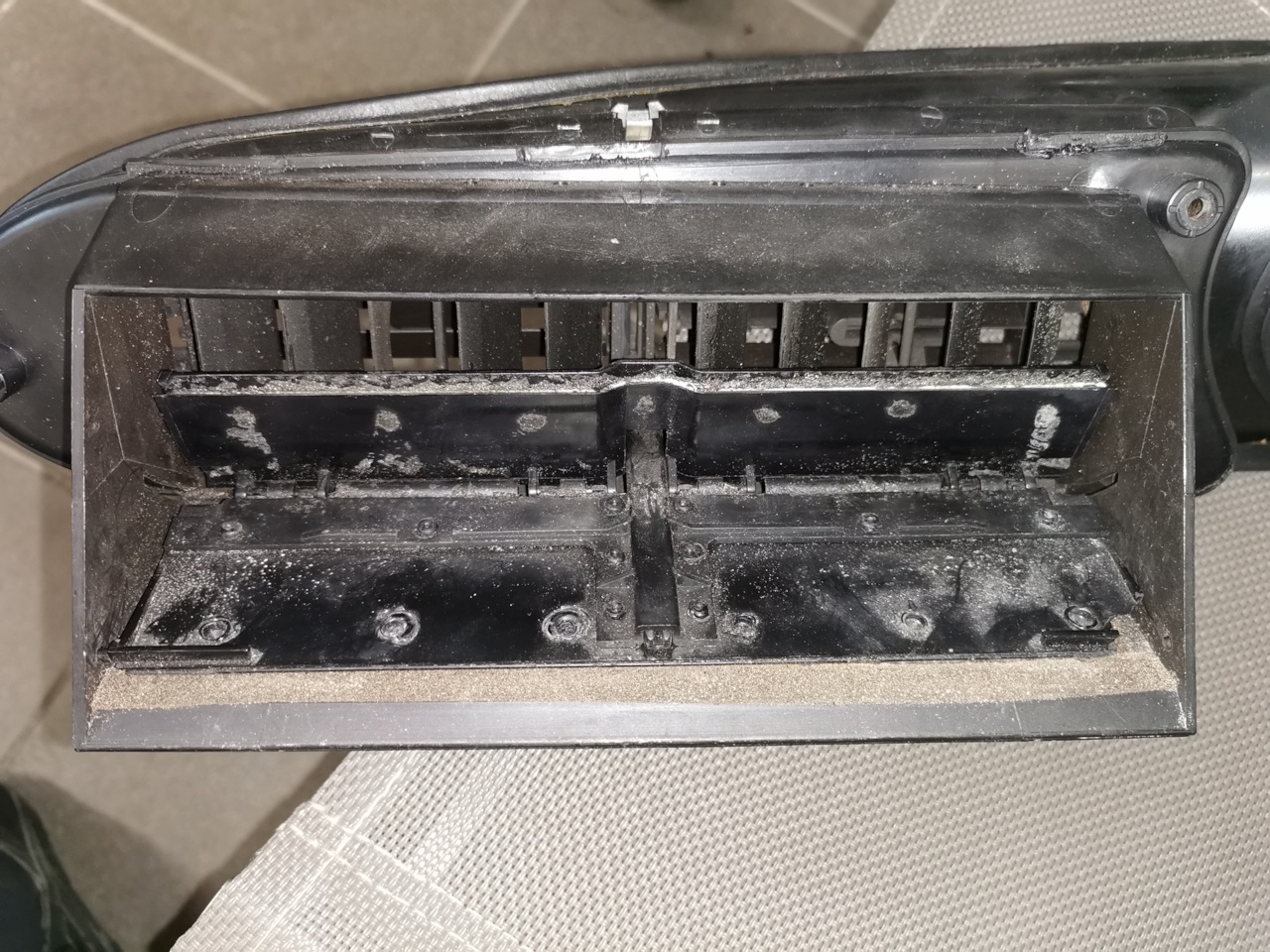

Hi Tom, is it clear now with this picture?
- Posts: 9098
- Has thanked: 952 times
- Been thanked: 4085 times
Yes. Sorry I should have figured that out! I will take some picture for you this afternoon. Not sure where you live, but those center vent inserts are easy to find in the US. But I certainly understand the desire to 3D print parts.bert huygens wrote: Thu Jan 27, 2022 11:12 pm Hi Tom, is it clear now with this picture?

I'll still take some pictures later -- looks like the corner pivot post snapped off yours...
