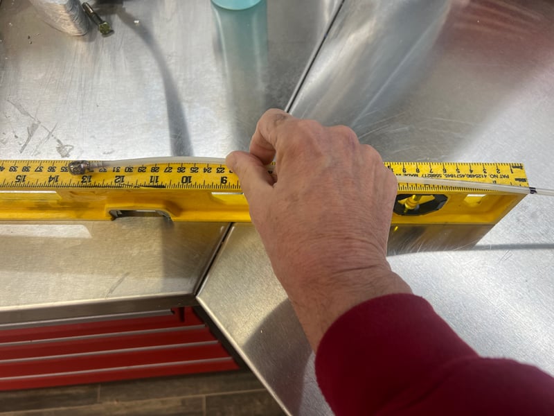

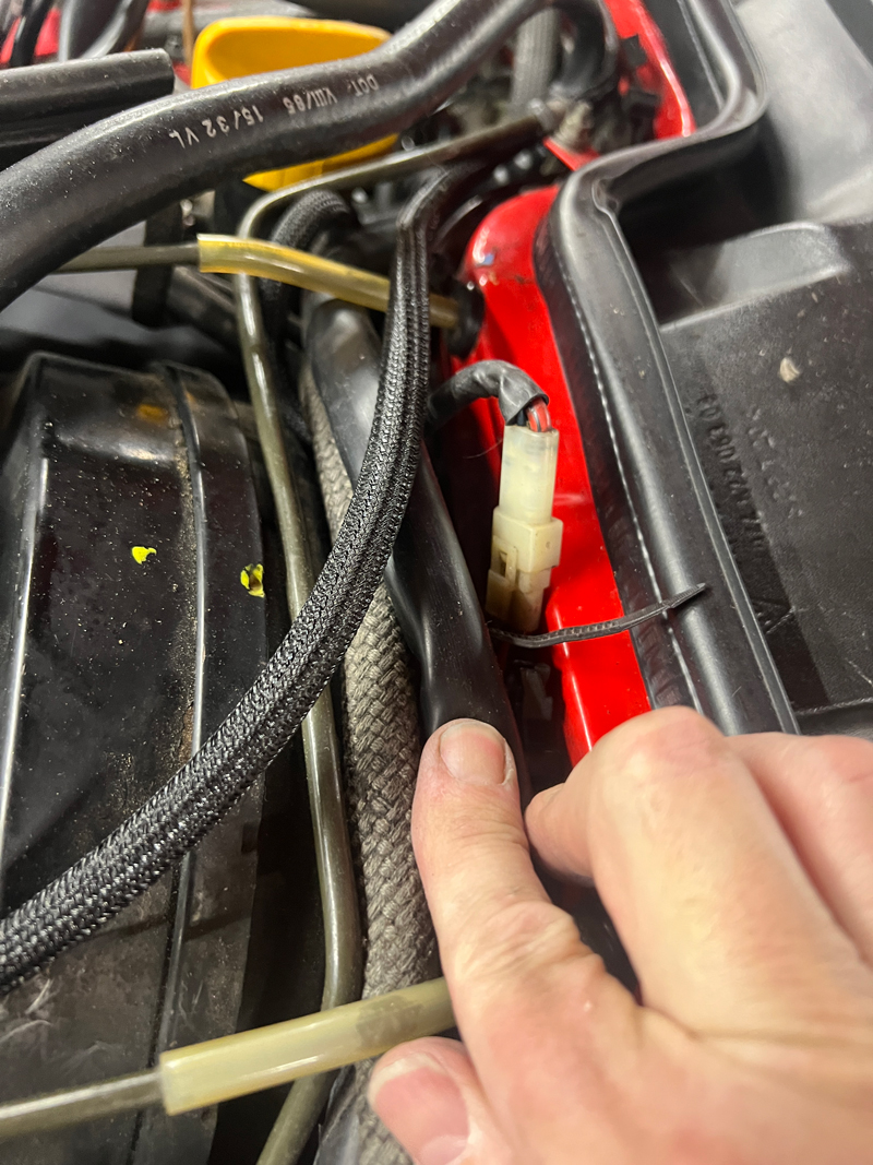

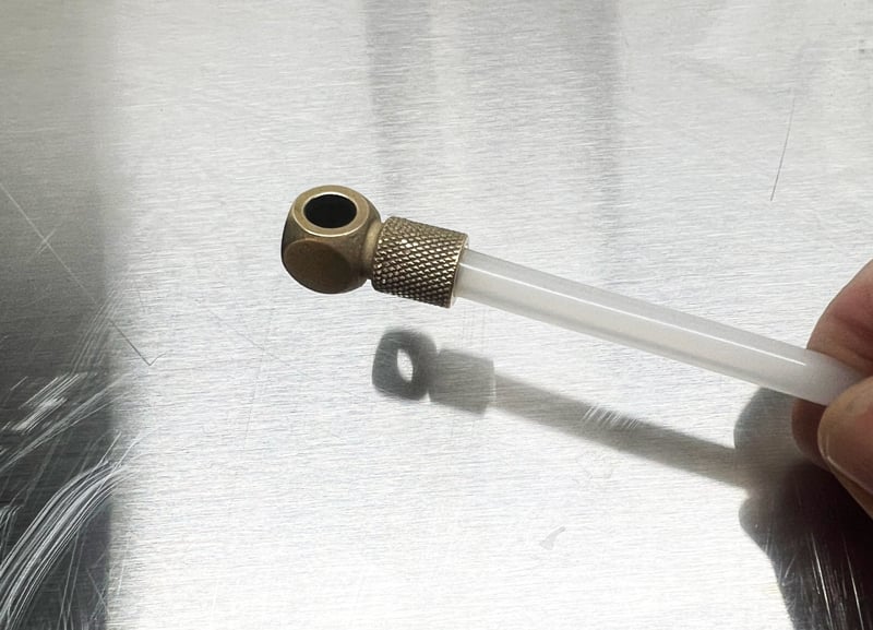

Below: The KLR tube extended 13 inches into the engine bay on my original harness, so I marked the new one at 13" and pulled it through the firewall snorkel to that mark. Edit: after installing the intake, I would shoot for 14 or 15 inches instead. 13" works, but just barely.

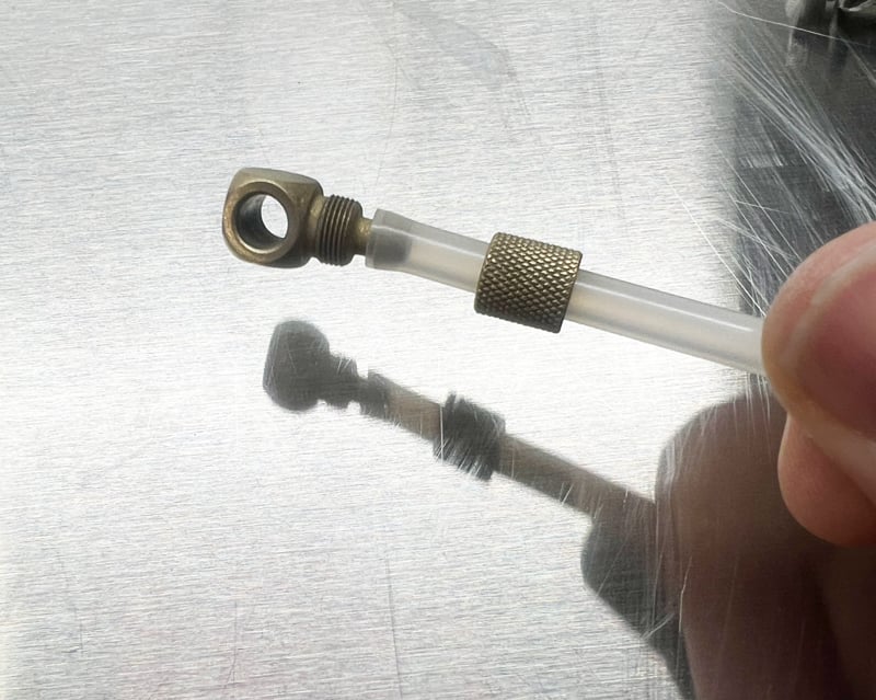

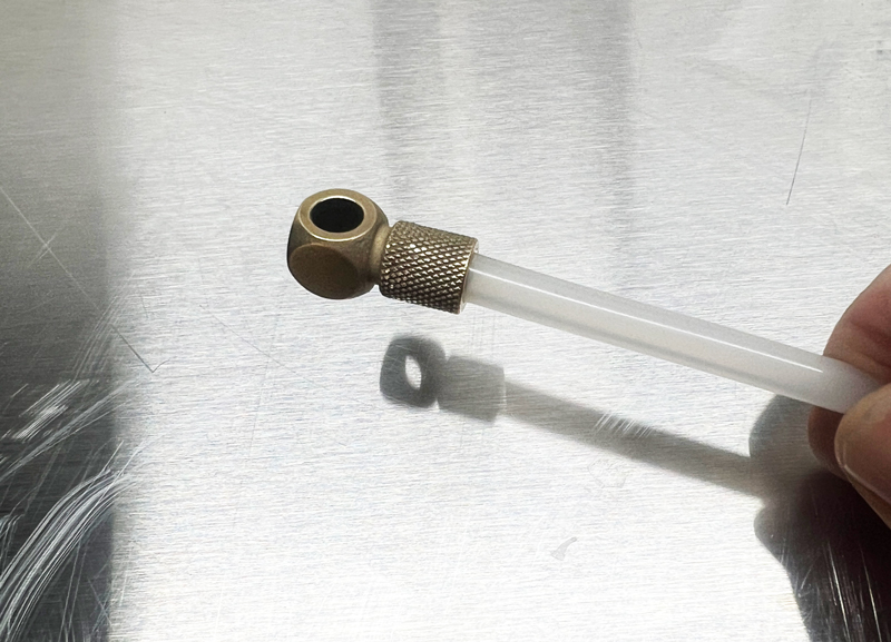

Below: On the cabin end of the tube, the banjo that connects to the KLR box is a type of compression fitting. I had to warm the tube up with a heat gun (not too much) so I could push it over the barb on the fitting. This is how far my original factory tube was pushed on, so I tried to copy the factory.
Below: Then I just screwed the compression piece on all the way, and it's likely the most secure vacuum connection on the whole car.

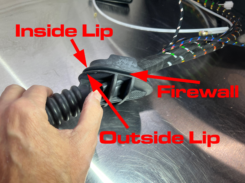

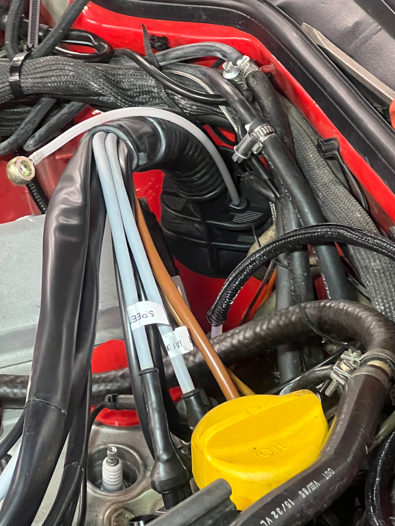

Below: I opted to put the harness in from the engine side. I fed the main DME and KLR connectors through the hold in the firewall, along with the smaller connectors on the cabin-side of the harness (e.g., altitude sensor, red 4-pin connector, diagnostic Kostal connector, etc.).
Below: At first I really struggled to get the snorkel seated in the firewall. There isn't much room to work, and the snorkel is big and clumsy with a deep lip that needs to be seated on the firewall all the way around (much like a grommet, but on steroids). I ended up removing the end cap on the cam tower (the one with 3 bolts and a cork gasket), which gave me a bit more room to work. The other key was getting a lot of light on it, so you can see the rubber lip clearly. I used soapy water on the rubber, and first worked the sealing lip onto the drivers side of the hole (toward the center of the car). Once that side is seated, you have reasonably good access to the passenger side of the snorkel, so you can poke the remaining sealing lip under the firewall hole with a screwdriver or plastic pry tool. I gave up last night, thinking I may need to pull the cam tower, but with a good night sleep, a cup of coffee, and morning sunlight, I was able to get the snorkel fully seated in about 10 minutes.
Below: This picture doesn't do it justice, but shows how the snorkel must be seated in the hole of the firewall. The groove for the firewall is quite deep, making that inside lip a pain to get seated. It's like pushing an 18" tire into a 15" hole. But it is possible!

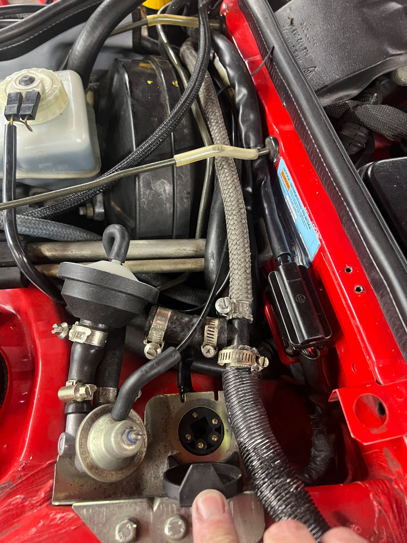

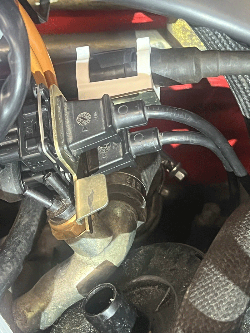

Made incremental progress on the harness installation today, between vet visits and Christmas tree shopping... So far, the Kroon harness is lining up and plugging in just like the factory harness.

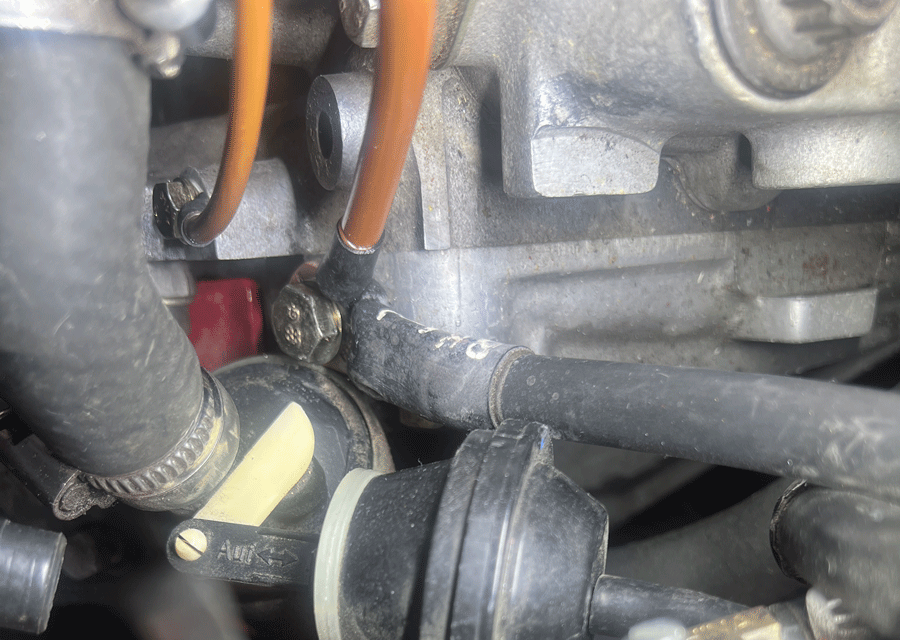

Below: reconnected the alternator exciter/warning connector, which had to be pulled out to get the engine harness out from under the hard brake lines.
Routed the new harness under the brake lines along the firewall, and connected the main Kostal connector and put the diagnostic port in its holder. The cover for the Kostal connector is getting a bath tonight and will go back on in the morning. It was much easier fishing these under the brake lines to reinstall than it was to remove the originals. Also re-routed the evap braided hose under the brake lines (also removed to get the harness in and out) and reconnected it.

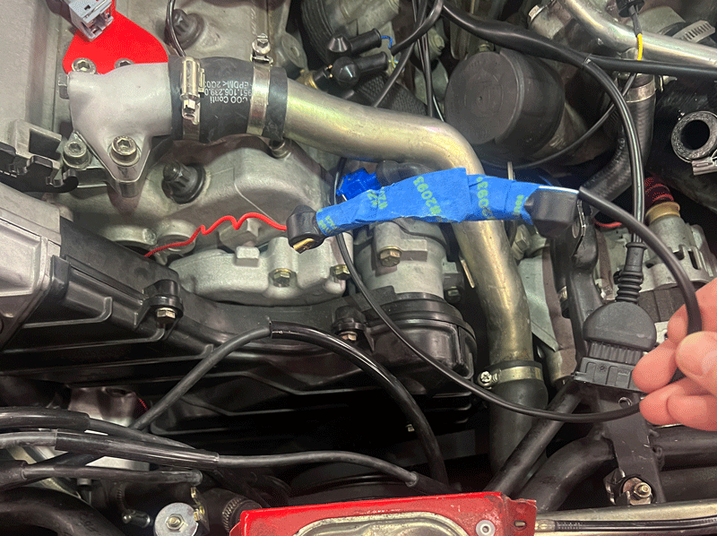

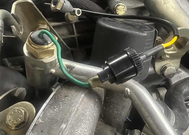

Below: Speed and Reference sensor connectors are labeled by Kroon, making it easier. O2 Sensor connector is just like the factory version, and fits securely in clip I 3D-printed today using our very own Carpokes STL file.
Below: ISV and knock sensor connector.

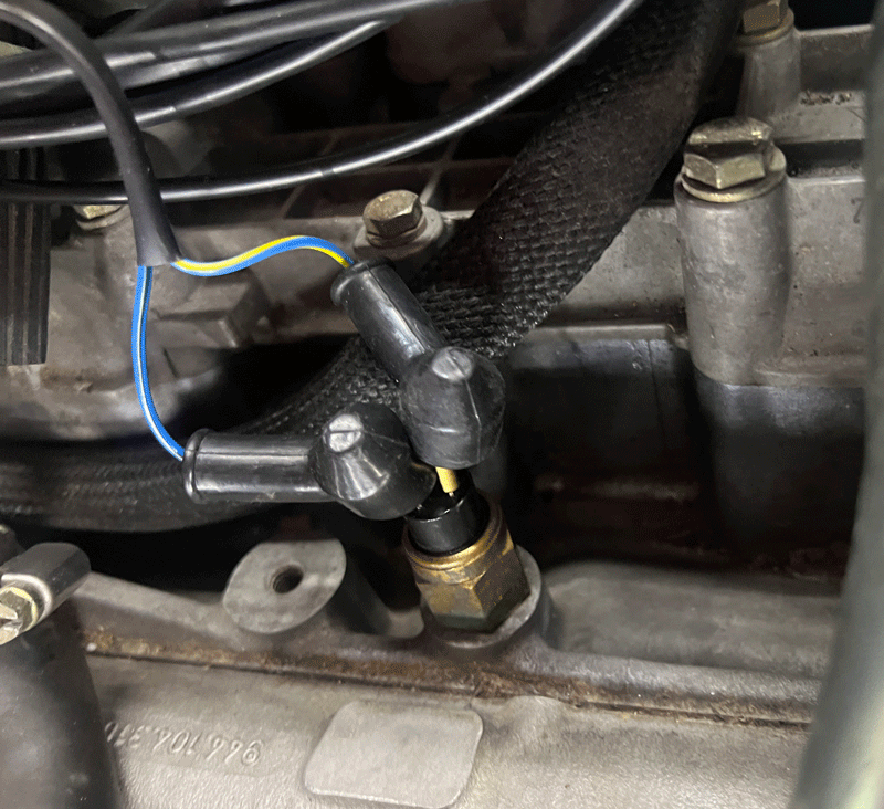

Below: Did Porsche put these rubber boots on the temp gauge sensor spade connectors? They don't fit over the spades very well, and my old harness did not have rubber boots? Anyone have these on a factory harness?

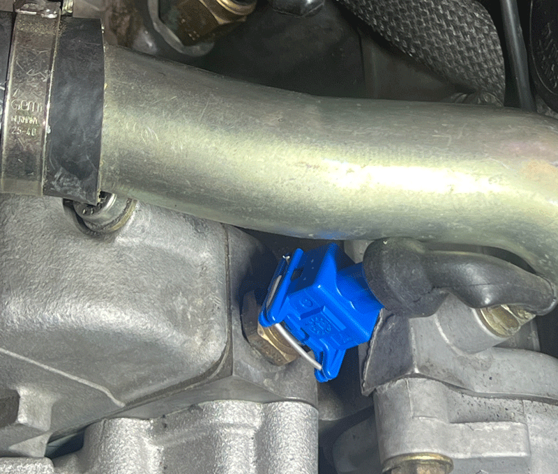

Below: The 2.7 water neck always makes the DME temp sensor connector a tight fit. Nice touch by Kroon using a blue connector just like the factory.

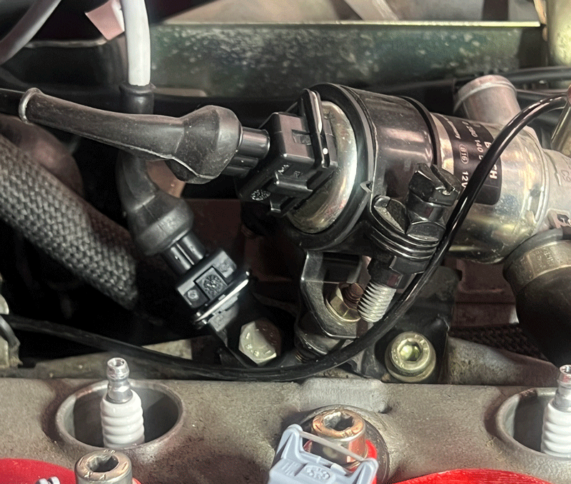

Below: The short aftermarket temp sensor has a bullet connector that conveniently plugs right into the factory-style connector on the harness. Where Kroon finds things like that connector is beyond me....

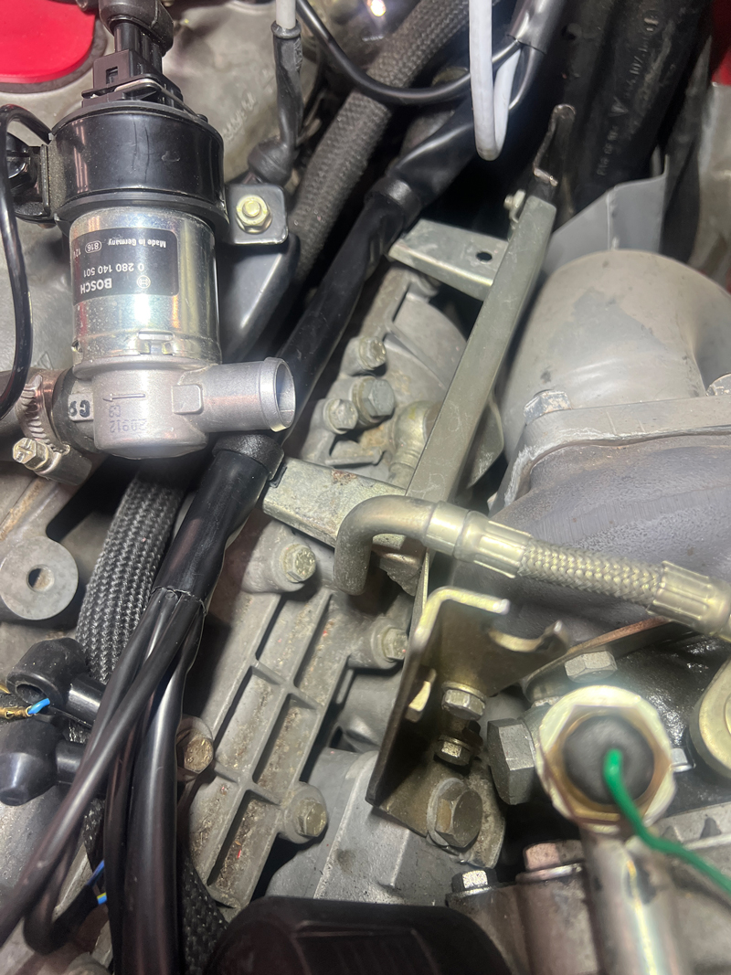

Below: Planning to use omega clips like the factory did. These clips were curtesy of @Crazy Eddie, who happened to have a big collection of these things. These may be a tad big, and they changed the color over the years, so I'm mulling the possibility of 3D printing a few in red. Stay tuned.

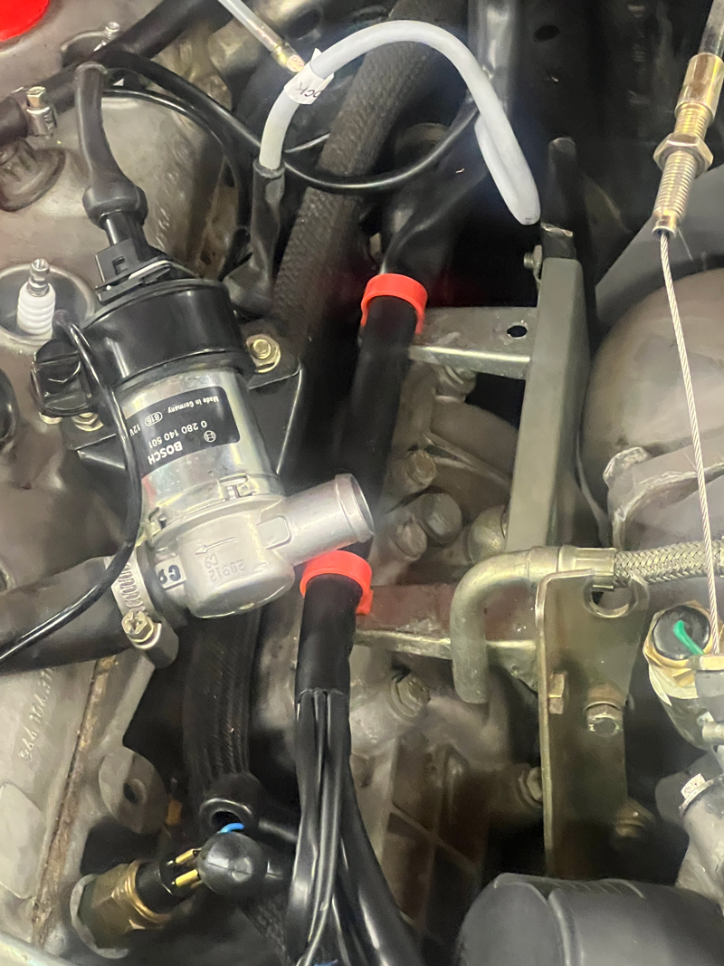

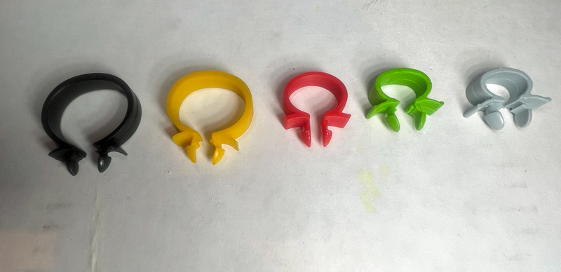

After looking at those omega clamps more, I decided they were just too big. Despite having every size he could find, none of Ed's omega clamps were a good fit for the Kroon harness. So, as is my way, I modeled and 3D printed my own. I really wanted to do them in red, but the red abs plastic is only good to about 200 degrees F, and given the proximity to the turbo, I was worried they'd melt. So I ended up making them in PAHT-CF, a nylon with carbon fiber filament good to nearly 400F.
Below: The red one in the middle is my 3D-printed version, surrounded by all the sizes I borrowed from Ed. By making my own, I was able to size it 'just right' for the Kroon harness.
Below: They looked nice in red on the car, but I worried they'd melt. Note the fit.
Below: Here are the final clips done in nylon-carbon-fiber. The wire insulation will melt before these do.

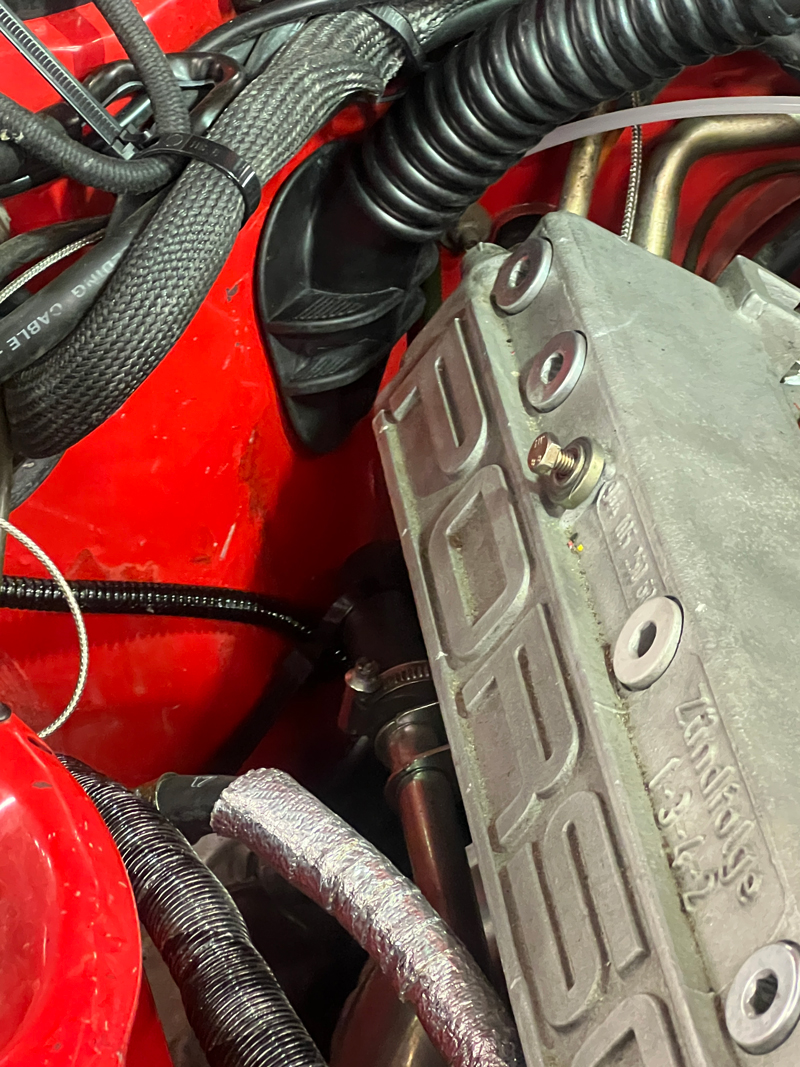

I opted to move the harness to the leftmost position on that bracket, just to keep the Kroon harness as far from the turbo heat as possible.

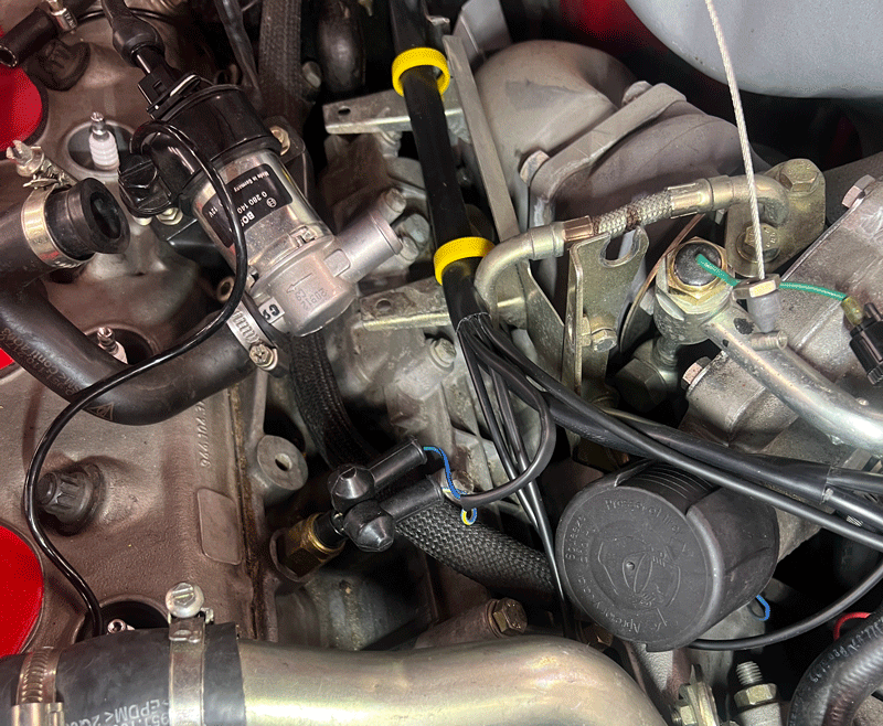

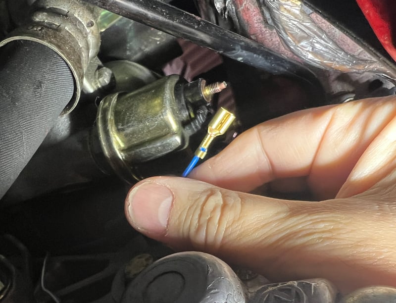

Next up was the oil sender.
Below: I tied a piece of wire to the old harness when I removed it to use as a pull cord for the new wires. The harness snakes behind the timing belt cover and is a bit of a chore to route properly without the cord.

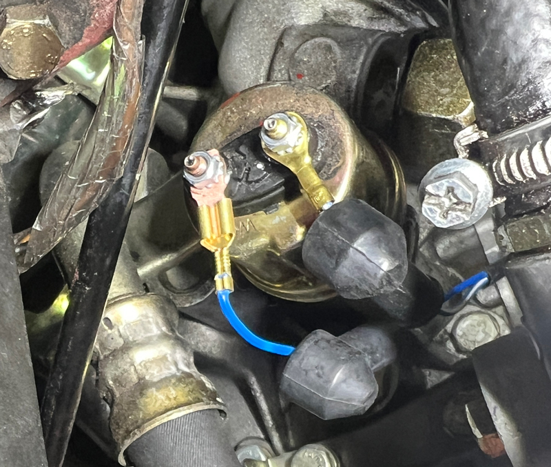

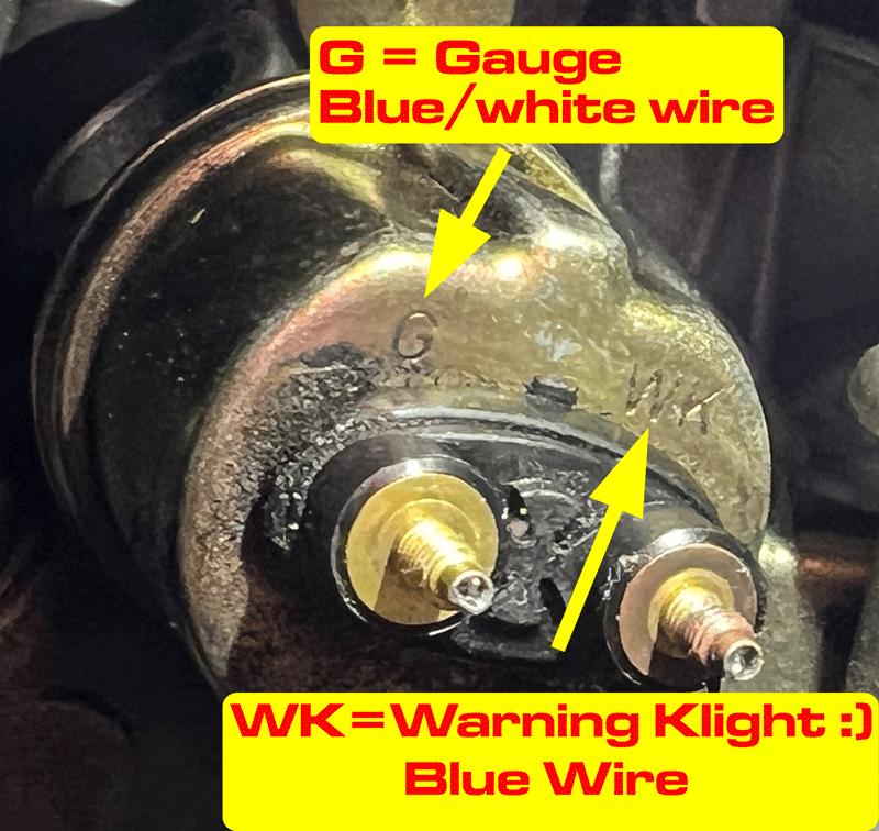

Below: The sender has two posts, one for the oil pressure reading on the gauge, marked G; and the other for the warning light, marked WK. The Kroon harness is faithful to the factory harness, with a blue wire with white strip for the Gauge post, and a solid blue wire for the WK post.

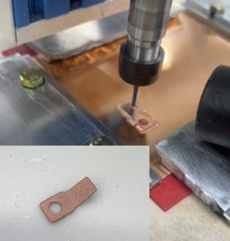

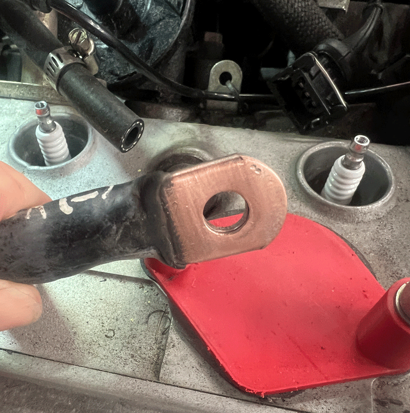

Below: The original factory sender used one spade connector and one eye ring connector. My sender, however, used 2 eye rings instead, which is common. True to the original, the Kroon harness comes with one spade and one eye ring connector.

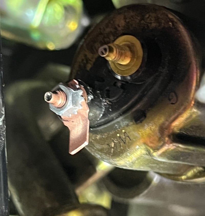

Below: I was not about to modify my perfect Kroon harness, so instead made a copper spade tab to install on the sender, just like the factory senders have. I used. .025" thick copper and my trusty CNC router to make the spade.
Sure, I could have made one with tin snips and a drill, but what's the fun in that.
