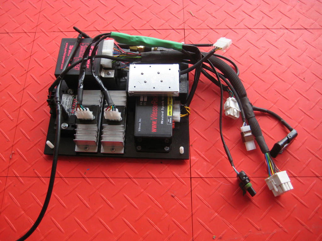

I was referring to using a stand-alone with a bone-stock harness. But you are right, you can add adapters and run extra wires, etc. to let you run things like MAFs and wasted spark with a normal DME. I've run Vitesse stuff for years and am a big fan. John is a clever guy and repurposes some of the factory wiring to support his chip board too. Even so, you need to splice into the harness to get meaningful control over fuel and spark. See the electronics I ran with my Vitesse MAF below to gain basic control over fuel and spark, most of which spliced into the factory harness. Re stand-alone's, without lots of modifications and supplements to the factory harness, you could not take advantage of their core benefits -- i.e., the speed-density engine management with sequential injection and the tuning precision that comes with it -- nor any of the ancillary functions it can perform. With effort, I'm sure you could modify and supplement a stock harness to take advantage of all that, but at that point it kind of becomes a 'custom' harness, albeit less elegant than one designed for the stand-alone. Just my two cents.
