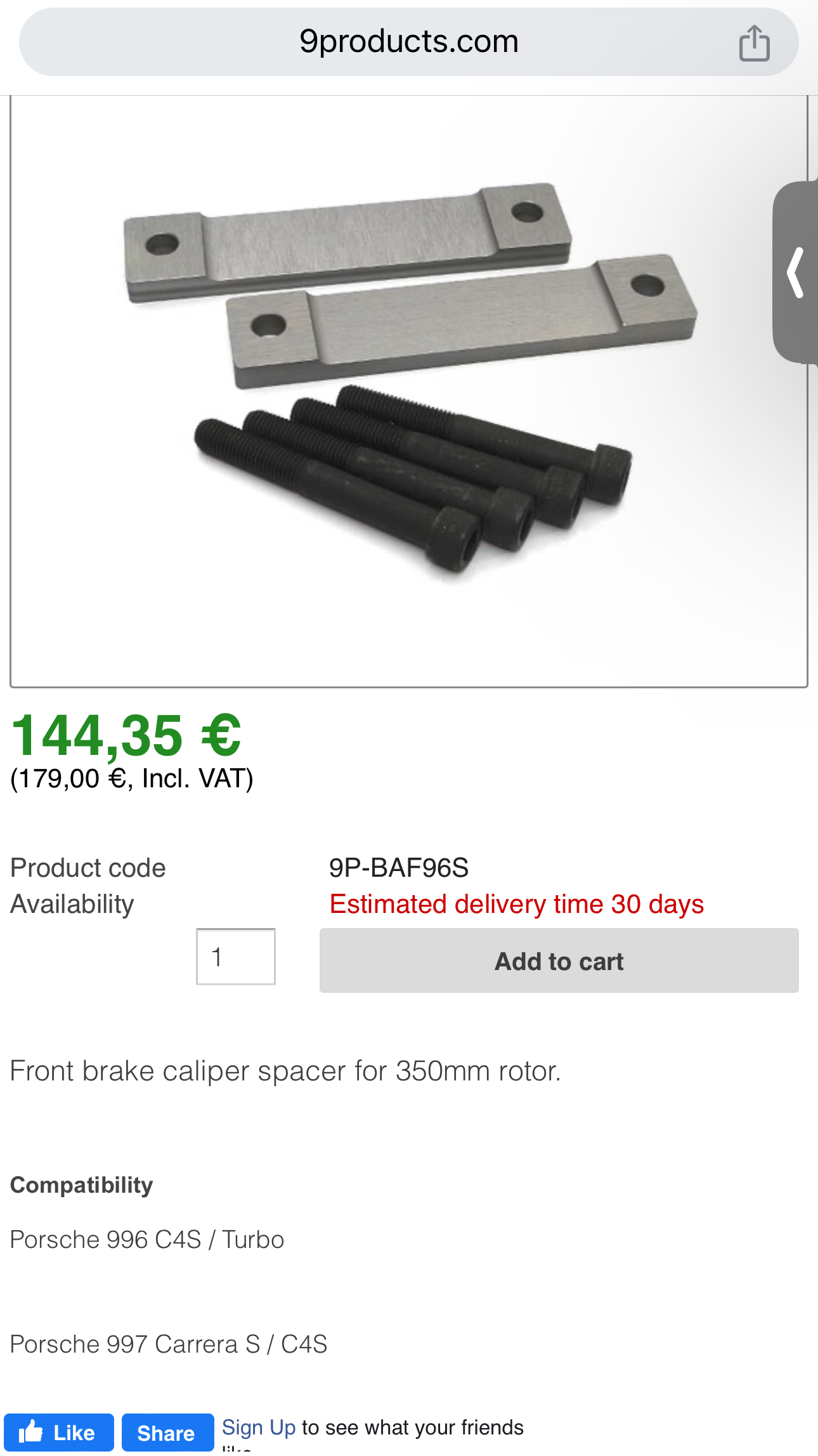

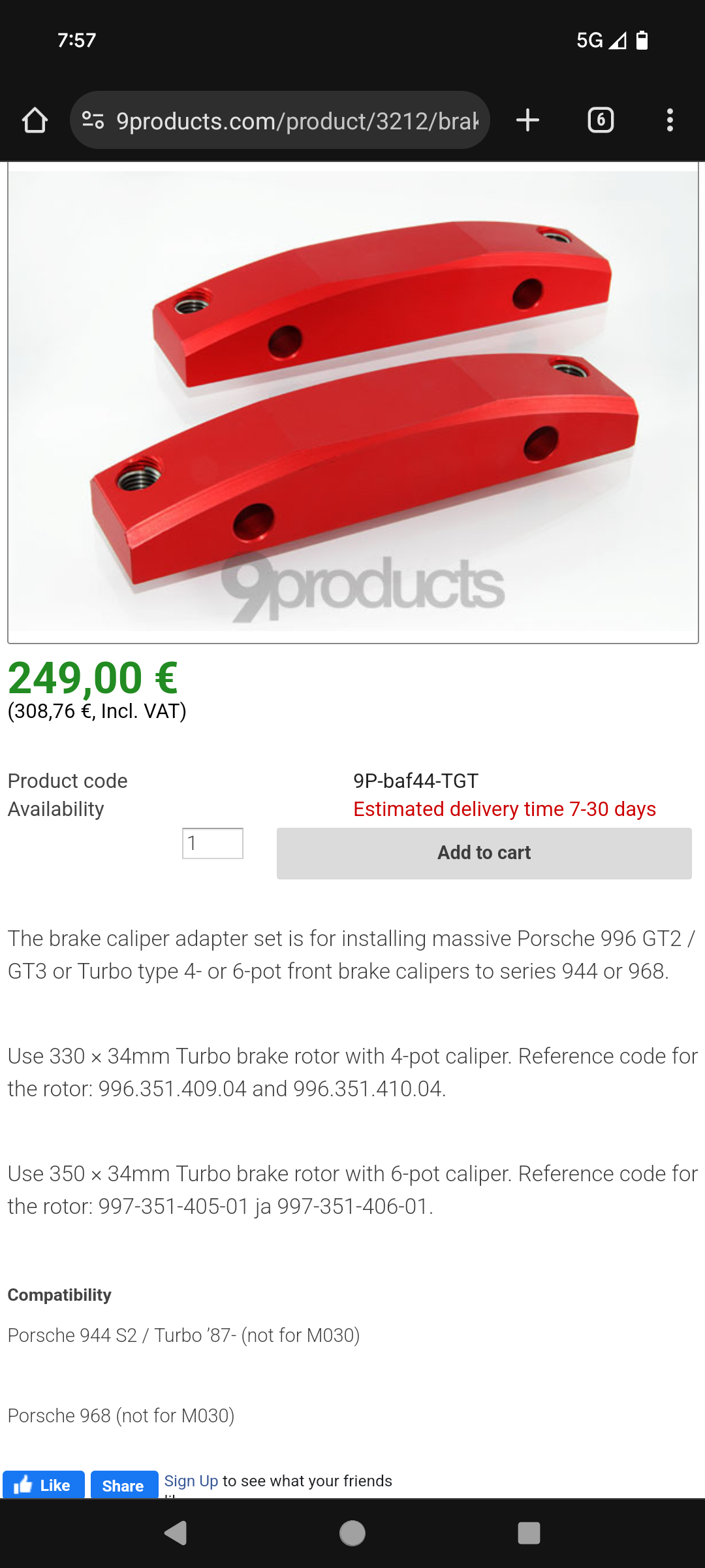

Which is why I asked him if I’d need a spacer when he suggested the 350mm discs would work during our discussions in both WhatsApp and voice. His own website offers them for this exact application yet he still said “no”. The man is so disinterested in what he does that he can’t keep the data points of a discussion In mind concurrently long enough to connect the points and realize what he’s putting together in a package to be shipped out.
