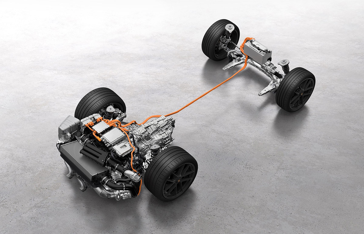

More on the new T-hybrid by PCA's Manny Alban -
https://www.pca.org/news/seven-facts-to ... -tech-tips
A few quotes from the article:
"Let’s first start off by not calling it a hybrid. Instead, let’s call it a T-hybrid ... this isn’t the same type of hybrid that you would find in a Prius or even a Cayenne Hybrid. That’s an E-Hybrid. No need to plug-in this 911 Carrera GTS."
"Porsche decided to install a 14.7-horsepower electric motor on the shaft between the turbo and compressor wheels. Its job is to spool up the turbo quicker than if it didn’t have it thus reducing any turbo lag. How much quicker does the motor help spool it up? It can reach peak boost now in 0.8 seconds versus almost three seconds on the 992.1 GTS with twin turbos."
No starter or generator.
Electric A/C & pwr steering.
Water pump integrated inside the engine
No drive or accessory belts.
No EV-only mode.
New engine is 3.6L vs previous 3.0L but 4.5" less engine height.
Additional total vehicle weight of 103 lbs is minimal for what's been done to the car.
Tuners will have a field day adding massive HP (200?, 300?, more?) once they figure it all out.

Yes they are!Tom wrote: Tue May 28, 2024 10:53 am Wow, 26psi boost running at stoichiometric air-fuel ratios, plus an electronically driver turbocharger. What will they think of next? If the motor is strong enough to hold the power,tuners are going to have a field day with this car!

I was under the impression that the Boxster/Cayman replacements were going to be all-electric, but Porsche is moving the bar behind the scenes trying to gauge customer reactions and moving gov regs, so who knows? The T-Hybrid-only GTS 911s were not anything I had expected as I figured Porsche would offer ICE variants across the entire 911 line, at least for a few more years.Stormy_Monday wrote: Mon Jun 10, 2024 5:56 am can't wait until this t-hybrid makes it the Boxster. we can always hope.....
Better hold on to ICE Porsches.
In the past I've said I'd never own anything but a pure ICE. However, if one wants a new 911 GTS...........
My excuse for the day will be that the T-hybrid is not a really a hybrid in the strictest sense that we've come to expect from that term. Rather, it's more about enhanced turbo performance (pretty awesome, actually), HP assist using an electric built into the PDK, and lots of new technology, all of which assists attaining Lambda 1, helping meet certain (unnecessary imo) regulations.

Porsche has been doing hybrids the same as pretty much every other manufacturer. Check out the 963 Hypercars (and those from BMW, Ferrari, etc.) to see where that technology can go. Also, much of the change is being forced by automotive government mandates worldwide whether any of us like it or not.911-Purist wrote: Mon Jun 10, 2024 4:41 amI guess Porsche had to jump on the bandwagon.
No thanks. Even my daily driver will never be a hybrid.
If you read a bit more on the new GTS (some good video too) you'll see it's not a true hybrid in the usual sense. It's actually some impressive engineering. How good will it be? Only time will tell.
Meanwhile, Porsche is referring to it as a T-Hybrid. With an electric motor running the turbo and a small HP/torque assist electric built into the PDk, it's not at all like the regular hybrids out there. For instance, there is no electric-only mode.
However, I realize where you're coming from and I tend to agree, but if one wants a specific new vehicle one must either play the game or forgo obtaining anything new.

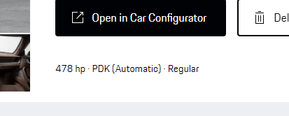

From Porsche's configurator for the 992.2 GTS.
This is the first time that I've ever seen a 911 that doesn't call for Premium fuel. There has been no mention of this in any of the intro videos or articles. I can't even find any mentions on the internet regarding the car only needing regular fuel. Is this part of a Euro mandate?
It was just by accident at the end of a build I was playing with last night that I saw it. Can it be possible?
Any other build will say "Premium Unleaded".
