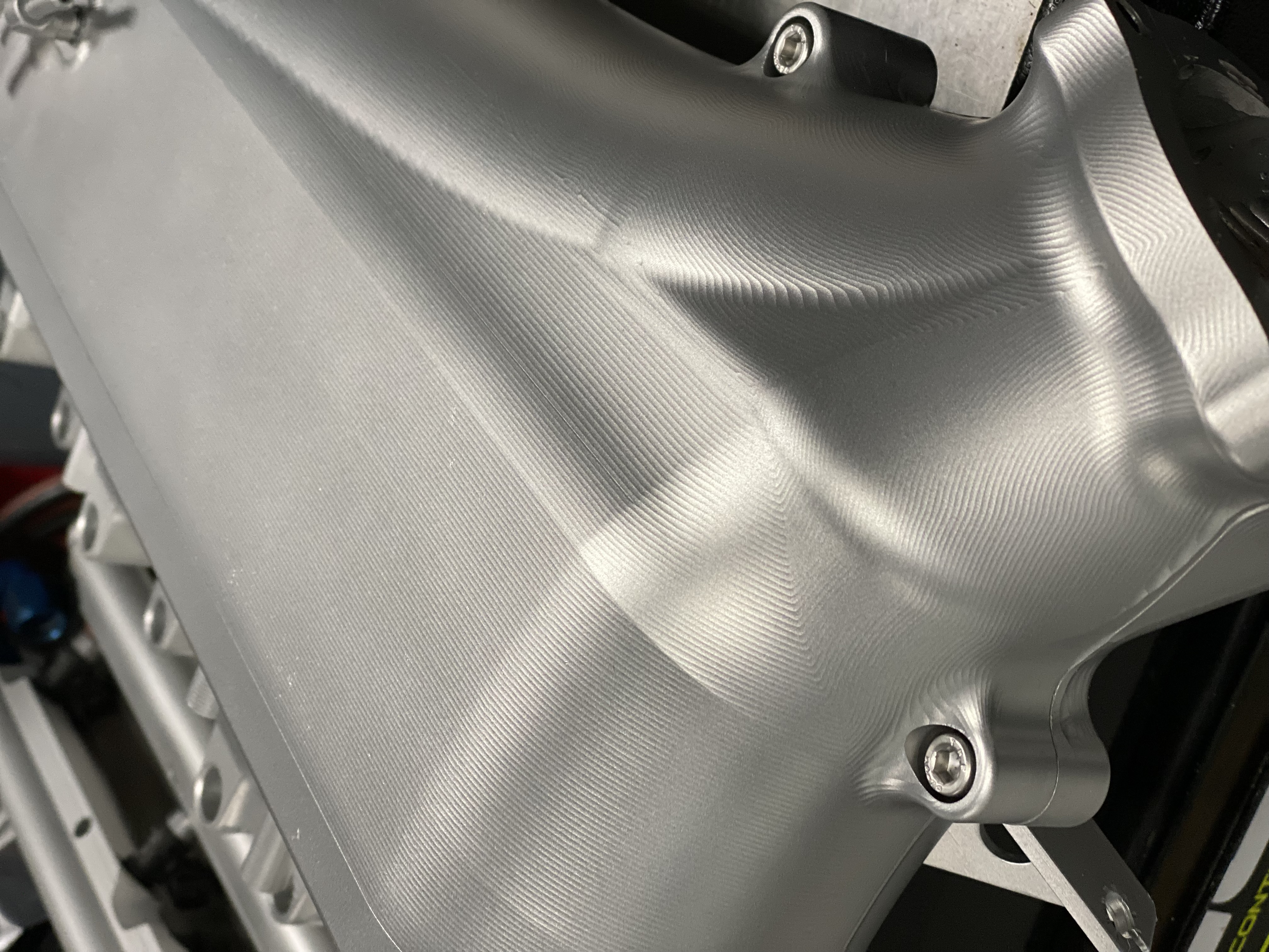

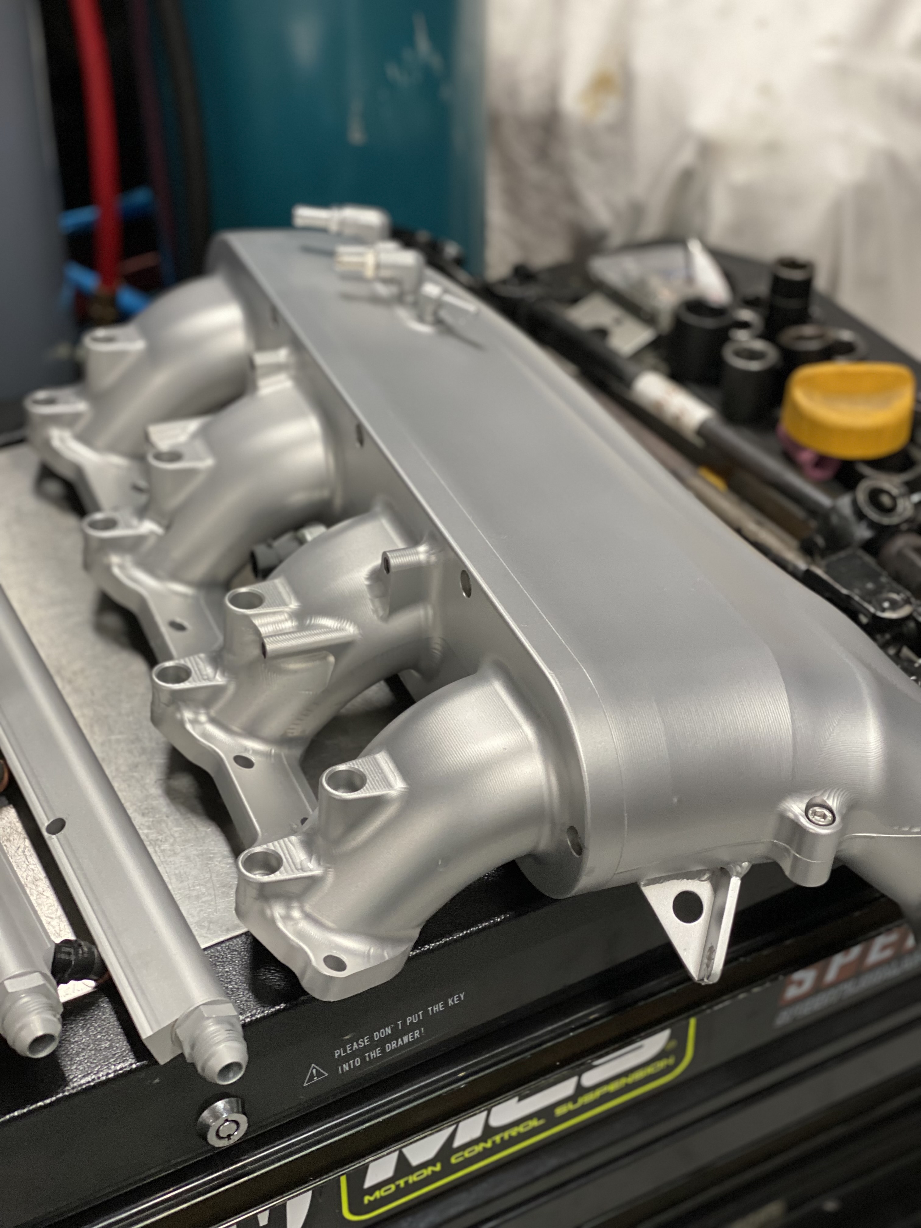

michaelmount123 wrote: Sun May 26, 2024 3:40 pm I'm quite sure a 944 intake manifold could be made in 4 pieces with only minor changes to the cylinder head flange bolt pattern. Here is one I had machined for a 4V using the ATPower throttle bodies. It resulted in a GORGEOUS piece of kit, but was pretty pricey. Unfortunately the engineering company wouldn't give up the CAD files.
If you had a sample part I could use as a template, I could most likely do a CAD replicate in all my spare time -- might take a while, but I'm like the tortoise who just keeps plugging away against all odds. :)

I've also wondered about this. I've seen bits of intakes 3D printed and even a complete one but these have been made only for fitting purposes before finishing the product as a metal part.
Looking at my CNC'd intake, it's clearly been built in parts to be constructed as a whole. Could you smart people not make something similar and even if the material is strong but perhaps hydroscopic, you could dip, coat or line the internals to deal with any chemicals?

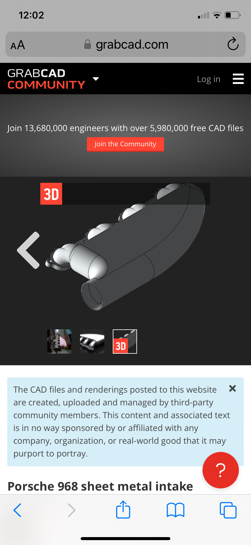

I have always wondered about the 968 manifold on Autcad , if it can be printed or on parts as Patrick mentioned .
