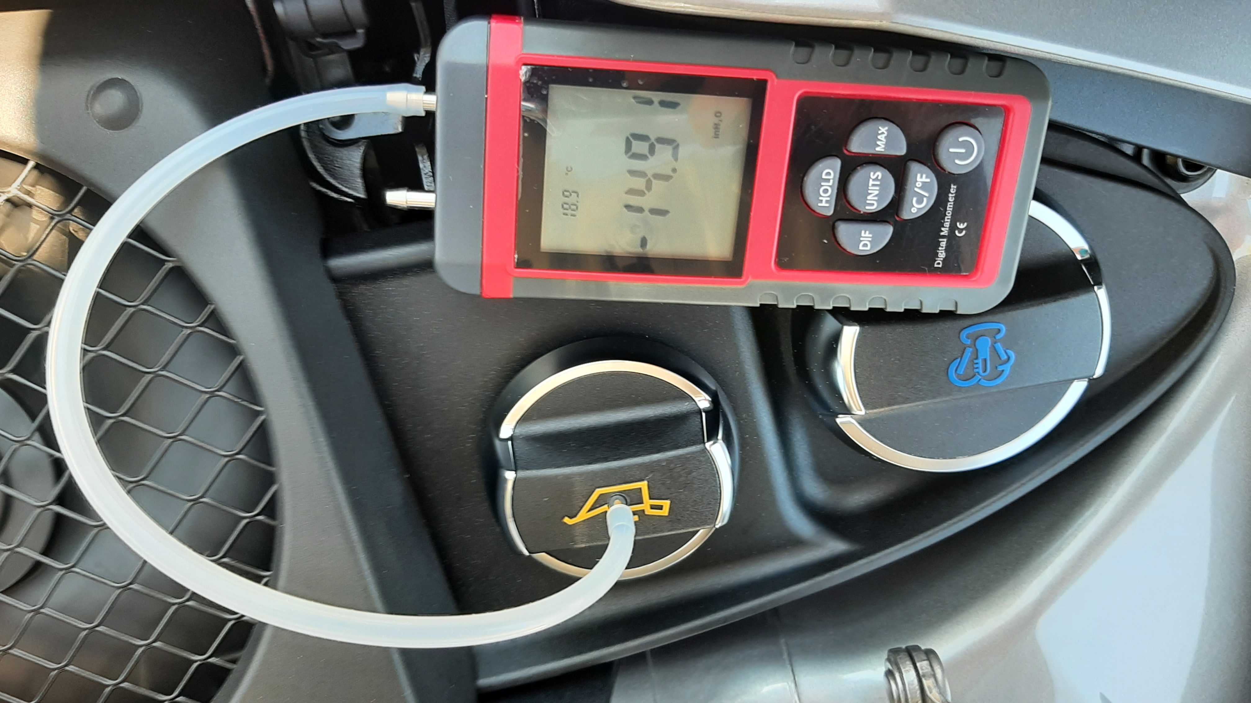

Before the AOS failed on my 991 (MA1), I wanted to confirm the reading of -14 to -16. I got -14.91.
