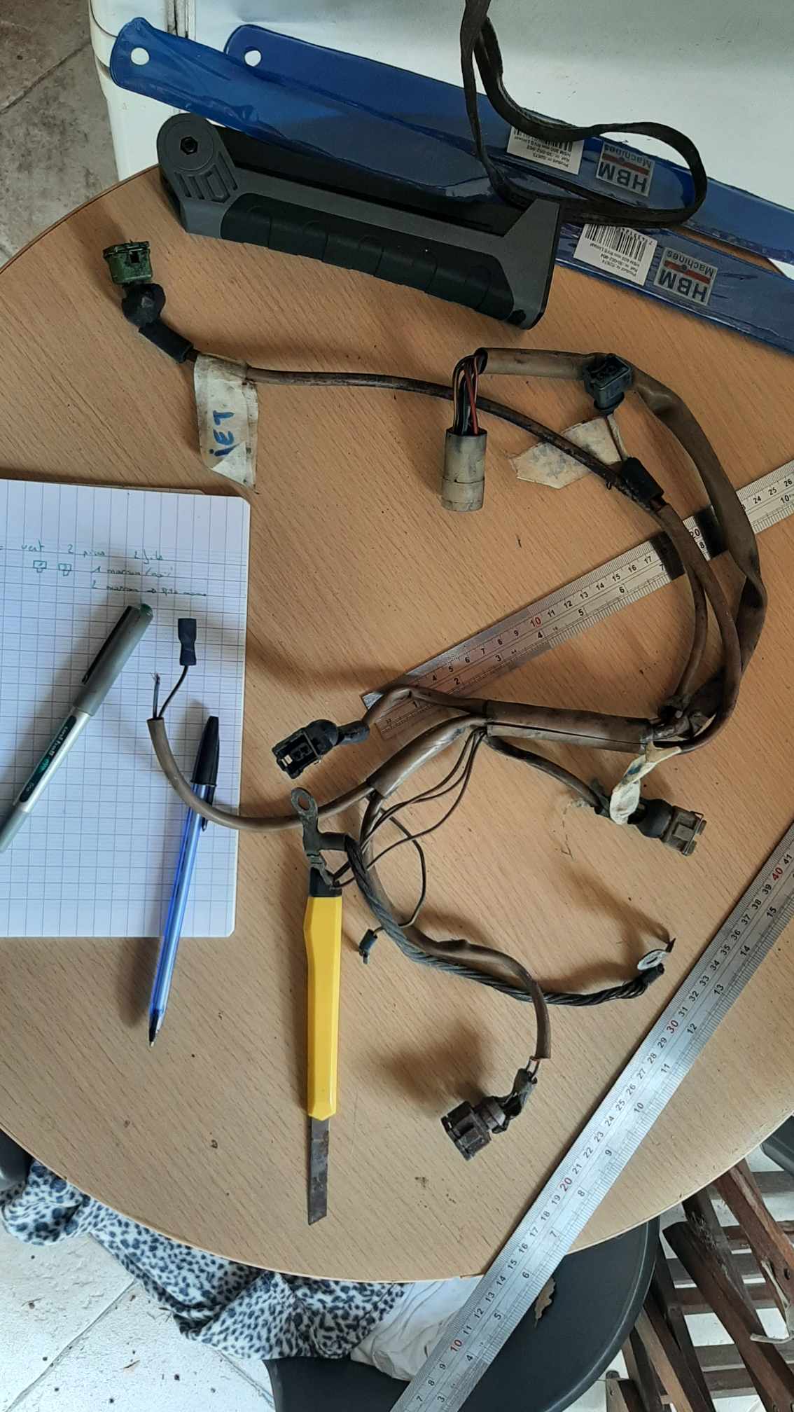

Hey all !
To pass the time, waiting for money to finish the engine, I work on the harness.
As I'm going to fully redone it, I have to make a diagram of it, as I don't find any for the 1977.
I share my firsts plans with you, if it can help anybody.
I tried to make them in a position seeming the reel position on the car. May it help beginner to understand and follow it easily.
I use generic draw for the connector, so please don't take care of that. It may have some mistake as my harness is in terrible state, and some color have totally change with the time ! What a baffling problem ! So feel free to correct me and i'll update the diagrams !

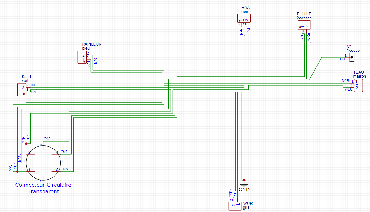

"Ignition" Harness
Schemas cablage 1.png (56.01 KiB) Viewed 296 times
Papillon = Intake Valve | RAA = Auxilliary Air Regulator | PHuile = Oil Pressure | TEau = Water Temperature | WUR = Warm Up Regulator | C1 = I dont know what it is... I've search in the PET, look for it on websites to buy it, i really dont know what it is, it's on the water temperature sensor support but not in contact with the water. If you know what it is, I would be grateful ! :clap:

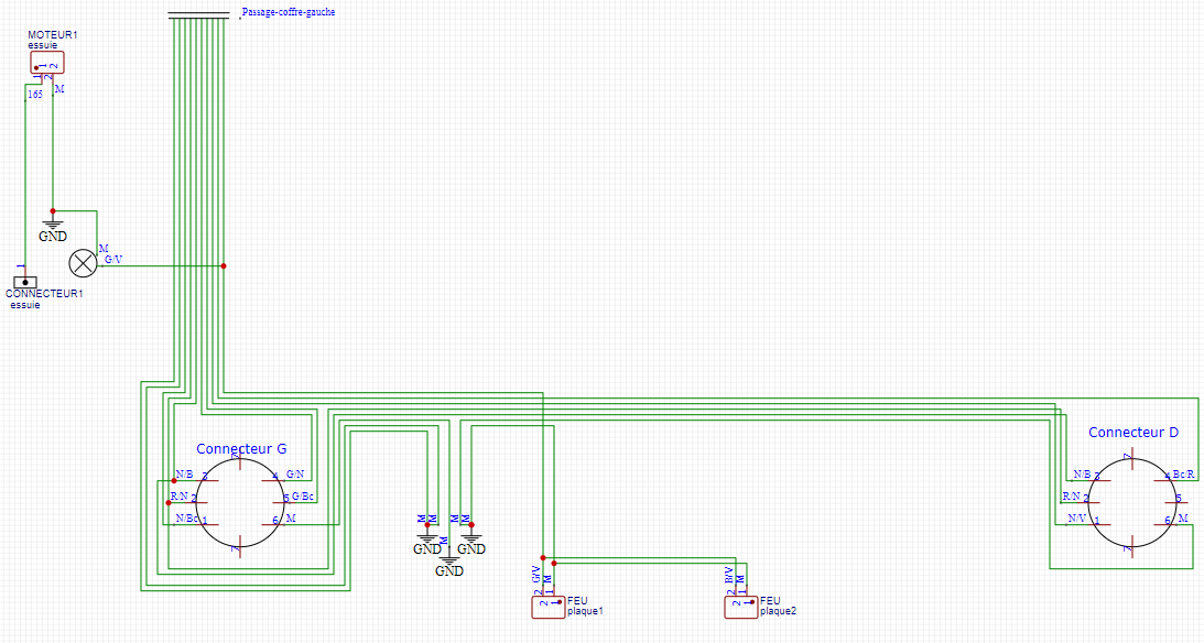

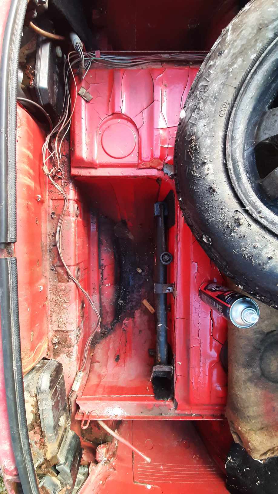

Trunk harness
sCHEMAS CABLAGE FEUX ARRIERE.png (39.3 KiB) Viewed 296 times
Connecteur D = Right Connector | Connecteur G = Left Connector | Feu Plaque = Plate Light | Moteur 1 = Rear Wiper | Cross in a circle = Lamp (not visible on the photo)
I can share an Excel document with all the colors, directions and the AWG. I haven't finish it yet, and I'll do it for the entire harness.
Hope it'll help !

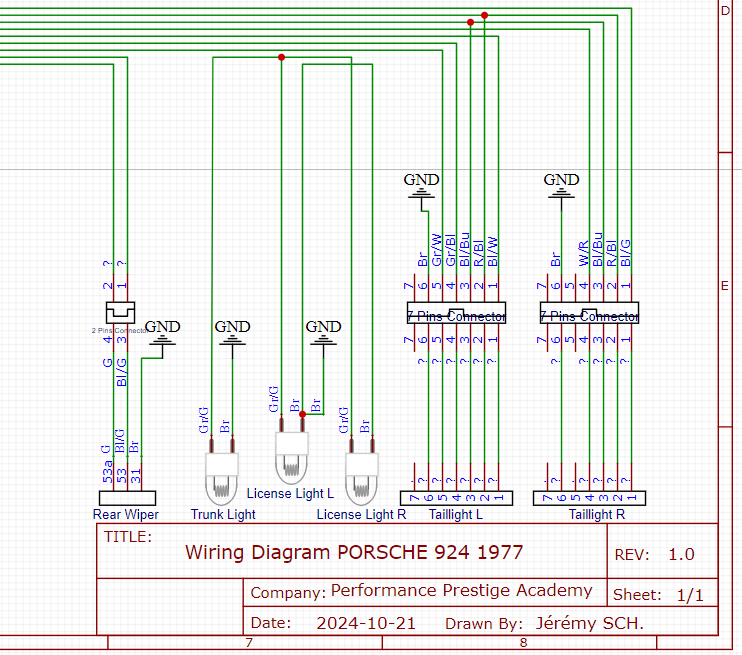

Hi all !
As I work on the wiring diagram and still want to share it with you, I have begun to draw the full car wiring diagram, as a standard one. AND A FULL VERSION IN ENGLISH !
Here is a first draw, I'll will share the full one, one's it will be done.
I'll continue sharing some intermediates diagram, waiting for the full result
Hope it'll help you !
