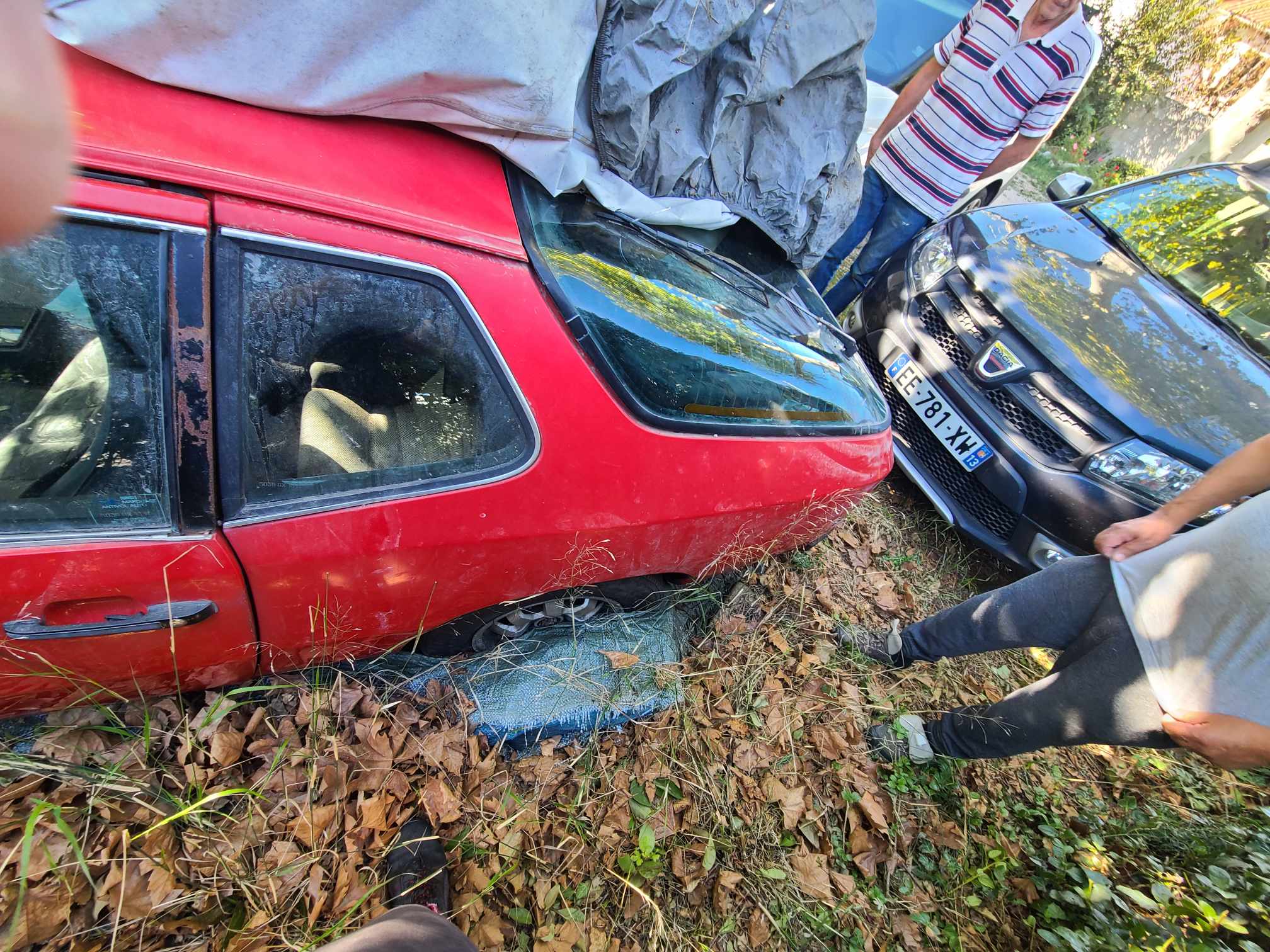

Let show you how i found it

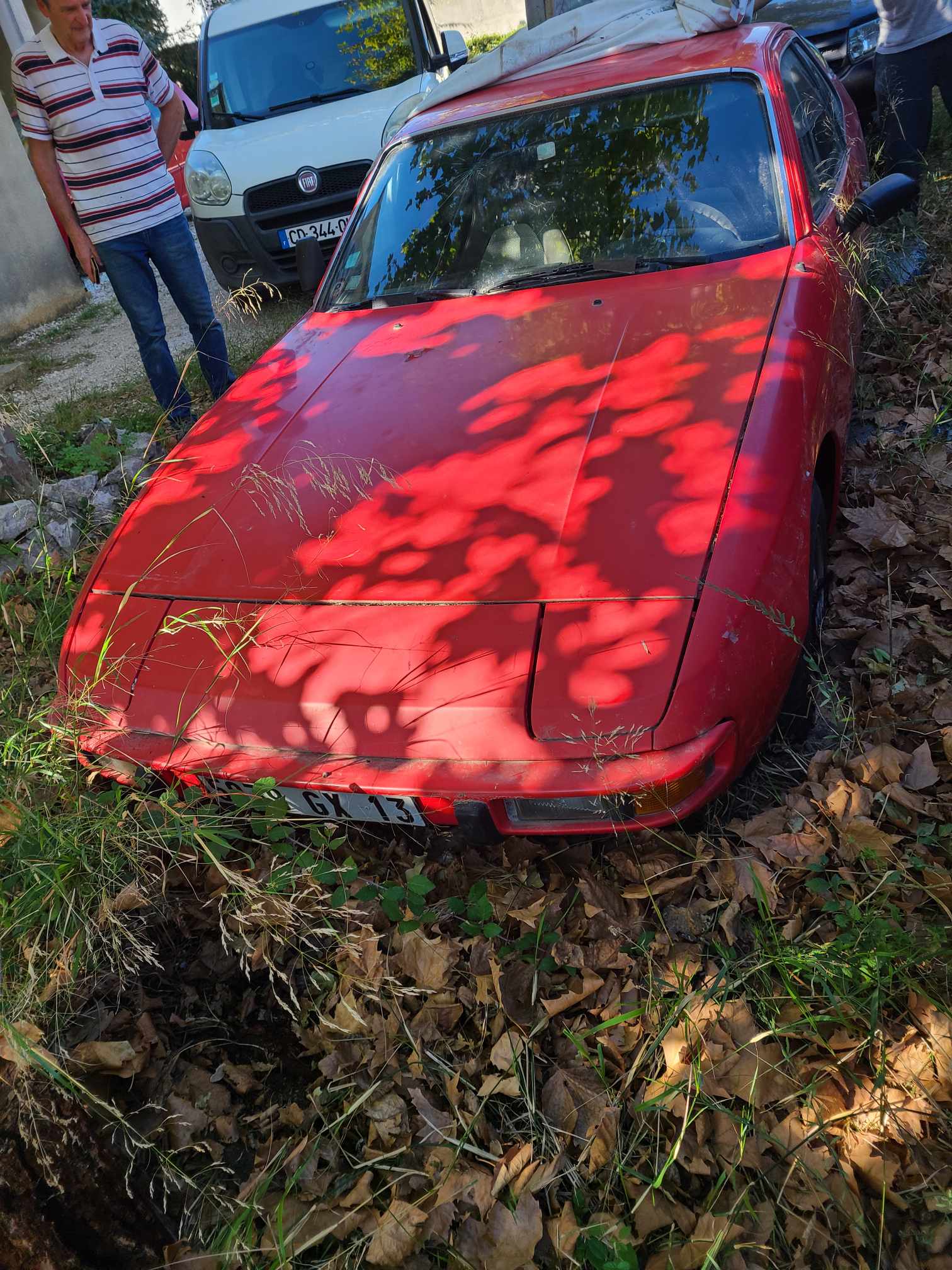

face avant
face avant
parebrise
parebrise

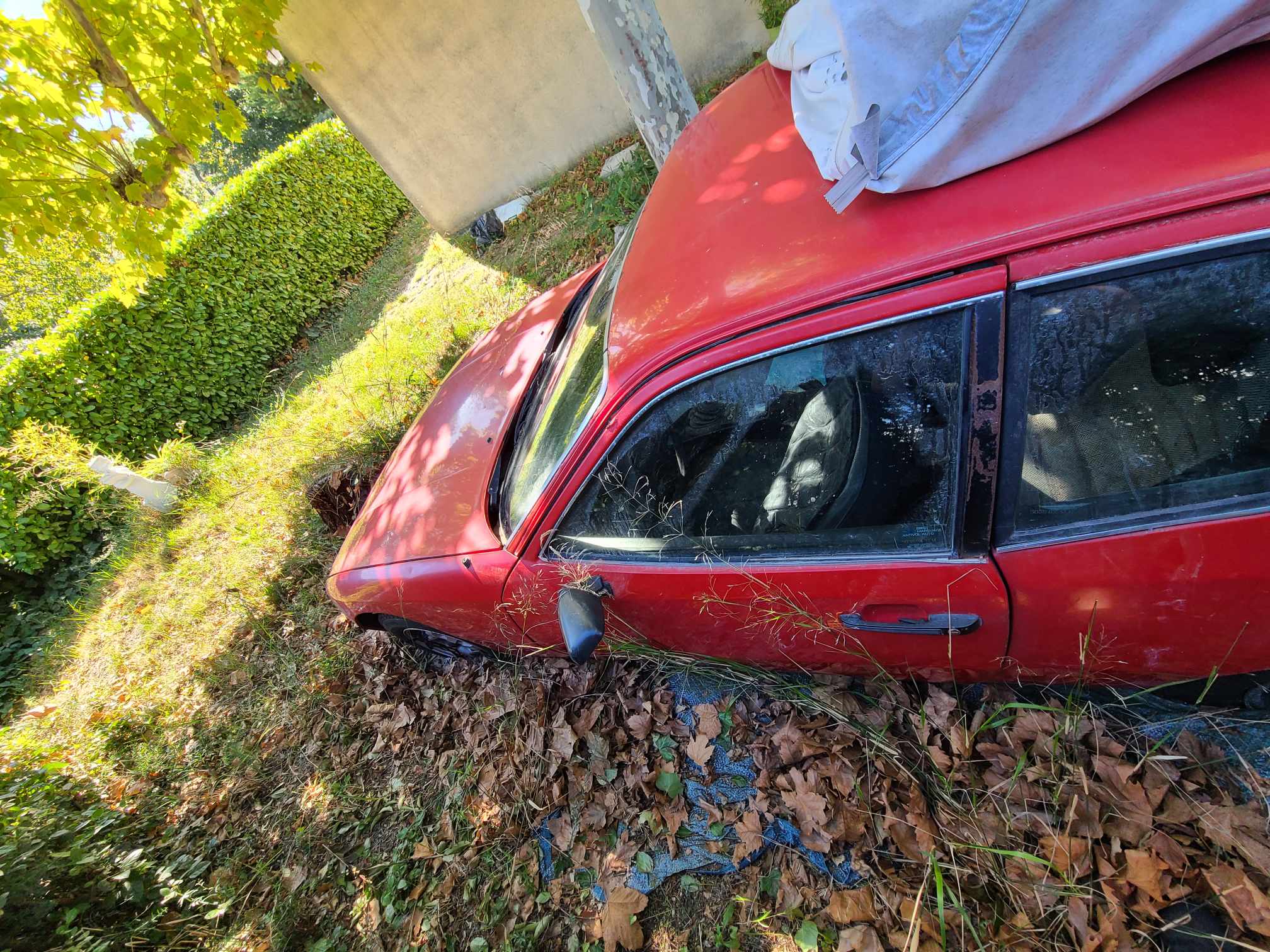

côté gauche
côté gauche
arrière gauche
arrière gauche

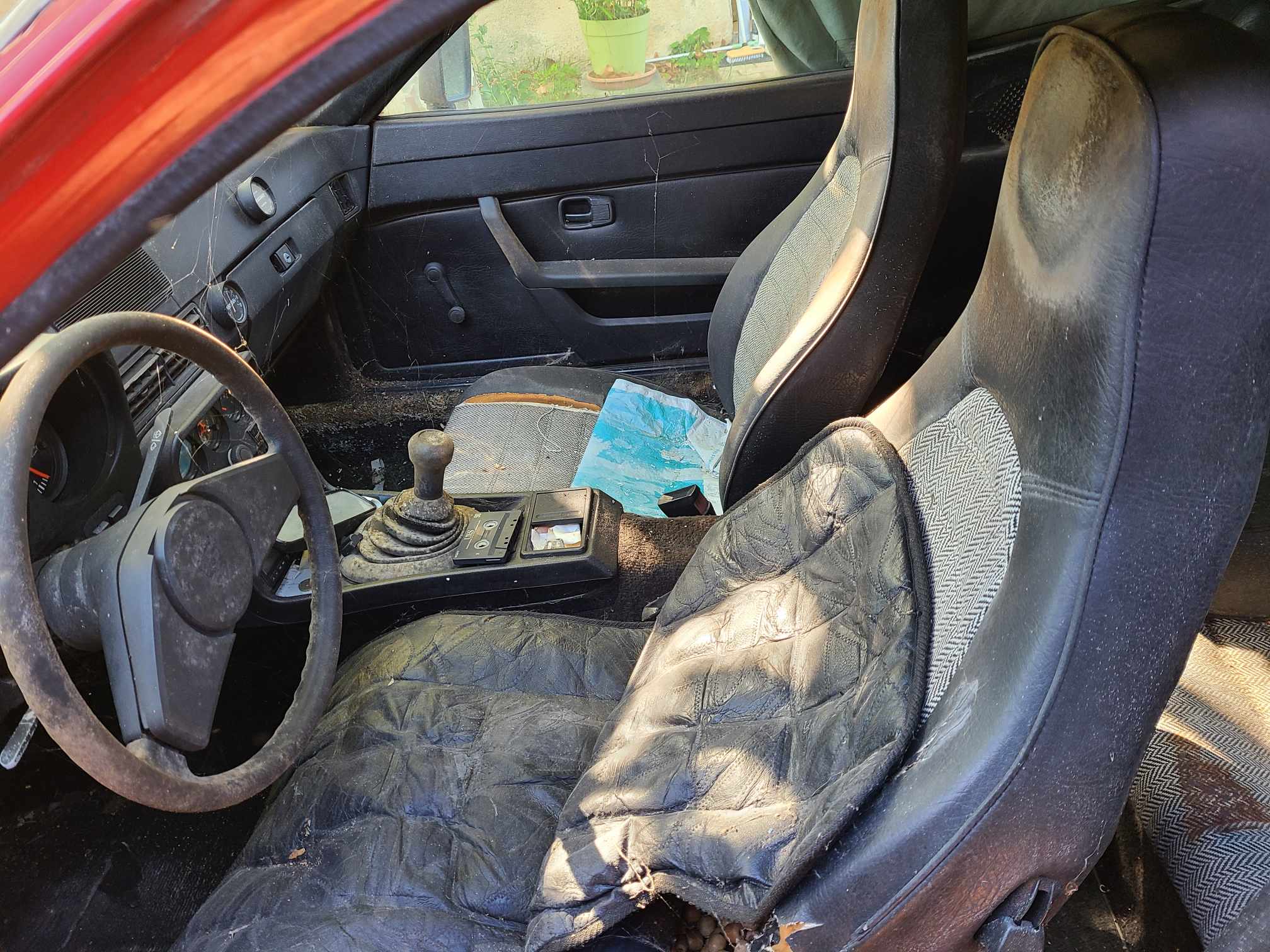

intérieur
intérieur
tableau de bord
tableau de bord
compteur
compteur

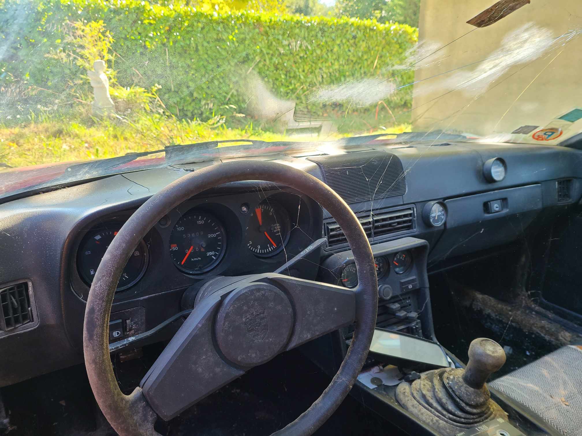

As you can see, all the interior has to be done at new. It's full of moss and all plastics are cracked, moist, etc...

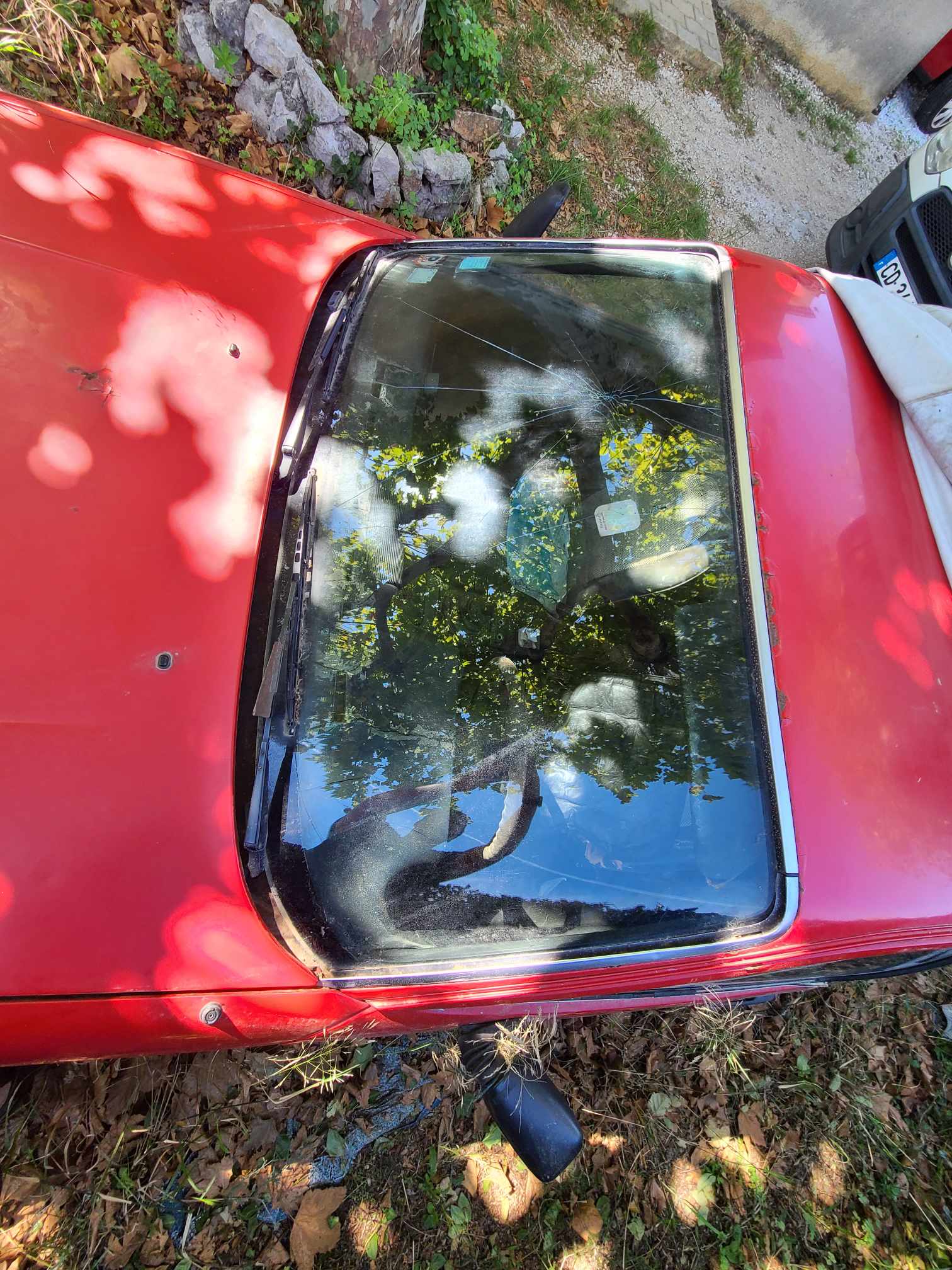

The body frame is in a partial good state. A lot has to be done. Multiple bumps and scratch, and a windshield to replace.
I couldn't see the engine because the cable to open it was stuck. But for a free car, how could i be demanding...

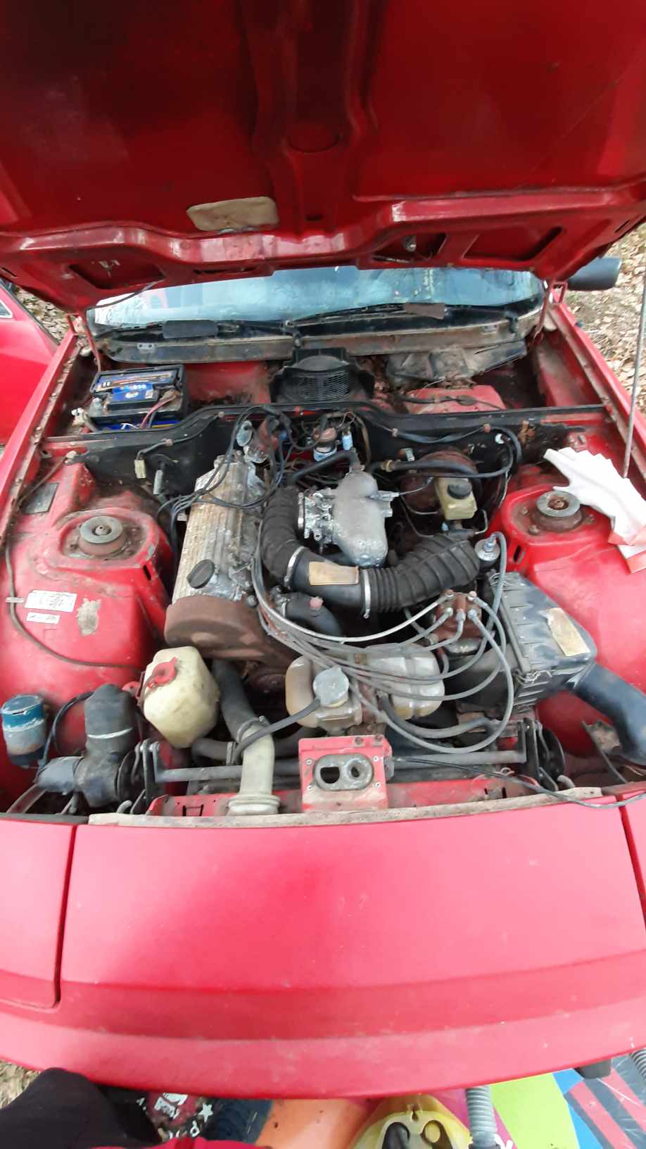

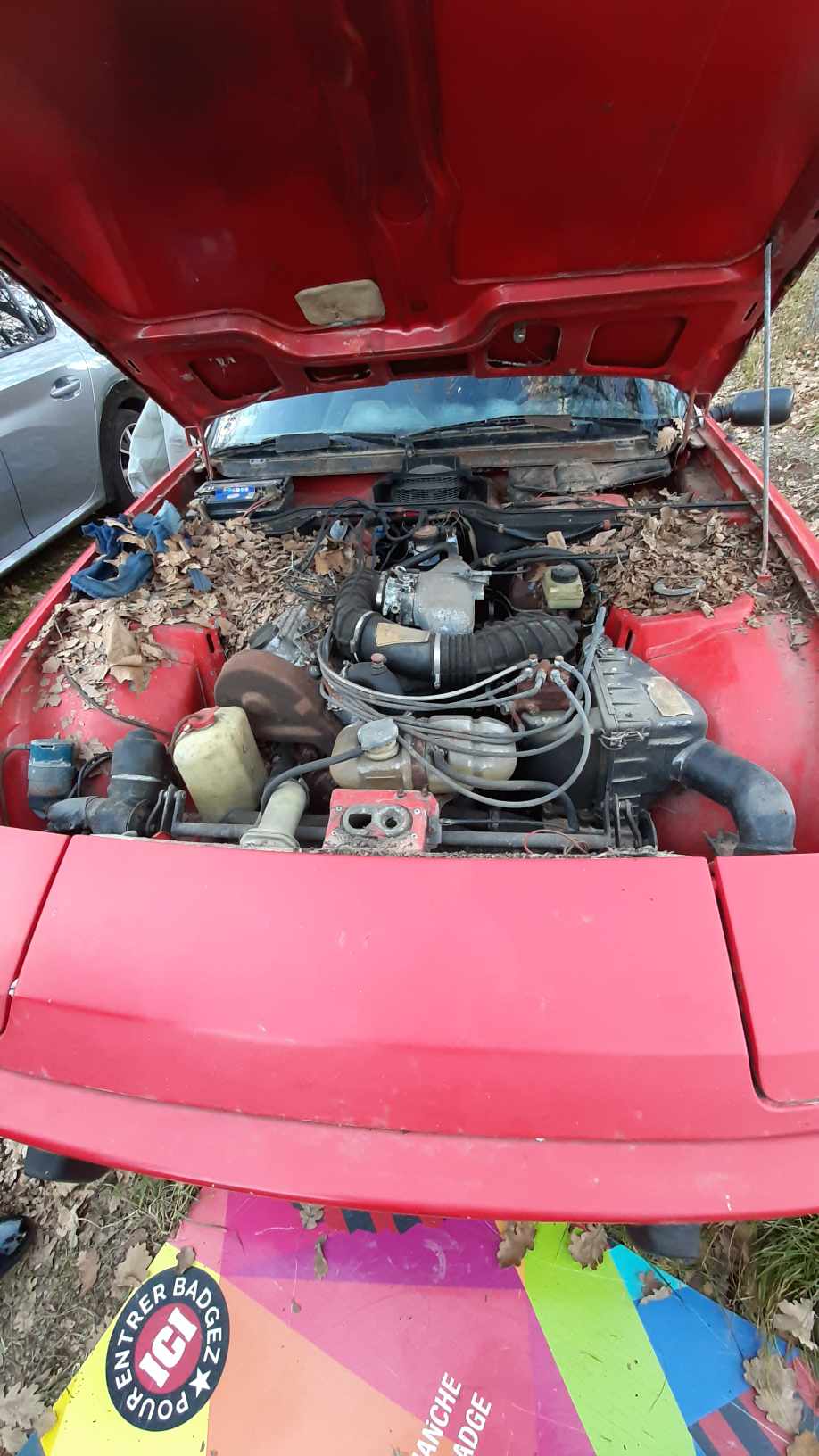

I begin by cutting the hood cable, and thank you Porsche, there is a LOOOOT of space to take it. And that's a lot of dirt, leaves, nuts....
capot sale
capot sale
capot propre
capot propre

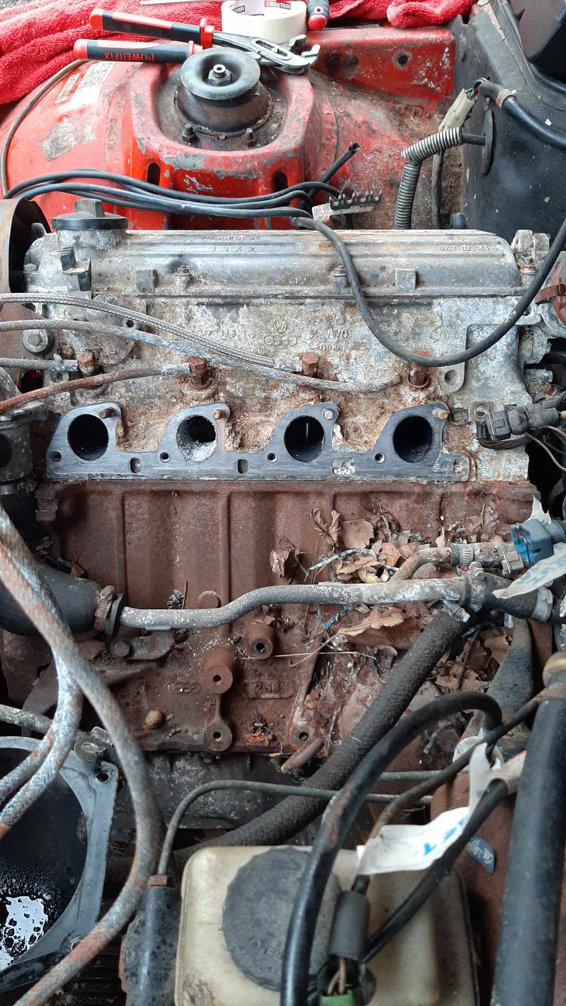

But it's in a pretty good shape for a 20years no running. I was waiting for a bigger deal.

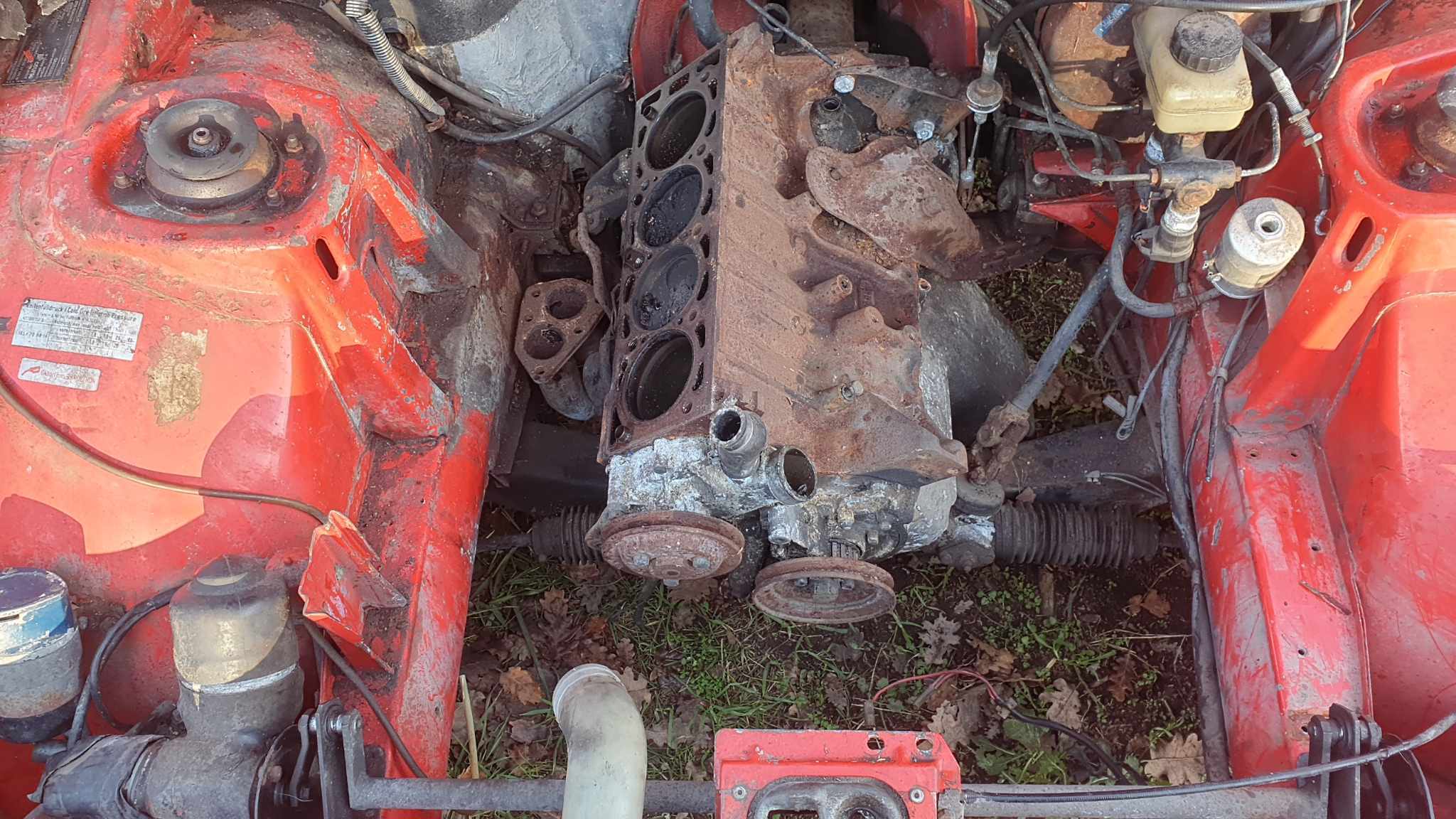

So lets take off everything around the engine (cooling system, air intake...), and clean up every part a little bit each time i get it in my hands. (some less work to do then)
moteur
moteur
Some corosion in the 2nd intake, but not a big deal after a quick clean.
the coolant is become grease with time (i could put it in any bearing balls :lol: ). I was scared to discover a head gasket failure.
So let's take off the cylinder head !

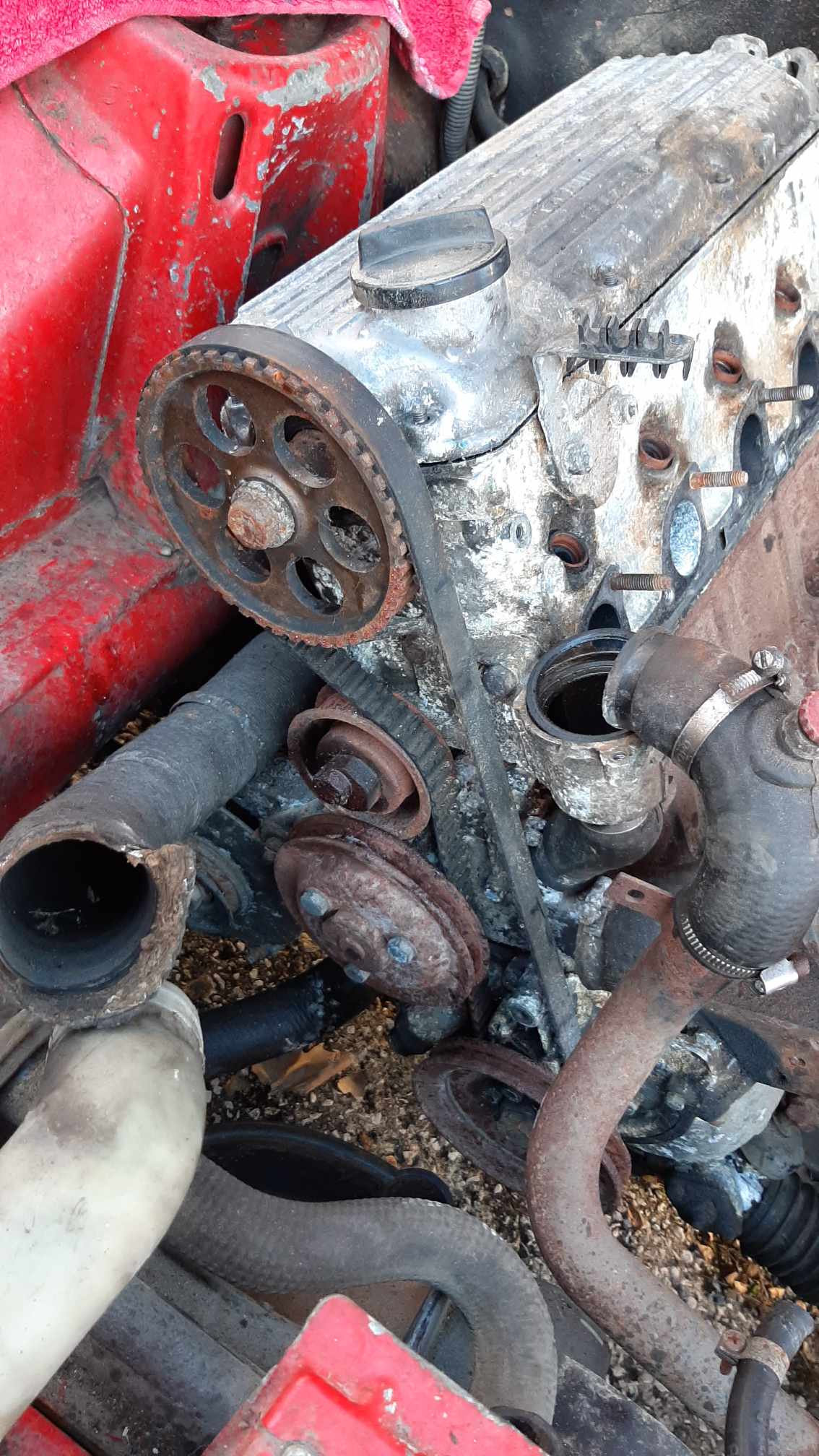

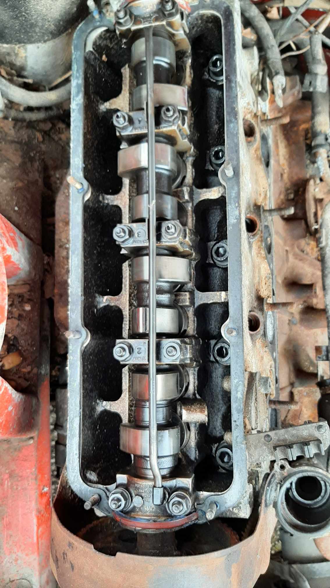

courroie
courroie
AAC monté
AAC monté
haut culasse
haut culasse
AAC
AAC
sous culasse
sous culasse
bloc moteur
bloc moteur
bloc moteur sous capot

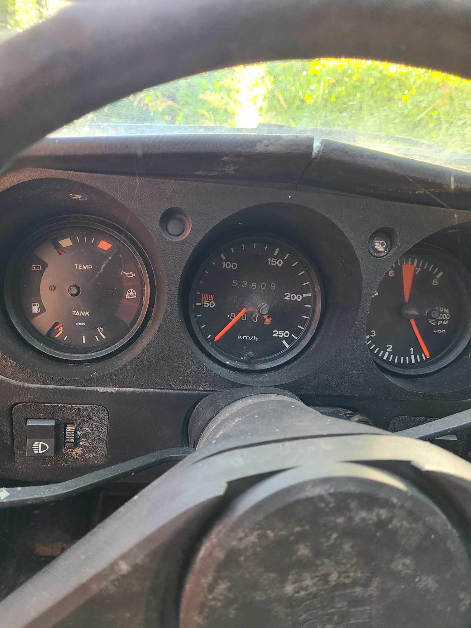

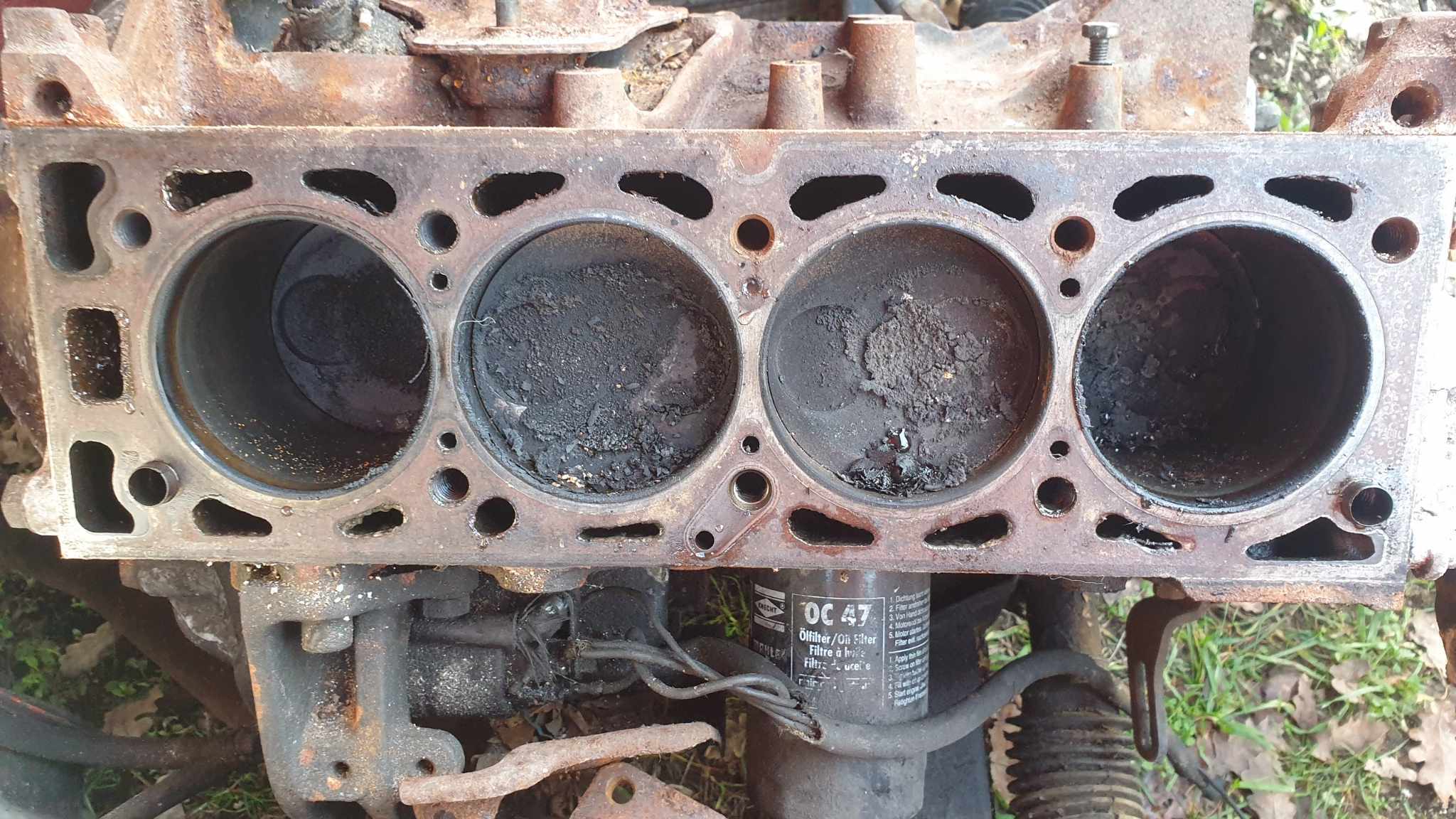

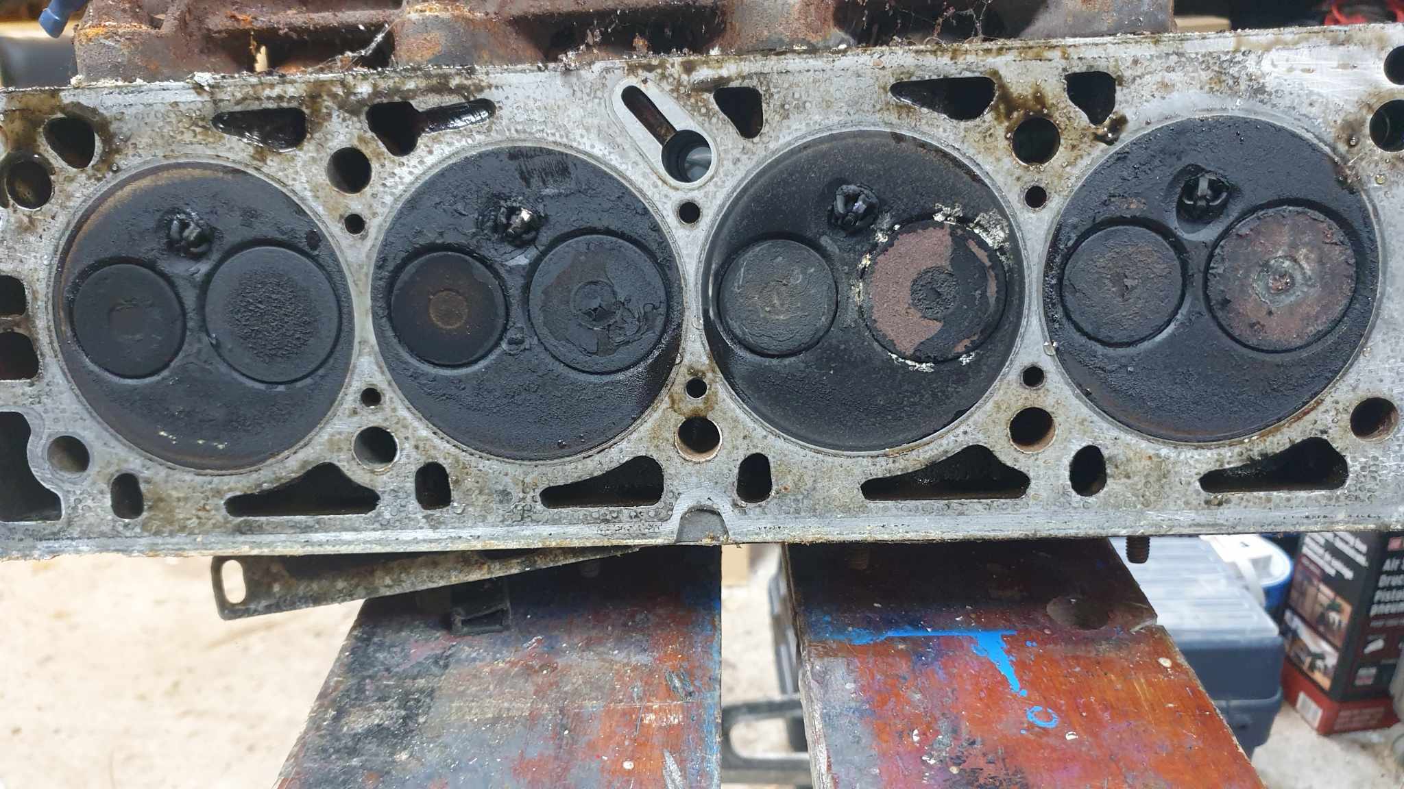

And.... Well.... We can see that it haven't runned correctly for a long time... In France we have a web site, wich relate every technical control and accident. It says about this car, that the odometer hasn't change from 1995 to 2002. But it passed the control every 2 years.
My conclusion is that the last owner just let the engine warm, and stoped it, without runing it on the road. That should be the reason for all that nasty things in cylinders.
But well, it's the game ! I'm here to restore it fully ! So let's roll up one’s sleeves !

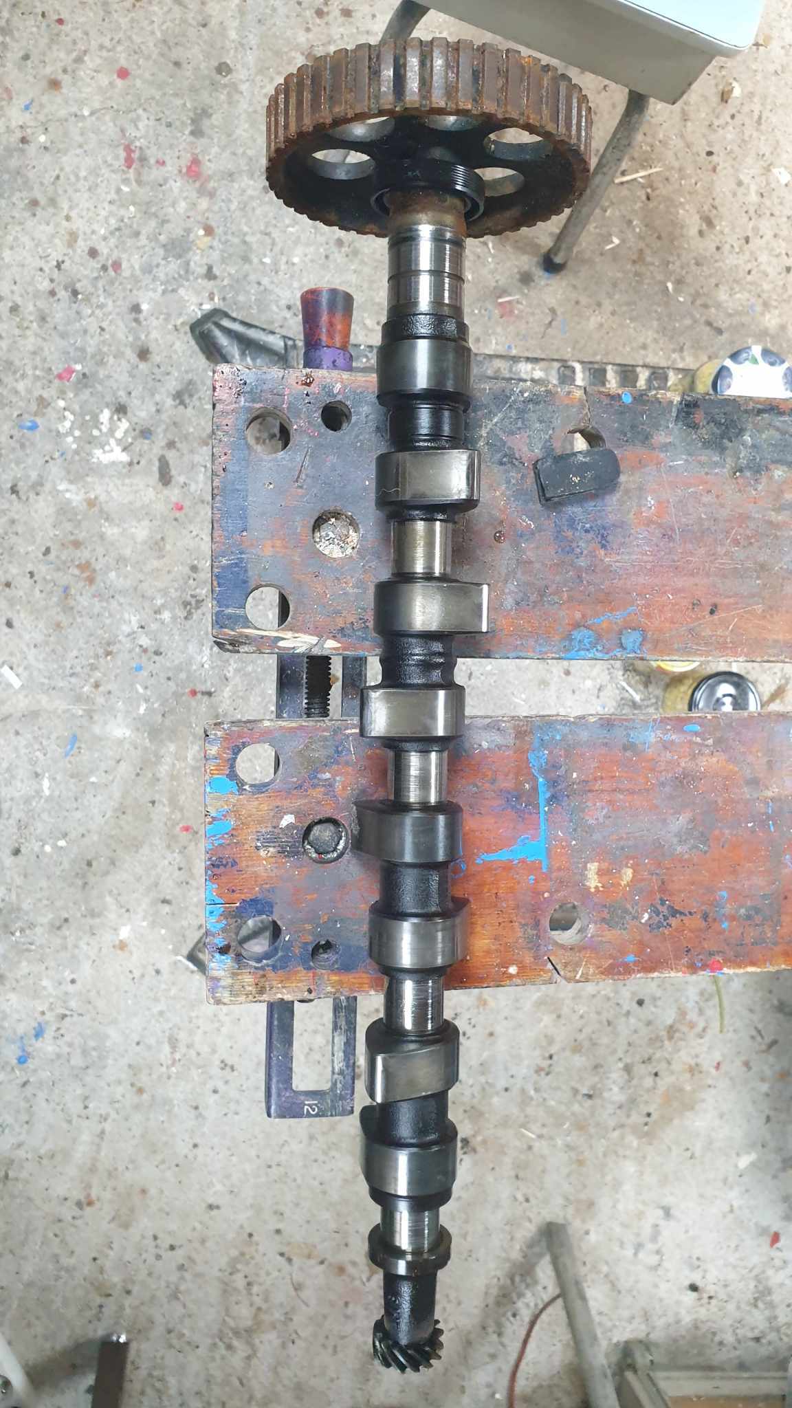

We can see some small problem of lubricant on camshaft. I think it's just because it didn't run often enought, and it has to start on dry pads. Not a big deal, a small sanding with a very fine grain should do the job correctly.

It looks like it is sitting very close to the ground. If it has been that close to the ground for all those dormant years, you might want to see if there is any major corrosion and rust in the floors and undercarriage.

CEW wrote: Sun Feb 25, 2024 5:58 pm Yes, very ambitious!
Effectivly i have watch it first !
I have a video, dont know if i can put it, but it's in an incredible shape ! No ruste, or near ! lol
Only the battery floor is, i think, completly dead. There is a big layer of something... don't know what. But it's not waterproof anymore. That would explain the moss inside

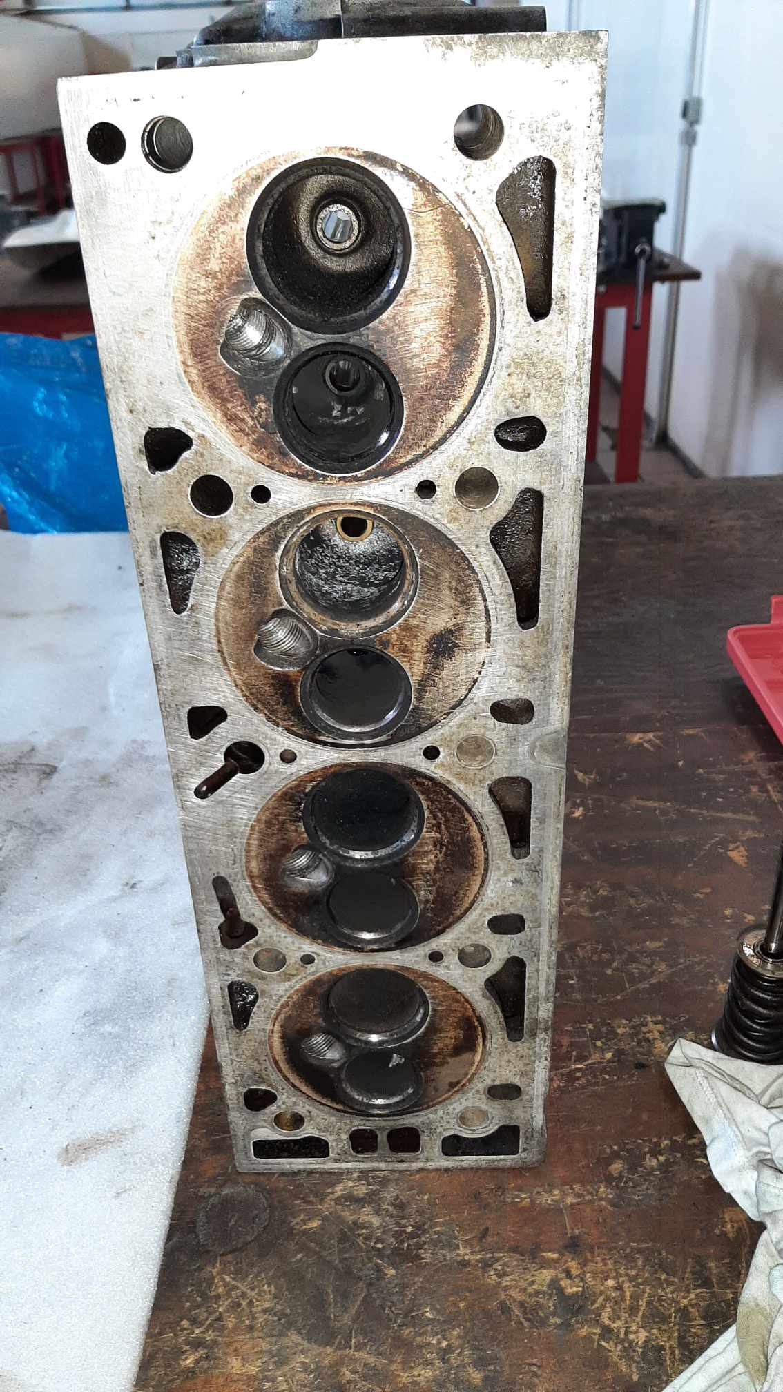

culasse 1
culasse 1
culasse 2
culasse 2

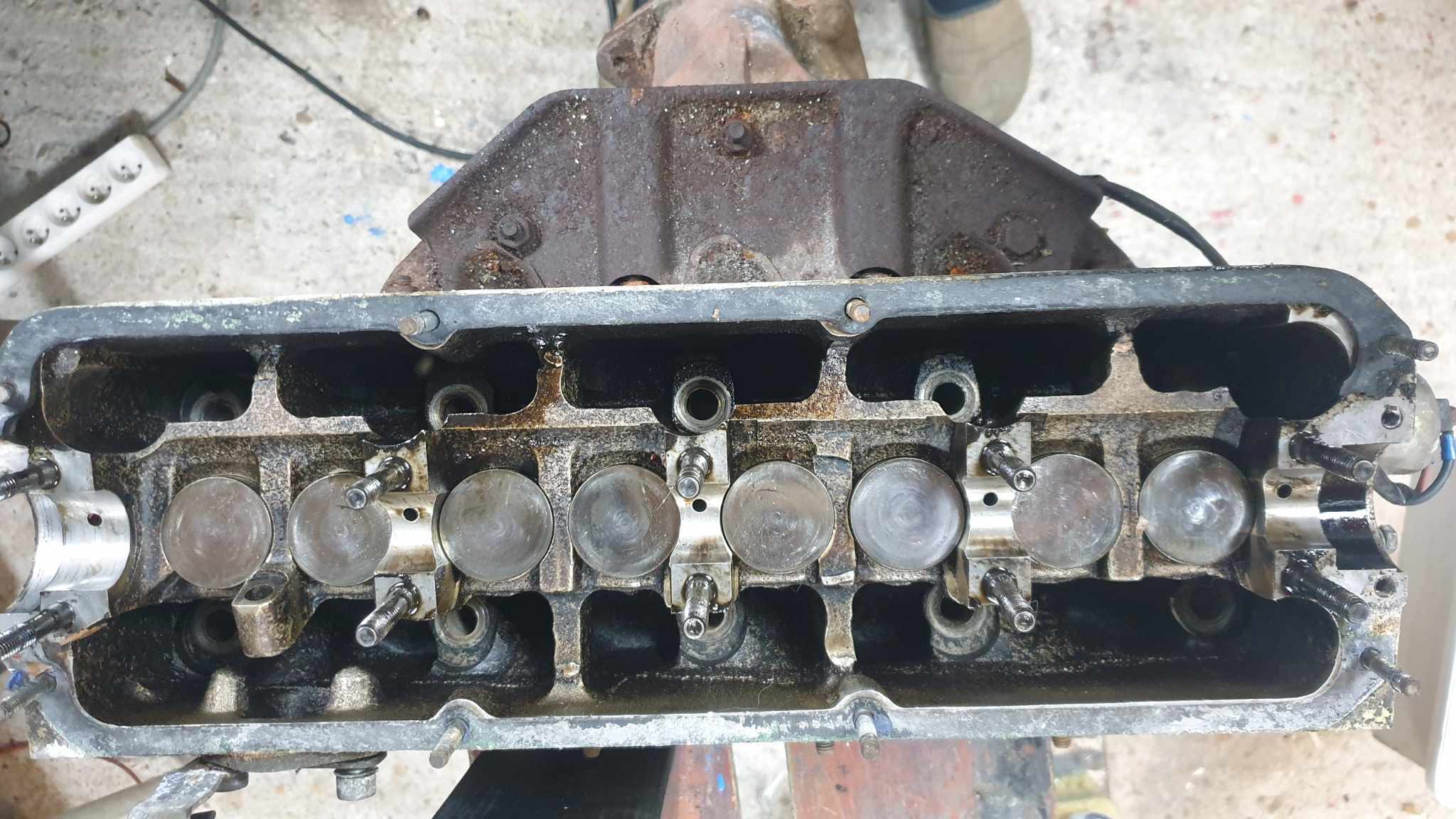

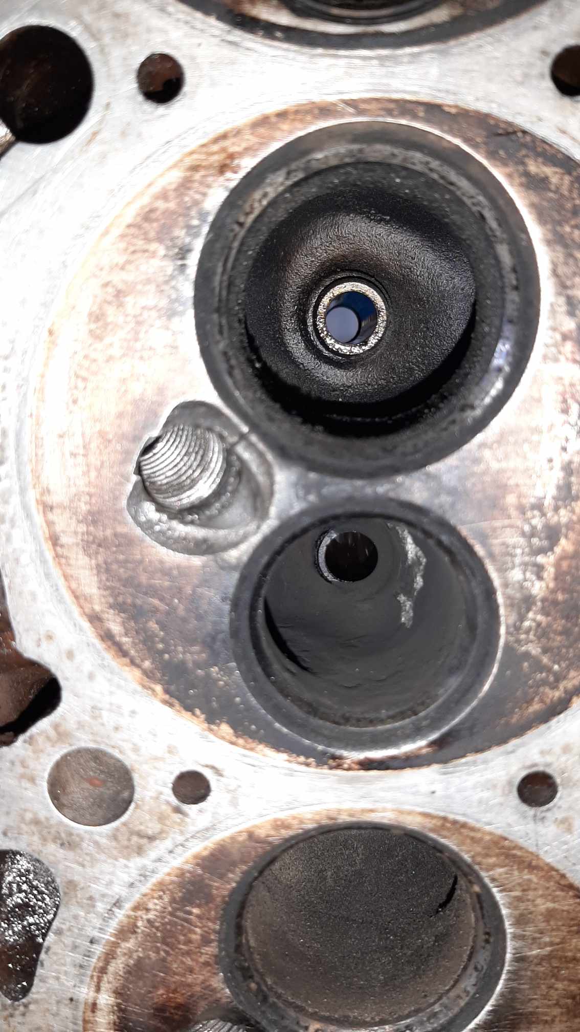

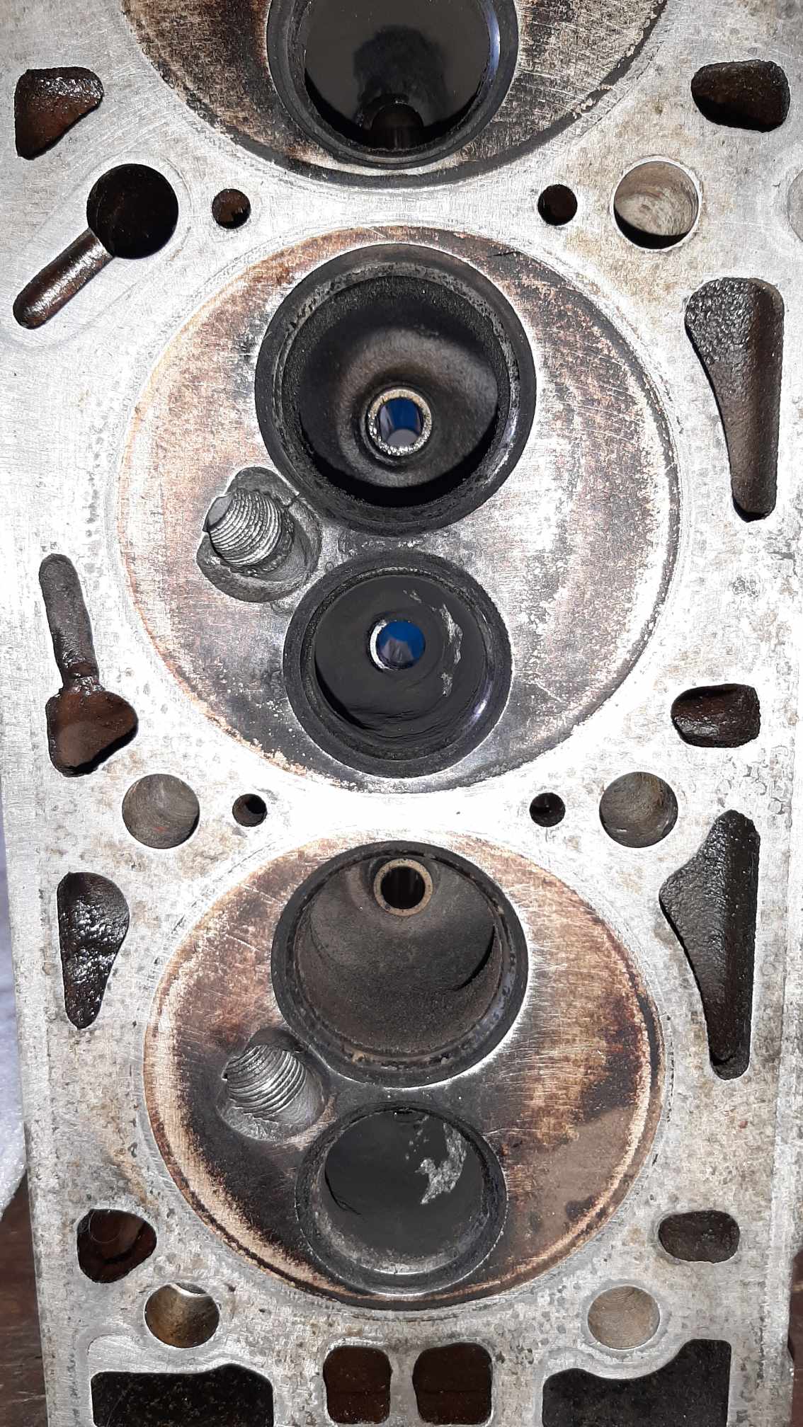

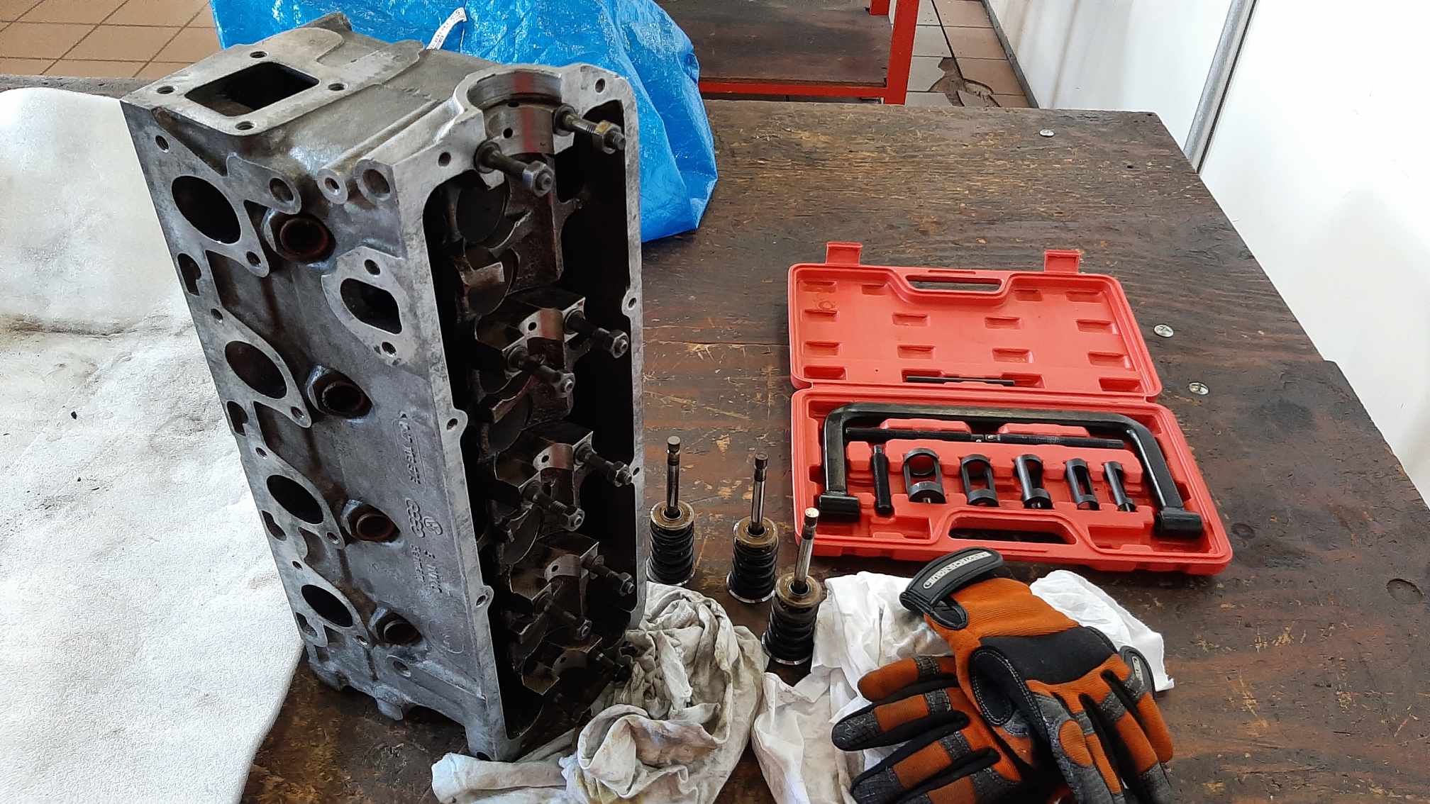

I have taken off the valves... What a deception to find 2 cracks :cry: :cry: :cry:
From the sparks to the valve seat, 2 are cracked...
culasse 3
culasse 3
Culasse 4
Culasse 4
I'm going to have to ask for a quote before to engage any work on the cylinder head. Maybe it'll be cheaper to change for another one...
I have found a french guy, next to my town, who produce new valves, for 200€ the 8. With that, i want to change the springs, valve seats, valve guides, and a big cleaning. I'll surely be at a 1000€ just for this cylinder head.
I'll think about it a little bit during the next weeks before working on it anymore.

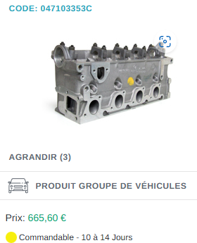

I took my cylinder head to a society next to me, and it's finaly going to be cheaper to buy a brand new cylinder head (665€ in France; 727USD)
Capture d’écran 2024-10-10 105445.png (56.29 KiB) Viewed 734 times
I'm gonna need to find a new camshaft and valves and rebuild this engine for a full brand new one
