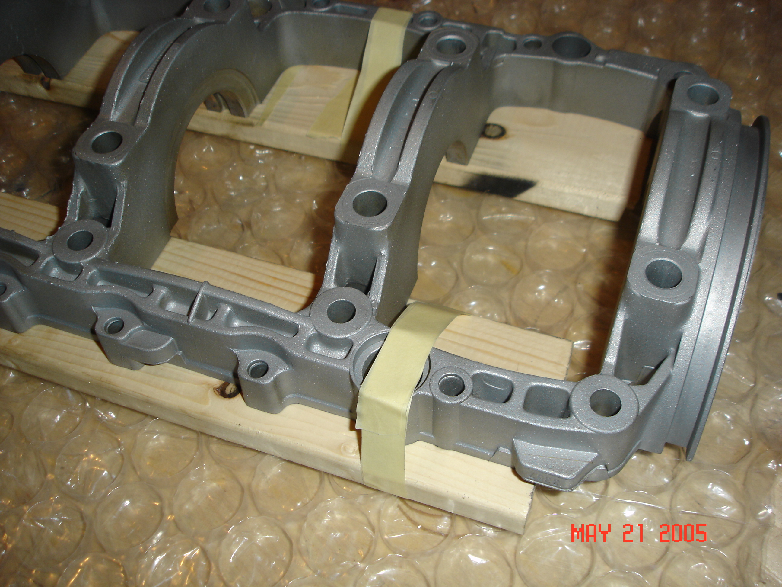

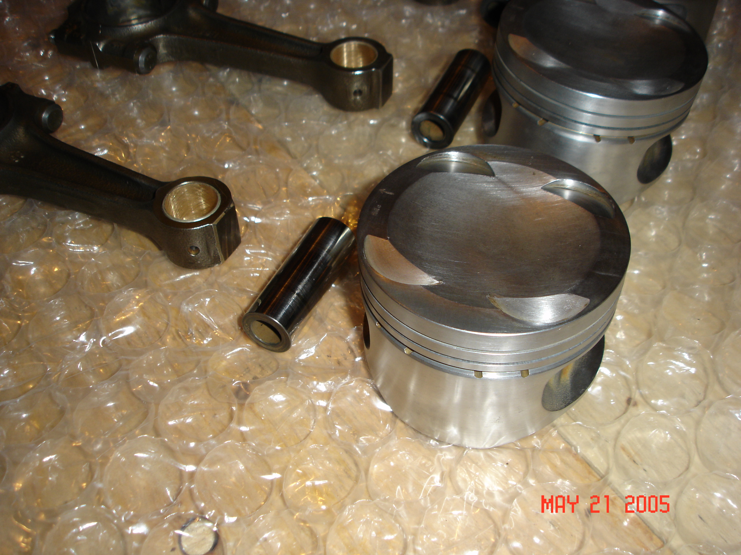

Anyway, this is some of the original parts after cleaning and machine work:

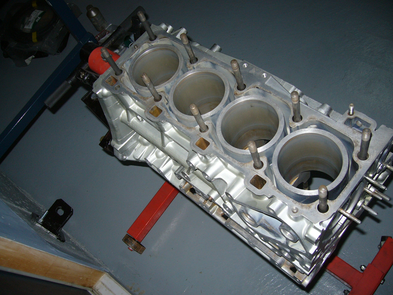

This is the block how it originally was, just cleaned:

The new pistons came complete with new pins and rings.

And here are the new pistons in the freshly machined block:
