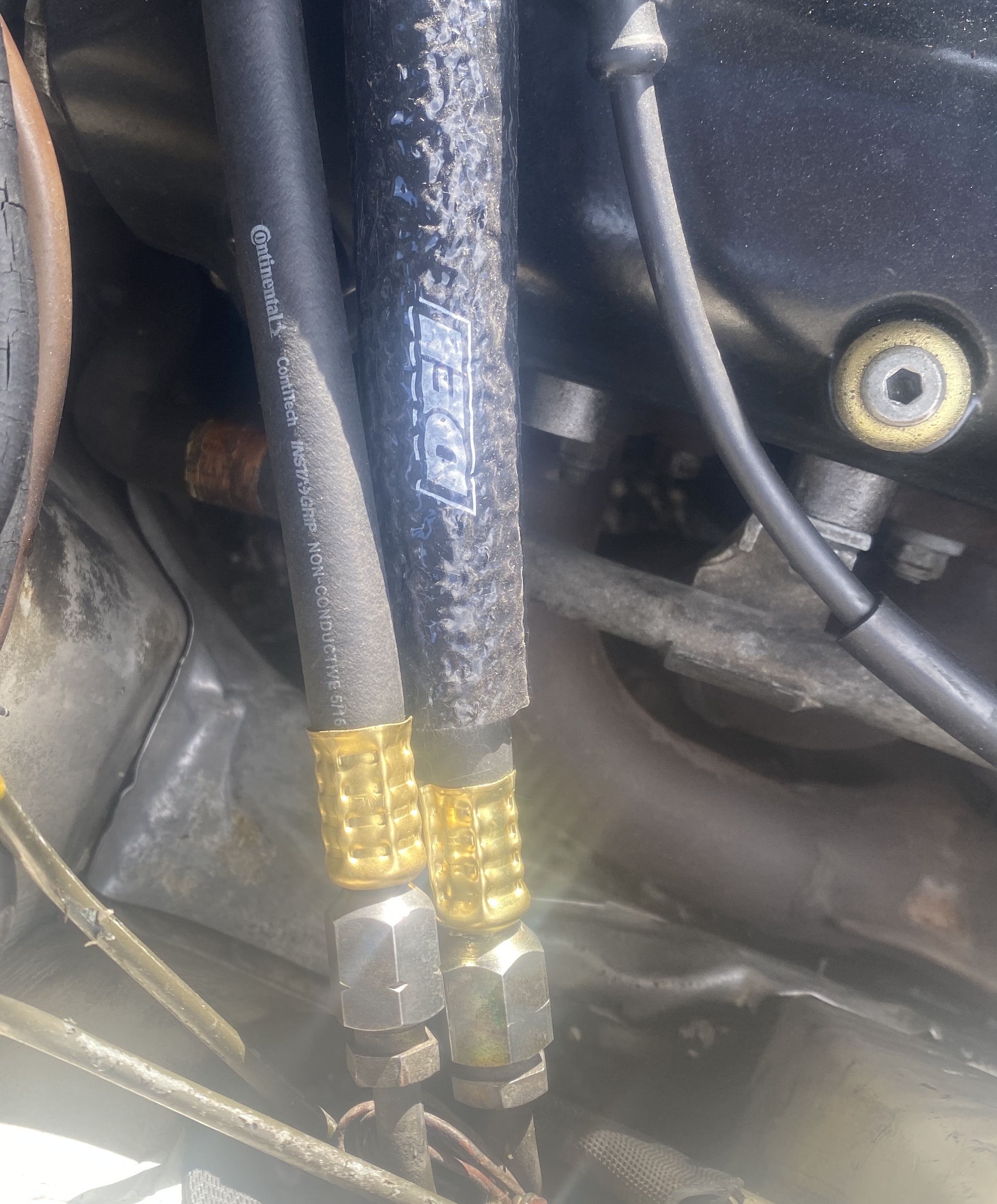

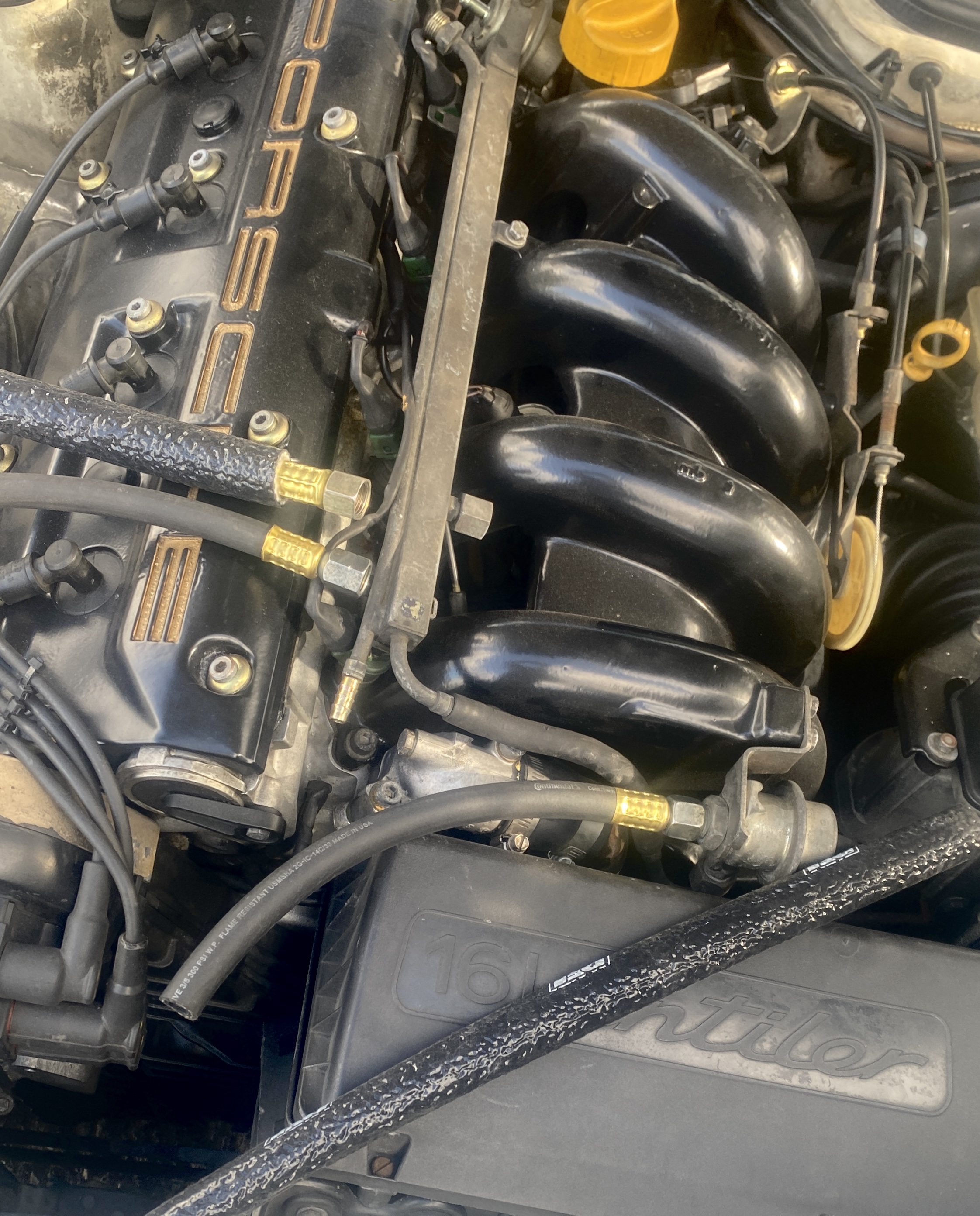

Looks nice!
However....I hate to say it, but I believe a 3/8" line is too big for the fuel rail nipples. They are only 7 mm or so. 3/8 is 10mm line...be careful! Make absolutely sure you can't pull that damper line off the fuel rail once you stick it on there, before any clamps are applied.
