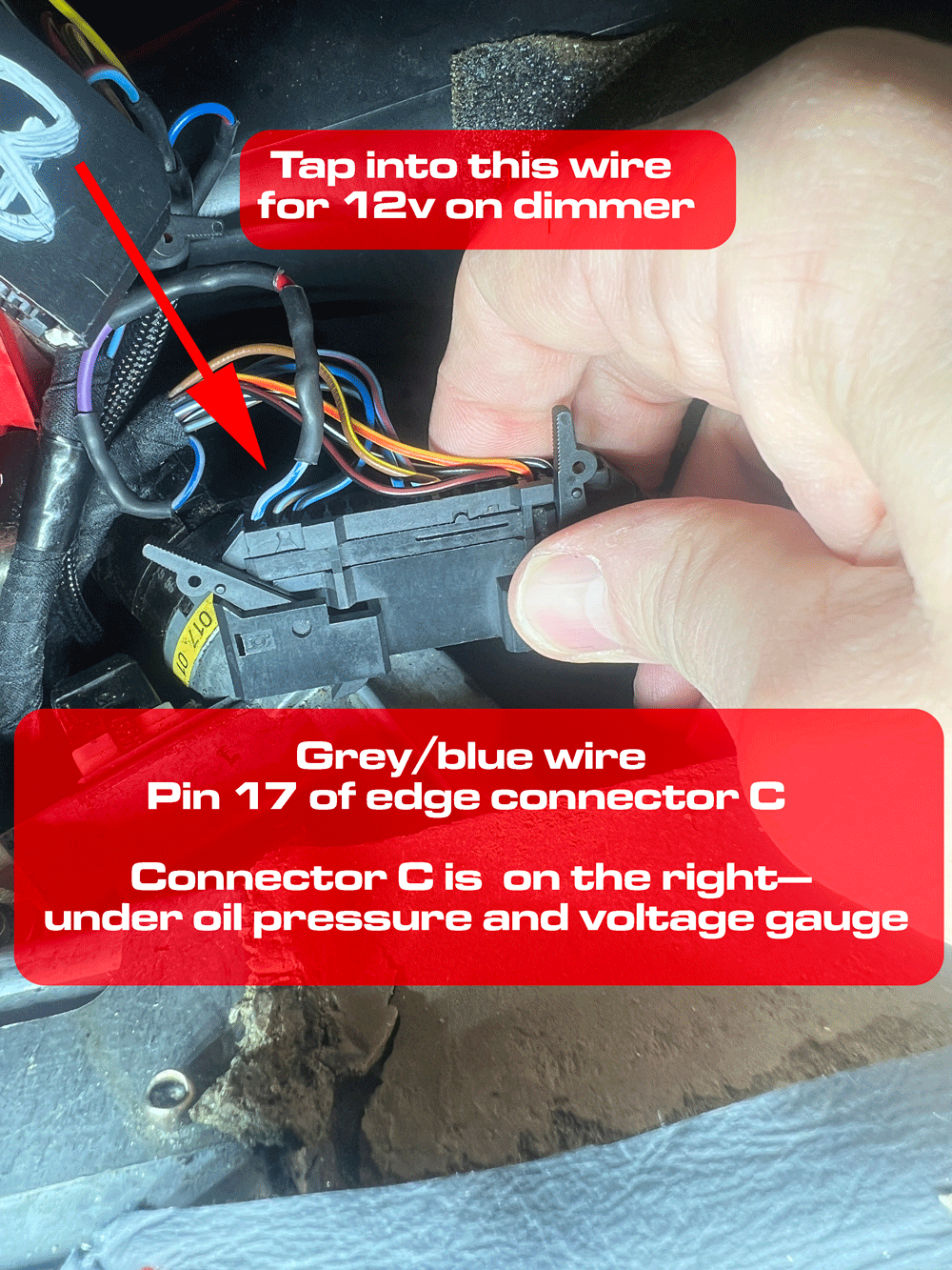

I'm not sure how much resistance you'd need to dim that bulb to your liking. If not much, then be careful with the wattage rating of the resistor. If that bulb is, say, a 2 watt bulb, you'd fry a quarter watt resistor unless it supplies enough resistance itself to bring the circuit under a quarter watt. I don't really have any idea if you'll need a couple ohms or a couple hundred. I'm thinking it would be less effort/risk, with a more factory result, just to connect the 12v dimmer signal to B1 on the CC unit. You can get at the 12v dimmer signal by tapping in to the grey/blue wire going to Pin 17 of the "C" edge connector on the instrument cluster (on the oil pressure/volt meter side of the cluster). Maybe when you install the 911-style gauge kit. :angel: Here's a picture of that wire. You can see I've already tapped into mine, to have the radio lights dim with the dash...
