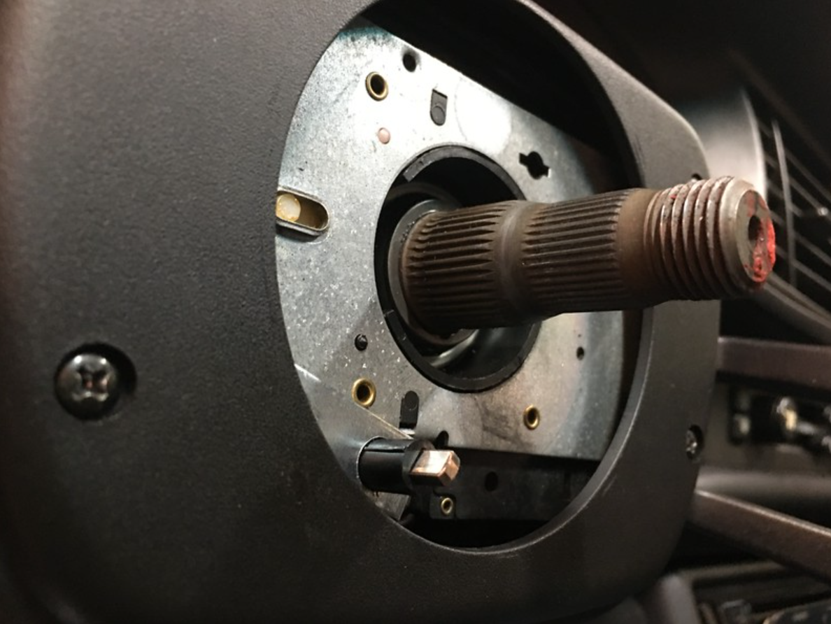

Here's a picture I found of an airbag equipped 944 with the clockspring removed. This particular unit has been modified with a spring-loaded contact for the horn function on a non-airbag steering wheel.
- 944 Steering Wheel Hub.png (1.17 MiB) Viewed 388 times
