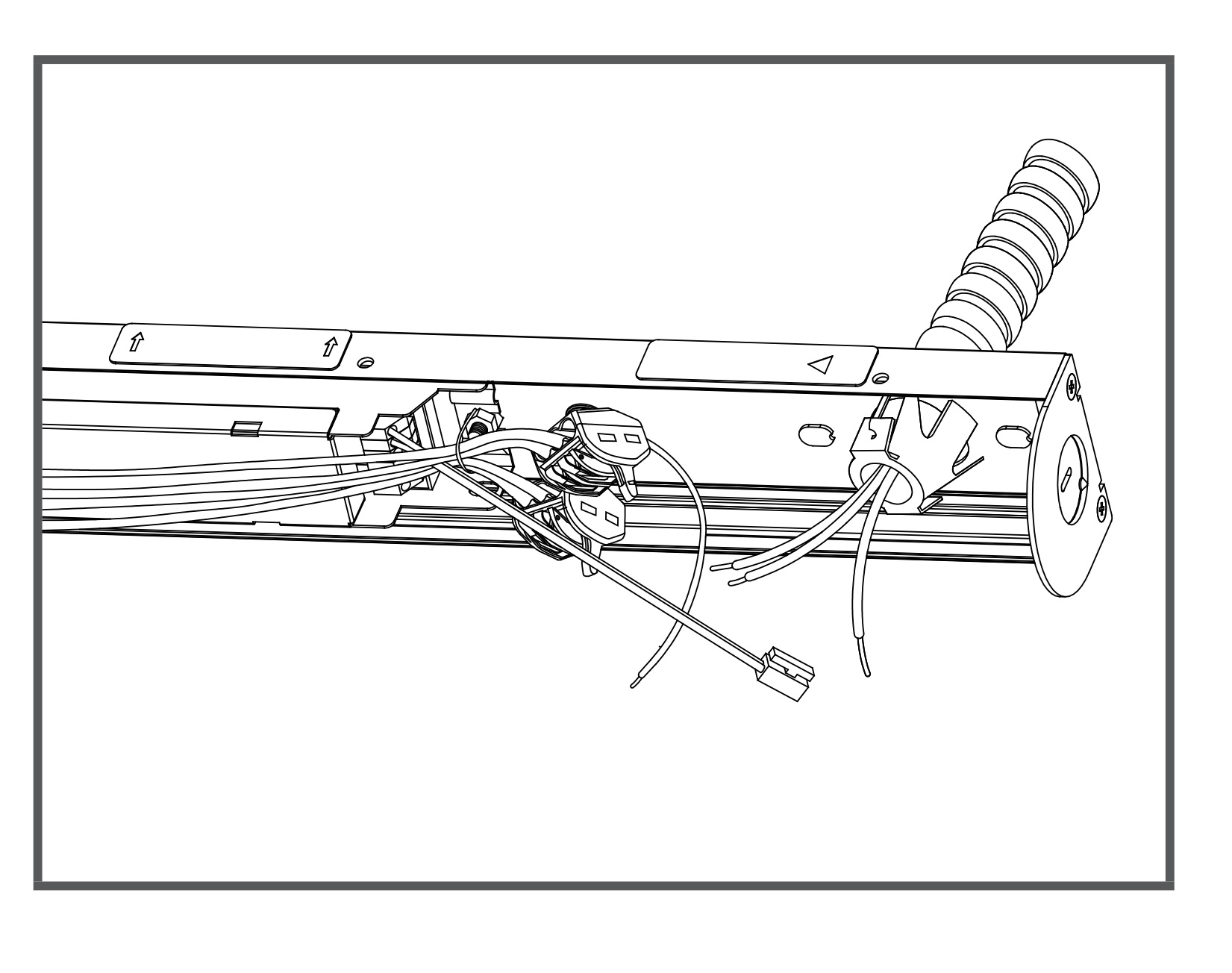

Those look better but the illustration in the instructions make me worry that this is a 2-piece design where the heavy LED part clips on under the electrical channel. If so, beware. I'm sure with care you can make them safe, but unless you install them yourself most electricians just push them together and assume they are fine. See video below to see how that works out.... I'll see if I can dig up what we originally spec'd and what we eventually installed instead.
From the instructions on that light you linked....
Why you don't want that....

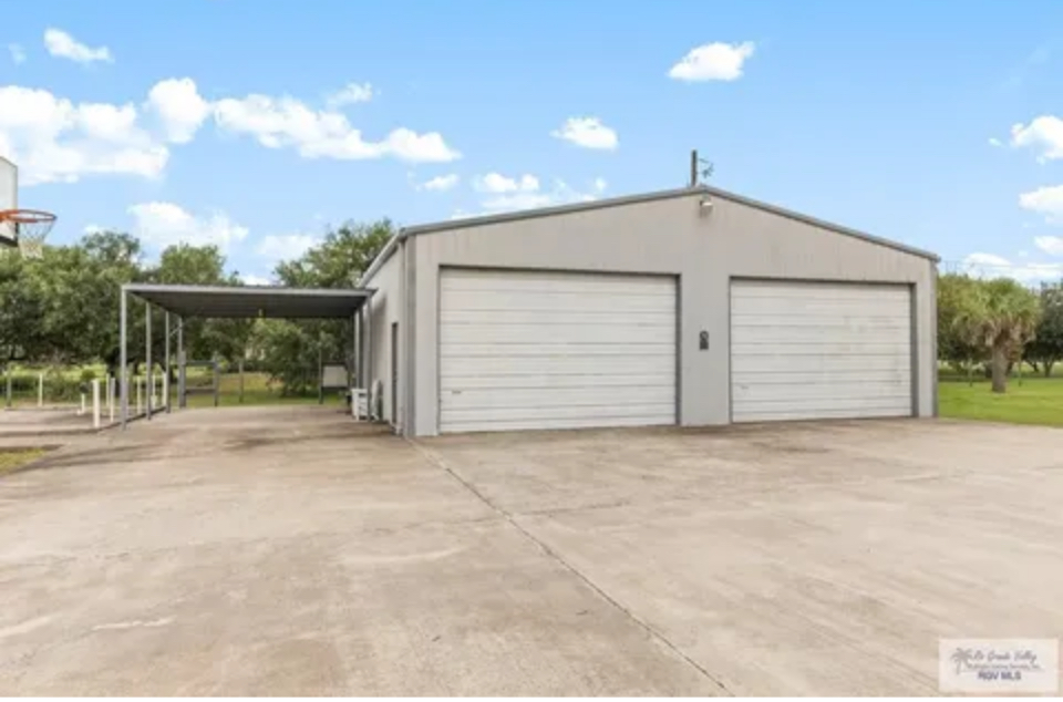

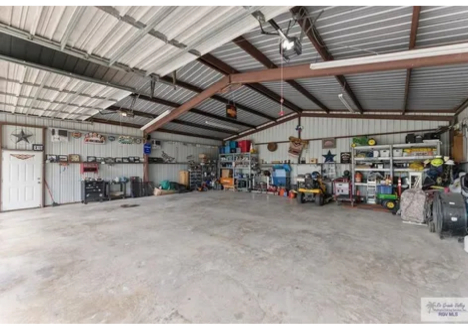

Going in here. Pics from before I bought the places. The inside is getting finished with lots of storage, work benches, and a big effin lift. The cars get parked in the attached garage.
- IMG_0952.jpeg (374.68 KiB) Viewed 874 times
- IMG_0953.jpeg (505.71 KiB) Viewed 874 times
RGV region
RGV region
- Posts: 8933
- Has thanked: 932 times
- Been thanked: 3994 times
Holy cow, what a fantastic space! The possibilities are endless. For lights, I can see why you are talking about hanging them. You might consider getting away from tube lights and going with high output UFO lights like these:Mojonito wrote: Tue Nov 14, 2023 10:14 am Going in here. Pics from before I bought the places. The inside is getting finished with lots of storage, work benches, and a big effin lift. The cars get parked in the attached garage.

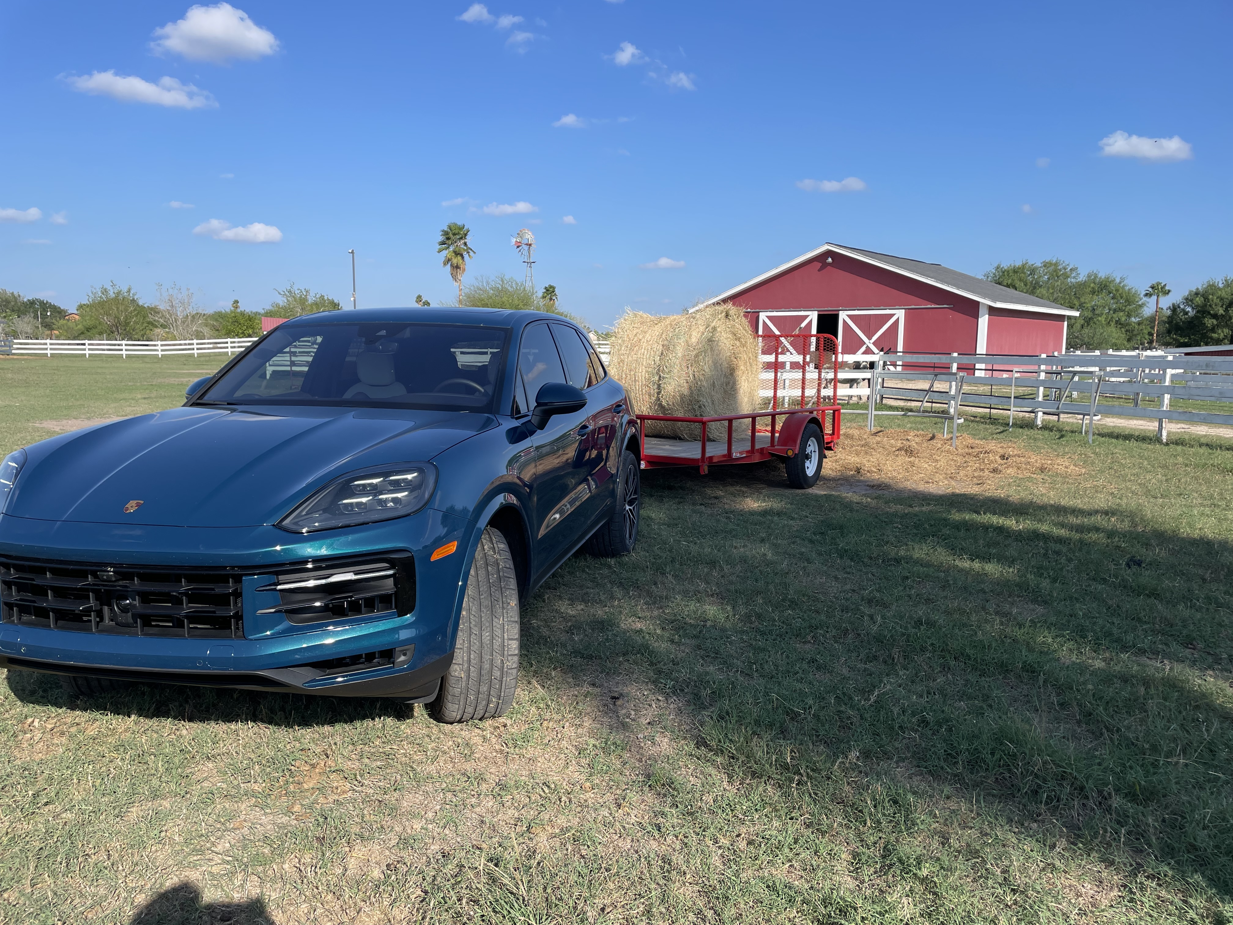

Yes. Two actually. The barn is plumbed with electricity. Plans for that to be a finished man cave to put the really cool cars and motorcycles and then the attached three car garage.
