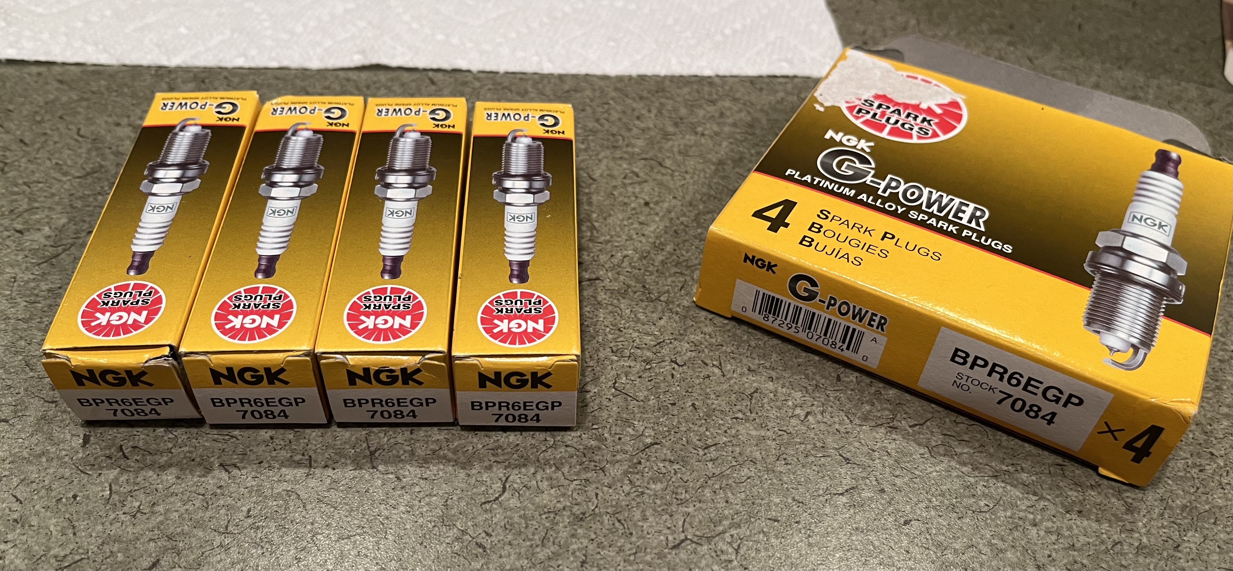

Ok, plugs arrived today. I gapped them all to .028

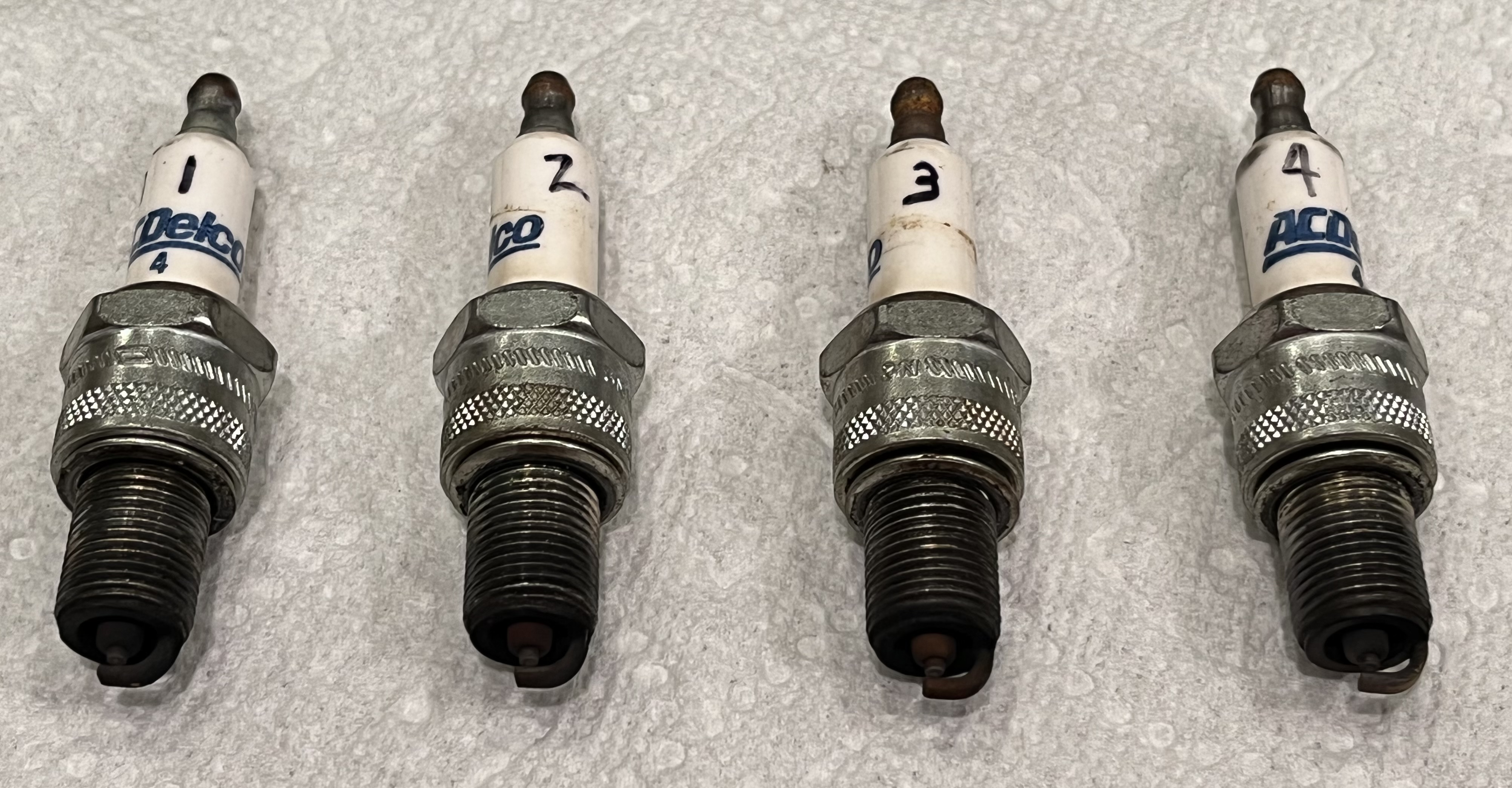

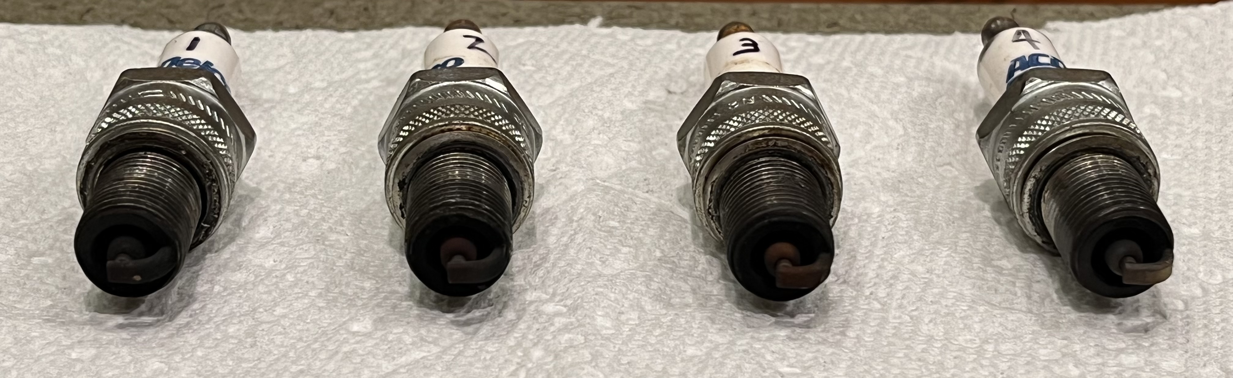

I pulled the old ones out. Mixture looks very rich to me with the possible exception of #3 and #4.
Makes me wonder if I should back the fuel pressure regulator off a little.
I will take it out for a spin tomorrow and see if it feels any different while driving.
I checked the gap on the plugs that I pulled out and they were between .032 and .035 on my feeler gauge.

Do you have a wideband? Vitesse software is pretty dialed in (as long as you are running the fuel pressure and injectors it's mapped for). Missing and stumbling can screw up plugs too. I'd run it with the new plugs (and wires?) and see how it does. If it really is is running rich, I'd be inclined to use the FQS, assuming you have the specs for your chipboard.
