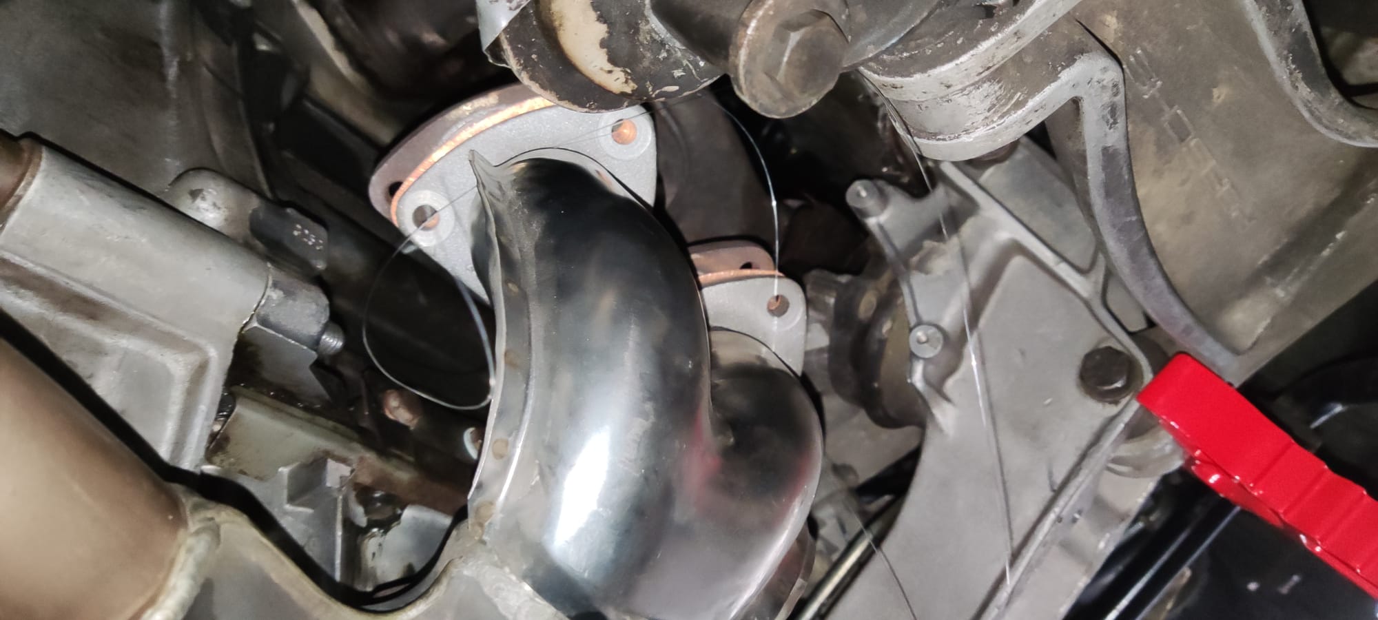

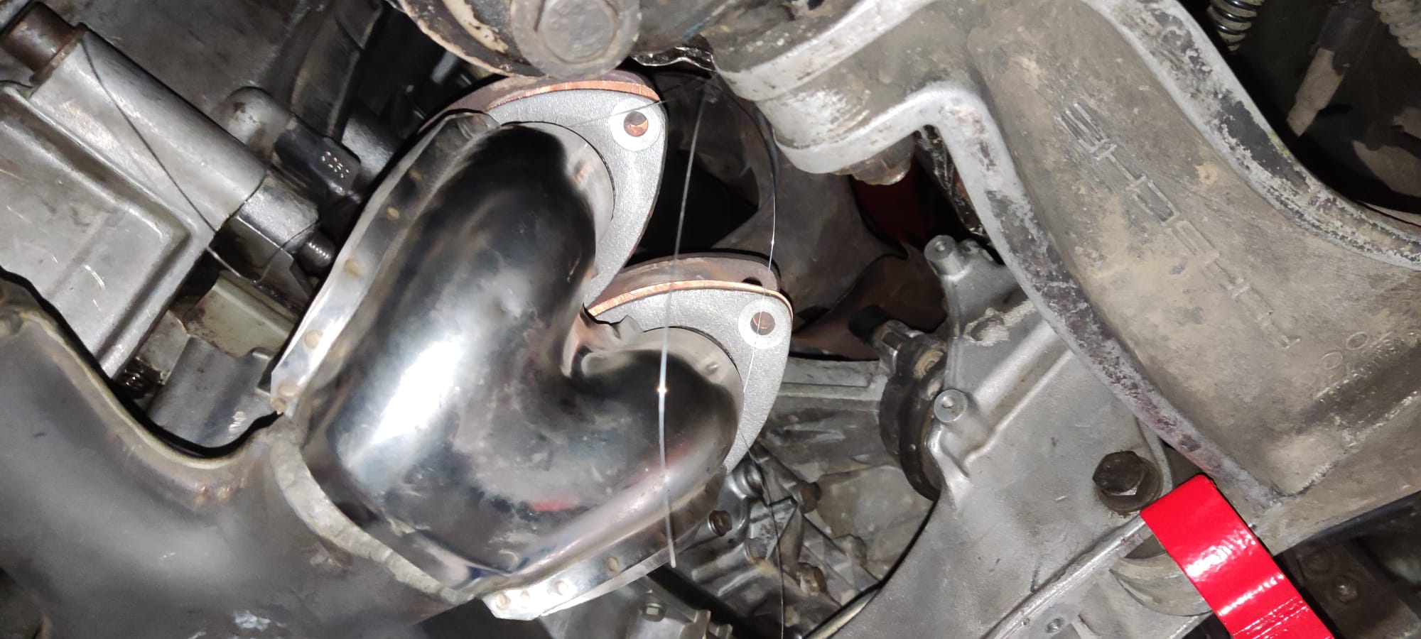

Thanks. I had my brother take some photos of the misalignment. What do you all think?

Exhaust headers are loose. Do you think it's safe to pry them this much together?
Posts: 9210
Has thanked: 962 times
Been thanked: 4161 times
Belgian951 wrote: Thu Oct 05, 2023 5:04 am
ealoken wrote: Thu Oct 05, 2023 3:49 am Loosen them on the head, and sqrew all places inn,turn by turn.
From those pictures, they look close enough to pry over with a screwdriver safely. Pictures can be deceiving so use your best judgment, but that looks pretty typical...

Belgian951 wrote: Thu Oct 05, 2023 1:32 am Thanks. I had my brother take some photos of the misalignment. What do you all think?
The headers are most likely warped also a normal occurrence with these cars. That looks very doable. As others have said get a line up punch. Also FWIW I removed the studs in the head at the exhaust ports and used the same allen heads that are used for the intake manifold works really nice and when/if you need to R&R the headers you don't have to fight them to get around the studs. BTW when "we" say leave it loose that means only a few threads on the fastener.

Dumb question: do I have to hammer these punches at a sideways angle?
gpr8er wrote: Fri Oct 06, 2023 4:24 pm
I wouldn't be surprised if these headers are warped or otherwise damaged. I noticed the PO did a poor welding job on one of them, so I just hope they are leak free... But if I ever replace them, I'll be sure to change the studs to the bolts. That's a good tip. Thank you!

Belgian951 wrote: Sat Oct 07, 2023 2:17 am
RUG8RB8 wrote: Fri Oct 06, 2023 4:06 pm You must have a set of quality tapered punches to make this happen. A generous amount of antiseize on your bolts and nuts will assist as well. You will have to play around with order of install as you will learn certain ones need to be started and other holes left open.
Thanks. I have bought 2 tapered punches, they'll arrive this evening. :thumbup:
No, you don't hammer in the punch. Get everything end to end rattle loose and start prying the best spot where you can get the punch in across 2 holes. Get a bolt in and keep going. It's going to fight you and will take some time
