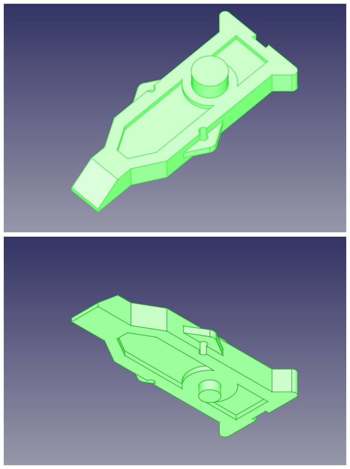

I also made a FreeCAD (v0.20.2) model of the cancellation tab. I didn't see one in the *.stl section of Carpokes. Just ask and I'll send the file.
Cancellation Tab

@usury : I'm a little out of practice but I have a resin printer and can try to print these parts. I don't know that they would stand up to actual use, but it might be a reasonable test for 3D printing. If you can send me the .stl files of anything that is not in the 3D section here, I'll see about getting it printed.

@Zirconocene , when I get to my computer later today where the file lives (on phone now), I'll send you the *.stl
I imagine a resin printer could print this standing on the square flat end of the larger complicated part. I also imagine bed adhesion vs UV print screen adhesion will be a problem as the wider nose of the part is formed.

Just yesterday I made a few more tweaks and printed a few more prototypes. The CAD is done and the model works™, but it's tricky to print and have the tolerances come out right.
There are places in the model, like the six spring pockets, that come one extrusion-width from poking into the feature behind them.
I've identified those places and made changes to various pocket depths in the model to leave more material thickness and also not adversely effect functionality.
I've also tried to eliminate the need for support as much as possible. Got it down to only three critical areas.
It's a detailed print for a filament printer. I'm close to releasing the STL here on Carpokes. (Quite possibly the 3MF since it will contain usable print settings.)
The prototypes that work the best I've printed with a 0.4mm nozzle, 0.1mm layer height, and 0.3mm extrusion width for perimeters and places with solid infill.
