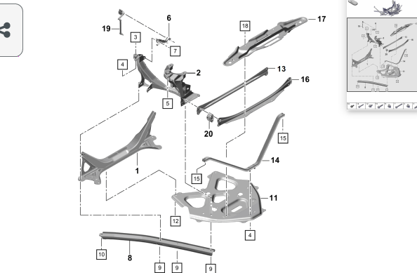

So, per Porsche lead tech, the 718 GT4 already has a brace of that type although it is two stamped steel pieces that do the same thing by joining the two halves of the rear subframe together. The sway-bar bearing mounts bolt them together if I'm understanding it correctly. The aluminum Techno Brace 2 bar would be stronger I'm sure but I don't think it would make a noticeable difference for a GT4.
However, I don't think a 718 GTS 4.0 has the 2-piece brace that's on the GT4. If that's the case, it would probably be of significant benefit.
I called Pedro and he said he had not installed one on a 718 GT4. He said they were originally designed and built for the 986/987 Boxsters and Caymans (the original Techno Brace) and the the TB2 was developed for 981/718. He did say if it didn't work out for your car you could send it back for a full refund. It's certainly not a lot of money.

Tim, Can you have a quick look at the picture reference here and tell me if this is what you were thinking? The 718s all seem to have the black support that connects the two sway bar mounts together. Is this what you are speaking of? Can you glance at your GT4 and see if your looks like this? My GTS sure does.

It's difficult for me to see mine as clearly as the pic you referenced due the underbody panels and the car not on a lift, but yes, that pic is of one of the two pieces. Here's a screenshot of a diagram. See parts #13 & 16.

The 718 came with the "reinforcement brace", but you can retrofit it on a 981(I did)
