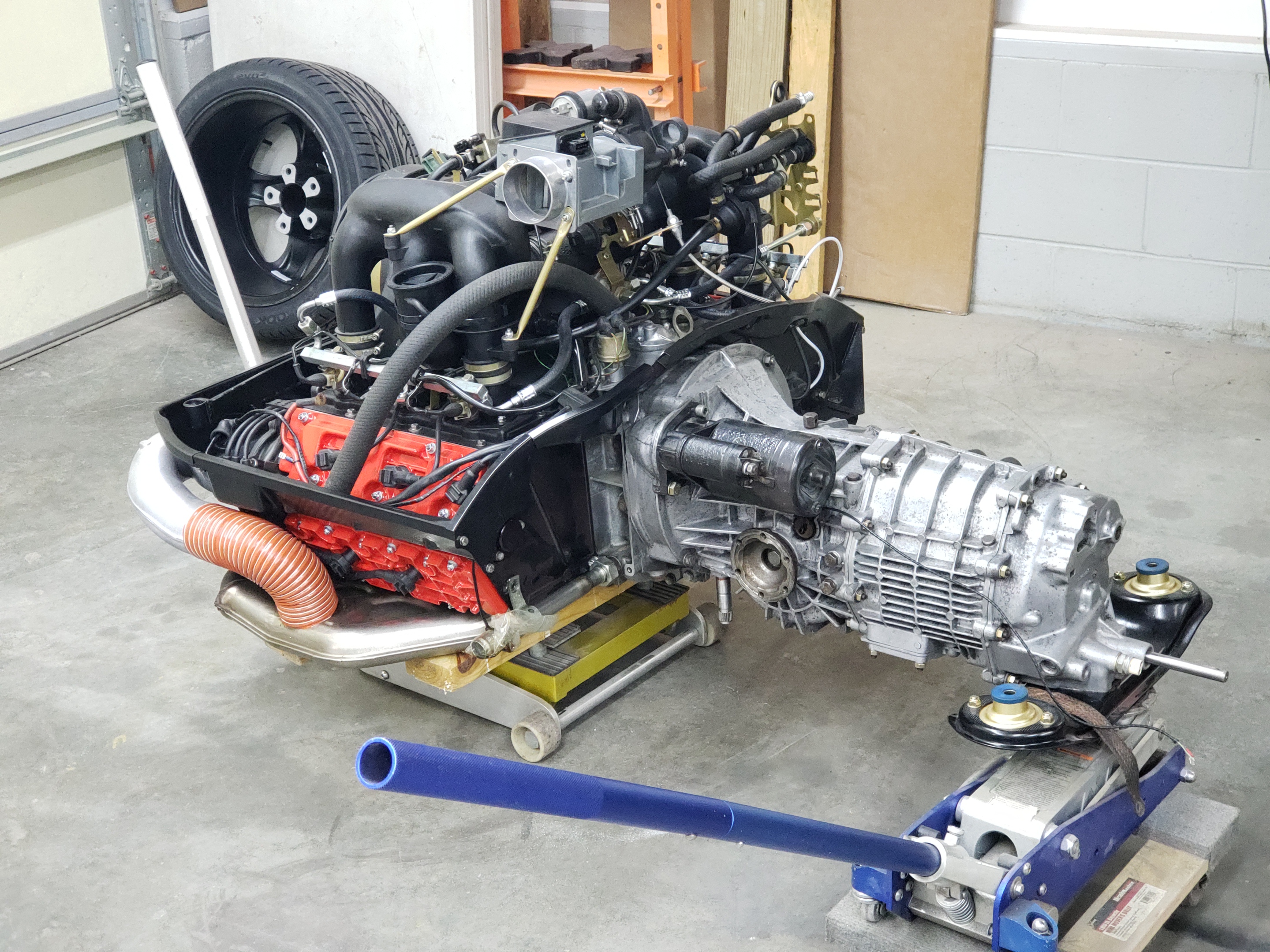

There is a difference how the engine must be supported between using jack stands or a lift where the car sits leveled. When the car is jacked up at the rear end and on jack stands, the engine is more or less level. By using a lift and the car is level, the transmission need to be jacked up so you can slide in the engine.
Since I have a lift, I'm using a motorcycle jack and a small floor jack on a furniture dolly, so it will slide in all directions, and I can rise or lower both ends as needed.
Here is a picture.

Carmagic wrote: Sun Jan 07, 2024 6:26 am There is a difference how the engine must be supported between using jack stands or a lift where the car sits leveled. When the car is jacked up at the rear end and on jack stands, the engine is more or less level. By using a lift and the car is level, the transmission need to be jacked up so you can slide in the engine.
Here is a picture.
That’s a great Idea !!
